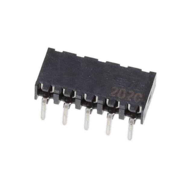

    弯插,P=2mm
    排母 间距:2mm 1x5P 插件
2314927-5 数据手册
4 C 2 3 1 REVISIONS 2021 TE Connectivity. All Rights Reserved. P E # 0.15 2 F # 0.10 0 DRAWING:2 8 2.1 7 1 1 8 2 B 4 DRAWING:5 32 8 (0.20) 0.40 B | A | C B | A | C TYP 6 DRAWING:3 TYP SCB 05OCT2021 AY 32 4.7 ALL OVER 3-5µm TIN OVER MIN 1.27µm NICKEL UNDERPLATE 3 CONTACT AREA: MIN 0.1µm GOLD SOLDER TAIL: 3-5µm TIN UNDERPLATING: MIN 1.27µm NICKEL ALL OVER 4 CONTACT AREA: MIN 0.38µm GOLD SOLDER TAIL: 3-5µm TIN UNDERPLATING: MIN 1.27µm NICKEL ALL OVER 5 CONTACT AREA: MIN 0.76µm GOLD SOLDER TAIL: 3-5µm TIN UNDERPLATING: MIN 1.27µm NICKEL ALL OVER 4.50 C N = NO. OF POSITIONS PER CONNECTOR. 8 DRAWING:6 8 CONTACT 2 DESCRIPTION ITEM HOUSING A D 2 6 F APVD MATERIAL: HOUSING: LCP, UL94 V0, BLACK CONTACT: PHOSPHOR BRONZE, 0.20mm THICK, C B ECR-21-115824 DWN NOTES: L DRAWING:13 DRAWING:2 DATE 8 D 5 DESCRIPTION 3 DRAWING:14 2.00 LTR A2 # 0.20 C 1 1 # 0.10 B 0.70 4.70 2.00 +0.1 0 0 -2 AS SHOWN PCB EDGE A RECOMMENDED PCB HOLE PATTERN FOR THROUGH HOLE WAVE 0.70MAX TYP 23NOV2017 SOURAV DAS CHK 19JULY2018 SHARATH S APVD 19JULY2018 PRASHANTH S DWN THIS DRAWING IS A CONTROLLED DOCUMENT. DIMENSIONS: mm MATERIAL TOLERANCES UNLESS OTHERWISE SPECIFIED: 0 PLC 1 PLC 2 PLC 3 PLC 4 PLC ANGLES FINISH 1 1471-9 (3/13) 1- -6 AS SHOWN -8 AS SHOWN 0.2 0.1 - PRODUCT SPEC 108-64040 TE Connectivity A NAME AMPMODU 2mm, BtB RECEPTACLE, SINGLE ROW, HORIZONTAL TH/THR APPLICATION SPEC 2 $ SEE NOTES - 114-32186 WEIGHT CUSTOMER DRAWING SIZE RESTRICTED TO CAGE CODE DRAWING NO A200779 2307700 SCALE 10:1 SHEET 1 OF - 2 A2 REV 4 C 2 3 1 REVISIONS 2021 TE Connectivity. All Rights Reserved. P LTR - D DESCRIPTION DATE SEE SHEET 1 DWN APVD - - - BTB RECEPTACLE BASE NUMBERS MATING SIDE "L"SOLDER TAIL PLATING (FINISH) LENGTH TAPE & REEL PKG TUBE PKG W/0 CAP W/O CAP TIN 2.1 2307700 2314927 3.4 A/R 2307702 2 2.8 GOLD FLASH 0.1µm 2.1 2307703 3.4 A/R 3 GOLD 0.38µm 4 GOLD 0.76µm 5 C 2.8 2314935 2314936 2.1 2307706 3.4 A/R 2.8 2314937 2.1 2307709 3.4 A/R 2.8 2314938 D 2307701 2314928 2307704 2307705 2314929 2307707 2307708 2314930 2307710 2307711 C * A/R- AVAILABLE ON REQUEST 48 50 25 2- -5 44 46 23 2- -3 46 48 42 44 40 16 10 6 6 2 23NOV2017 SOURAV DAS CHK 19JULY2018 SHARATH S APVD 19JULY2018 PRASHANTH S THIS DRAWING IS A CONTROLLED DOCUMENT. A DIMENSIONS: mm MATERIAL 1471-9 (3/13) TOLERANCES UNLESS OTHERWISE SPECIFIED: 0 PLC 1 PLC 2 PLC 3 PLC 4 PLC ANGLES FINISH 0.2 0.1 - PRODUCT SPEC 108-64040 6 -6 4 -4 -5 3 4 DIM "F" DIM "E" DWN -7 5 8 4 -8 7 12 8 -9 8 14 10 1- -0 9 16 12 1- -1 10 18 14 1- -2 11 20 -3 2 -2 N 6 FG PN TE Connectivity A NAME AMPMODU 2mm, BtB RECEPTACLE, SINGLE ROW, HORIZONTAL TH/THR APPLICATION SPEC 2 $ SEE NOTES - 114-32186 WEIGHT CUSTOMER DRAWING SIZE RESTRICTED TO CAGE CODE DRAWING NO A200779 2307700 SCALE 10:1 SHEET 2 B 1- -3 12 22 18 1- -4 13 24 20 1- -5 14 26 22 1- -6 15 28 24 1- -7 16 30 26 1- -8 17 32 28 1- -9 18 34 30 2- -0 19 36 32 2- -1 20 38 34 2- -2 21 40 36 2- -4 22 42 38 B 24 OF - 2 A2 REV
2314927-5
1. 物料型号:2307700 00779 2. 器件简介:这是一个2mm间距,板对板(BtB)的连接器,单排,水平引脚,通孔焊接(TH/THR)。 3. 引脚分配:文档中提供了详细的引脚分配图,但没有提供具体的引脚功能。 4. 参数特性:包括材料、尺寸、公差等,例如: - 材料:LCP, UL94 V0, 黑色 - 接触材料:磷青铜,0.20mm厚,表面镀锡3-5µm - 接触区域:最小0.1µm金层 - 焊尾:3-5µm锡层,下层至少1.27µm镍层 5. 功能详解:文档中没有提供详细的功能描述,但提到了连接器的一般应用和规格。 6. 应用信息:文档中提到了应用规格编号108-64040和重量规格114-32186。 7. 封装信息:提供了不同焊尾长度和镀层的封装选项,例如镀锡、金闪镀0.1mm、0.38mm金层和0.76mm金层。
