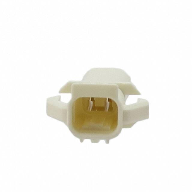

2321926-3 数据手册
2.5MM SEALED SIGNAL DOUBLE LOCK CONNECTORS PROTECTION WITH PERFORMANCE PRODUCT DESCRIPTION Our new 2.5mm Sealed Signal Double Lock connectors offers secondary locking safety combined with first in class IP67 rated sealing protection. Designed with a space-saving 2.5mm centerline to meet the needs of today's smaller designs, our next generation 2.5mm Sealed Signal Double Lock connectors offer robust seals that can help to enable reliable performance in water related or high humidty environments. These connectors are available in panel mount and free hanging configurations to provide flexible design options for a broad range of applications. Contacts are on a miniature 2.5mm centerline spacing and accept 26-22 AWG wire. Rated up to 3 amps max. per line, our solution includes features that are designed to help ease manual assembly including a snag-proof latch, polarized terminals, and an optional TPA. Cap and plug housings meet Glow Wire Test (750°C, no flame) and UL 94 V-0 requirements to meet global industry safety standards. APPLICATIONS • Major Home Appliances: refrigeration, laundry (washing machines and dryers), water heaters, cooking (range hoods) • Small Home Appliances: water purifiers, humidifiers, rice cookers • Industrial: refrigeration • Power cords • Lighting: outdoor and industrial • Personal Health Care: smart toilet seats • Lawn and Garden: outdoor tools (lawn mowers and sprinkler system interfaces) KEY FEATURES • IP67 rated protection against water and dust • Contacts are on a miniature 2.5mm centerline to provide a compact design solution • 3 amps max. current rating, and 250 VAC voltage rating • UL94-V0 and Glow Wire Test (750°C, no flame) to meet global industry safety standards • Snag-proof latch provides for ease of assembly • Automotive: battery chargers • Optional TPA's (Terminal Position Assurance) help to ensure proper assembly STANDARDS & SPECIFICATIONS • Polarized lance-less terminals to prevent incorrect insertion reducing assembly errors • Product specification #108-143069 • Application specification #114-143067 • Qualification Test Report #501-143069 • UL Recognized, File #E28476 APPLIANCES /// 2.5MM SEALED SIGNAL DOUBLE LOCK CONNECTORS 2.5MM SEALED SIGNAL DOUBLE LOCK CONNECTORS Protection With Performance Overview of New Parts PLUG HOUSING Part Number PERIMETER SEAL — PLUG HOUSING Part Description Part Number Part Description 2321918-2 PLUG HOUSING SDL2.5 WATERPROOF 2PIN 2321920-2 PERIMETER SEAL PLUG HOUSING 2PIN 2321918-3 PLUG HOUSING SDL2.5 WATERPROOF 3PIN 2321920-3 PERIMETER SEAL PLUG HOUSING 3PIN 2321918-4 PLUG HOUSING SDL2.5 WATERPROOF 4PIN 2321920-4 PERIMETER SEAL PLUG HOUSING 4PIN 2321918-5 PLUG HOUSING SDL2.5 WATERPROOF 5PIN 2321920-5 PERIMETER SEAL PLUG HOUSING 5PIN 2321918-6 PLUG HOUSING SDL2.5 WATERPROOF 6PIN 2321920-6 PERIMETER SEAL PLUG HOUSING 6PIN RECEPTACLE HOUSING (FREE HANGING) WIRE SEAL Part Number Part Number Part Description Part Description 2321924-2 RECEPTACLE HOUSING FREE HANGING 2PIN 2321922-2 REAR WIRE SEAL 2PIN 2321924-3 RECEPTACLE HOUSING FREE HANGING 3PIN 2321922-3 REAR WIRE SEAL 3PIN 2321924-4 RECEPTACLE HOUSING FREE HANGING 4PIN 2321922-4 REAR WIRE SEAL 4PIN 2321924-5 RECEPTACLE HOUSING FREE HANGING 5PIN 2321922-5 REAR WIRE SEAL 5PIN 2321924-6 RECEPTACLE HOUSING FREE HANGING 6PIN 2321922-6 REAR WIRE SEAL 6PIN RECEPTACLE HOUSING (PANEL MOUNT) TERMINALS Part Number Part Number Part Description Part Description 2321926-2 RECEPTACLE HOUSING PANEL MOUNT 2PIN 2321921-1 RECEPTACLE TERMINAL 2321926-3 RECEPTACLE HOUSING PANEL MOUNT 3PIN 1-2321921-1 RECEPTACLE TERMINAL (LOOSE PIECE) 2321926-4 RECEPTACLE HOUSING PANEL MOUNT 4PIN 2321928-1 TAB TERMINAL 2321926-5 RECEPTACLE HOUSING PANEL MOUNT 5PIN 1-2321928-1 TAB TERMINAL (LOOSE PIECE) 2321926-6 RECEPTACLE HOUSING PANEL MOUNT 6PIN PLUG HOUSING TPA* Part Number RECEPTACLE HOUSING TPA* Part Description Part Number Part Description 2321919-2 TPA PLUG HOUSING, 2 POS 2321927-2 TPA RECEPTACLE HOUSING, 2 POS 2321919-3 TPA PLUG HOUSING, 3 POS 2321927-3 TPA RECEPTACLE HOUSING, 3 POS 2321919-4 TPA PLUG HOUSING, 4 POS 2321927-4 TPA RECEPTACLE HOUSING, 4 POS 2321919-5 TPA PLUG HOUSING, 5 POS 2321927-5 TPA RECEPTACLE HOUSING, 5 POS 2321919-6 TPA PLUG HOUSING, 6 POS 2321927-6 TPA RECEPTACLE HOUSING, 6 POS *Plug and receptacle housing TPA's are still to be released *Plug and receptacle housing TPA's are still to be released TE TECHNICAL SUPPORT CENTER TOOLING* USA: Canada: Mexico: Latin/S. America: Germany: UK: France: Netherlands: China: Part Number +1 (800) 522-6752 +1 (905) 475-6222 +52 (0) 55-1106-0800 +54 (0) 11-4733-2200 +49 (0) 6251-133-1999 +44 (0) 800-267666 +33 (0) 1-3420-8686 +31 (0) 73-6246-999 +86 (0) 400-820-6015 Part Description 2350391-1 HAND TOOL X-2836993-X OCEAN 2.0 APPLICATOR *Applicator part number is dependent on the type of terminal used. Please visit TE.COM for more information te.com TE, TE Connectivity and TE connectivity (logo) are trademarks owned or licensed by the TE Connectivity Ltd. family of companies. All other logos, products and/or company names referred to herein might be trademarks of their respective owners. The information given herein, including drawings, illustrations and schematics which are intended for illustration purposes only, is believed to be reliable. However, TE Connectivity makes no warranties as to its accuracy or completeness and disclaims any liability in connection with its use. TE Connectivity's obligations shall only be as set forth in TE Connectivity‘s Standard Terms and Conditions of Sale for this product and in no case will TE Connectivity be liable for any incidental, indirect or consequential damages arising out of the sale, resale, use or misuse of the product. Users of TE Connectivity products should make their own evaluation to determine the suitability of each such product for the specific application. © 2020 TE Connectivity Ltd. family of companies All Rights Reserved. 2-1773983-6    06/20    Revised APPLIANCES /// 2.5MM SEALED SIGNAL DOUBLE LOCK CONNECTORS
