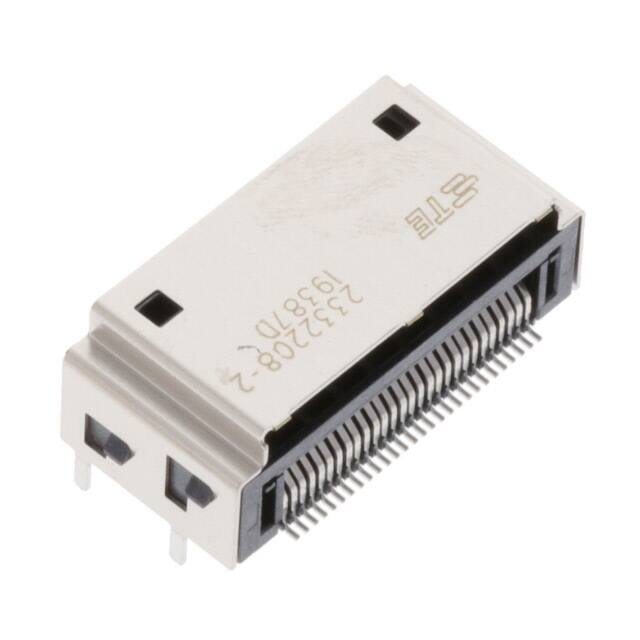

    HUMIREL(泰科)
    SMD,P=0.6mm,卧贴
    0.6MM P数:56P
2332208-2 数据手册
7 8 THIS DRAWING IS UNPUBLISHED. C COPYRIGHT 20 RELEASED FOR PUBLICATION 6 5 4 3 2 1 20 REVISIONS ALL RIGHTS RESERVED. BY - P LTR A DESCRIPTION DATE RELEASED PER ECO-19-014774 DWN APVD CJV 26SEP2019 JW 24.15 MAX D 1 HOUSING, ORGANIZER AND CONTACT OVERMOLDS - LCP, SHELL, CONTACTS AND HOLD DOWNS - COPPER ALLOY. 2 CONTACTS - GOLD PLATE ON MATING SURFACES, TIN PLATE ON SOLDER FEET. HOLD DOWNS - TIN PLATE. SHELL - NICKEL PLATE, TIN PLATE ON HOLD DOWNS. 3 1.76 C 0.03 18.62 D 1.5. 5 SEE MSA SPECIFICATION FOR ADDITIONAL PADDLE CARD LAYOUTS COMPATABLE WITH THIS RECEPTACLE AND FOR OPTIONAL SPLIT CONTACT PAD LAYOUTS FOR THE PADDLE CARD. SPECIFICATION PINOUT MAY ALSO DESIGNATE PAD SEQUENCE DIFFERENT FROM ILLUSTRATION. 6 POSITIONS DESIGNATED AS "SIGNAL" ARE REQUIRED LOCATIONS FOR HIGH SPEED DIFFERENTIAL PAIR SIGNALING. THESE LOCATIONS MAY ALSO BE USED FOR SUPPORTING SIDEBAND SIGNALS OR OTHER UTILITY PURPOSES. POSITIONS DESIGNATED AS "GROUND" ARE REQUIRED WHEN SUPPORTING HIGH SPEED DIFFERENTIAL SIGNALS. THESE LOCATIONS MAY ALSO BE USED FOR SIDEBAND SIGNALS OR OTHER UTILITY PURPOSES. 7 COMPONENT AND TRACES KEEP OUT AREA. EACH EDGE 0.15 MIN FROM EDGE OF HOLE. 8 T APE AND REEL PACKAGED FOR PICK AND PLACE SURFACE MOUNT PROCESSING, SEE FIGURE 1. POCKET TAPE: WIDTH = 44. 11.1 MAX BLACK. DATUMS AND BASIC DIMENSIONS ESTABLISHED BY CUSTOMER. 4. MINIMUM HOST PCB THICKNESS: HOUSING UL94V-0, 0.04 C CONTACT MATING SURFACES B28 SHELL B1 8.38 1.8 MAX 0.18 ( 6.05 ) ( 3.05 ) A28 B 6X ( 0.25 ) 4X A A1 2X HOLD DOWN CONTACT SOLDER FEET ( 22.48 ) B ( 1.47 ) 0.8 MIN TYP (3) ( 4.53 ) 2X 1 0.05 6.15 SEE SHEET 4 FOR PART TABLE 1 A A THIS DRAWING IS A CONTROLLED DOCUMENT. DIMENSIONS: mm 18.83 ORGANIZER MATERIAL 0 PLC 1 PLC 2 PLC 3 PLC 4 PLC ANGLES FINISH 1 4805 (3/13) TOLERANCES UNLESS OTHERWISE SPECIFIED: - 2 DWN 29MAR2018 CHK 29MAR2018 APVD 29MAR2018 B. MATTHEWS D. HARMON D. HARMON TE Connectivity NAME PRODUCT SPEC 108-130021 APPLICATION SPEC - 114-130015 WEIGHT - CUSTOMER DRAWING SIZE RECEPTACLE ASSEMBLY, RIGHT ANGLE, 56 POSITION, SLIVER 2.0 CAGE CODE A1 00779 DRAWING NO 2332208 SCALE 10:1 SHEET 1 OF RESTRICTED TO - 4 REV A 7 8 THIS DRAWING IS UNPUBLISHED. C COPYRIGHT 20 RELEASED FOR PUBLICATION BY - 6 5 4 3 2 1 20 REVISIONS ALL RIGHTS RESERVED. P LTR - DESCRIPTION DATE SEE SHEET 1 DWN APVD - - - ( 24.33 ) 2X 2X D 1.95 20.78 19.88 D ( 2.75 ) 1.1 0.05 ( 2.4 ) 0.68 7 COMPONENT KEEP OUT AREA 6X 1.1 0.05 PLATED THRU HOLES 7 W 1.1 2X 4.53 2X 3 2X 0.05 1.47 2X ( 1.4 ) C ( 6.5 ) C 5.1 ( 5.8 ) ( 6.8 ) 2.15 2X ( 4.33 ) BSC 3 A1 B28 B1 3 ( 12.8 ) 1 A28 Y 27X ( 2.75 ) 56X 0.6 0.35 1.42 56X 1.4 0.05 0.05 2X ( 1.5 ) 2X ( 3.45 ) 3 BSC B 3 18.83 B Z RECOMMENDED PCB LAYOUT AND KEEP OUT AREA X A A THIS DRAWING IS A CONTROLLED DOCUMENT. DIMENSIONS: mm MATERIAL TOLERANCES UNLESS OTHERWISE SPECIFIED: 0 PLC 1 PLC 2 PLC 3 PLC 4 PLC ANGLES FINISH - DWN 29MAR2018 CHK 29MAR2018 APVD 29MAR2018 B. MATTHEWS D. HARMON D. HARMON NAME PRODUCT SPEC 108-130021 APPLICATION SPEC - 114-130015 WEIGHT - CUSTOMER DRAWING 4805 (3/13) TE Connectivity SIZE RECEPTACLE ASSEMBLY, RIGHT ANGLE, 56 POSITION, SLIVER 2.0 CAGE CODE A1 00779 DRAWING NO 2332208 SCALE 10:1 SHEET 2 OF RESTRICTED TO - 4 REV A 7 8 THIS DRAWING IS UNPUBLISHED. C COPYRIGHT 20 RELEASED FOR PUBLICATION 6 5 4 3 2 1 20 REVISIONS ALL RIGHTS RESERVED. BY - P LTR - DESCRIPTION DATE SEE SHEET 1 DWN APVD - - - D D D 2X R 0.5 0.1 B28 2X 6.1 B1 0.1 2X 30 $ 5 $ A1 A28 2X 45 $ 5 $ SEE DETAIL C C 54X 0.6 2X 8.015 2X 0.75 18.48 0.13 G 2X 0.62 0.13 J 1.57 0.13 ACROSS PADS C 0.1 RECOMMENDED PCB OUTLINE DIMENSIONS: TOLERANCE VALUES ARE CRITICAL. PLEASE BE SURE TO DESIGNATE TOLERANCES TO PCB SUPPLIER TO ENSURE OPTIMIZED FUNCTIONALITY. 56X 0.38 0.05 CONTACT POINT REFERENCE LINE B B ( 0.1 ) 3 0.13 1.28 0.13 LEVEL 2 SEQUENCE ( 2.58 ) 0.88 0.13 LEVEL 1 SEQUENCE SPLIT PADS OPTIONAL 5 J DETAIL SCALE 20:1 A A THIS DRAWING IS A CONTROLLED DOCUMENT. DIMENSIONS: mm MATERIAL TOLERANCES UNLESS OTHERWISE SPECIFIED: 0 PLC 1 PLC 2 PLC 3 PLC 4 PLC ANGLES FINISH - DWN 29MAR2018 CHK 29MAR2018 APVD 29MAR2018 B. MATTHEWS D. HARMON D. HARMON NAME PRODUCT SPEC 108-130021 APPLICATION SPEC - 114-130015 WEIGHT - CUSTOMER DRAWING 4805 (3/13) TE Connectivity SIZE RECEPTACLE ASSEMBLY, RIGHT ANGLE, 56 POSITION, SLIVER 2.0 CAGE CODE A1 00779 DRAWING NO 2332208 SCALE 10:1 SHEET 3 OF RESTRICTED TO - 4 REV A 7 8 THIS DRAWING IS UNPUBLISHED. C COPYRIGHT 20 RELEASED FOR PUBLICATION BY - 6 5 4 3 2 1 20 REVISIONS ALL RIGHTS RESERVED. P LTR - TABLE 1: CONNECTOR CONTACT IDENTIFICATION 5 DESCRIPTION DATE SEE SHEET 1 DWN APVD - - - 6 D D CONTACT NUMBER SIDE A SIDE B 1 2 GROUND 3 SIGNAL GROUND SIGNAL SIGNAL 4 5 6 7 8 9 10 11 12 13 14 15 C 16 17 18 19 20 21 22 23 24 25 26 27 28 GROUND SIGNAL SIGNAL GROUND SIGNAL SIGNAL GROUND SIGNAL SIGNAL GROUND SIGNAL SIGNAL GROUND SIGNAL SIGNAL GROUND SIGNAL SIGNAL GROUND SIGNAL SIGNAL GROUND SIGNAL SIGNAL GROUND SIGNAL GROUND A1 SIGNAL SIGNAL GROUND SIGNAL DETAIL B SCALE 10:1 SIGNAL GROUND SIGNAL SIGNAL GROUND SEE DETAIL B SIGNAL POCKET TAPE PITCH SIGNAL GROUND SIGNAL SIGNAL GROUND SIGNAL FIGURE 1 SIGNAL SIGNAL SIGNAL GROUND SIGNAL SIGNAL GROUND OBSOLETE OBSOLETE 3 # 0.1 1.2 # 0.2 1.8 +0.2/-0.1 OBSOLETE OBSOLETE OBSOLETE 3 # 0.1 1.2 # 0.2 1.8 +0.2/-0.1 A A 8 DIRECTION OFF TOP OF REEL FOR USER UNREELING SCALE 2:1 GROUND OBSOLETE B 0.76µm Au 0.38µm Au 24 FLASH Au/PdNi 0.76µm Au 0.38µm Au 300 24 FLASH Au/PdNi 0.76µm Au 0.38µm Au FLASH Au/PdNi 0.76µm Au 0.38µm Au FLASH Au/PdNi 0.76µm Au 0.38µm Au FLASH Au/PdNi 0.76µm Au DIMENSIONS: mm MATERIAL TOLERANCES UNLESS OTHERWISE SPECIFIED: 0 PLC 1 PLC 2 PLC 3 PLC 4 PLC ANGLES FINISH - APVD 29MAR2018 D. HARMON D. HARMON - CUSTOMER DRAWING 2332208 -8 2332208 -7 2332208 -6 2332208 -5 2332208 -4 2332208 -3 100 2332208 -2 50 2332208-1 MATING CYCLES PART NUMBER A TE Connectivity NAME 108-130021 WEIGHT 2332208 -9 200 APPLICATION SPEC 114-130015 1- 2332208 -1 50 PRODUCT SPEC - 1- 2332208 -2 100 REEL QUANTITY 29MAR2018 100 1- 2332208 -3 200 POCKET TAPE PITCH CHK 1- 2332208 -4 50 PLATING 29MAR2018 50 100 350 B. MATTHEWS 1- 2332208 -5 200 20 B 1- 2332208 -6 50 350 DWN 1- 2332208 -7 200 0.38µm Au FLASH Au/PdNi 50 1- 2332208 -8 100 350 20 1- 2332208 -9 200 300 20 200 100 300 24 THIS DRAWING IS A CONTROLLED DOCUMENT. 4805 (3/13) C SIZE RECEPTACLE ASSEMBLY, RIGHT ANGLE, 56 POSITION, SLIVER 2.0 CAGE CODE A1 00779 DRAWING NO 2332208 SCALE 10:1 SHEET 4 OF RESTRICTED TO - 4 REV A
2332208-2
1. 物料型号:56 POSITION, SLIVER 2.0,型号为A100779-2332208。 2. 器件简介:文档描述了一种连接器组件,包括其外壳、接触件和固定件的材料和镀层信息。 3. 引脚分配:文档提供了连接器的接触点识别表,展示了56个接触点在两侧A和B的分配情况,其中奇数位置为信号(SIGNAL),偶数位置为地(GROUND)。 4. 参数特性:文档中提到了最小宿主PCB厚度为1.5mm,以及一些尺寸公差和推荐PCB布局。 5. 功能详解:文档中提到了高速差分对信号传输,以及地线位置的必要性,用于支持高速差分信号或其它用途。 6. 应用信息:文档中提到了组件和迹线保持区域,以及用于拾放表面贴装工艺的带和卷包装。 7. 封装信息:文档提供了连接器组件的尺寸和形状信息,以及一些特定的封装要求。
