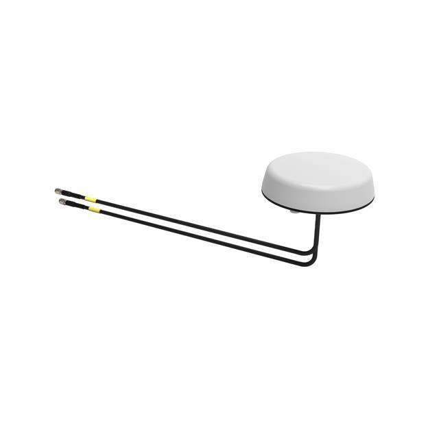

LOW PROFILE MIMO WIFI ANTENNA CEILING MOUNT UP TO 4X4 MIMO DUAL BAND WIFI ANTENNA EN45545-2 CERTIFIED The Low Profile Wifi antenna range has been designed to provide MiMo dual band WiFI coverage in an ultra low profile package. The compact, robust low-profile housing contains up to four antenna elements with effective isolation and low correlation covering 2.4-2.5/4.9-6GHz. The antenna is designed to be ceiling mounted and can be fitted on a conductive or non-conductive panel. Supplied with integrated flame retardant CS32 cables (Compliant to UNECE 118.01 and EN45545-2) and a halogen free flame retardant radome the antenna is suitable for many environments. Technical Drawing LOW PROFILE MIMO WIFI ANTENNA /// DATA SHEET LOW PROFILE MIMO WIFI ANTENNA CEILING MOUNT UP TO 4x4 MIMO DUA BAND WIFI ANTENNA EN45545-2 CERTIFIED Versions 2x 2.4/5.0 GHz 3x 2.4/5.0 GHz 4x 2.4/5.0 GHz 2.4-2.5GHz 4dBi 4dBi 6dBi 4.9-6GHz 5dBi 6dBi 9dBi Electrical Data Peak Gain: Isotropic* Typical VSWR* 12dB Pattern Omni Directional Impedance 50Ω Max Input Power (W) 10W Mechanical Data Dimensions (mm) Diameter 115 (4.52”) Height 30mm (1.18”) Operating Temp ( C) -30 to +70oC (-22 to 158oF) o Material Geloy HRA 222F white Approx Weight (g) 225 gram Regulatory approvals EN45545-2 : HL 1-3 Mounting Data Fixing Panel Mount - 18mm (3/4”) Cable Data Cable Type all feeds CS32 Flame Retardant to UN118.01 / EN6722 / EN45545-2 Diameter 5mm (0.2”) Length Termination 2m (6’) Rev Pol SMA plug 2344721-1 2344721-2 2344721-3 Right Angle N-plug 2344721-4 2344721-5 2344721-6 ᵻ Peak gain simulated with all elements fed on 600x600mm ground plane excluding cable loss * Typical Isolation and VSWR stated as measured with 0.5m (1.5’) of cable LOW PROFILE MIMO WIFI ANTENNA /// DATA SHEET LOW PROFILE MIMO WIFI ANTENNA CEILING MOUNT UP TO 4x4 MIMO DUA BAND WIFI ANTENNA EN45545-2 CERTIFIED Electrical Data Typical VSWR - Elements 1-[3]4* * VSWR measured with 0.5m (1.5’) of CS32 cable Typical Isolation - Elements 1-[3]4* *Isolation measured with 0.5m (1.5’) of CS32 cable Red Plot = Adjacent Elements Green Plot =Opposite Elements Typical 3D Pattern CM4 Ground Plane (2450MHz) Typical 3D Pattern CM4 Ground Plane (5400MHz) Typical 3D Pattern CM4 Free Space (2450MHz) Typical 3D Pattern CM4 Free Space (5400MHz) LOW PROFILE MIMO WIFI ANTENNA /// DATA SHEET
