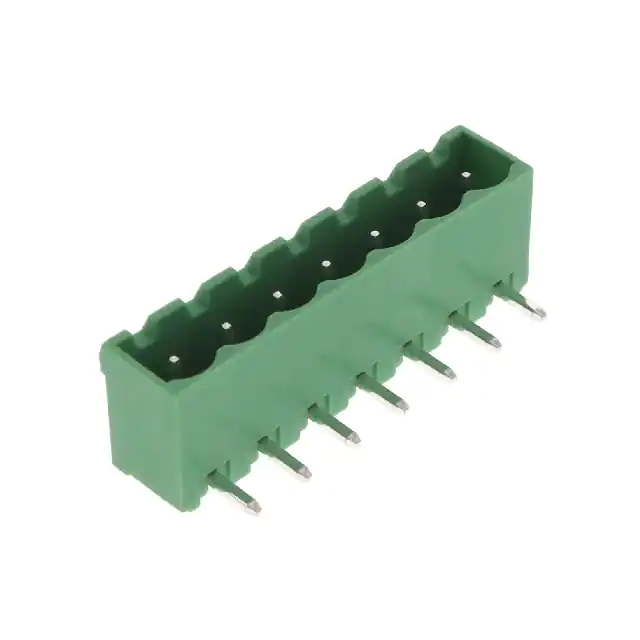

2350513-7 数据手册
4 C 2 3 1 REVISIONS 2019 TE Connectivity. All Rights Reserved. P 1:1 DESCRIPTION LTR A DATE RELEASED FOR PRODUCTION DWN APVD RK 06AUG2019 PS D D 8.3 #0.3 NOTES: 1.0 #0.1 2. MECHANICAL MIN. PC BOARD HOLES DIAMETER : 1.5 mm 5 5.0 #0.1 4.5 #0.3 3.3 #0.3 1. MATERIAL AND FINISH: HOUSING : POLYAMIDE 66, UL94V-0, COLOR GREEN. TERMINAL : COPPER ALLOY, TIN PLATED. 1.8 #0.3 3. ELECTRICAL RATED VOLTAGE RATED CURRENT INSULATION RESISTANCE DIM A±0.5 5 NOT CUMULATIVE TOLERANCE. 81.6 16 1-2350513-6 71.6 14 1-2350513-4 76.6 15 66.6 +0 0 .1 1.8 #0.3 A 5 1. mm RECOMMENDED PC BOARD LAYOUT MATERIAL 1470-19 (3/13) TOLERANCES UNLESS OTHERWISE SPECIFIED: SEE NOTES - 0 1 2 3 4 PLC PLC PLC PLC PLC ANGLES FINISH - PRODUCT SPEC - APPLICATION SPEC - SEE NOTES - - WEIGHT CUSTOMER DRAWING 2350513-4 3 2350513-3 2 NO. OF POS 2350513-2 PART NUMBER TE Connectivity NAME HEADER 90 DEG. 5.00MM PITCH TAIL LENGTH 4.5mm - SIZE - 2350513-5 4 16.6 DIMENSIONS: 2350513-6 5 21.6 DIM A 2350513-7 6 26.6 B 2350513-8 7 31.6 10APR2019 RAGHAVENDRA.K CHK 01JUL2019 KARTHIK.JK APVD 02JUL2019 PRASHANTH.S 2350513-9 8 36.6 DWN 1-2350513-0 9 41.6 THIS DRAWING IS A CONTROLLED DOCUMENT. 1-2350513-1 10 46.6 11.6 1-2350513-2 11 51.6 3.3 #0.3 1-2350513-3 12 56.6 B 1-2350513-5 13 61.6 5.00 C 4. OPERATING TEMPERATURE RANGE: -40 $ C TO +105 $ C 12.0 #0.3 C : 300 V : 16 A : >2000 M Ohm (500V DC) CAGE CODE A3 00779 A DRAWING NO 2350513 SCALE 3:1 SHEET RESTRICTED TO - 1 OF 1 REV A
