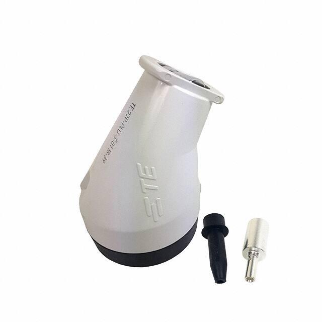

MU27P CONNECTOR SERIES TRAINLINE WIRE CONNECTORS FOR CONTROL AND COMMUNICATIONS The Multiple Unit (MU) connectors include a 27 pin receptacle, plug and “dummy” receptacle that are used to convey the locomotive functions between units. 27 point trainline connectors allow a single point in the train to issue up to 27 commands to all or some of the vehicles simultaneously. TE’s MU27P connectors are used to convey control & indication signals such as door controls and indications, public address, brake applied/released indications as well as audio and other passenger rail functions. Designed to accept three 10 AWG lead with all other leads being 12 AWG or 14 AWG allows the connectors to be completely interchangeable and intermateable with other brands adhering to the AAR-S-512 specification, and are key in preventing intermating of different wiring configurations. Technical Information Electrical Data Rated Current 30 A Service Voltage 600 V DC Material Data Shell Aluminum Crimp Contacts Silver Plated Environmental Data Salt Spray 250 hours Temperature Range -40oC - 110oC (-40oF - 230oF) Mechanical Data 27 pole arrangement 10, 12 or 14 AWG wires Mechanical coding Intermateable with other major brands Manufactured to conform to: AAR S-512 APTA RP-E-017-99 APTA RP-E-019-99 Standards Tested against NF F 61-030 selected criteria Jumper assemblies are available on request. Please contact your TE representative. MU27P CONNECTOR SERIES Trainline Wire Connectors For Control and Communications Available Colors Part Number Description Color 27P-REC-1-01 RECEPTACLE, MU, CONTROL Black 27P-REC-2-01 RECEPTACLE, COMMUNICATION Blue 27P-REC-3-01 RECEPTACLE, TYPICAL OF AEM-7 White 27P-REC-4-01 RECEPTACLE, COMM. COMMUTER Red 27P-PLU-1-01 PLUG, MU, CONTROL 27P-PLU-2-01 PLUG, COMMUNICATION 27P-PLU-3-01 PLUG, TYPICAL AEM-7 27P-PLU-4-01 PLUG, COMMUNICATION COMMUTER 27P-DUM-Y DUMMY RECEPTACLE Yellow 27P-DUM-W DUMMY RECEPTACLE White 27P-KITCON-24P12-3P10 CONTACTS KIT FOR RECEPTACLE 27P-KITCON-24S12-3S10 CONTACTS FOR PLUG Black Blue White Red 7 1/4 5.38 5 3/16 DIA 5.88 *Holes are 7/16 DIA (4x) Note: All dimensions are in Inches © 2018 TE Connectivity. All Rights Reserved. TE, TE Connectivity, and the TE connectivity (logo) are trademarks of the TE Connectivity. Other logos, product and company names mentioned herein may be trademarks of their respective owners. While TE has made every reasonable effort to ensure the accuracy of the information in this brochure, TE does not guarantee that it is error-free, nor does TE make any other representation, warranty or guarantee that the information is accurate, correct, reliable or current. TE reserves the right to make any adjustments to the information contained herein at any time without notice. TE expressly disclaims all implied warranties regarding the information contained herein, including, but not limited to, any implied warranties of merchantability or fitness for a particular purpose. The dimensions in this catalog are for reference purposes only and are subject to change without notice. Specifications are subject to change without notice. Consult TE for the latest dimensions and design specifications. 1-1773930-6 CC 05/2018
