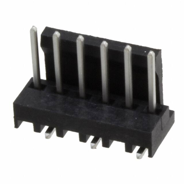

HEADER ASSEMBLY
SCALE 8:1
2.54
TYP
[ .100 ]
B
5.97
[ .235 ]
1.52
[ .060 ]
POST NO. 1
A
1.78
[ .070 ]
PRELIMINARY
0.2 [.008]
34.25 [1.348]
72.00 [2.835]
45.72 [1.800]
18
4- 647502 -8
0.2 [.008]
34.25 [1.348]
72.00 [2.835]
45.72 [1.800]
18
1- 647502 -8
PRELIMINARY
PRELIMINARY
0.2 [.008]
34.25 [1.348]
72.00 [2.835]
43.18 [1.700]
17
4- 647502 -7
0.2 [.008]
34.25 [1.348]
72.00 [2.835]
43.18 [1.700]
17
1- 647502 -7
PRELIMINARY
PRELIMINARY
0.2 [.008]
34.25 [1.348]
72.00 [2.835]
40.64 [1.600]
16
4- 647502 -6
0.2 [.008]
34.25 [1.348]
72.00 [2.835]
40.64 [1.600]
16
1- 647502 -6
PRELIMINARY
PRELIMINARY
0.2 [.008]
34.25 [1.348]
72.00 [2.835]
38.10 [1.500]
15
4- 647502 -5
0.2 [.008]
34.25 [1.348]
72.00 [2.835]
38.10 [1.500]
15
1- 647502 -5
PRELIMINARY
PRELIMINARY
0.2 [.008]
26.20 [1.031]
56.00 [2.205]
35.56 [1.400]
14
4- 647502 -4
0.2 [.008]
26.20 [1.031]
56.00 [2.205]
35.56 [1.400]
14
1- 647502 -4
PRELIMINARY
PRELIMINARY
0.2 [.008]
26.20 [1.031]
56.00 [2.205]
33.02 [1.300]
13
4- 647502 -3
0.2 [.008]
26.20 [1.031]
56.00 [2.205]
33.02 [1.300]
13
1- 647502 -3
PRELIMINARY
PRELIMINARY
0.15 [.006]
26.20 [1.031]
56.00 [2.205]
30.48 [1.200]
12
4- 647502 -2
0.15 [.006]
26.20 [1.031]
56.00 [2.205]
30.48 [1.200]
12
1- 647502 -2
PRELIMINARY
PRELIMINARY
0.15 [.006]
26.20 [1.031]
56.00 [2.205]
27.94 [1.100]
11
4- 647502 -1
0.15 [.006]
26.20 [1.031]
56.00 [2.205]
27.94 [1.100]
11
1- 647502 -1
PRELIMINARY
PRELIMINARY
0.15 [.006]
20.20 [.795]
44.00 [1.732]
25.40 [1.00]
10
4- 647502 -0
0.15 [.006]
20.20 [.795]
44.00 [1.732]
25.40 [1.00]
10
1- 647502 -0
PRELIMINARY
PRELIMINARY
0.15 [.006]
20.20 [.795]
44.00 [1.732]
22.86 [.900]
9
3- 647502 -9
PRELIMINARY
0.15 [.006]
20.20 [.795]
44.00 [1.732]
22.86 [.900]
9
647502 -9
0.15 [.006]
20.20 [.795]
44.00 [1.732]
20.32 [.800]
8
3- 647502 -8
0.15 [.006]
20.20 [.795]
44.00 [1.732]
20.32 [.800]
8
647502 -8
0.15 [.006]
20.20 [.795]
44.00 [1.732]
17.78 [.700]
7
3- 647502 -7
0.15 [.006]
20.20 [.795]
44.00 [1.732]
17.78 [.700]
7
647502 -7
0.15 [.006]
14.20 [.559]
32.00 [1.260]
15.24 [.600]
6
3- 647502 -6
0.15 [.006]
14.20 [.559]
32.00 [1.260]
15.24 [.600]
6
647502 -6
0.15 [.006]
14.20 [.559]
32.00 [1.260]
12.70 [.500]
5
3- 647502 -5
0.15 [.006]
14.20 [.559]
32.00 [1.260]
12.70 [.500]
5
647502 -5
0.15 [.006]
14.20 [.559]
32.00 [1.260]
10.16 [.400]
4
3- 647502 -4
0.15 [.006]
14.20 [.559]
32.00 [1.260]
10.16 [.400]
4
647502 -4
0.15 [.006]
14.20 [.559]
32.00 [1.260]
7.62 [.300]
3
3- 647502 -3
0.15 [.006]
14.20 [.559]
32.00 [1.260]
7.62 [.300]
3
647502 -3
0.15 [.006]
11.50 [.453]
24.00 [.945]
5.08 [.200]
2
3- 647502 -2
0.15 [.006]
11.50 [.453]
24.00 [.945]
5.08 [.200]
2
647502 -2
