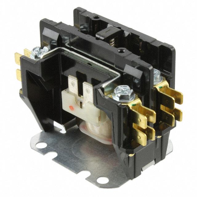

Model 96 - 3100 series Definite Purpose Contactor 1- or 2-pole, 20-40 FLA AC Coil File E75492 File EN60947-4-1:2010; EN60947-1:2007 File LR49598 Users should thoroughly review the technical data before selecting a product part number. It is recommended that users also seek out the pertinent approvals files of the agencies/laboratories and review them to ensure the product meets the requirements for a given application. Features Environmental Data • Robust 1- and 2-pole contactors. • Shunt available on 1-pole models. • Convenient mounting plate. Temperature Range: Storage and Operating: -40°C – +65°C. Flammability: UL 94-HB housing. Mechanical Data Contact Termination: 20, 25, 30 FLA Models Type: #10-32 Screw with quad 0.250” (6.35 mm) quick connects. Wire Size: 16-8 AWG (Stranding must be split for 8 AWG wire.) Tightening Torque: 25 in.-lbs. NOTE: Contactors with terminals of two-piece design are shipped with terminal screws left “up” to facilitate customer wiring. The customer must tighten the screws to the specified torque to achieve a good electrical connection. 40 FLA Models Type: Box Lug with dual 0.250” (6.35 mm) quick connects. Wire Size: 14-4 Cu/Al AWG Tightening Torque: 40 in.-lbs. Coil Termination: Dual 0.250” (6.35 mm) quick connects. Arc Cover: Optional on 20-30 FLA models, standard on 40 FLA models. Weight: One Pole Types: 8 oz. (227 g) approximately. Two Pole Types: 9.6 oz. (273 g) approximately Contact Data @ 25°C Arrangements: 1 Form X (SPST-NO-DM) with or without shunt and 2 Form X (DPST-NO-DM). Maximum Ratings: See Contact Ratings Table. Material: Silver Cadmium Oxide. Coil Data @ 25°C Voltage: 24 - 277 VAC, 50/60 Hz. See Coil Data Table below. (480 & 575VAC coils available upon request.) Insulation Class: UL Class B (130°C). Duty Cycle: Continuous. Contact Ratings Full Load Amps Number of Poles 20 2 25 1 25 2 30 1 30 2 40 1 40 2 Line Voltage Locked Rotor Amps 120 100 80 150 50 40 150 125 100 150 75 50 150 125 100 240 200 160 240 200 160 240/277 480 600 240/277 480 600 240/277 480 600 240/277 480 600 240/277 480 600 240/277 480 600 240/277 480 600 Resistive Amps Rating 30 30 30 30 30 30 35 35 35 40 40 40 40 40 40 50 50 50 50 50 50 Maximum Horsepower Voltage Single Phase 120 2 240 3 120 240 1 2 120 240 2 3 120 240 1 2 120 240 2 3 120 240 2 3 120 240 2 3 Coil Data Nominal Coil Voltage Maximum Pickup Volts Drop-Out Volts Range Nominal Inrush VA @ 50 Hz Nominal Inrush VA @ 60 Hz Nominal Sealed VA @ 50 Hz Nominal Sealed VA @ 60 Hz Nominal DC Resistance - Ohms ± 10% 02-2013, Rev. 0213 www.te.com © 2013 Tyco Electronics Corporation, a TE Connectivity Ltd. company 24 18 6 - 15 22.5 20 7 5.25 16.5 1-Pole Models 120 208/240 88 177 20 - 70 40 - 140 22.5 22.5 20 20 7 7 5.25 5.25 440 1850 EU RoHS/ELV, China RoHS, REACH, Halogen content refer to the Product Compliance Support Center at www.te.com/customersupport/rohssupportcenter 277 221 50 - 165 22.5 20 7 5.25 2250 24 18 6 - 15 37 35 8 7 11 Datasheets and product data is subject to the terms of the disclaimer and all chapters of the ‘Definitions’ section, available at http://relays.te.com/definitions 2-Pole Models 120 208/240 88 177 20 - 70 40 - 140 37 37 35 35 8 8 7 7 250 1000 277 221 50 - 165 37 35 8 7 1600 Datasheets, product data, ‘Definitions’ section, application notes and all specifications are subject to change. 1 Ordering Information Typical Part No. > 3100 - 20 Q 6 999 1. Series: 3100 = 1- or 2-pole, 20-40 FLA contactor 2.Packaging: Y = Individual Pack - = Bulk Pack A-ZZZ = Customer specific information (assigned by factory) 3.Pole Configuration: 10 = 1 Form X (SPST-NO-DM) 15 = 1 Form X (SPST-NO-DM) with Shunt 20 = 2 Form X (DPST-NO-DM) 4.Coil Voltage (50/60 Hz.): T = 120VAC U = 208/240VAC Q = 24VAC P = 100VAC S = 200VAC V = 277VAC 5.Contact Ratings (Inductive): 1 = 25 FLA on 1-pole models 3 = 20 FLA on 2-pole models 5 = 25 FLA on 2-pole models 2 = 30 FLA on 1-pole models 6 = 30 FLA on 2-pole models 14 = 35 FLA on 1-pole models 19 - 40 FLA on 1-pole models 18 = 40 FLA on 2-pole models 6.Customer ID Suffix: 999 = Standard Model 000-998 = Factory assigned customer ID 7.Option Code: Leave Blank = No customer-specific options A - ZZ = Factory assigned customer-specific options. Standard part numbers listed below are more likely to be available from stock. 3100-15Q2999 3100-15T2999 3100-15U2999 3100-20Q6999 3100-20T6999 3100-20U6999 3100-20Q18999CL 3100-20T18999CL 3100-20U18999CL Outline Dimensions Termination Options 2.10 Max. (53.3) 1-Pole .253 (6.43) 3.30 (83.8) 2.445 (62.1) 1.625 (41.3) 2.00 (50.8) .215 TYP (5.46) 2.541 (64.5) Standard on 20, 25, 30, 35 FLA #10-32 Combination Phillips, Slotted & 5/16 Hex Head #12 Washer Special on 20, 25, 30, 35 FLA #10-32 Sems Screw with Pressure Plate Standard on 40 FLA Lug accepts 14-4 Cu/Al AWG 2.10 Max. (53.3) 2-Pole 3.30 (83.8) 2.445 (62.1) 1.625 .875 (41.28) (22.2) 2.313 (57.75) 1.625 .875 (41.28) (22.2) 2.313 (57.75) 1.625 (41.3) 2.00 (50.8) .215 TYP (5.46) 2.610 (66.3) ORDERING NOTE: “Standard” terminals need not be specified in the “Ordering Information” chart above. “Special” terminals are offered on a special order basis. Special order items may be subject to extended leadtimes and significant minimum order quantities. Your TE sales engineer must consult with the factory before providing price and availability information regarding items with these options. 2 02-2013, Rev. 0213 www.te.com © 2013 Tyco Electronics Corporation, a TE Connectivity Ltd. company EU RoHS/ELV, China RoHS, REACH, Halogen content refer to the Product Compliance Support Center at www.te.com/customersupport/rohssupportcenter Datasheets and product data is subject to the terms of the disclaimer and all chapters of the ‘Definitions’ section, available at http://relays.te.com/definitions Datasheets, product data, ‘Definitions’ section, application notes and all specifications are subject to change.
