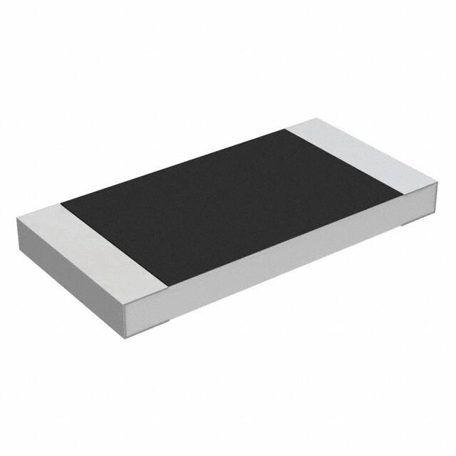

SMD Power Resistors Type 3520 Series Key Features I 1 Watt at 70°C I Small Size to Power Ratio I Supplied on Tape I Available via Distribution I Value Marked on Resistor I 400 Volt Maximum Overload I 200 Volt Working Voltage I Laboratory Kit Available I Low Profile TE Connectivity is pleased to introduce this low cost high power device, suitable for auto placement in volume, and for most applications, including high frequency operations, owing to the short lead structure. It is attractively priced and available on 7" reels of 4000 pieces. Characteristics - Electrical Power Rating: 1 Watt at 70°C** Max. RCWV*: 200V Max. Overload Voltage: 400V Resistance Tolerance(%): ±5% Resistance Range: 1R0 - 1M0 Temperature Coefficient: ±200ppm ±350ppm**(below 10R) Resistance Grid Value: E-24 * Rated continuous working voltage (RCWV) shall be determined from RCWV = Rated Power x Resistance Value, or Maximum RCWV listed above, whichever is less ** Recommended Circuit Board Design - If this device is anticipated to run at full continuous power then action to improve the cooling should be taken. This can be a metal substrate, copper pad left under the chip, an opening in the PCB or enlarged silver conductor pads each end. Power Derating Curve 100 Rated Power (%) 80 60 40 20 0 -55 -40 -20 0 20 40 60 70 80 100 120 125 Ambient Temperature (°C) For resistors operated in ambient temperatures above 70°C, power rating must be derated in accordance with this curve. 1773139 CIS BI 10/2011 Dimensions are in millimeters and inches unless otherwise specified. Values in brackets are standard equivalents. Dimensions are shown for reference purposes only. Specifications subject to change. For email, phone or live chat, go to: te.com/help SMD Power Resistors Type 3520 Series Dimensions L a W t b L W a b t 6.40 ±0.20 3.20 ±0.20 0.70 ±0.10 0.70 ±0.20 0.60 ±0.10 Handling Recommendations When flow soldering - the land width must be smaller than the Chip Resistor width to properly control the solder application. Generally, the land width can be Chip Resistor width (W) x 0.7 to 0.8. When reflow soldering - solder application amount can be adjusted. Thus the land width can be set to W x 1.0 to 1.3. How to Order 3520 1K0 J T Common Part Resistance Value Tolerance Pack Style J - 5% T - 4000 / reel 1 ohm 1000 milli ohms 1R0 3520 1K ohm 1000 ohms 1K0 1 Meg ohm 1000000 ohms 1M0 TE Connectivity, TE connectivity (logo) and TE (logo) are trademarks. Other logos, product and Company names mentioned herein may be trademarks of their respective owners. While TE has made every reasonable effort to ensure the accuracy of the information in this datasheet, TE does not guarantee that it is error-free, nor does TE make any other representation, warranty or guarantee that the information is accurate, correct, reliable or current. TE reserves the right to make any adjustments to the information contained herein at any time without notice. TE expressly disclaims all implied warranties regarding the information contained herein, including, but not limited to, any implied warranties of merchantability or fitness for a particular purpose. The dimensions in this datasheet are for reference purposes only and are subject to change without notice. Specifications are subject to change without notice. Consult TE for the latest dimensions and design specifications.
352015RJT
1. 物料型号:TE Connectivity SMD Power Resistors Type 3520 Series。 2. 器件简介:这是一种低成本、高功率的设备,适合大规模自动放置,适用于包括高频操作在内的大多数应用场景。 3. 引脚分配:文档中没有明确提到引脚分配,但提到了器件的短引脚结构,适合高频操作。 4. 参数特性: - 功率等级:70°C时1瓦特 - 最大额定工作电压(RCWV):200V - 最大过载电压:400V - 电阻公差:±5% - 电阻范围:1R0至1M0 - 温度系数:±200ppm(10R以下为+350ppm) - 电阻网格值:E-24 5. 功能详解:文档提供了推荐电路板设计,以改善在全连续功率下运行时的散热情况,例如使用金属基板、铜垫、PCB开口或扩大的银导电垫。 6. 应用信息:适用于需要高功率和高频率操作的应用,且价格具有吸引力。 7. 封装信息:提供了详细的尺寸信息,包括宽度、长度和高度,以及公差。
