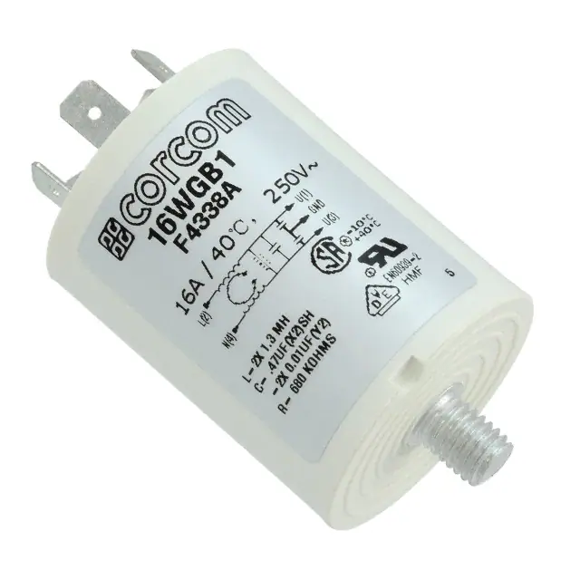

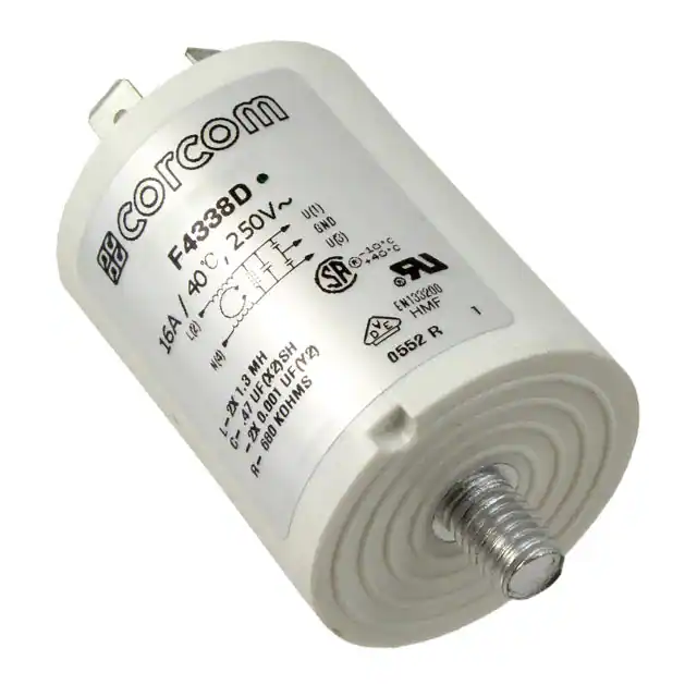

Catalog: 1654001 Issue Date: 06.2011 Corcom Product Guide High Performance, Low Cost Filter Ideal for Appliance Equipment WG Series UL Recognized CSA Certified VDE Approved 1 RFI Power Line Filters WG_1 Style WG Series Specifications • Cost-effective • Tubular design • WGA, WGB and WGC versions designed to comply with leakage current for fixed appliances not easily moved from one place to another • WGD, WGE and WGF versions designed to comply with leakage current requirements for appliances which may be easily moved from one place to another • Available in a variety of styles Ordering Information 16 WG A 1 Maximum leakage current each Line to Ground: A, B & C Models D, E & F Models .76 mA 1.27 mA .10 mA .20 mA @ 120 VAC 60 Hz: @250 VAC 50 Hz: Hipot rating (one minute): Line to Ground: Line to Line: 2250 VDC 1450 VDC Rated Voltage (max): 250 VAC Operating Frequency: 50/60 Hz Rated Current: 16A Operating Ambient Temperature Range (at rated current Ir): -10°C to +40°C In an ambient temperature (Ta) higher than +40°C the maximum operating current (Io) is calculated as follows: Io = Ir (85-Ta)/45 Electrical Schematics Input / Output Style 1 – .250 [6.3] spade terminals 3 – Wire Leads 7 – RAST 5 connection Leakage Current & Performance A, B & C: for fixed appliances A = Standard B = Enhanced C = High performance D, E & F: for mobile appliances D = Standard E = Enhanced F = High performance WG Series Current Rating 16A L (2) U (1) GND N(4) U (3) With RAST 5 Connector (style 7) L GND N Available Part Numbers 16WGA1 16WGB1 16WGC1 16WGD1 16WGE1 16WGF1 16WGA3 16WGB3 16WGC3 16WGD3 16WGE3 16WGF3 16WGA7 16WGB7 16WGC7 16WGD7 16WGE7 16WGF7 89 Dimensions are in inches and millimeters unless otherwise specified. Values in italics are metric equivalents. Dimensions are shown for reference purposes only. Specifications subject to change. For email, phone or live chat, please go to te.com/help corcom.com Catalog: 1654001 Issue Date: 06.2011 Corcom Product Guide High Performance, Low Cost Filter for Appliance Equipment (continued) WG Series Case Styles WG_1 .386 9.80 WG_3 2.46 max. 62.5 .386 9.80 .46 max. 11.7 2.0 max. 50.8 4.0 min. 101.6 1.49 Dia. 37.8         WG_7 .386 9.80  2.4 max. 60.96 .352 min. 8.94 1.49 Dia. 37.8     1.49 Dia. 37.8                  WG_7 Style 90 Dimensions are in inches and millimeters unless otherwise specified. Values in italics are metric equivalents. Dimensions are shown for reference purposes only. Specifications subject to change. For email, phone or live chat, please go to te.com/help corcom.com Catalog: 1654001 Issue Date: 06.2011 Corcom Product Guide High Performance, Low Cost Filter for Appliance Equipment (continued) WG Series Performance Data Typical Insertion Loss 1 Measured in closed 50 Ohm system All Case Styles 16WGB 16WGC 16WGD db 100 db 100 db 100 db 100 90 90 90 90 80 80 80 80 70 70 70 70 60 60 60 60 50 50 50 50 40 40 40 40 30 30 30 30 20 20 20 20 10 10 10 0 0.01 0.1 1 0 10 30 Frequency in MHz 0.01 0.1 16WGE 16WGF db 100 db 100 90 90 80 80 70 70 60 60 50 50 40 40 30 30 20 20 10 0 1 10 30 Frequency in MHz 0 RFI Power Line Filters 16WGA 10 0.01 0.1 1 0 10 30 Frequency in MHz 0.01 0.1 1 10 30 Frequency in MHz Common Mode / Asymmetrical (L-G) Differential Mode / Symmetrical (L-L) 10 0.01 0.1 1 0 10 30 Frequency in MHz 0.01 0.1 1 10 30 Frequency in MHz Minimum Insertion Loss Measured in closed 50 Ohm system Common Mode / Asymmetrical (Line to Ground)  Differential Mode / Symmetrical (Line to Line)                                                                                                                                                              91 Dimensions are in inches and millimeters unless otherwise specified. Values in italics are metric equivalents. Dimensions are shown for reference purposes only. Specifications subject to change. For email, phone or live chat, please go to te.com/help corcom.com
