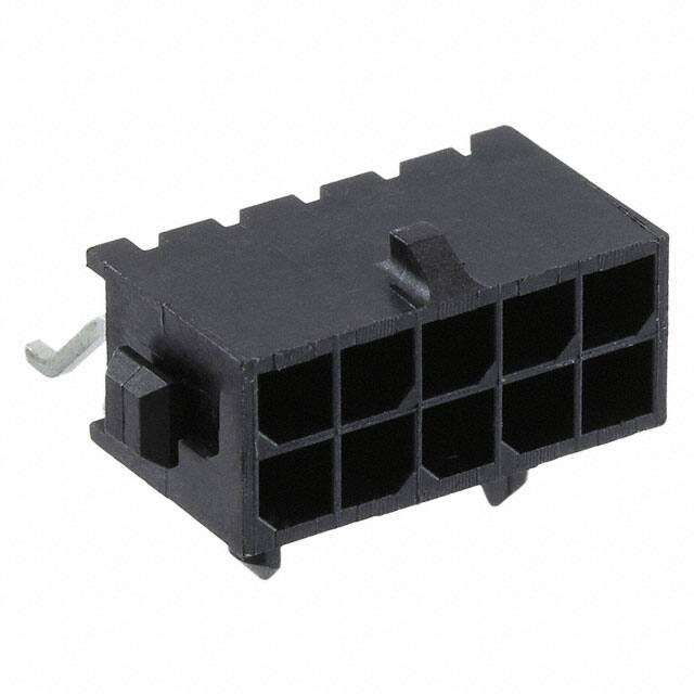

    CONN HEADER SMD R/A 10POS 3MM
4-794623-0 数据手册
MICRO MATE-N-LOK CONNECTOR SYSTEM Quick Reference Guide The Micro MATE-N-LOK 3 mm connector system offers wire-to-wire and wire-to-board connections with contacts on a 3 mm (0.118) centerline and current ratings up to 5 Amps max. per line. Both single-row and dual-row configurations are available. Crimp, snap-in pin and receptacle contacts are used to terminate 30-18 (0.05-0.9 mm2) AWG wire with insulation diameters up to 1.52 mm. Plug and receptacle housings allow wire-to-wire and wire-to-panel configurations and header assemblies offer wire-to-board connections in vertical and right angle configurations. These IR reflow process compatible headers are available in through-hole and surface mount configurations with multiple board mount options. FEATURES AND BENEFITS • Wire-to-wire and wire-to-board pin and receptacle connector system • Contacts are on 3 mm centerline spacing and are available in strip form or loose piece • Panel mount or free-hanging versions • Dual beam receptacle contact design for improved reliability • PCB mount pin header assemblies available in both vertical and right angle styles and surface mount or through hole versions • Available in low profile design (
