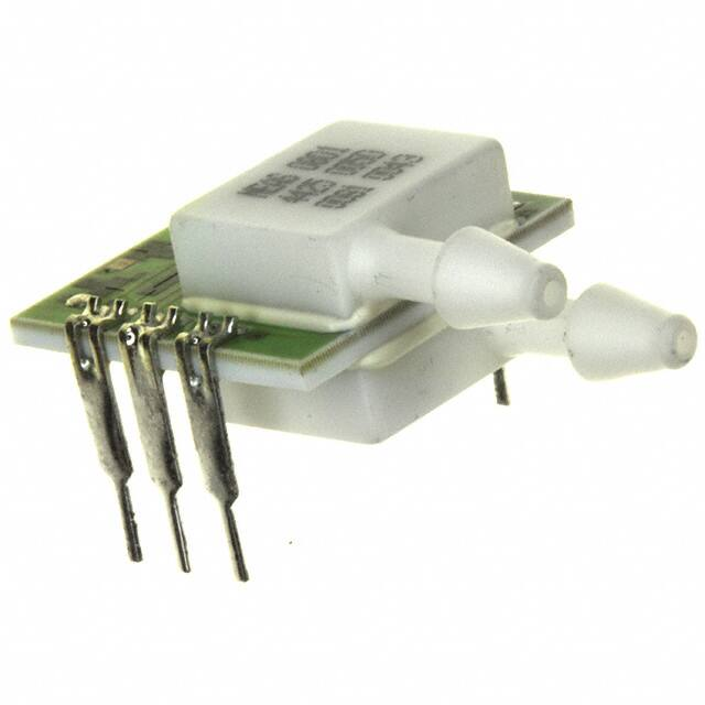

MS4425 SPECIFICATIONS      PC Board Mountable Pressure Sensor 0-100 mV Output Voltage Excitation Differential, Gage, and Absolute Temperature Compensated The MS4425 is a temperature compensated, piezoresistive silicon pressure sensor packaged in a dual-in- line configuration and intended for cost sensitive applications where excellent performance and long-term stability are required. Integral temperature compensation is provided over a range of 0-50°C using laser-trimmed resistors. The pressure sensor is available in absolute, gage or differential pressure ranges from 0-1 to 0-300 psi. The pressure ports are 1/8” barbed ports which mate with 3/32” ID tubing. These tubes are parallel to the printed circuit board to allow other boards to be located above the sensor. For a vertical mounted tube in gage or absolute pressure, refer to the MS4426. SENSOR SOLUTIONS /// MS4425 06/2017 Page 1 MS4425 FEATURES Dual-in-Line Package 0ºC to 50ºC Compensated Temperature Range ±0.15% Pressure Non Linearity Solid State Reliability APPLICATIONS Medical Instruments Altitude and Airspeed Measurements Process Control Factory Automation Leak Detection STANDARD RANGES Range 0 to 1 0 to 5 0 to 15 0 to 30 0 to 50 0 to 100 0 to 150 0 to 300 SENSOR SOLUTIONS /// MS4425 psid         psig         06/2017 psia       Page 2 MS4425 PERFORMANCE SPECIFICATIONS Supply Voltage: 12V Ambient Temperature: 25°C (unless otherwise specified) Pressure applied to Port 2 PARAMETERS MIN TYP MAX UNITS NOTES Span (0-1 psi) 17.6 18 18.4 mV 1 Span (0-5 psi) 58 60 62 mV 1 Span (0-15 to 0-50 psi) 88 90 92 mV 1 Span (0-100 & 0-300 psi) 98 100 102 mV 1 Span (0-150 psi) 148 150 152 mV 1 -1 ±0.2 1 mV 1 Zero Pressure Output Pressure Non Linearity (Gage & Absolute) -0.15 0.15 % Span 2 Pressure Non Linearity (Differential) -0.25 0.25 % Span 2 Pressure Hysteresis -0.20 0.20 % Span KΩ Input Resistance ±0.05 5 15 25 3500 5000 6500 Ω -1 0.3 1 % Span 3 -0.75 ±0.2 0.75 mV 3 12 20 V mV 4 Pressure Overload (Differential) 3X Rated 5 Common Mode Pressure 400 psi Output Resistance Temperature Error – Span Temperature Error – Zero Supply Voltage Long Term Stability (Offset & Span) ±0.1 Compensated Temperature Operating Temperature 0 50 ºC -25 85 ºC Storage Temperature -40 125 ºC 0 85 % RH 3 grams Humidity Weight Solder Temperature 260ºC Max 5 Sec. Media Non-Corrosive Dry Gases Compatible with Silicon, Pyrex, RTV, Ceramic & Gold 6 Notes 1. Ratiometric to supply voltage. 2. Best fit straight line. Non linearity for 5 psi Differential devices is 0.75%. 3. Maximum temperature error between 0°C and 50°C with respect to 25°C. For errors beyond the compensated temperature, see Temperature Error Multiplier Chart below. 4. Long term stability over a one year period with constant voltage and temperature. 5. 3X or 400 psi max, whichever is less. 6. For more details refer to 4425/4426 Mounting Application Note. SENSOR SOLUTIONS /// MS4425 06/2017 Page 3 MS4425 2.5 2.0 1.5 1.0 0.5 0.0 -25 -10 5 20 35 50 65 80 95 110 125 DIMENSION SENSOR SOLUTIONS /// MS4425 06/2017 Page 4 MS4425 SENSOR SOLUTIONS /// MS4425 06/2017 Page 5 MS4425 CONNECTIONS PACKAGE STYLE, PINOUT, AND PORT DESIGNATION SENSOR SOLUTIONS /// MS4425 06/2017 Page 6 MS4425 ORDERING INFORMATION 4425 - 005 D F Coating (F - Gel Fill, Blank = No Coating) Type (D = Differential, A = Absolute, G = Gage) Pressure Range Model NORTH AMERICA EUROPE ASIA Measurement Specialties, Inc., a TE Connectivity company Tel: 800-522-6752 Email: customercare.frmt@te.com Measurement Specialties (Europe), Ltd., a TE Connectivity Company Tel: 800-440-5100 Email: customercare.bevx@te.com Measurement Specialties (China) Ltd., a TE Connectivity company Tel: 0400-820-6015 Email: customercare.shzn@te.com TE.com/sensorsolutions Measurement Specialties, Inc., a TE Connectivity company. Measurement Specialties, TE Connectivity, TE Connectivity (logo) and EVERY CONNECTION COUNTS are trademarks. All other logos, products and/or company names referred to herein might be trademarks of their respective owners. The information given herein, including drawings, illustrations and schematics which are intended for illustration purposes only, is believed to be reliable. However, TE Connectivity makes no warranties as to its accuracy or completeness and disclaims any liability in connection with its use. TE Connectivity‘s obligations shall only be as set forth in TE Connectivity‘s Standard Terms and Conditions of Sale for this product and in no case will TE Connectivity be liable for any incidental, indirect or consequential damages arising out of the sale, resale, use or misuse of the product. Users of TE Connectivity products should make their own evaluation to determine the suitability of each such product for the specific application. © 2015 TE Connectivity Ltd. family of companies SENSOR SOLUTIONS /// MS4425 All Rights Reserved. 06/2017 Page 7
