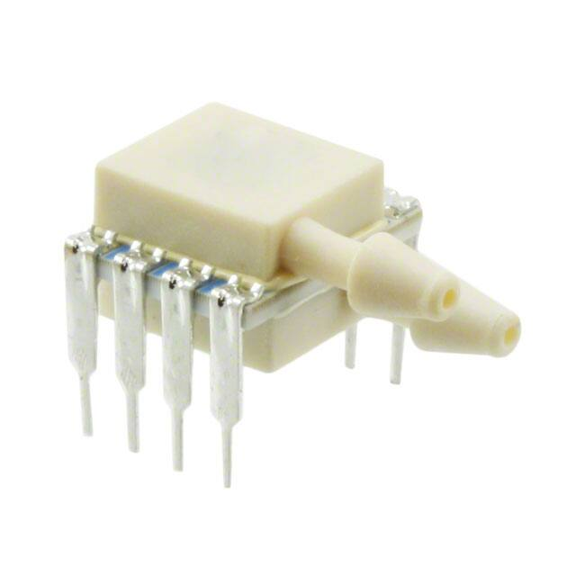

    SENSOR PRESS DIFF 1.08PSI 8DIP
4515DO-DS3BK030DPL 数据手册
MS4515DO SPECIFICATIONS         FEATURES     Inches H2O Pressure Ranges PCB Mountable Digital Output Barbed Pressure Ports APPLICATIONS        Blocked Filter Detection Altitude and Airspeed Measurements Medical Instruments Fire Suppression System Panel Meter Air Movement/Environmental Controls Pneumatic Controls SENSOR SOLUTIONS /// MS4515DO PCB Mounted Digital Output Transducer Combination Temperature and Pressure Pressure Ranges from 2 to 30 inches H2O I2C or SPI Protocol Differential & Gage Temperature Compensated 3.3 or 5.0 VDC Supply Voltage Low Power Option Available (standby < 1µA) The MS4515DO is a small, ceramic based, PCB mounted pressure transducer from TE Connectivity. The transducer is built using the latest CMOS sensor conditioning circuitry to create a low cost, high performance digital output pressure (14bit) and temperature (11bit) transducer designed to meet the strictest requirements from OEM customers. The MS4515DO is fully calibrated and temperature compensated with a total error band (TEB) of less than 1.0% over the compensated range. The sensor operates from single supply of either 3.3 or 5.0VDC and requires a single external component for proper operation. The rugged ceramic transducer is available in side port, top port, and manifold mount and can measure gage or differential pressure from 2 to 30 inches H2O. The 1/8” barbed pressure ports mate securely with 3/32” ID tubing. 08/2018 Page 1 MS4515DO STANDARD RANGES (INCHES H2O) Range 2 4 5 10 20 30 Gage DS, SS, TP, MM DS, SS, TP, MM DS, SS, TP, MM DS, SS, TP, MM DS, SS, TP, MM Differential DS, SS, TP, MM DS, SS, TP, MM DS, SS, TP, MM DS, SS, TP, MM DS, SS, TP, MM DS, SS, TP, MM Option Availability -L -L -L -F, -L, -M -F, -L, -M -F, -L, -M See Package Configurations: DS= Dual Side Port, SS= Single Side Port, TP= Top Port, MM= Manifold Mount Only I2C Protocol is Available on “L” type Pin Styles; Reference Ordering Information for Details Pin Style “L” is only available SS and MM port types. Pin Style “C” is only available SS, TP and MM port types. BLOCK DIAGRAM SENSOR SOLUTIONS /// MS4515DO 08/2018 Page 2 MS4515DO ABSOLUTE MAXIMUM RATINGS Parameter Supply Voltage Output Current Storage Temperature Humidity Overpressure Burst Pressure ESD Solder Temperature Conditions TA = 25 °C TA = 25°C TA = 25°C TA = 25 °C, both Ports TA = 25 °C, Port 1 HBM Min 2.7 Max 5.5 3 -40 +125 95 Not to Exceed 300 -4 +4 250°C, 5 sec max. Unit V mA °C %RH psi psi kV Notes Non Condensing See Table 1 EN 61000-4-2 TABLE 1: BURST PRESSURE BY RANGE AND PACKAGE STYLE Style DS,MM SS,TP Port Port 1 Port 2 Port 1 002 10 10 004 10 10 10 005 10 10 10 010 10 10 10 020 10 10 10 030 20 20 20 Unit PSI PSI PSI ENVIRONMENTAL SPECIFICATIONS Parameter Mechanical Shock Mechanical Vibration Thermal Shock Life MTTF SENSOR SOLUTIONS /// MS4515DO Conditions Mil Spec 202F, Method 213B, Condition C, 3 Drops Mil Spec 202F, Method 214A, Condition 1E, 1Hr Each Axis 100 Cycles over Storage Temperature, 30 minute dwell 1 Million FS Cycles >10Yrs, 70 ºC, 1.188 Million Pressure Cycles, 120%FS Pressure 08/2018 Page 3 MS4515DO PERFORMANCE SPECIFICATIONS Supply Voltage1: 5.0V or 3.3 VDC Reference Temperature: 25°C (unless otherwise specified) PARAMETERS Output Span MIN TYP MAX 51E 3AE0 1EB 3EB 31EA 3333 347A 3852 3998 3AE0 UNITS NOTES Count Hex 1,2,3 %Span 1,2,3 Pressure Accuracy -0.25 0.25 %Span 2 Total Error Band (TEB) -1.0 1.0 %Span 3,7 TEB (4inH20 and Below) -2.0 2.0 %Span 3,7 Temperature Accuracy 1.5 ºC 4 Supply Current 3 mA 7 ±0.5 %Span Load Resistance (RL) kΩ 10 Long Term stability (Offset & Span) Compensated Temperature 0 +60 ºC Operating Temperature -10 +85 ºC 14 bits 11 bits Output Pressure Resolution Output Temperature Resolution Update Time 8 0.5 5 ms 6 Start Time to Data Ready 8.4 ms 6 Weight 3 grams Media Non-Corrosive Dry Gases Compatible with Ceramic, Silicon, Borosilicate Glass, RTV, Gold, Aluminum and Epoxy. See “Wetted Material by Port Designation” chart below. Notes 1. Proper operation requires an external capacitor placed as shown in Connection Diagram. Output is not ratiometric to supply voltage. 2. The maximum deviation from a best fit straight line (BFSL) fitted to the output measured over the pressure range at 25C. Includes all errors due to pressure non linearity, hysteresis, and non-repeatability. 3. Total pressure error band includes all accuracy errors, thermal errors over the compensated temperature range and span and offset calibration tolerances. For ideal sensor output with respect to input pressure and temperature, reference Transfer Function charts below. TEB values are valid only at the calibrated supply voltage. 4. The deviation from a best fit straight line (BFSL) fitted to the output measured over the compensated temperature range. 5. For errors beyond the compensated temperature range, see Extended Temperature Multiplier chart below. 6. Start time to data ready is the time to get valid data after POR (power on reset). The time to get subsequent valid data is then specified by the update time specification. 7. This product can be configured for custom OEM requirements, contact factory for lower power consumption or higher accuracy. CONNECTION DIAGRAM Notes 1. Place 100nF capacitor between Supply and GND to within 2 cm of sensor. SENSOR SOLUTIONS /// MS4515DO 08/2018 Page 4 MS4515DO PRESSURE AND TEMPERATURE TRANSFER FUNCTION Sensor Output at Significant Percentages % of Count Output Type A (inH20) 0 PMIN-(PMAX-PMIN)*10/80 5 10 PMIN 50 90 PMAX 95 100 PMAX+(PMAX-PMIN)*10/80 Output Type B (inH20) PMIN-(PMAX-PMIN)*5/90 PMIN PMAX PMAX+(PMAX-PMIN)*5/90 Digital Counts (decimal) 0 819 1638 8192 14746 15563 16383 Digital Counts (hex) 0X0000 0X0333 0X0666 0X2000 0X399A 0X3CCB 0X3FFF Temperature Output vs Counts OUTPUT (°C) -50 0 10 25 50 85 150 SENSOR SOLUTIONS /// MS4515DO Digital Count (decimal) 0 511 614 767 1023 1381 2047 08/2018 Digital Counts (hex) 0X0000 0X01FF 0X0266 0X02FF 0X03FF 0X0565 0X07FF Page 5 MS4515DO EXTENDED TEMPERATURE MULTIPLIER CHART 2.5 2.0 1.5 1.0 0.5 0.0 -10 0 10 20 30 40 50 60 70 80 90 PACKAGE, PINOUT & PRESSURE TYPE CONFIGURATION SENSOR SOLUTIONS /// MS4515DO 08/2018 Page 6 MS4515DO Pin Name GND SUPPLY SDA MISO SCL SCLK INT SS Pin 1 2 3 4 5 6-8 Function Ground Positive Supply Voltage I2C Data SPI Data I2C Clock SPI Clock I2C Interrupt SPI Chip Select No Connection INT is not available for Pin Style “L” models Pressure Type Differential/ Bidirectional Gauge Pmin Pmax -Prange +Prange 0psiG +Prange Description Output is proportional to the difference between Port 1 and Port 2. Output swings positive when Port 1> Port 2. Output is 50% of total counts when Port 1=Port 2 Output is proportional to the difference between 0psiG (P min) and Port 1. Output swings positive when Port 1> Port 2. Prange is equal to the maximum full scale pressure specified in the ordering information. Standard Range (inH2O) by port style WETTED MATERIAL BY PORT DESIGNATION Style DS, MM SS, TP, SM Port Port 1 Port 2 Port 1 Ceramic X X X Silicon X X X Material Borosilicate Glass RTV X X X X X X Gold Aluminum X X X X Epoxy X X X "X” Indicates Wetted Material SENSOR SOLUTIONS /// MS4515DO 08/2018 Page 7 MS4515DO I2C INTERFACE I2C Interface Parameters 1 Parameters Symbol Min SCLK Clock Frequency FSCL 100 Start Condition hold time relative to SCL edge tHDSTA 0.1 µs Minimum SCL clock low width 1 tLOW 0.6 µs Minimum SCL clock high width tHIGH 0.6 µs Start Condition Setup time relative to SCL edge tSUSTA 0.1 µs Data hold time on SDA relative to SCL edge tHDDAT 0 µs Data setup time on SDA relative to SCL edge tSUDAT 0.1 µs Stop condition setup time on SCL tSUSTO 0.1 µs Bus free time between stop and start condition tBUS 2 µs 1 Typ Max Units 400 kHz combined low and high widths must equal or exceed minimum SCL period SENSOR SOLUTIONS /// MS4515DO 08/2018 Page 8 MS4515DO SPI INTERFACE SPI Interface Parameters Parameters Symbol Min SCLK Clock Frequency FSCL 50 SS Drop to First clock edge tHDSS 2.5 µs Minimum SCL clock low width @1 tLOW 0.6 µs Minimum SCL clock high width @1 tHIGH 0.6 µs Clock Edge to data transition tCLKD 0 Rise of SS relative to last clock edge tSUSS 0.1 µs Bus free time rise and fall of SS tBUS 2 µs Typ Max Units 800 kHz 0.1 µs @1 combined low and high widths must equal or exceed minimum SCLK period SENSOR SOLUTIONS /// MS4515DO 08/2018 Page 9 MS4515DO DIMENSIONS Dimensions are in INCHES [mm] Model: MS4515DO-DSvoixxxyP Model: MS4515DO-DSvoixxxyS SENSOR SOLUTIONS /// MS4515DO 08/2018 Page 10 MS4515DO Model: MS4515DO-SSvoixxxyP Model: MS4515DO-SSvoixxxyS SENSOR SOLUTIONS /// MS4515DO 08/2018 Page 11 MS4515DO Model: MS4515DO-TPvoixxxyP Model: MS4515DO-TPvoixxxyS SENSOR SOLUTIONS /// MS4515DO 08/2018 Page 12 MS4515DO Model: MS4515DO-SSvoixxxyL Model: MS4515DO-MMvoixxxyL SENSOR SOLUTIONS /// MS4515DO 08/2018 Page 13 MS4515DO Model: MS4515DO-MMvoixxxyP Model: MS4515DO-MMvoixxxyS SENSOR SOLUTIONS /// MS4515DO 08/2018 Page 14 MS4515DO Model: MS4515DO-SSvoixxxyC Model: MS4515DO-TPvoixxxyC SENSOR SOLUTIONS /// MS4515DO 08/2018 Page 15 MS4515DO Model: MS4515DO-MMvoixxxyC SENSOR SOLUTIONS /// MS4515DO 08/2018 Page 16 MS4515DO APPLICATION NOTES Measurement Specialties offers a comprehensive selection of product support documentation. MS45xx Series Application Note  Bypass Capacitor Selection  Pressure Hose Recommendations  PCB Layout Recommendations Interfacing to MEAS Digital Pressure Modules  I2C or SPI Protocol Description  Data Fetch, Measurement Request Commands  Timing Diagrams Configuration, POR and Power Consumption  Standard and Low Power Configuration  Power On Reset (POR)  Current Consumption by Sampling Frequency AVAILABLE OPTIONS Gel Coat (-F Option) The MS4515DO is designed for non-ionic and clean dry air applications. Select this option for added protection in high humidity or slightly corrosive environments with the application of a silicone gel elastomer to sensor and ASIC. For questions concerning media compatibility, contact the factory. Low Power (-L Option) Select this option for battery powered or handheld device applications. In this configuration, the sensor and calibration microcontroller are powered down, drawing a current of ~ 0.6uA (Vs=5.0 VDC). When the master sends a Read MR (measurement request) command (I2C or SPI); the sensor is “awaken” and begins the measurement cycle; data is then placed onto the output registers. The sensor and calibration microcontroller are powered down again, awaiting the Read DF (data fetch) command from the master. SENSOR SOLUTIONS /// MS4515DO 08/2018 Page 17 MS4515DO ORDERING INFORMATION 4515DO – DS 3 B K 030 D P M Package Type SS Single Sideport DS Dual Sideport TP Top Port MM Manifold Mount Option Type [Blank] No Option F* Gel Coating L Low Power M* Gel Coat & Low Power * Options available for pressure ranges ≥10inH2O Supply Voltage 3.3 VDC 3 5 5.0 VDC Pin Type P Thru Hole S J Lead L In Line C Castellation Output Type A 10% to 90% B 5% to 95% Pressure Type Differential D Gauge G Interface Type I I2C (Addr. 0x28H) J I2C (Addr. 0x36H) K I2C (Addr. 0x46H) S SPI (Not available for ‘L’ pin Style) 0 I2C (Addr. 0x48H) : : 9 I2C (Addr. 0x51H) NORTH AMERICA Measurement Specialties, Inc., a TE Connectivity company Tel: +1 800-522-6752 Email: customercare.frmt@te.com Pressure Range [inH2O] 002 004 005 010 020 030 EUROPE ASIA Measurement Specialties (Europe), Ltd., a TE Connectivity Company Tel: +31 73 624 6999 Email: customercare.bevx@te.com Measurement Specialties (China) Ltd., a TE Connectivity company Tel: +86 0400-820-6015 Email: customercare.shzn@te.com TE.com/sensorsolutions Measurement Specialties, Inc., a TE Connectivity company. Measurement Specialties, TE Connectivity, TE Connectivity (logo) and EVERY CONNECTION COUNTS are trademarks. All other logos, products and/or company names referred to herein might be trademarks of their respective owners. The information given herein, including drawings, illustrations and schematics which are intended for illustration purposes only, is believed to be reliable. However, TE Connectivity makes no warranties as to its accuracy or completeness and disclaims any liability in connection with its use. TE Connectivity‘s obligations shall only be as set forth in TE Connectivity‘s Standard Terms and Conditions of Sale for this product and in no case will TE Connectivity be liable for any incidental, indirect or consequential damages arising out of the sale, resale, use or misuse of the product. Users of TE Connectivity products should make their own evaluation to determine the suitability of each such product for the specific application. © 2015 TE Connectivity Ltd. family of companies SENSOR SOLUTIONS /// MS4515DO All Rights Reserved. 08/2018 Page 18
