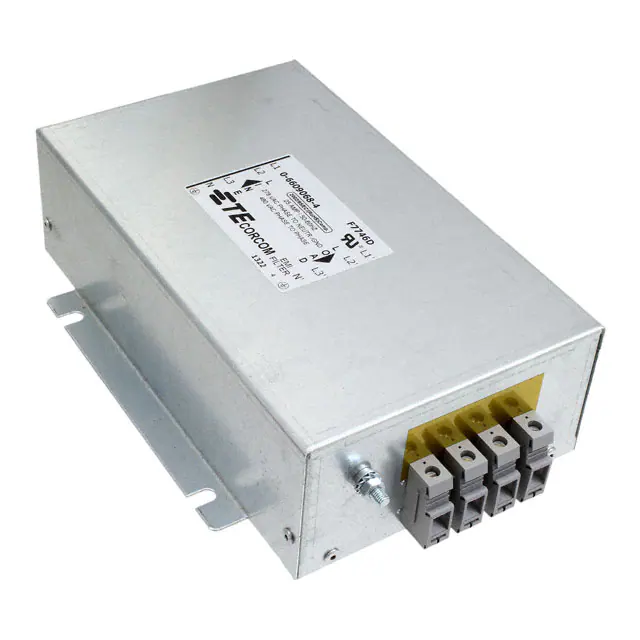

    HUMIREL(泰科)
    LINEFILTER25ACHASSISMOUNT
6609068-4 数据手册
Catalog: 1654001 Issue Date: 06.2011 Corcom Product Guide 3-phase WYE RFI Power Line Filters for High Noise Applications AYC Series UL Recognized* 150AYC10B AYC Series Specifications • For 3-phase, four wire, WYE applications Maximum leakage current each Line to Ground: 120 VAC 60Hz • Very high attenuation • Low leakage current • Ideal for EMC troubleshooting and refurbishing in the field • Touch safe terminals provide easy connections and prevent inadvertent contact for safety in the most demanding applications Ordering Information 150 AYC 10 B -95 Terminal Block Option -95 – 95mm terminal block available on 150A only Omit for standard terminals Filter Type B – Single stage Input / Output Style 10 – Terminal block 16A 25 & 36A 63A 80, 100 & 150A 180, 200A 62 mA 68 mA 74 mA 74 mA 111 mA Hipot rating (one minute): Line to Ground: Line to Line: Line to Neutral: 277 VAC 50Hz 106 118 128 129 192 mA mA mA mA mA 1850 VDC 1850 VDC 1450 VDC Rated Voltage (max): Phase to Phase: Phase to Ground: 480 VAC 277 VAC Operating Frequency: 50/60 Hz Rated Current: 16 to 200A Operating Ambient Temperature Range (at rated current Ir): -10°C to +40°C In an ambient temperature (Ta) higher than +40°C the maximum operating current (Io) is calculated as follows: Io = Ir (85-Ta)/45 Electrical Schematic AYC Series Current Rating 16, 25, 36, 63, 80, 110, 150, 180 or 200A Available Part Numbers 16AYC10B 25AYC10B 36AYC10B 63AYC10B 80AYC10B 110AYC10B 150AYC10B 150AYC10B-95 180AYC10B 200AYC10B A LINE LOAD A B B C C N N GND GND *All except 200AYC10B 108 Dimensions are in inches and millimeters unless otherwise specified. Values in italics are metric equivalents. Dimensions are shown for reference purposes only. Specifications subject to change. For email, phone or live chat, please go to te.com/help corcom.com Catalog: 1654001 Issue Date: 06.2011 Corcom Product Guide 3-phase WYE RFI Filters for High Noise Applications (continued) AYC Series Case Styles 16, 25, 36, 63AYC10B Case Dimensions Part No. E A 80, 110, 150AYC10B / -95 B D C D E                                               Terminal Ground 16AYC10B Line / Load C Ground 25AYC10B Line / Load Ground 180, 200AYC10B 36AYC10B Line / Load Ground B D 63AYC10B Line / Load 80, 110, 150AYC10B E E A C 2 Terminals Part No. E A               Three Phase Filters C B     25AYC10B   36AYC10B   63AYC10B   80, 110 &  150AYC10B  150AYC10B-95   180AYC10B  200AYC10B 16AYC10B B D A  Ground Line / Load 150AYC10B-95 Ground 180AYC10B Line / Load 200AYC10B Size Torque max. lbf-in [N-m] M5 26.58 [3.0] 4mm² 7.08 [0.8] terminal block M5 26.58 [3.0] 6mm² 15.93 [1.8] terminal block M5 26.58 [3.0] 10mm² 15.93 [1.8] terminal block M6 53.1 [6.0] 16mm² 20.35 [2.3] terminal block M10 177.0 [20.0] 50mm² 70.80 [8.0] terminal block M10 177.0 [20.0] 95mm² 177.0 [20.0] terminal block 109 Dimensions are in inches and millimeters unless otherwise specified. Values in italics are metric equivalents. Dimensions are shown for reference purposes only. Specifications subject to change. For email, phone or live chat, please go to te.com/help corcom.com Catalog: 1654001 Issue Date: 06.2011 Corcom Product Guide 3-phase WYE RFI Filters for High Noise Applications (continued) AYC Series Performance Data Typical Insertion Loss Measured in closed 50 Ohm system 16AYC10B 25AYC10B 36AYC10B 63AYC10B db 100 db 100 db 100 db 100 90 90 90 90 80 80 80 80 70 70 70 70 60 60 60 60 50 50 50 50 40 40 40 40 30 30 30 30 20 20 20 20 10 10 10 0 0.01 0.1 1 0 10 30 Frequency in MHz 0.01 0.1 1 10 30 Frequency in MHz 0 10 0.01 0.1 1 0 10 30 Frequency in MHz 0.01 0.1 1 10 30 Frequency in MHz 80AYC10B 110AYC10B 150AYC10B 180, 200AYC10B db 100 db 100 db 100 db 100 90 90 90 90 80 80 80 80 70 70 70 70 60 60 60 60 50 50 50 50 40 40 40 40 30 30 30 30 20 20 20 20 10 10 10 0 0.01 0.1 1 0 10 30 Frequency in MHz 0.01 0.1 1 10 30 Frequency in MHz 0 10 0.01 0.1 1 0 10 30 Frequency in MHz 0.01 0.1 1 10 30 Frequency in MHz Common Mode / Asymmetrical (L-G) Differential Mode / Symmetrical (L-L) Minimum Insertion Loss Measured in closed 50 Ohm system Common Mode / Asymmetrical (Line to Ground) Differential Mode / Symmetrical (Line to Line)                                                                                                                                                                                       110 Dimensions are in inches and millimeters unless otherwise specified. Values in italics are metric equivalents. Dimensions are shown for reference purposes only. Specifications subject to change. For email, phone or live chat, please go to te.com/help corcom.com
