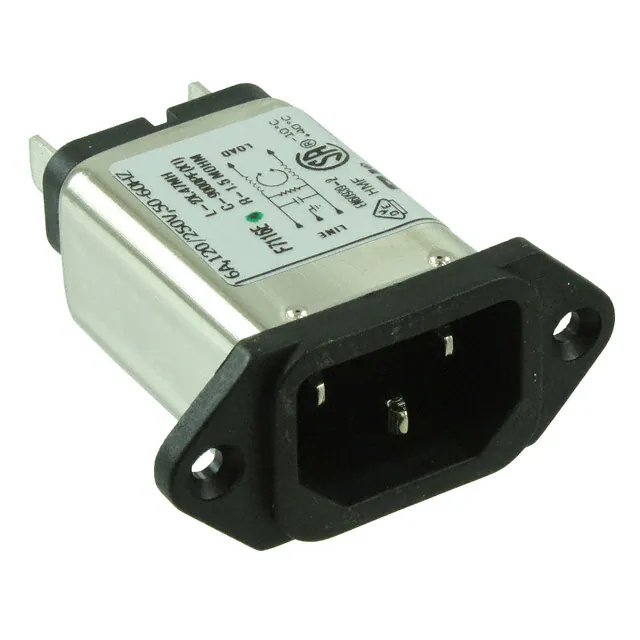

Catalog: 1654001 Issue Date: 06.2011 Corcom Product Guide Cost-effective EMI Power Inlet Filter EEA & EEB Series Including the EAS/EBS and EAH/EBH Models UL Recognized CSA Certified VDE Approved EEA1 / EEB1 EEA2 / EEB2 EEAP / EEBP EEA Series • Compact single stage EMI filter with IEC 60320-1 C14 inlet • Two element circuit provides basic attenuation • Same performance as the EF Series • Available in three terminal configurations • Supersedes EF Series Specifications Maximum leakage current each Line to Ground: EEA/EEB EAS/EBS EAH/EBH @ 120 VAC 60 Hz: .22 mA 2 A @ 250 VAC 50 Hz: .38 mA 5 A Hipot rating (one minute): Line to Ground: Line to Line: 2250 VDC 1450 VDC Rated Voltage (max.): 250 VAC • Compact EMI filter with IEC 60320-1 C14 inlet Operating Frequency: 50/60 Hz • Two element circuit provides extended attenuation Rated Current: EEB Series • Extended differential mode performance • Available in three terminal configurations 1 to 10A Operating Ambient Temperature Range (at rated current Ir): -10°C to +40°C In an ambient temperature (Ta) higher than +40°C the maximum operating current (Io) is calculated as follows: Io = Ir (85-Ta)/45 EAS & EBS Models • Same performance as EEA and EEB Series • Snap–in mounting • Spade terminals Electrical Schematic LINE EAH & EBH Models 1 • Same size as EEA and EEB • Minimal leakage current suitable for medical applications • Flange mounted LOAD 1 Note 1: Not present in EAH / EBH Versions Note 1: Not present in EAH / EBH versions • Spade terminals 148 Dimensions are in inches and millimeters unless otherwise specified. Values in italics are metric equivalents. Dimensions are shown for reference purposes only. Specifications subject to change. For email, phone or live chat, please go to te.com/help corcom.com Catalog: 1654001 Issue Date: 06.2011 Corcom Product Guide Cost-effective EMI Power Inlet Filter (continued) EEA & EEB Series Ordering Information Available Part Numbers 3 EEB 1 Output Styles 1 – .250 [6.3] spade terminals (back) 2 – .250 [6.3] spade terminals (bottom) P – PC board pins Series EEA – Basic Inlet Filter EAS – Snap–in EEA Filter EAH – Medical EEA Filter EEB – Extended EMI Performance EBS – Snap-in EEB Filter EBH – Medical EEB Filter Accessories EEB Models 1EEA1 1EEA2 1EEAP 3EEA1 3EEA2 3EEAP 6EEA1 6EEA2 6EEAP 10EEA1 10EEA2 10EEAP 1EEB1 1EEB2 1EEBP 3EEB1 3EEB2 3EEBP 6EEB1 6EEB2 6EEBP 10EEB1 10EEB2 10EEBP EAS Models EBS Models 1EAS1 3EAS1 6EAS1 10EAS1 1EBS1 3EBS1 6EBS1 10EBS1 EAH Models EBH Models 1EAH1 3EAH1 6EAH1 10EAH1 1EBH1 3EBH1 6EBH1 10EBH1 3 Power Inlet Filters & Power Entry Modules Current Rating 1, 3, 6, or 10A EEA Models GA400: NEMA 5-15P to IEC 60320-1 C-13 line cord FA601: Insulating Shroud .413 Dia. 10.5 .271 Dia. 6.9 .118 3.0 EAS / EBS 1.39 35.4 1.17 29.7 .767 19.5 149 Dimensions are in inches and millimeters unless otherwise specified. Values in italics are metric equivalents. Dimensions are shown for reference purposes only. Specifications subject to change. For email, phone or live chat, please go to te.com/help corcom.com Catalog: 1654001 Issue Date: 06.2011 Corcom Product Guide Cost-effective EMI Power Inlet Filter (continued) EEA & EEB Series Case Styles Case Dimensions EEA1, EEB1, EAH1 & EBH1 EEA1, EEB1, EAH1, EBH1 C EEA2, EEB2 D E A   B         A B C                            Part No. EEAP, EEBP EAS1, EBS1 D E                    Recommended Panel Cutouts EEA2 & EEB2 EEA, EEB, EAH, EBH Front Mount C Back Mount .820 20.8 .50 Max. 12.7 A D E   B         .900 22.9 .140  3.56 1.14* 28.96* 1.575 40.01 1.200 30.48 1.575 40.01 .12 R. 3.05 Typ. *± 0.02 [0.51] .140  3.56 .234 R. 5.94 Typ. Tolerances ± .005 [0.13] unless otherwise noted     EEAP & EEBP EAS, EBS C  G .537 Ref. 13.68 .380 Max. 9.652 0.551 ± .010 D    .815 20.70    13.995 A E     B R 0.188 [4.78] (4X)     PC Board Layout EAS1 & EBS1 0.075 1.91 ∅ Max. C D E     A .81 20.5 0.520 13.21 B    .685* 17.40* 0.551 13.99 *±.015 [0.38] 150 Dimensions are in inches and millimeters unless otherwise specified. Values in italics are metric equivalents. Dimensions are shown for reference purposes only. Specifications subject to change. For email, phone or live chat, please go to te.com/help corcom.com Catalog: 1654001 Issue Date: 06.2011 Corcom Product Guide Cost-effective EMI Power Inlet Filter (continued) EEA & EEB Series Performance Data Typical Insertion Loss Common Mode / Asymmetrical (L-G) Differential Mode / Symmetrical (L-L) Measured in closed 50 Ohm system EEA, EAS Models 1A 3A 6A 10A db 100 db 100 db 100 db 100 90 90 90 90 80 80 80 80 70 70 70 70 60 60 60 60 50 50 50 50 40 40 40 40 30 30 30 30 20 20 20 20 10 10 10 0 0.1 1 10 30 Frequency in MHz 0 0.1 1 10 30 Frequency in MHz 0 10 0.1 1 10 30 Frequency in MHz 0 0.1 1 10 30 Frequency in MHz 3 EEB, EBS Models 3A 6A 10A db 100 db 100 db 100 db 100 90 90 90 90 80 80 80 80 70 70 70 70 60 60 60 60 50 50 50 50 40 40 40 40 30 30 30 30 20 20 20 20 10 10 10 0 0.1 1 10 30 Frequency in MHz 0 0.1 1 10 30 Frequency in MHz 0 Power Inlet Filters & Power Entry Modules 1A 10 0.1 1 10 30 Frequency in MHz 0 0.1 1 10 30 Frequency in MHz 1 10 30 Frequency in MHz 1 10 30 Frequency in MHz EAH Models 1A 3A 6A 10A db 100 db 100 db 100 db 100 90 90 90 90 80 80 80 70 70 70 70 60 60 60 60 80 50 50 50 50 40 40 40 40 30 30 30 30 20 20 20 20 10 10 10 0 0.1 1 10 30 Frequency in MHz 0 0.1 1 10 30 Frequency in MHz 0 10 0.1 1 10 30 Frequency in MHz 0 0.1 EBH Models 1A 3A 6A 10A db 100 db 100 db 100 db 100 90 90 90 90 80 80 80 80 70 70 70 70 60 60 60 60 50 50 50 50 40 40 40 40 30 30 30 30 20 20 20 20 10 10 10 0 0 0 0.1 1 10 30 Frequency in MHz 0.1 1 10 30 Frequency in MHz 10 0.1 1 10 30 Frequency in MHz 0 0.1 151 Dimensions are in inches and millimeters unless otherwise specified. Values in italics are metric equivalents. Dimensions are shown for reference purposes only. Specifications subject to change. For email, phone or live chat, please go to te.com/help corcom.com Catalog: 1654001 Issue Date: 06.2011 Corcom Product Guide Cost-effective EMI Power Inlet Filter (continued) EEA & EEB Series Performance Data (continued) Minimum Insertion Loss Measured in closed 50 Ohm system Differential Mode / Symmetrical (Line to Line) Common Mode / Asymmetrical (Line to Ground)                                                                                                                                                                                                                                                                                                                                                                 152 Dimensions are in inches and millimeters unless otherwise specified. Values in italics are metric equivalents. Dimensions are shown for reference purposes only. Specifications subject to change. For email, phone or live chat, please go to te.com/help corcom.com

物料型号:EEA系列和EEB系列,包括EAS/EBS和EAH/EBH型号。
器件简介:这些是成本效益高的EMI电源入口滤波器,具有IEC 60320-1 C14入口,提供基础或扩展的EMI衰减性能。
引脚分配:文档中提到了三种不同的终端配置,包括EEA1/EEB1、EEA2/EEB2和EEAP/EEBP。
参数特性:包括最大漏电流、Hipot等级、额定电压、操作频率、额定电流和操作环境温度范围。
功能详解:EEA系列提供基本的EMI衰减,而EEB系列提供扩展的差模性能。EAS/EBS型号具有快装安装,EAH/EBH型号适用于医疗应用,具有最小的漏电流。
应用信息:适用于需要EMI滤波的电源入口,EAH/EBH型号特别适用于医疗设备。
封装信息:提供了详细的尺寸信息,包括英寸和毫米,以及安装和PCB布局的推荐开槽。
