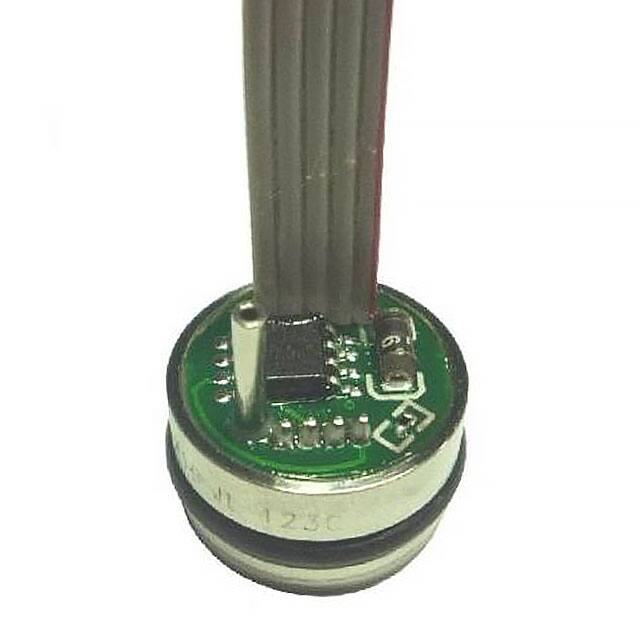

86BSD Digital Output SPECIFICATIONS         Stainless steel with O-ring seal Pressure/temperature read-out Digital output ASIC calibrated Absolute, gage Cable/connector option Low power option 16mm diaphragm diameter The 86BSD is a small profile, media compatible, piezoresistive silicon pressure sensor packaged in a 316L stainless steel housing. This 14-bit digital output pressure sensor supports I2C and SPI interface protocols, may come in a 3.3 or 5.0Vdc supply voltage and is designed for o-ring mounting. The sensing package utilizes silicone oil to transfer pressure from the 316L stainless steel diaphragm to the sensing element. The 86BSD is designed for high performance, low pressure applications. A custom ASIC is used for temperature compensation, offset correction, and provides a digital output of 10~90% or 5~95%. For a similar sensor with stainless steel fittings, refer to the 85BSD digital output pressure sensor. SENSOR SOLUTIONS ///86BSD 09/2017 Page 1 86BSD Digital Output FEATURES       Mountable with O-ring seal ±0.25% Accuracy ±1.0 Total Error Band Cable/connector option Low power option I2C or SPI Interface protocols APPLICATIONS        Level controls Tank level measurement Corrosive fluids and gas measurement systems Sealed systems Manifold pressure measurement Barometric pressure measurement Submersible depth monitoring STANDARD RANGES Range 0 to 001 0 to 002 0 to 005 0 to 015 0 to 030 0 to 050 0 to 100 0 to 150 0 to 200 0 to 300 SENSOR SOLUTIONS ///86BSD psiG  psiA                 Range BarG 0 to .07  0 to .35  0 to 001 0 to 002 0 to 005 0 to 007 0 to 010 0 to 014 0 to 020 09/2017 BarA               Page 2 86BSD Digital Output PERFORMANCE SPECIFICATIONS Supply Voltage: 3.3VDC Ambient Temperature: 25°C (unless otherwise specified) PARAMETERS MIN TYP Zero Pressure Output (10% ~ 90%) Zero Pressure Output (5% ~ 95%) UNITS NOTES 666 MAX Count Hex 1 333 Count Hex 1 Full Scale Pressure Output (10% ~ 90%) 399A Count Hex 1 Full Scale Pressure Output (5% ~ 95%) 3CCB Count Hex 1 Accuracy Total Error Band Pressure Resolution Temperature Accuracy -0.25 0.25 %Span 2 -1 1 %Span 3 0.008 %Span -1.5 1.5 Resolution – Temperature Input Voltage Range 0.1 2.7 3.3 Supply Current Insulation Resistance (50VDC) Load Resistance (RL) 5 6 3X Rated 7 ±0.5 Compensated Temperature (≥15psi) Operating Temperature Storage Temperature %Span/Year 50 °C -20 +85 °C -40 +125 °C -40 +125 °C 14 Bits 11 Bits 8.4 ms Output Pressure Resolution Output Temperature Resolution MΩ Rated kΩ Long Term Stability (Offset & Span) 0 1 2X 10 Compensated Temperature (≤5psi) V mA 50 Burst Pressure 4 °C 5.5 3 Overpressure °C 8 Start Time to Data Ready Output Type 10% to 90% or 5% to 95% Interface Type I2C (ADDR, 0x28H) I2C (ADDR, 0X36H) I2C (ADDR, 0x46H) SPI Media – Pressure Liquids and gases compatible with 316/316L Stainless Steel 8 9 Notes 1. Measured at vacuum for absolute (A), ambient for gage (G) and sealed gage(S). Output is not ratiometric to supply voltage. 2. Accuracy: combined linearity, hysteresis and repeatability. 3. Total Error Band: includes calibration errors and temperature effects over the compensated range. See Figure 3. 4. The deviation from a best fit straight line (BFSL) fitted to the output measured over the compensated temperature range. For errors beyond the compensated temperature range, see Figure 2. 5. Between case and sensing element. 6. 2X or 400psi, whichever is less. The maximum pressure that can be applied to a transducer without changing the transducer’s performance or accuracy. 7. 3X or 600psi, whichever is less. The maximum pressure that can be applied to a transducer without rupture of either the sensing element or transducer. 8. Maximum temperature range for product with standard cable and connector is -20°C to +105°C. 9. Start time to data ready is the time to get valid data after POR (Power on Reset). The time to get subsequent valid data is then specified by the response time specification. 10. Device marking: Each part shall be identified with model number, pressure range, type (‘A’ for absolute or ‘G’ Gage), Lot Number, Serial Number, and Date Code 11. Shipping/Packaging requirements: Each unit will be packaged individually in a plastic vial with anti-static foam. The stainless steel diaphragm is protected by a static dissipative cap. 12. Direct mechanical contact with diaphragm is prohibited. Diaphragm surface must remain free of defects (scratches, punctures, dents, fingerprints, etc) for device to operate properly. Caution is advised when handling parts with exposed diaphragms. Use protective cap whenever devices are not in use. SENSOR SOLUTIONS ///86BSD 09/2017 Page 3 86BSD Digital Output DIMENSIONS SENSOR SOLUTIONS ///86BSD 09/2017 Page 4 86BSD Digital Output SENSOR SOLUTIONS ///86BSD 09/2017 Page 5 86BSD Digital Output BLOCK DIAGRAM SENSOR SOLUTIONS ///86BSD 09/2017 Page 6 86BSD Digital Output TEMPERATURE/PRESSURE ACCURACY SENSOR SOLUTIONS ///86BSD 09/2017 Page 7 86BSD Digital Output PRESSURE TRANSFER FUNCTIONS SENSOR SOLUTIONS ///86BSD 09/2017 Page 8 86BSD Digital Output TEMPERATURE TRANSFER FUNCTIONS SENSOR SOLUTIONS ///86BSD 09/2017 Page 9 86BSD Digital Output ORDERING INFORMATION 86BSD Model Name Pressure Range 100P G ― 3 A I C LT See Pressure Range table Pressure Type A = Absolute G = Gage Supply Voltage 3 = 3.3VDC 5 = 5.0VDC Output A = 10 to 90% B = 5 to 95% Interface I = I2C (Addr. 0x28H) J = I2C (Addr 0x36H) S = SPI K = I2C (Addr 0x46H) Connection P = Pads R = Ribbon Cable C = Cable with Connector Power Mode/Vent Tube T = Standard with Tube LT = Low power with Tube [Blank] = Standard L = Low Power without Tube Pressure Range psi bar 001P .07B Gage only 002P 005P .35B 015P 001B 030P 002B 050P 005B Absolute and 100P 007B Gage 150P 010B 200P 014B 300P 020B Note: Intermediate Pressure Ranges Available NORTH AMERICA EUROPE ASIA Measurement Specialties, Inc., a TE Connectivity Company Tel: 800-522-6752 Email: customercare.frmt@te.com Measurement Specialties (Europe), Ltd., a TE Connectivity Company Tel: 800-440-5100 Email: customercare.lcsb@te.com Measurement Specialties (China), Ltd., a TE Connectivity Company Tel: 0400-820-6015 Email: customercare.shzn@te.com TE.com/sensorsolutions Measurement Specialties, Inc., a TE Connectivity company. Measurement Specialties, TE Connectivity, TE Connectivity (logo) and EVERY CONNECTION COUNTS are trademarks. All other logos, products and/or company names referred to herein might be trademarks of their respective owners. The information given herein, including drawings, illustrations and schematics which are intended for illustration purposes only, is believed to be reliable. However, TE Connectivity makes no warranties as to its accuracy or completeness and disclaims any liability in connection with its use. TE Connectivity‘s obligations shall only be as set forth in TE Connectivity‘s Standard Terms and Conditions of Sale for this product and in no case will TE Connectivity be liable for any incidental, indirect or consequential damages arising out of the sale, resale, use or misuse of the product. Users of TE Connectivity products should make their own evaluation to determine the suitability of each such product for the specific application. © 2015 TE Connectivity Ltd. family of companies SENSOR SOLUTIONS ///86BSD All Rights Reserved. 09/2017 Page 10
