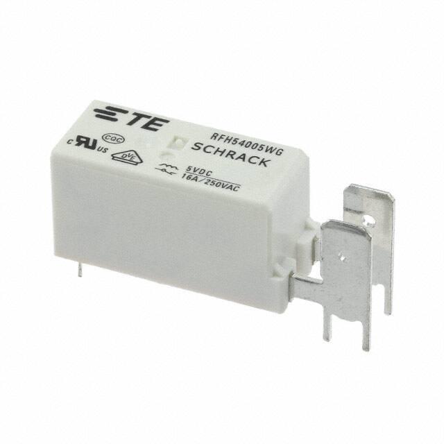

    通用 继电器 SPST-NC(1 Form B) 5VDC 线圈 通孔
9-1415520-1 数据手册
General Purpose Relays PCB Relays SCHRACK Power Relay RF n 1 pole 16A, 1 form A (NO) or 1 form B (NC) contact power 400mW n Reinforced insulation (EN 61810, 60335, 60730) n Ambient temperature up to 105°C n Quick connect terminals for load side n WG version: Materials in accordance to IEC 60335-1 n Coil Typical applications Oven control, electric heating, power supplies, air conditioning, microwave ovens, hobs VZ Approvals Coil Data VDE REG.-Nr. A652, UL E214025, CQC 05001014817 Coil voltage range Operative range, IEC 61810 Coil insulation system according UL1446 Technical data of approved types on request Contact Data Contact arrangement 1 form A (NO) or 1 form B (NC) Rated voltage 250VAC Max. switching voltage 400VAC Rated current 16A Limiting making current, form A contact, max. 4s, duty factor 10 % 25A Breaking capacity max. 4000VA Contact material AgNi 90/10 Min. recommended contact load 12VAC at 500mA Frequency of operation, with/without load 360/72000h-1 Operate/release time max. 11/7ms Bounce time max., form A/form B 4/4ms Contact ratings Type IEC 61810 RF334; RFH34 RF334; RFH34 RF334; RFH34 RF334; RFH34 RF354; RFH54 RF354; RFH54 RF354; RFH54 RFH34 RFH34 RFH34 RFH34 Contact Load A (NO) A (NO) A (NO) A (NO) B (NC) B (NC) B (NC) A (NO) A (NO) A (NO) A (NO) 5 to 60VDC 2 class F Coil versions, DC coil Coil Rated Operate Release Coil Rated coil code voltage voltage voltage resistance power VDC VDC VDC Ω±10% mW 005 5 3.5 0.5 62 403 006 6 4.2 0.6 90 400 009 9 6.3 0.9 203 399 012 12 8.4 1.2 360 400 024 24 16.8 2.4 1440 400 048 48 33.6 4.8 5520 417 060 60 42.0 6.0 8570 420 All figures are given for coil without pre-energization, at ambient temperature +23°C. Other coil voltages on request. Cycles 16A, 250VAC resistive, 85°C 11A, 250VAC resistive, 85°C 20A, 250VAC resistive, 85°C 25A, 250VAC resistive, 70°C 16A, 250VAC resistive, 85°C 20A, 250VAC resistive, 85°C 25A, 250VAC resistive, 70°C 16A, 250VAC resistive, 105°C 11A, 250VAC resistive, 105°C 18.5A, 250VAC resistive, 105°C 10A, 400VAC resistive, 105°C Mechanical endurance F0273-BI 100x103 250x103 25x103 15x103 100x103 50x103 20x103 100x103 250x103 20x103 150x103 >10x106 operations Insulation Data Initial dielectric strength between open contacts between contact and coil Clearance/creepage between contact and coil Material group of insulation parts Tracking index of relay base 11-2011, Rev. 1111 www.te.com © 2011 Tyco Electronics Corporation, a TE Connectivity Ltd. company Datasheets and product specification according to IEC 61810-1 and to be used only together with the ‘Definitions’ section. Datasheets and product data is subject to the terms of the disclaimer and all chapters of the ‘Definitions’ section, available at http://relays.te.com/definitions 1000Vrms 4000Vrms ≥8/8mm IIIa PTI250V Datasheets, product data, ‘Definitions’ section, application notes and all specifications are subject to change. 1 General Purpose Relays PCB Relays SCHRACK Power Relay RF (Continued) Other Data Material compliance: EU RoHS/ELV, China RoHS, REACH, Halogen content refer to the Product Compliance Support Center at www.te.com/customersupport/rohssupportcenter Resistance to heat and fire WG version according EN 60335-1, par.30 Ambient temperature RF3 -40 to 85°C RFH -40 to 105°C Category of environmental protection IEC 61810 RTII - flux proof1) Vibration resistance (functional), form A/form B, 55 to 500Hz 20/5g Shock resistance (destructive) 100g Terminal type PCB-THT, quick connect for load side Weight 20g Resistance to soldering heat THT, IEC 60068-2-20 flux proof version 270°C/10s wash tight version 260°C/5s Packaging/unit tray/30 pcs., box/300 pcs. PCB layout / terminal assignment Bottom view on solder pins S0256-CA 1 form A (NO) contact S0256-CB 1) RTIII - wash tight version on request 1 form B (NC) contact S0256-CC Dimensions Quick connect terminals vertical Quick connect terminals horizontal S0282-CI 2 11-2011, Rev. 1111 www.te.com © 2011 Tyco Electronics Corporation, a TE Connectivity Ltd. company Datasheets and product specification according to IEC 61810-1 and to be used only together with the ‘Definitions’ section. S0282-CJ Datasheets and product data is subject to the terms of the disclaimer and all chapters of the ‘Definitions’ section, available at http://relays.te.com/definitions Datasheets, product data, ‘Definitions’ section, application notes and all specifications are subject to change. General Purpose Relays PCB Relays SCHRACK Power Relay RF (Continued) Product code structure Typical product code RF 3 3 4 012 WG Type RF Power Relay RF Version 3 16A, 85°C H 16A, 105°C Contact configuration 3 1 form A (NO) contact, quick connect term. vertical D 1 form A (NO) contact, quick connect term. horizontal 5 1 form B (NC) contact, quick connect term. vertical F 1 form B (NC) contact, quick connect term. horizontal Contact material 4 AgNi ​90/10 Coil Coil code: please refer to coil versions table Version Blank Standard version WG Product in accordance with IEC 60335-1 (domestic appliances) Wash tight version on request Product code Contact arrangement Version Coil Version Part number RF334012 1 form A (NO) 85°C 12VDC Standard 8-1415513-1 RFH34009WG contact 105°C 9VDC IEC60335-1 compliant 4-1415520-1 RFH34012WG 12VDC 5-1415520-1 RFH34024 24VDC Standard 1415511-1 RFH54006WG 1 form B (NC) 6VDC IEC60335-1 compliant 1415521-1 RFH54024WG contact 24VDC 3-1415521-1 RFHD4012WG 1 form A (NO) 12VDC 9-1415521-1 This list represents the most common types and does not show all variants covered by this datasheet. Other types on request 11-2011, Rev. 1111 www.te.com © 2011 Tyco Electronics Corporation, a TE Connectivity Ltd. company Datasheets and product specification according to IEC 61810-1 and to be used only together with the ‘Definitions’ section. Datasheets and product data is subject to the terms of the disclaimer and all chapters of the ‘Definitions’ section, available at http://relays.te.com/definitions Datasheets, product data, ‘Definitions’ section, application notes and all specifications are subject to change. 3
