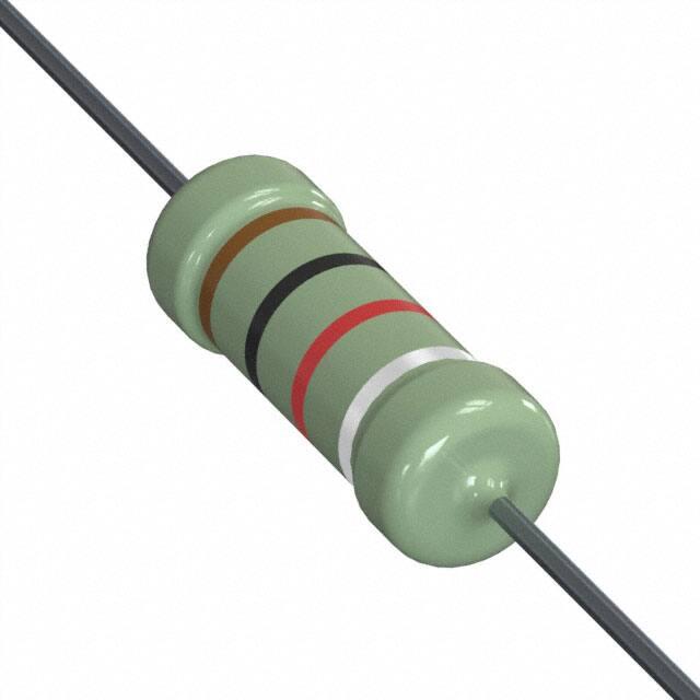

Ceramic Composition Resistors
Type CCR Series
Type CCR Series
Characteristics Electrical
Power at 70°C Ambient:
Derating:
Resistance Range:
Resistance Tolerance:
Temp. Coefficient (ppm/°C):
Max. Working Voltage:
Max. Overload Voltage:
Dielectric Withstand Voltage:
Impulse Withstanding Voltage*:
The CCR series of resistors is
0.5 Watt.
1.0 Watt.
2.0 Watt.
Derating to 0 at 200°C Derating to 0 at 200°C
10R – 100K
3R3 – 390K
3R3 – 390K
10% E12 series
10% E12 series
10% E12 series
100R: -1300 to ±300
200V
300V
400V
400V
600V
800V
500 volts
500 volts
700 volts
10 Kv
14 Kv
20 Kv
NB *: Please refer to Resistance to Pulse Circuit
constructed utilising solid ceramic
composition, which is the traditional
medium for absorbing high energy
Characteristics Environmental
pulses, in cases of high inrush
current.

Key Features
I
Range of Resistance
Tolerances
I
Solid Ceramic
Composition
I
Low Cost, High
Performance
I
Two Sizes Available
I
Wide Range of
Resistance Values
I
Available on Tape

Dimensions
L
d
D
Literature No. 1773193
Issued: 12-08
Dimensions are shown for
reference purposes only.
BULK
L
D
d (nom)
l
CCR1/2
9.0 ± 1.0
3.5 ± 0.5
0.7
30 ± 3
CCR1
16.5 ± 1.0
5.5 ± 1.0
0.8
38 ± 3
CCR2
19.0 ± 1.0
7.0 ± 1.0
0.8
38 ± 3
Dimensions are in
millimetres unless
otherwise specified.
