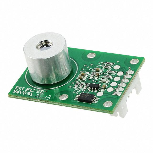

TSEV01S01C10 SPECIFICATIONS        Contact less Temperature Measurement Small Size Heat Spreader improves Accuracy Wide Supply Voltage Range Digital Interface Bus (SPI) Connector Small Field of View The TSEV01S01C10 is a contact-less temperature measuring system for OEM use based on the detection of infrared radiation. The TSEV01S01C10 is equipped with an infrared sensor (Thermopile) in front. The Thermopile Sensor has to be pointed at the target object. The basic working principle is:     Detection of infrared radiation with a Thermopile sensor, which turns incoming radiation to an analogue voltage Determination of sensor temperature using a thermistor Calculation of ambient and object temperature using a processing unit Providing the ambient and objects temperature at digital output bus (SPI) The basic thermopile sensor module is suitable for a wide range of application where non-contact temperature measurement and high accuracy are required SENSOR SOLUTIONS /// TSEV01S01C10 9/2015 Page 1 TSEV01S01C10 FEATURES 0°C – 300°C Measurement Range Small Size Up to 2°C Accuracy 2mA Current Consumption APPLICATIONS Contact less Temperature Measurement Climate Control Industrial Process Control Household Applications ABSOLUTE MAXIMUM RATINGS Absolute maximum ratings are limiting values of permitted operation and should never be exceeded under the worst possible conditions either initially or consequently. If exceeded by even the smallest amount, instantaneous catastrophic failure can occur. And even if the device continues to operate satisfactorily, its life may be considerably shortened. Parameter Supply Voltage Operating Temperature Storage temperature Humidity Humidity Symbol Vccmax Topmax Tstor HumL HumH Conditions Stabilized supply voltage Min -0.3 -10 -40 Typ Max 16 85 85 85 50 Unit V °C °C % % -40°C - +50°C +50°C - +85°C OPERATING CONDITIONS Parameter Supply Voltage Operating Temperature Range Emission Coefficient Symbol Vcc Top ε Conditions Stabilized supply voltage Min 3.3 0 0.98 Typ Max 16 85 Unit V °C Parameter Symbol Conditions Min Typ Max Unit Field of View FOV10 Field of View FOV50 Wavelength Range S SENSOR CONDITIONS SENSOR SOLUTIONS /// TSEV01S01C10 Total field of view at 10% signal level Total field of view at 50% signal level 9/2015 14 ° 10 ° Silicon, no coating µm Page 2 TSEV01S01C10 OPERATIONAL CHARACTERISTICS If not otherwise noted, 5V supply voltage and object with ε =0.98 were applied. Parameter Object Temperature Range Resolution Supply Current1) Data Output Rate Symbol Tobj Res I Fout Standard Start-Up Time tStart Conditions Min 0 No output load Typ Max 300 0.1 3 Unit °C °C mA Hz s Max 2 3 3 4 Unit °C °C °C °C 2 1 TOLERANCES If not otherwise noted, 3.3V supply voltage and object with ε =0.98 were applied. Parameter Standard Temp 1) 3) Extended Temp. 1 2) 3) Extended Temp. 2 2) 3) Extended Temp. 3 2) 3) Symbol AccS AccE1 AccE2 AccE3 Sensor Temp. 15 < Tsen < 35 Tsen < 15, Tsen > 35 15 < Tsen < 35 Tsen < 15, Tsen > 35 Object Temp. 170 < Tobj < 190 170 < Tobj < 190 Tobj < 170, Tobj > 190 Tobj < 170, Tobj > 190 OTHER TEMPERATURE RANGES AND ACCURACIES ARE AVAILABLE ON REQUEST. 1) Proved while production by design Valid for a distance of 100mm and black body size of 150mm x 150mm 2) Proved 3) SENSOR FIELD OF VIEW 100 95 90 85 80 75 70 Thermopile Signal / % 65 60 55 50 45 40 35 30 25 20 15 10 5 0 -15 -14 -13 -12 -11 -10 -9 -8 -7 -6 -5 -4 -3 -2 -1 0 1 2 3 4 5 6 7 8 9 10 11 12 13 14 15 Angle / ° SENSOR SOLUTIONS /// TSEV01S01C10 9/2015 Page 3 TSEV01S01C10 MECHANICAL DIMENSIONS Only use hatched areas for mechanical assembly (screws, nuts, etc). TERMINALS Connector: JST PHR-6 Pin 1 2 3 4 5 6 Name VDD GND SCL MISO MOSI SCE Description Supply Voltage Ground SPI Clock SPI Master In / OutOut / SPI Slave Master In SPI Slave Chip Enable SENSOR SOLUTIONS /// TSEV01S01C10 Type Supply Supply Interface Interface Interface Interface 9/2015 Page 4 TSEV01S01C10 BLOCK DIAGRAM EEPROM Thermopile MCU (Signal Processing, Signal Compensation) SPI Interface INTERFACE PARAMETER Parameter Baudrate Data Bits Chip Select Input Voltage Low Input Voltage High Output Voltage Low Output Voltage High Symbol FSPI Conditions Min 10 Typ Max 100 Unit kHz 0.9 V V V V 8 Yes Vcc = 3.3V 1mA Vcc = 3.3V, 1mA 2.1 0.3 3.0 SIGNAL DESCRIPTION    SCE (Chip Select) 0 = Enable, 1 = Disable CKP 0 CKE 1 SENSOR SOLUTIONS /// TSEV01S01C10 9/2015 Page 5 TSEV01S01C10 SAMPLE CODE Sample Code for sending 8 bits and reading 8 bits while sending 8 clocks. // Setting directions TRISC4 = 1; // SDI = Input TRISC5 = 0; // SDO = Output TRISC3 = 0; // SCL = Output // Reset SPI Lines RC5 = 0;// SDO RC3 = 0;// SCL for (c = 0; c < 8; c++) { cReceive = cReceive > (7 - c)); RC3 = 1; cReceive = cReceive | RC4; } RC3 = 0; RC5 = 0; return cReceive; // Shift Receive Register // SCL = 0 // Outupt next Bit on SDO // SCL = 1 // Input next Bit on SDI AMBIENT AND OBJECT TEMPERATUREMEASUREMENT Please refer following table for SPI commands to read object temperature and ambient temperature. Both values are transmitted in hundredth of degrees. Com Description Reply Bytes 0xA0 Sensor Temperature Sensor temperature in hundredth of degrees Celsius 2 0xA1 Object Temperature Object temperature in hundredth of degrees Celsius 2 SEQUENCE OF TRANSMISSION Enable SCE (SCE=0) before transmission of “Command”. Release SCE (SCE=1) after reading last byte. Sensor MASTER First Transmission 8 Clocks 8 Bits Write 8 Bits Read Second Transmission 8 Clocks 8 Bits Write 8 Bits Read Third Transmission 8 Clocks 8 Bits Write 8 Bits Read Command (0xA0 or 0xA1) 8 bits ??? 8 bits 0x00 8 bits Temperature High Byte 8 bits 0x00 8 bits Temperature Low Byte 8 bits SENSOR SOLUTIONS /// TSEV01S01C10 9/2015 Page 6 TSEV01S01C10 EXAMPLE OF TEMPERATURE CALCULATION For reading object temperature send: 0xA1 Return values i.e.: Byte(0) = ??? discard reading Byte(1) = 0x1A (=26) Byte(2) = 0xB0 (=176) Tobj = (256 * Byte(1) + Byte(2)) / 100 = (256 * 26 + 176) / 100 = 68.32°C NAMING CONVENTION TSEV01 S 01 B 10 Series Interface (S = SPI, I = I2C) Variant (01, 02, ...) Option (B = Basic, C = Comfort) Field of View at 50% Signal Level (5°, 10°, ...) ORDER INFORMATION Please order this product using following: Part Number G-TPMO-023 Part Description TSEV01S01C10 EMC Due to the use of these modules for OEM application no CE declaration is done. Especially line coupled disturbances like surge, burst, HF etc. cannot be removed by the module due to the small board area and low price feature. There is no protection circuit against reverse polarity or over voltage implemented. The module will be designed using capacitors for blocking and ground plane areas in order to prevent wireless coupled disturbances as good as possible. SENSOR SOLUTIONS /// TSEV01S01C10 9/2015 Page 7 TSEV01S01C10 DEFINITIONS AND DISCLAIMERS   Application information – Applications that are described herein for any of these products are for illustrative purpose only. MEAS Deutschland GmbH makes no representation or warranty that such applications will be suitable for the specified use without further testing or modification. Life support applications – These products are not designed for use in life support appliances, devices, or systems where malfunctions of these products can reasonably be expected to result in personal injury. MEAS Deutschland GmbH customers using or selling this product for use in such applications do so at their own risk and agree to fully indemnify MEAS Deutschland GmbH for any damages resulting from such improper use or sale. NORTH AMERICA EUROPE ASIA Measurement Specialties, Inc., a TE Connectivity Company 910 Turnpike Road Shrewsbury, MA 01545 Tel: 1-508-842-0516 Fax: 1-508-842-0342 Sales email: temperature.sales.amer@meas-spec.com Measurement Specialties (Europe), Ltd., a TE Connectivity Company Deutschland GmbH Hauert 13 44277 Dortmund Tel: +49 (0) 231/9740-0 Fax: +49 (0) 231/9740-20 Sales email: info.de@meas-spec.com Measurement Specialties (China), Ltd., a TE Connectivity Company No. 26 Langshan Road Shenzhen High-Tech Park (North) Nanshan District, Shenzhen 518057 China Tel: +86 755 3330 5088 Fax: +86 755 3330 5099 Sales email: temperature.sales.asia@meas-spec.com TE.com/sensorsolutions Measurement Specialties, Inc., a TE Connectivity company. Measurement Specialties, TE Connectivity, TE Connectivity (logo) and EVERY CONNECTION COUNTS are trademarks. All other logos, products and/or company names referred to herein might be trademarks of their respective owners. The information given herein, including drawings, illustrations and schematics which are intended for illustration purposes only, is believed to be reliable. However, TE Connectivity makes no warranties as to its accuracy or completeness and disclaims any liability in connection with its use. TE Connectivity‘s obligations shall only be as set forth in TE Connectivity‘s Standard Terms and Conditions of Sale for this product and in no case will TE Connectivity be liable for any incidental, indirect or consequential damages arising out of the sale, resale, use or misuse of the product. Users of TE Connectivity products should make their own evaluation to determine the suitability of each such product for the specific application. © 2015 TE Connectivity Ltd. family of companies All Rights Reserved. SENSOR SOLUTIONS /// TSEV01S01C10 9/2015 Page 8
