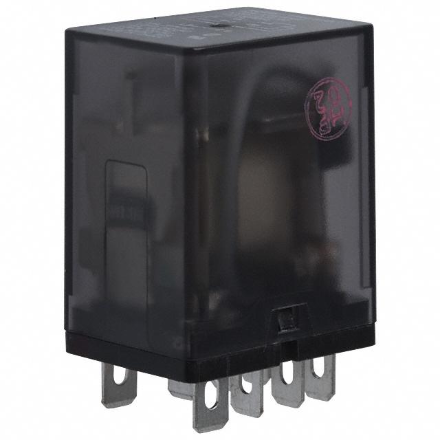

General Purpose Relays Industrial Relays Potter & Brumfield K10 Series Miniature Relay n 2 Form C contact arrangement and DC coils n Socket, PCB and top flange mounting options n AC Typical applications Industrial controls, medical, motor controls Approvals Coil Data (continued) Technical data of approved types on request Coil versions, AC coil Coil Rated Operate Release Coil Rated coil code voltage voltage voltage resistance power VAC VAC VAC Ω±15% VA 006 6 5.1 0.6 10.5 1.20 012 12 10.2 1.2 43 1.20 024 24 20.4 2.4 160 1.25 048 48 40.8 4.8 668 1.25 120 120 102.0 12.0 3900 1.35 240 240 204.0 24.0 12000 1.50 UL E22575; CSA L15734 Contact Data Contact arrangement 2 form C (CO), 2 from A (NO), 2 form B (NC), 1 form A (NO) + 1 form B (NC) Rated voltage 120VAC Rated current 15A Contact material Ag, AgCdO, AgSnOInO Min. recommended contact load Ag contacts 100mA, 12VDC AgCdO and AgSnInO contacts 300mA, 12VDC Initial contact resistance 100mΩ Frequency of operation 360 ops./hour Operate/release time max. 13/10 ms Bounce time max. 10ms Contact ratings Type Load UL 508 Ag 10A, 30VDC 10A, 277VAC AgCdO 15A, 120VAC 10A, 277VAC 15A, 30VDC 15 FLA, 36 LRA, 120VAC 1/3HP, 120VAC 1/2HP, 250VAC AgSnOInO 15A, 240VAC Mechanical endurance Coil Data Coil voltage range Coil insulation system according UL Operations 10x106 operations 6x103 6x103 100x103 100x103 100x103 100x103 1x103 1x103 70x103 6 to 110VDC 6 to 240VAC Class B Coil versions, DC coil Coil Rated Operate Release Coil Rated coil code voltage voltage voltage resistance power VDC VDC VDC Ω±10% mW 006 6 4.5 0.6 40 900 012 12 9.0 1.2 160 900 024 24 18.0 2.4 650 900 048 48 36.0 4.8 2600 900 110 110 82.5 11.0 11000 1100 All figures are given for coil without preenergization, at ambient temperature +23°C, 60Hz. Insulation Data Initial dielectric strength between open contacts between contact and coil between adjacent contacts between coil and frame Initial surge withstand voltage between adjacent contacts 1000Vrms 1500Vrms 1500Vrms 1500Vrms 1000MΩ at 500VDC Other Data Material compliance: EU RoHS/ELV, China RoHS, REACH, Halogen content refer to the Product Compliance Support Center at www.te.com/customersupport/rohssupportcenter Ambient temperature -45°C to 70°C Category of environmental protection IEC 61810 RT0 - open relay RTI - dust protected Terminal type quick connect (QC) .187 PCB .120” and .160” long Weight 51g Packaging/unit box/250 pcs., tray/50 pcs. Accessories For details see datasheet Sockets and Accessories, K10 Relays Product Code 27E895 27E487 20C426 27E488 27E489 20C217 Description DIN socket Track mount socket Clip for 27E895 and 27E487 Chassis/solder socket PCB socket Clip for 27E488 and 27E489 All figures are given for coil without preenergization, at ambient temperature +23°C. 04-2013, Rev. 0413 www.te.com © 2013 Tyco Electronics Corporation, a TE Connectivity Ltd. company Datasheets and product specification according to IEC 61810-1 and to be used only together with the ‘Definitions’ section. Datasheets and product data is subject to the terms of the disclaimer and all chapters of the ‘Definitions’ section, available at http://relays.te.com/definitions Datasheets, product data, ‘Definitions’ section, application notes and all specifications are subject to change. 1 General Purpose Relays Industrial Relays Potter & Brumfield K10 Series Miniature Relay (Continued) Terminal assignment PCB layout Bottom view on solder pins 2 Form C 2 Form A (delete 1 and 2) 2 Form B (delete 3 and 4) 1 2 3 4 5 6 A B .232 (5.89) .394 .185 (10.01) (4.70) .285 (7.24) .086 DIA. (2.18) .559 (14.20) Dimensions .187 ± .0 02 (4.75 ± .05) 5 1 3 6 2 4 B .281 (7.14) .239 REF. (6.07) .020 ± .0 02 (.51 ± .05) 1.109 MAX . (28.17) A .559 (14.20) .078 (1.98) .517 (13.13) A .078 (1.98) .020 ± .0 02 (.51 ± .05) 1 3 2 4 5 6 .078 TYP. (1.98) B 1.720 MAX. (43.69) .25 (6.4) .854 MAX. (21.69) 1.480 ± .0 03 (37.59 ± .08) .125 (3.18) 1.400 MAX. (35.56) w/NEON INDI CATOR 1.600 MAX . (40.64) 1.375 MAX . (34.93) Mounting code T Flange mount 1.087 ± .010 (27.61 ± .25) Mounting code 5 Printed circuit terminals w/NEON INDI CATOR 1.625 MAX. (41.28) Mounting code 1 Socket mount .160 (4.06) 1.682 MAX. (42.72) .142 TYP. (3.61) .394 .860 MAX . (10.01) (21.84) .181 (4.60) Product code structure Typical product code K10 P -11 D 1 5 -6 Type K10 15A Miniature Relay, K10 Series Cover P Polycarbonate (smoke color) L Neon or LED, polycarbonate dust cover (smoke color) Option without cover (open style) on request Contact arrangement 7 2 form A (NO) 8 2 form B (NC) 11 2 form C (CO) 50 1 form A and 1 form B (NO and NC) Coil input A 50/60Hz AC D DC Mounting & termination 1 Socket mount; .187“ (4.75mm) quick connect/solder terminals 5 Printed circuit terminals; .160“ (4.1mm) length. T Mounting bracket on end of cover; .187“ (4.75mm) quick connect/solder terminals Options with mounting plates on narrow side or on end cover and shorter (.120“ (3.05mm)) PCB terminals on request Contact type 1 Ag (10A) 5 AgCdO (15A) P AgSnOIn (15A) Coil voltage Coil code: please refer to coil versions table 2 04-2013, Rev. 0413 www.te.com © 2013 Tyco Electronics Corporation, a TE Connectivity Ltd. company Datasheets and product specification according to IEC 61810-1 and to be used only together with the ‘Definitions’ section. Datasheets and product data is subject to the terms of the disclaimer and all chapters of the ‘Definitions’ section, available at http://relays.te.com/definitions Datasheets, product data, ‘Definitions’ section, application notes and all specifications are subject to change. General Purpose Relays Industrial Relays Potter & Brumfield K10 Series Miniature Relay (Continued) Product Code Arrangement Cont. material Coil Coil Terminals Mounting K10P-11A15-6 2 form C, 2 CO AgCdO AC coil 6VAC Quick connect (QC) Socket K10P-11A15-12 12VAC K10P-11A15-24 24VAC K10P-11AT5-24 Bracket K10P-11A15-120 120VAC Socket K10P-11AT5-120 Bracket K10P-11D15-6 DC coil 6VDC Socket K10P-11D15-12 12VDC K10P-11DT5-12 Bracket K10P-11D15-24 24VDC Socket K10P-11DT5-24 Bracket K10P-11D15-48 48VDC Socket K10P-11D15-110 110VDC K10P-11D55-12 12VDC PCB PCB K10P-11D55-24 24VDC K10P-11D55-110 110VDC 04-2013, Rev. 0413 www.te.com © 2013 Tyco Electronics Corporation, a TE Connectivity Ltd. company Datasheets and product specification according to IEC 61810-1 and to be used only together with the ‘Definitions’ section. Datasheets and product data is subject to the terms of the disclaimer and all chapters of the ‘Definitions’ section, available at http://relays.te.com/definitions Part number 4-1393144-4 3-1393144-9 4-1393144-1 3-1393144-5 4-1393144-0 3-1393144-3 6-1393144-0 5-1393144-5 5-1393144-0 5-1393144-7 5-1393144-1 5-1393144-9 5-1393144-4 6-1393144-6 6-1393144-8 6-1393144-5 Datasheets, product data, ‘Definitions’ section, application notes and all specifications are subject to change. 3
