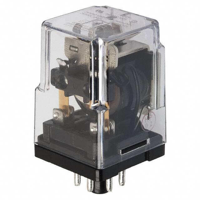

    RELAY GEN PURPOSE DPDT 5A 240V
KRPA-11AY-240 数据手册
General Purpose Panel/Plug-in Relays Potter & Brumfield KRPA Series Panel Plug-in Relay n 5 to 10A current capability arrangements of 1, 2 and 3 form C (CO) n Octal type termination for quick installation n Indicator lamp available on certain models n Contact Typical applications Baggage handling, lighting, inspection equipment, marine. Coil Data (continued) Approvals UL E22575; CSA LR15734 Technical data of approved types on request. Contact Data Contact arrangement 1 form C (CO), 2 form C (CO), 3 form C (CO) Rated voltage 240VAC Rated current 10A Contact material Ag AgCdO Min. recommended contact load 100mA, 12VDC 300mA, 12VDC Frequency of operation 360 ops./hour 360 ops./hour Contact ratings Type Load UL 508 KRPA, Ag 5A, 120VAC 3A, 240VAC 1/10HP, 120VAC 1/6HP, 240VAC KRPA, AgCdO 10A, 240VAC 1/3HP, 120VAC 1/2HP, 240VAC KA, Ag 5A, 120VAC 3A, 240VAC 1/10HP, 120VAC 1/6HP, 240VAC KA, AgCdO 10A, 120VAC 6A, 240VAC 1/6HP, 120VAC 1/3HP, 240VAC Mechanical endurance Coil versions, AC coil Coil Rated Operate code voltage voltage VAC VAC 6 6 5.1 12 12 10.2 24 24 20.4 120 120 102.0 240 240 204.0 Coil resistance Ω±15% 6 24 85 2250 9110 Rated coil power VA 2.01 2.02 2.02 2.1 2.1 All figures are given for coil without preenergization, at ambient temperature +23°C. Insulation Data Cycles 100x103 100x103 1x103 1x103 100x103 1x103 1x103 10x106 ops. Coil Data Coil voltage range 6 to 220VDC 6 to 240VAC Coil insulation system according UL Class B Coil versions, DC coil Coil Rated Operate Coil Rated coil code voltage voltage resistance power VDC VDC Ω±10% W 6 6 4.5 32 1.15 12 12 9.0 120 1.2 24 24 18.0 472 1.25 48 48 36.0 1800 1.3 110 110 82.5 10000 1.2 – 220 Use 110V relay with 10KΩ, 5W resistor in series Initial dielectric strength between open contacts between contact and coil between adjacent contacts Initial insulation resistance between insulated elements 1000Vrms 1000Vrms 1000Vrms KRPA: 1000MΩ KA: 100MΩ Other Data Material compliance: EU RoHS/ELV, China RoHS, REACH, Halogen content refer to the Product Compliance Support Center at www.te.com/customersupport/rohssupportcenter Ambient temperature DC coil KRPA: -45ºC to 70ºC KA: -45ºC to 85ºC AC coil KRPA: -45ºC to 55ºC KA: -45ºC to 70ºC Category of environmental protection IEC 61810 RTI - dust protected KRPA and RT0 - open style KA Terminal type KRPA: 8- or 11-pin octal-type plug KA: solder terminals Weight 85g Packaging/unit tray/25 pcs., box/150pcs. Accessories For details see datasheet Product Code 27E891 27E892 27E122 27E123 Sockets and Accessories, KRPA Relays Description Two pole DIN socket (use 20C318 clip) Three pole DIN socket (use 20C318 clip) Two pole track mount socket (use 20C318 clip) Three pole track mount socket (use 20C318 clip) All figures are given for coil without preenergization, at ambient temperature +23°C. 07-2015, Rev. 0715 www.te.com © 2015 Tyco Electronics Corporation, a TE Connectivity Ltd. company. Catalog and product specification according to IEC 61810-1 and to be used only together with the ‘Definitions’ section. Catalog and product data is subject to the terms of the disclaimer and all chapters of the ‘Definitions’ section, available at http://relays.te.com/definitions Catalog product data, ‘Definitions’ section, application notes and all specifications are subject to change. 1 General Purpose Panel/Plug-in Relays Potter & Brumfield KRPA Series Panel Plug-in Relay (Continued) Dimensions KRPA KA 1.468 MAX. (37.29) 1.375 MAX. (34.93) 1.406 MAX. (35.71) 2.0 MAX. (50.8) 1.406 MAX. (35.71) .25 (6.4) 1.06 MAX. .44 (26.9) (11.2) 1.92 MAX. (48.8) 1 STUD #6-32 THREAD .15 (3.8) .312 (7.92) Terminal assignment KRPA KRPA KRPA KA KA KA 1 form C 3 form C 1 form C 2 form C 3 form C 8 2 form C 8 1 1 7 2 7 2 6 3 6 3 5 4 5 4 10 11 1 2 9 8 3 7 6 5 4 Product code structure Typical product code KRPA -5 A Y -120 Type KRPA Enclosed relay with octal-style plug KA Open style relay with solder terminals Contact arrangement and rating 5 1 form C (CO) 11 2 form C (CO) 14 3 form C (CO) Coil Input A AC, 50/60Hz D DC Contact material and indicator lamp option Y Ag, no indicator lamp G AgCdO, no indicator lamp N AgCdO, with indicator (Code N only available with relay type KRPA) Options Leave blank no additional options F Au flashed contacts P Push to test button (Options F and P only available with relay type KRPA) Coil voltage Coil code: please refer to coil versions table 2 07-2015, Rev. 0715 www.te.com © 2015 Tyco Electronics Corporation, a TE Connectivity Ltd. company. Catalog and product specification according to IEC 61810-1 and to be used only together with the ‘Definitions’ section. Catalog and product data is subject to the terms of the disclaimer and all chapters of the ‘Definitions’ section, available at http://relays.te.com/definitions Catalog product data, ‘Definitions’ section, application notes and all specifications are subject to change. General Purpose Panel/Plug-in Relays Potter & Brumfield KRPA Series Panel Plug-in Relay (Continued) Product Code Arrangement Contact Material Coil Option Part Number KA-5AG-120 KA-5AY-120 KA-5DG-6 KA-5DG-12 KA-5DG-110 KA-11AG-120 KA-11AY-6 KA-11AY-24 KA-11AY-120 KA-11DG-12 KA-11DG-24 KA-11DG-110 KA-14AG-120 KA-14AY-120 KA-14DG-24 KA-14DG-110 KRPA-5AG-24 KRPA-5AG-120 KRPA-5DG-6 KRPA-5DG-12 KRPA-5DG-24 KRPA-5DY-12 KRPA-5DY-24 KRPA-11AG-6 KRPA-11AG-12 KRPA-11AG-24 KRPA-11AG-120 KRPA-11AG-240 KRPA-11AN-12 KRPA-11AN-24 KRPA-11AN-120 KRPA-11AN-240 KRPA-11AY-6 KRPA-11AY-12 KRPA-11AY-24 KRPA-11AY-120 KRPA-11AY-240 KRPA-11DG-6 KRPA-11DG-12 KRPA-11DG-24 KRPA-11DG-48 KRPA-11DG-110 KRPA-11DG-125 KRPA-11DG-24 KRPA-11DG-48 KRPA-11DN-12 KRPA-11DN-24 KRPA-11DN-110 KRPA-11DY-12 KRPA-11DY-24 KRPA-14AG-12 KRPA-14AG-24 KRPA-14AG-120 KRPA-14AG-240 KRPA-14AN-24 KRPA-14AN-120 KRPA-14AN-240 KRPA-14AY-24 KRPA-14AY-120 KRPA-14AY-240 KRPA-14DG-12 KRPA-14DG-24 KRPA-14DG-48 KRPA-14DG-110 KRPA-14DG-125 KRPA-14DN-24 KRPA-14DY-24 1 form C, 1 CO AgCdO Ag AgCdO 120VAC Open style 7-1393099-1 7-1393099-3 7-1393099-9 7-1393099-7 7-1393099-6 3-1393099-6 4-1393099-1 4-1393099-0 3-1393099-9 4-1393099-3 4-1393099-5 4-1393099-2 5-1393099-0 5-1393099-4 5-1393099-7 5-1393099-5 9-1393104-9 9-1393104-8 1393105-5 1393105-3 1393105-4 1393105-6 1393105-7 2-1393104-8 2-1393104-4 1-1393105-2 2-1393104-5 2-1393104-7 3-1393104-1 3-1393104-3 3-1393104-2 3-1393104-4 3-1393104-9 3-1393104-5 3-1393104-7 3-1393104-6 3-1393104-8 4-1393104-7 4-1393104-3 4-1393104-5 4-1393104-6 4-1393104-2 4-1393104-4 4-1393104-5 4-1393104-6 5-1393104-0 5-1393104-1 4-1393104-9 5-1393104-6 5-1393104-7 6-1393104-4 6-1393104-7 6-1393104-5 6-1393104-8 7-1393104-4 7-1393104-3 7-1393104-5 7-1393104-8 7-1393104-7 7-1393104-9 8-1393104-2 8-1393104-4 8-1393104-5 8-1393104-1 8-1393104-3 9-1393104-0 9-1393104-3 07-2015, Rev. 0715 www.te.com © 2015 Tyco Electronics Corporation, a TE Connectivity Ltd. company. 2 form C, 2 CO Ag AgCdO 3 form C, 3 CO Ag AgCdO 1 form C, 1 CO Ag 2 form C, 2 CO AgCdO Ag AgCdO Ag 3 form C, 3 CO AgCdO Ag AgCdO Ag Catalog and product specification according to IEC 61810-1 and to be used only together with the ‘Definitions’ section. 6VDC 12VDC 110VDC 120VAC 6VAC 24VAC 120VAC 12VDC 24VDC 110VDC 120VAC 24VDC 110VDC 24VAC 120VAC 6VDC 12VDC 24VDC 12VDC 24VDC 6VAC 12VAC 24VAC 120VAC 240VAC 12VAC 24VAC 120VAC 240VAC 6VAC 12VAC 24VAC 120VAC 240VAC 6VDC 12VDC 24VDC 48VDC 110VDC 125VDC 24VDC 48VDC 12VDC 24VDC 110VDC 12VDC 24VDC 12VAC 24VAC 120VAC 240VAC 24VAC 120VAC 240VAC 24VAC 120VAC 240VAC 12VDC 24VDC 48VDC 110VDC 125VDC 24VDC None Indicator None Indicator None Indicator None Indicator None Catalog and product data is subject to the terms of the disclaimer and all chapters of the ‘Definitions’ section, available at http://relays.te.com/definitions Catalog product data, ‘Definitions’ section, application notes and all specifications are subject to change. 3
