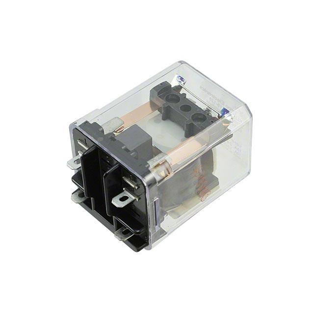

General Purpose Relays Industrial Relays Potter & Brumfield KUEP Series Panel Plug-in Relay n 1 Form X, 2 Form A and 2 Form C contact arrangements amp current rating n Magnetic blow-out n Various mounting options n Indicator lamp available n 10 Typical applications DC load switching in industrial controls Approvals Coil Data UL E22575; CSA LR15734; CE (KUEP-11 only) Technical data of approved types on request Contact Data Contact arrangement 1 form X (NO-DM), 2 form A (NO), 2 form C (CO) Rated voltage 150VDC Rated current 10A Contact material AgCdO AgSnOInO Min. recommended contact load 300mA, 12VDC Frequency of operation 360 ops./hour 360 ops./hour Operate/releases time max. 15/10ms Bounce time max. 17ms Contact ratings Type Load UL 508 KUEP, 1 form X, AgCdO 10A, 150VDC 1A, 300VDC 2.5 A, 170 VDC, resistive KUEP, 2 form A, AgCdO 5 A, 150 VDC 2.5 A, 170 VDC, resistive KUEP, 2 form C, AgCdO 3 A, 150 VDC 2.5 A, 170 VDC, resistive 10 A, 240 VAC 10 A, 32 VDC 5 FLA, 15 LRA, 250 VAC 1/3 HP, 120 VAC 5 A, 120 VAC, tungsten 1/2 HP, 250 VAC 10 FLA, 40 LRA, 125 VAC 3 A, 600 VAC 1/2 HP, 480 VAC 1/2 HP, 600 VAC 1 HP, 480 VAC, 3 phase KUEP, 1 form X, AgSnOInO 10A, 150VDC, resistive KUEP, 2 form A, AgSnOInO 5 A, 150 VDC, resistive KUEP, 2 form C, AgSnOInO 3 A, 150 VDC, resistive Mechanical endurance Cycles 100x103 100x103 100x103 100x103 Coil voltage range 5 to 125VDC 6 to 240VAC Coil insulation system according UL Class B Coil versions, DC coil Coil Rated Operate Coil Rated coil code voltage voltage resistance power VDC VDC Ω±10% W One pole versions 5 5 3.75 21 1.2 6 6 4.5 32 1.125 12 12 9.0 120 1.2 24 24 18.0 472 1.25 48 48 36.0 1800 1.3 110 110 82.5 10000 1.25 125 125 93.75 13000 1.2 Two pole versions 5 5 3.75 14 1.8 6 6 4.5 20 1.8 12 12 9.0 80 1.8 24 24 18.0 320 1.8 48 48 36.0 1250 1.85 110 110 82.5 6720 1.8 125 125 93.75 8680 1.8 All figures are given for coil without preenergization, at ambient temperature +23°C. 100x103 Coil versions, AC coil Coil Rated Operate code voltage voltage VAC VAC One pole versions 6 6 5.1 12 12 10.2 24 24 20.4 120 120 102.0 240 240 204.0 Two pole versions 6 6 5.1 12 12 10.2 24 24 20.4 120 120 102.0 240 240 204.0 100x103 All figures are given for coil without preenergization, at ambient temperature +23°C. 100x103 30x103 10x106 ops. Datasheets and product specification according to IEC 61810-1 and to be used only together with the ‘Definitions’ section. Rated coil power VA 6 24 85 2250 9110 2.0 2.0 2.0 2.1 2.1 4.2 18 72 1700 7200 2.8 2.8 2.8 2.9 2.9 Insulation Data Initial dielectric strength between open contacts between contact and coil between adjacent contacts Initial insulation resistance between insulated elements 12-2016, Rev. 1216 www.te.com © 2015 Tyco Electronics Corporation, a TE Connectivity Ltd. company Coil resistance Ω±15% Datasheets and product data is subject to the terms of the disclaimer and all chapters of the ‘Definitions’ section, available at http://relays.te.com/definitions 1200Vrms 2200Vrms 2200Vrms 100MΩ Datasheets, product data, ‘Definitions’ section, application notes and all specifications are subject to change. 1 General Purpose Relays Industrial Relays Potter & Brumfield KUEP Series Panel Plug-in Relay (Continued) Other Data Other Data (Continued) Material compliance: EU RoHS/ELV, China RoHS, REACH, Halogen content refer to the Product Compliance Support Center at www.te.com/customersupport/rohssupportcenter Ambient temperature DC coil -45ºC to 70ºC AC coil 1 pole: -45ºC to 55ºC 2 pole: -45ºC to 45ºC Category of environmental protection IEC 61810 RTI - dust protected Vibration resistance (functional) .065” double amplitude, 10-55Hz Shock resistance (functional) 15g, 11ms (non-operating) Terminal type Quick connects (QC), .187 or .205 PCB-THT Terminal retention, push force QC .205 17 lbs for 3s QC .187 25 lbs for 3s Weight 85g Packaging/unit tray/25 pcs., box/150pcs. Accessories For details see datasheet Product Code 27E893 27E121 27E043 27E046 27E067 27E396 Sockets and Accessories, KUP Relays Description DIN socket (use 20C318 clip) Track mount socket (use 20C314 clips) Chassis mount/solder eyelet socket (use 20C254 clip) Chassis mount/PCB socket (use 20C254 clip) Chassis mount/quick connect socket (use 20C254 clip) Snap-in/quick connect socket (use 20C254 clip) Dimensions Plain case Bracket mount case .312 .625 TYP. TYP. (15.88) (7.92) 1.906 MAX. (48.41) X .078 R. TYP. (1.98) 2.90 MAX. (73.7) X .75 (19.1) 1.531 MAX. (38.89) X .375 (9.53) X X 1.531 MAX. (38.89) 1 4 7 2 5 8 A 3 6 9 B 1.406 MAX. (35.71) 1.406 MAX. (35.71) .06 (1.52) .07 (1.8) Top flange case 1.906 MAX. (48.41) Core / stud mount case 1.518 MAX. (38.56) .078 TYP. (1.98) 1 4 2 5 3 6 1.713 ± .0 03 (43.51 ± .08) 7 8 9 1.373 ± .010 1.989 ± .0 03 (50.52) (34.87 ± .25) A X X .437 (11.10) 2.500 (63.50) B 1.906 MAX. (48.41) X 1.43 MAX. (36.27) .130 (3.30) 2.248 MAX. (57.10) .178 TYP. (4.52) 1.74 MAX. (44.2) STUD with #6-32 THREAD or CORE T APPED #6-32 .437 .010 (11.10 .25) X Is For Terminal Dimensions. See Teminal Drawings. .312 (7.92) 1.29 (32.8) MAX. W/ .205 (5.21) QC 1.25 (31.8) MAX. W/ .187 (4.75) QC Terminal dimensions 4.75mm (.187) quick connect 5.21mm (.205) quick connect .156 (3.96) .125 (3.18) .187±.002 (4.75±.05) HEADER .250 .078 (6.35) (1.98) 281 REF. (7.14) .020 THICKNESS (.51) 2 12-2016, Rev. 1216 www.te.com © 2015 Tyco Electronics Corporation, a TE Connectivity Ltd. company 1.19mm (.047) printed circuit .093 (2.36) .156 (3.96) .205± .0 02 (5.21± .05) HEADER .035 .285 (.89) (7.24) .316 REF. (8.03) .032 THICKNESS (.81) Datasheets and product specification according to IEC 61810-1 and to be used only together with the ‘Definitions’ section. .093 (2.36) .180 (4.57) HEADER .237 .156 (6.02) (3.96) .268 REF. (6.81) .032 THICKNESS (.81) .047 (1.19) Datasheets and product data is subject to the terms of the disclaimer and all chapters of the ‘Definitions’ section, available at http://relays.te.com/definitions Datasheets, product data, ‘Definitions’ section, application notes and all specifications are subject to change. General Purpose Relays Industrial Relays Potter & Brumfield KUEP Series Panel Plug-in Relay (Continued) PCB layout Bottom view on solder pins 1 form X version 2 form C version shown (Omit unnecessary holes for form A types) .076 DIA. TYP. (1.93) .206 (5.23) .076 DIA. TYP. (1.93) .626 (15.90) .328 (8.33) .626 (15.90) .875 (22.23) .875 (22.23) Terminal assignment 1 Form X 2 Form A 2 Form C 4 – 6 + +4 +6 – – A B A 7 – – 9 + B 1 4 7 A – – + 3 6 9 B Load polarity noted above is recommended for optimum arc suppression. Product code structure Typical product code KUEP -3 A 1 5 -120 Type KUEP Enclosed relay with magnetic blow-outs Contact arrangement and rating 3 1 form X (1 NO-DM) 7 2 form A (2 NO) 11 2 form C (2 CO) Coil Input A AC, 50/60Hz D DC Mounting and options 1 Socket mount (plain) case 3 Socket mount (plain) case, with indicator lamp 1) 5 Bracket mount case A Plain case with #6-32 stud and locating tab E Plain case with #6-32 tapped core and locating tab T Top flange case 1) Indicator lamps are available on models with the following coils: 6-24VAC and VDC, 110VDC and 120-240VAC. Only models with 120-240VAC coils are UL recognized. Terminal and contact material 5 4.75mm (.187in) quick connect/solder; AgCdO 6 5.21mm (.205in) quick connect/solder; AgCdO 7 1.19mm (.047in) PCB, AgCdO P 4.75mm (.187in) quick connect/solder; AgSnOInO R 5.21mm (.205in) quick connect/solder; AgSnOInO S 1.19mm (.047in) PCB, AgSnOInO Coil voltage Coil code: please refer to coil versions table Product Code Arrangement Material Coil Terminals Mounting Part Number KUEP-3A15-120 KUEP-3D15-12 KUEP-3D15-24 KUEP-3D15-48 KUEP-3D15-110 KUEP-3D35-24 KUEP-7D15-24 KUEP-11A15-120 KUEP-11D15-12 KUEP-11D15-24 KUEP-11D15-48 KUEP-11D15-110 1 Form X, 1 NO-DM AgCdO 120 VAC 12 VDC 24 VDC 48 VDC 110 VDC 24 VDC 4.75mm (.187in) QC Socket mount, plain case 9-1393113-4 9-1393113-8 1393114-1 1393114-2 9-1393113-7 1393114-5 1-1393114-1 8-1393113-3 8-1393113-6 8-1393113-7 8-1393113-8 8-1393113-5 2 Form A, 2 NO 2 Form C, 2 CO 12-2016, Rev. 1216 www.te.com © 2015 Tyco Electronics Corporation, a TE Connectivity Ltd. company Socket mount, plain case w/ indicator lamp Socket mount, plain case 120 VAC 12 VDC 24 VDC 48 VDC 110 VDC Datasheets and product specification according to IEC 61810-1 and to be used only together with the ‘Definitions’ section. Datasheets and product data is subject to the terms of the disclaimer and all chapters of the ‘Definitions’ section, available at http://relays.te.com/definitions Datasheets, product data, ‘Definitions’ section, application notes and all specifications are subject to change. 3
