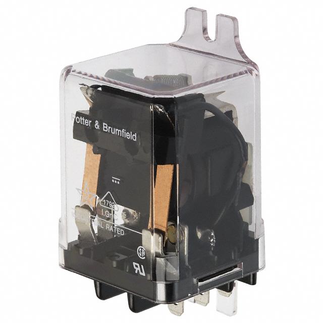

    RELAY GEN PURPOSE DPST 10A 240V
KUGP-7AT5-240 数据手册
General Purpose Relays Industrial Relays Potter & Brumfield KUIP/KUGP Series Panel Plug-in Relay n 10 amp rated relays 2 Form A (NO) and 1-3 Form C (CO) contact arrangement n KUIP 8mm coil-to-contact spacing and KUGP 3mm contact gap n Various mounting and socket styles n Typical applications Voltage control units Approvals UL E22575; CSA LR15734 Technical data of approved types on request Contact Data Contact arrangement KUGP: 2 form A (NO); 3 form A (NO) KUIP: 1 form C (CO), 2 form A (NO), 2 form C (CO), 3 form C (CO) Rated voltage 240VAC Rated current 10A Contact material Ag AgCdO Min recommended contact load 100mA, 12VDC 300mA, 12VDC Frequency of operation 360 ops./hour 360 ops./hour Operate/releases time max. 20/15ms Bounce time max. 20ms Contact ratings Type Load UL 508 Ag 5A, 240VAC 5A, 28VDC 1/6HP, 120VAC 2.5A, 120VAC, tungsten 1/3HP, 240VAC 0.5A, 120VDC 5FLA, 15LRA, 250VAC AgCdO 10A, 240VAC 10A, 32VDC 5FLA, 15LRA, 250VAC 1/3HP, 120VAC 5A, 120VAC, tungsten 1/2HP, 250VAC 0.5A, 125VDC 10FLA, 40LRA, 125VAC 3A, 600VAC 1/2HP, 480VAC 1/2HP, 600VAC 1HP, 480VAC, 3 phase Mechanical endurance Coil Data Coil voltage range Coil insulation system according UL 08-2011, Rev. 0811 www.te.com © 2011 Tyco Electronics Corporation, a TE Connectivity Ltd. company Cycles Coil versions, DC coil Coil Rated Operate code voltage voltage VDC VDC KUIP 5 5 3.75 6 6 4.5 12 12 9.0 24 24 18.0 48 48 36.0 110 110 82.5 KUGP 5 5 3.75 6 6 4.5 12 12 9.0 24 24 18.0 48 48 36.0 110 110 82.5 Coil resistance Ω±10% Rated coil power W 21 32.1 120 472 1800 10000 1.2 1.125 1.2 1.25 1.3 1.25 14 20 80 320 1250 6720 1.8 1.8 1.8 1.8 1.85 1.8 All figures are given for coil without preenergization, at ambient temperature +23°C. Coil versions, AC coil Coil Rated Operate code voltage voltage VAC VAC KUIP 1 and 2 pole 6 6 5.1 12 12 10.2 24 24 20.4 120 120 102.0 240 240 204.0 KUIP 3 pole, KUGP 6 6 5.1 12 12 10.2 24 24 20.4 120 120 102.0 240 240 204.0 Coil resistance Ω±15% Rated coil power VA 6 24 85 2250 9110 2.0 2.0 2.0 2.1 2.1 4.2 18 72 1700 7200 2.8 2.8 2.8 2.9 2.9 All figures are given for coil without preenergization, at ambient temperature +23°C. 10x106 ops. 6 to 110VDC 6 to 240VAC Class B Datasheets and product specification according to IEC 61810-1 and to be used only together with the ‘Definitions’ section. Insulation Data Initial dielectric strength between open contacts between contact and coil between adjacent contacts Initial insulation resistance between insulated elements Datasheets and product data is subject to the terms of the disclaimer and all chapters of the ‘Definitions’ section, available at http://relays.te.com/definitions KUIP 1200Vrms 2200Vrms 2200Vrms KUGP 3500Vrms 3750Vrms 3750Vrms 100MΩ, 500VDC Datasheets, product data, ‘Definitions’ section, application notes and all specifications are subject to change. 1 General Purpose Relays Industrial Relays Potter & Brumfield KUIP/KUGP Series Panel Plug-in Relay (Continued) Other Data Material compliance: EU RoHS/ELV, China RoHS, REACH, Halogen content refer to the Product Compliance Support Center at www.te.com/customersupport/rohssupportcenter Ambient temperature DC coil KUIP: -45ºC to 95ºC KUGP: -45ºC to 75ºC (1 & 2 pole) AC coil KUIP: -45ºC to 70ºC KUGP: -45ºC to 70ºC (1 & 2 pole) Category of environmental protection IEC 61810 RTI - dust protected Terminal type Quick connects (QC) .187 PCB-THT Terminal retention, push force 25 lbs for 3s Weight 85g Packaging/unit tray/25 pcs., box/150pcs. Accessories For details see datasheet Product Code 27E893 27E121 27E043 27E046 27E067 27E396 Sockets and Accessories, KUP Relays Description DIN socket (use 20C318 clip) Track mount socket (use 20C314 clips) Chassis mount/solder eyelet socket (use 20C254 clip) Chassis mount/PCB socket (use 20C254 clip) Chassis mount/quick connect socket (use 20C254 clip) Snap-in/quick connect socket (use 20C254 clip) Dimensions Plain case Bracket mount case .312 .625 TYP. TYP. (15.88) (7.92) 1.906 MAX. (48.41) X .375 (9.53) X .078 R. TYP. (1.98) .75 (19.1) 1.531 MAX. (38.89) X X 2.90 MAX. (73.7) X 2.500 (63.50) X X .437 (11.10) 1.531 MAX. (38.89) 1 4 7 2 5 8 A 1.406 MAX. (35.71) 3 6 9 B 1.906 MAX. (48.41) .07 (1.8) PCB layout Bottom view on solder pins Top flange case 1.518 MAX. (38.56) A .06 (1.52) 1.406 MAX. (35.71) .078 TYP. (1.98) 1 4 2 5 3 6 1.713 ± .0 03 (43.51 ± .08) 7 8 9 1.373 ± .010 1.989 ± .0 03 (50.52) (34.87 ± .25) B .178 TYP. (4.52) 3 Form C shown Omit unncessary holes for other contact forms .206 (5.23) .076 DIA. TYP. (1.93) .328 (8.33) .626 (15.90) 2.248 MAX. (57.10) .437 (11.10) .875 (22.23) X Is For Terminal Dimensions. See Teminal Drawings. 2 08-2011, Rev. 0811 www.te.com © 2011 Tyco Electronics Corporation, a TE Connectivity Ltd. company Datasheets and product specification according to IEC 61810-1 and to be used only together with the ‘Definitions’ section. Datasheets and product data is subject to the terms of the disclaimer and all chapters of the ‘Definitions’ section, available at http://relays.te.com/definitions Datasheets, product data, ‘Definitions’ section, application notes and all specifications are subject to change. General Purpose Relays Industrial Relays Potter & Brumfield KUIP/KUGP Series Panel Plug-in Relay (Continued) Terminal dimensions 4.75mm (.187) quick connect 1.19mm (.047) printed circuit .125 (3.18) .156 (3.96) .187±.002 (4.75±.05) HEADER .093 (2.36) .180 (4.57) HEADER .250 .078 (6.35) (1.98) 281 REF. (7.14) .020 THICKNESS (.51) .237 .156 (6.02) (3.96) .268 REF. (6.81) .032 THICKNESS (.81) .047 (1.19) Terminal assignment 1 Form C A 2 Form C 2 Form A (delete 1 & 3) 3 Form C 3 Form A (delete 1, 2 & 3) 2 1 3 1 2 3 5 4 6 4 5 6 8 7 9 7 8 9 A B A B B Product code structure Typical product code KUIP -5 A 5 5 -120 Type KUIP Enclosed relay with 8mm contact to coil spacing KUGP Enclosed relay with 3mm open contact spacing and 8mm contact to coil spacing (form A only) Contact arrangement and rating 5 1 form C (1 CO) 1) 7 2 form A (2 NO) 11 2 form C (2 CO) 1) 12 3 form A (3 NO) 14 3 form C (3 CO) 1) 1) not available on KUGP type Coil Input A AC, 50/60Hz D DC Mounting and options 1 Socket mount (plain) case 5 Bracket mount case T Top flange case Terminal and contact material 3 1.19mm (.047in) PCB, Ag 5 4.75mm (.187in) quick connect/solder; AgCdO 7 1.19mm (.047in) PCB, AgCdO Coil voltage Coil code: please refer to coil versions table Product Code Arrangement Material Coil Terminals Mounting Part Number KUGP-7D55-24 KUIP-5A55-120 KUIP-11D55-12 KUIP-11D55-24 KUIP-14A15-120 KUIP-14D15-12 KUIP-14D15-24 2 Form A, 2 NO 1 Form C; 1 CO 2 Form C; 2 CO AgCdO 24 VDC 120 VAC 12 VDC 24 VDC 120 VAC 12 VDC 24 VDC 4.75mm (.187in) QC Bracket mount case 2-1393114-4 2-1393115-0 1-1393115-0 1-1393115-1 1-1393115-4 1-1393115-6 1-1393115-7 3 Form C; 3 CO 08-2011, Rev. 0811 www.te.com © 2011 Tyco Electronics Corporation, a TE Connectivity Ltd. company Datasheets and product specification according to IEC 61810-1 and to be used only together with the ‘Definitions’ section. Socket mount, plain case Datasheets and product data is subject to the terms of the disclaimer and all chapters of the ‘Definitions’ section, available at http://relays.te.com/definitions Datasheets, product data, ‘Definitions’ section, application notes and all specifications are subject to change. 3
