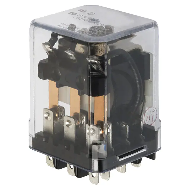

KUMP-14D18-24 数据手册
General Purpose Panel/Plug-in Relays Potter & Brumfield KUMP Series Panel Plug-in Relay n 15 amp rating arrangements 1-3 form A, 1-3 form B, 1-3 form C, 1 form X, 1 form Y, 1 form Z n Open or enclosed n Plain or bracket mount dust covers n Optional indicator lamp and push-to-test button n Several termination and mounting styles n Contact Typical applications Hospital beds, semiconductor wafer equipment, boom/bucket lifts. Approvals UL E22575; CSA LR15734 Technical data of approved types on request. Contact Data Contact arrangement 1, 2 and 3 form A (NO); 1, 2 and 3 form B (NC); 1, 2 and 3 form C (CO); 1 form X (NO-DM); 1 form Y (NC-DB); 1 form Z (CO-DB-DM) Rated voltage 277VAC Rated current 15A Contact material AgCdO AgSnOInO Min. recommended contact load 300mA, 12VDC 300mA, 12VDC Frequency of operation 360 ops./hour 360 ops./hour Operate/releases time max. 15/10ms Bounce time max. 17ms Contact ratings Type Load UL 508 AgCdO 15A, 277VAC 1/2HP, 120VAC 10A, 240VAC 10A, 32VDC 5FLA, 15LRA, 250VAC 5A, 120VAC, tungsten 0.5A, 250VAC 0.5A, 125VDC 10FLA, 40LRA, 125VAC 3A, 600VAC 1/2HP, 480VAC 1/2HP, 600VAC 1HP, 480VAC, 3 phase AgSnOInO 15A, 277VAC, pf = 0.8 10A, 277VAC, pf = 0.8 Mechanical endurance Cycles Coil versions, AC coil Coil Rated Operate code voltage voltage VAC VAC 6 6 5.1 12 12 10.2 24 24 20.4 120 120 102.0 240 240 204.0 Coil resistance Ω±15% 4.2 18 72 1700 7200 Rated coil power VA 2.8 2.8 2.8 2.9 2.9 All figures are given for coil without preenergization, at ambient temperature +23°C. Insulation Data Initial dielectric strength between open contacts between contact and coil between adjacent contacts Initial insulation resistance between insulated elements 1200Vrms 2200Vrms 2200Vrms 100MΩ, 500VDC Other Data 10x106 ops. 15x103 100x103 Coil Data Coil voltage range 5 to 110VDC 6 to 240VAC Coil insulation system according UL Class B Coil versions, DC coil Coil Rated Operate Coil Rated coil code voltage voltage resistance power VDC VDC Ω±10% W 5 5 3.75 21 1.2 6 6 4.5 32.1 1.125 12 12 9.0 120 1.2 24 24 18.0 472 1.25 48 48 36.0 1800 1.3 110 110 82.5 10000 1.25 Material compliance: EU RoHS/ELV, China RoHS, REACH, Halogen content refer to the Product Compliance Support Center at www.te.com/customersupport/rohssupportcenter Ambient temperature DC coil Enclosed relays: -45ºC to 70ºC Open relays: 15ºC higher maximum AC coil Enclosed relays, 3 pole: -45°C to +45°C Enclosed relays, 1 and 2 pole: -45ºC to +55ºC Open relays: 15°C higher maximum Category of environmental protection IEC 61810 RT0 - open relay; RTI - dust protected Terminal type Quick connects (QC), .187, .205 or .250: PCB-THT Terminal retention, push force QC .205 17 lbs for 3s QC .187, QC .250, PCB 25 lbs for 3s Weight 85g Packaging/unit tray/25 pcs., box/150pcs. Accessories For details see datasheet Product Code 27E893 27E121 27E043 27E046 27E067 27E396 Sockets and Accessories, KUP Relays Description DIN socket (use 20C318 clip) Track mount socket (use 20C314 clips) Chassis mount/solder eyelet socket (use 20C254 clip) Chassis mount/PCB socket (use 20C254 clip) Chassis mount/quick connect socket (use 20C254 clip) Snap-in/quick connect socket (use 20C254 clip) All figures are given for coil without preenergization, at ambient temperature +23°C. 03-2015, Rev. 0315 www.te.com © 2015 Tyco Electronics Corporation, a TE Connectivity Ltd. company. Catalog and product specification according to IEC 61810-1 and to be used only together with the ‘Definitions’ section. Catalog and product data is subject to the terms of the disclaimer and all chapters of the ‘Definitions’ section, available at http://relays.te.com/definitions Catalog product data, ‘Definitions’ section, application notes and all specifications are subject to change. 1 General Purpose Panel/Plug-in Relays Potter & Brumfield KUMP Series Panel Plug-in Relay (Continued) Seated Heights For KUM (open) Relays Dimensions 1.391” (35.33mm) for #6-32 stud KUM bracket type 1.437 (36.50) .19 (4.8) with .218” (5.54mm) locating tab. 2.43 MAX.* (61.72) 2.33 MAX.** (59.18) 2.29 MAX.*** (58.17) X .63 (16.0) X 2.27 MAX.* (57.7) 2.171 MAX.** (55.14) 2.125 MAX.*** (53.98) .16 (4.1) (2) #6-32 THREAD TAPPED HOLES KUM stud type 1.468 MAX. (37.29) .031 REF. (.79) 1.391 (35.33) .065 (1.65) .437 (11.10) 1.52” (38.6mm) for bracket with 2-#6 32 tapped holes. .63 (16.0) 2.27 MAX.* (57.7) 2.171 MAX.** (55.14) 2.125 MAX.*** (53.98) .218 (5.54) X .109 MAX. (2.77) 1 4 2 5 3 6 7 8 9 A .031 REF. (.79) 1.282 MAX. (35.56) 1.687 MAX. B (42.85) .150 TAB WIDTH (3.81) #6-32 THREAD with .125” (3.18mm) or .218” (5.54mm) locating tab. 2.046” (51.97mm) for relay with printed circuit terminals. .31 (7.9) 1.39 MAX.* (35.3) 1.29 MAX.** (32.8) 1.25 MAX.*** (31.8) 1.282” (32.56mm) for #6-32 tapped core STUD TYPE also available with .125” (3.18mm) tab, as well as without stud and locating tab. Models without stud have core tapped #6-32 THREAD, .25” (6.4mm) minimum depth. *Dimensions with .250” (6.35mm) terminals. ** Dimensions with .110” (2.79mm) or .205”(5.21mm) terminals. *** Dimensions with .187” (4.75mm) terminals. KUMP plain case KUMP core / stud mount case .288 (7.32) .187 (4.75) DIA. PUSH-TO-TEST BUTT ON AVAILABLE 1.531 MAX. (38.89) .219 MAX. (5.56) 1.968 MAX.† (49.99) 1.906 MAX.‡ (48.41) 1.968 MAX.† (49.99) 1.906 MAX.‡ (48.41) X 1 4 2 5 3 6 7 8 9 1.406 MAX. (35.71) 1.74 MAX. (44.2) STUD with #6-32 THREAD or CORE T APPED #6-32 .437 .010 (11.10 .25) X X X 1.43 MAX. (36.27) .130 (3.30) B A X X Is For Terminal Dimensions. See Teminal Drawings. 1.39 MAX.* (35.3) 1.29 MAX.** (32.8) 1.25 MAX.*** (31.8) .312 (7.92) KUMP top flange case 1.518 MAX. (38.56) .078 TYP. (1.98) 1 4 2 5 3 6 7 8 9 A 2.248 MAX. (57.10) † Dimensions with .250” (6.35mm) terminals. ‡ Dimensions with .187” (4.75mm and .205” 5.21mm) terminals. 1.713 ± .0 03 (43.51 ± .08) B 1.373 ± .010 1.989 ± .0 03 (34.87 ± .25) (50.52) *Dimensions with .250” (6.35mm) terminals. ** Dimensions with .110” (2.79mm) or .205”(5.21mm) terminals. *** Dimensions with .187” (4.75mm) terminals. .178 TYP. (4.52) KUMP bracket mount case 2.90 MAX. (73.7) X .75 (19.1) 1.531 MAX. (38.89) .375 (9.53) 2 KUMP stud on end case .078 R. TYP. (1.98) 2.500 (63.50) 03-2015, Rev. 0315 www.te.com © 2015 Tyco Electronics Corporation, a TE Connectivity Ltd. company. X X .437 (11.10) PUSH-TO-TEST BUTTON AVAILABLE .07 (1.8) 1.968 MAX. † (49.99) 1.906 MAX. ‡ (48.41) .38 (9.7) .085 MAX. (2.16) 1.406 M AX. (35.71) 1.128 (28.65) .312 .625 TYP. TYP. (15.88) (7.92) .06 (1.52) 1.968 MAX.† (49.99) 1.906 MAX.‡ (48.41) Catalog and product specification according to IEC 61810-1 and to be used only together with the ‘Definitions’ section. #6-32 THREAD Catalog and product data is subject to the terms of the disclaimer and all chapters of the ‘Definitions’ section, available at http://relays.te.com/definitions .16 (4.1) Catalog product data, ‘Definitions’ section, application notes and all specifications are subject to change. General Purpose Panel/Plug-in Relays Potter & Brumfield KUMP Series Panel Plug-in Relay (Continued) Relay front diagrams Models with 6.35mm (.250) QC terminals Models with all other terminals 1.531 MAX. (38.89) 1.531 MAX. (38.89) 1 4 2 5 3 6 7 9 1.406 MAX. (35.71) B A 1 4 2 5 3 6 7 8 9 A 1.406 MAX. (35.71) B Terminal dimensions 4.75mm (.187) quick connect 5.21mm (.205) quick connect .156 (3.96) .125 (3.18) .187±.002 (4.75±.05) HEADER .093 (2.36) .250 .078 (6.35) (1.98) 281 REF. (7.14) .020 THICKNESS (.51) .156 (3.96) .205± .0 02 (5.21± .05) HEADER 1.19mm (.047) printed circuit .035 (.89) .125 DIA. (3.18) .250 ± .0 03 (6.35 ± .08) .180 HEADER (4.57) HEADER .035 .285 (.89) (7.24) .316 REF. (8.03) .032 THICKNESS (.81) 6.35mm (.250) quick connect .093 (2.36) .237 .156 (6.02) (3.96) .268 REF. (6.81) .032 THICKNESS (.81) .047 (1.19) .106 (2.69) .358 REF. (9.09) .312 (7.92) .305 (7.75) .032 THICKNESS (0.81) Terminal assignment 1 form Z 1 form C 2 form C 3 form C 1 form X (delete 1 & 3) 1 form A (delete 2) 2 form A (delete 1 & 3) 3 form A (delete 1, 2 & 3) 4 & 6) 11 form Y (delete 3 6 4 1 form 2 B (delete 5) 4 & 6) 12 form B (delete 3 3 form 1 B2(delete 3 4, 5 & 6) 7 A B A 5 4 6 A B 7 B 9 4 7 A 5 8 6 9 B PCB layout Bottom view on solder pins 1 form Z version (Omit unnecessry holes for form X and Y types) .076 DIA. TYP. .206 (5.23) (1.93) 3 pole version (Omit unnecessry holes for form A and 2 pole types) .076 DIA. TYP. (1.93) .328 (8.33) .626 (15.90) .626 (15.90) .875 (22.23) 03-2015, Rev. 0315 www.te.com © 2015 Tyco Electronics Corporation, a TE Connectivity Ltd. company. .206 (5.23) .437 (11.10) .875 (22.23) Catalog and product specification according to IEC 61810-1 and to be used only together with the ‘Definitions’ section. Catalog and product data is subject to the terms of the disclaimer and all chapters of the ‘Definitions’ section, available at http://relays.te.com/definitions Catalog product data, ‘Definitions’ section, application notes and all specifications are subject to change. 3 General Purpose Panel/Plug-in Relays Potter & Brumfield KUMP Series Panel Plug-in Relay (Continued) Product code structure Typical product code KUMP -11 A 1 8 -120 Type KUM 15A open style relay KUMP 15A enclosed relay Contact arrangement 1 1 form A (1 NO) 2 1 form B (1 NC) 3 1 form X (1 NO-DM) 4 1 form Y (1 NC-DB) 5 1 form C (1 CO) 6 1 form Z (1 CO-DB-DM) 7 2 form A (2 NO) 8 2 form B (2 NC) 11 2 form C (2 CO) 12 3 form A (3 NO) 13 3 form B (3 NC) 14 3 form C (3 CO) Coil Input A AC, 50/60Hz D DC Mounting and options KUM 1 #6-32 mounting stud, 5.54mm (.218in) locating tab 2 2-hole bracket, #6-32 tapped 3 #6-32 tapped core, 3.18mm (.125in) locating tab 4 #6-32 tapped core, 5.54mm (.218in) locating tab 5 #6-32 tapped core, no locating tab KUMP 1 Socket mount (plain) case 2 Socket mount (plain) case with push-to-test button 3 Socket mount (plain) case with indicator lamp1) 4 Socket mount (plain) case with indicator lamp and push-to-test button1) 5 Bracket mount case 6 Bracket mount case with push-to-test button 7 Bracket mount case with indicator lamp1) 8 Bracket mount case with indicator lamp and push-to-test button1) 9 Plain case with #6-32 stud and locating tab on end of case A Plain case with #6-32 stud and locating tab B Plain case with #6-32 stud and locating tab, push-to-test button C Plain case with #6-32 stud and locating tab, indicator lamp1) D Plain case with #6-32 stud and locating tab, push-to-test button and indicator lamp1) E Plain case with #6-32 tapped core and locating tab F Plain case with #6-32 tapped core and locating tab, push-to-test button G Plain case with #6-32 tapped core and locating tab, indicator lamp1) H Plain case with #6-32 tapped core and locating tab, push-to-test button and indicator lamp1) T Top flange case 1) Indicator lamps are available on models with the following coils: 6-24VAC and VDC, 110VDC and 120-240VAC. Only models with 120-240VAC coils are UL recognized. Terminal and contact material 6 5.21mm (.205in) quick connect/solder; AgCdO 8 4.75mm (.187in) quick connect/solder; AgCdO 9 1.19mm (.047in) PCB, AgCdO G 6.35mm (.250in) quick connect/solder; AgCdO 2) R 5.21mm (.205in) quick connect/solder; AgSnOInO T 4.75mm (.187in) quick connect/solder; AgSnOInO U 1.19mm (.047in) PCB, AgSnOInO V 6.35mm (.250in) quick connect/solder; AgSnOInO 2) 2) 6.35mm (.250in) quick connect/solder terminals are not available on 3 pole relays Coil voltage Coil code: please refer to coil versions table 4 Product Code Arrangement Material Coil Terminals Mounting Part Number KUMP-11A18-24 KUMP-11A18-120 KUMP-11A18-240 KUMP-11D18-12 KUMP-11D18-24 KUMP-11D18-110 KUMP-14A18-24 KUMP-14A18-120 KUMP-14D18-12 KUMP-14D18-24 2 form C; 2 CO AgCdO 24 VAC 120 VAC 240 VAC 12 VDC 24 VDC 110 VDC 24 VAC 120 VAC 12 VDC 24 VDC 4.75mm (.187in) QC Socket mount, plain case 6-1393116-3 6-1393116-2 6-1393116-4 7-1393116-1 7-1393116-2 7-1393116-0 8-1393116-5 8-1393116-4 9-1393116-0 9-1393116-1 3 form C, 3 CO 03-2015, Rev. 0315 www.te.com © 2015 Tyco Electronics Corporation, a TE Connectivity Ltd. company. Catalog and product specification according to IEC 61810-1 and to be used only together with the ‘Definitions’ section. Catalog and product data is subject to the terms of the disclaimer and all chapters of the ‘Definitions’ section, available at http://relays.te.com/definitions Catalog product data, ‘Definitions’ section, application notes and all specifications are subject to change.
