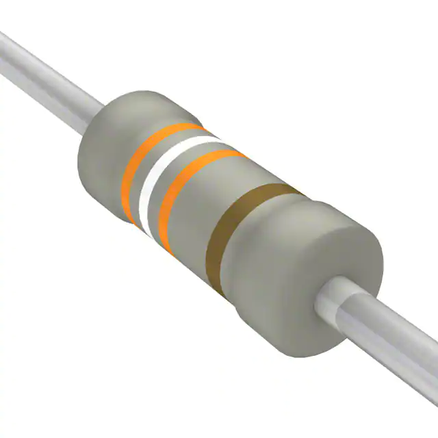

Metal Film Fixed Resistors Type LR Series Key Features I Superior quality metal film resistors with 1% tolerance and temperature coefficients down to 50 ppm. 3 case sizes are available in 0.25, 0.6, 0.75W. The LR1L series is a low ohmic value range from 0.1 to 0.82 ohm. Ideally suited where low resistance and small size are required. I Metal film resistors have excellent stability under load and severe environmental conditions. They exhibit very low noise current and voltage coefficients. They are available in a wide range of resistance values and are suitable for general purpose and precision applications. The resistive element comprises a thin film of nickel-chrome alloy evaporated onto a high thermal conductivity ceramic element. Metal end caps are force fitted to the element prior to spiralling to value. Tinned copper lead wires are welded to the end caps and the components are then coated. One coat of phenolic resin is followed by three coats of epoxy resin. All resistors are tested for value and tolerance. Characteristics - Electrical LR0204 LR1L LR1 LR2 LR100 0.25 0.5 0.6 0.75 1 2 10R 10R Rated Power @ 70°C (W) Resistance Range (Ohms) Min 1R0 10R R10 Max 10R 1M1 1R0 9R1 1M0 10M 1M0 9R1 1M0 R82 Tolerance (%) 1 1 5 Code Letter F F J Temp. Coefficient (ppm/°C) ± 100 ± 100 ± 200 ± 100 ± 50 ± 100 Selection Series E24 E24 E12 E24 E24 E24 On Request E96 1 1 22 0.5 1 1 22 0.5 1 1 55 1 0.5 DF F GG DF F GG DF F JJ F 1M0 1M0 2 1 5 1 5 G F J F J ± 100 25/50/100 25/50/100 E24 E24 E24 E96 E96 E96 E96 Limiting Element Voltage 200 350 350 350 500 500 Max Permitted Element Voltage 200 350 350 350 500 500 400 500 700 700 1000 1000 750 750 750 1000 1000 700 700 700 Max Overload Voltage Max Intermittent Overload Voltage 500 Operating Temp. Range (°C) -55 to +155 Climatic Category Dielectric Strength (V) 55/155/56 500 700 Insulation Resistance Min Dry (Mohms) 1773241 CIS BI 06/2011 1R0 LR200 Dimensions are in millimeters and inches unless otherwise specified. Values in brackets are standard equivalents. 700 1000 Dimensions are shown for reference purposes only. Specifications subject to change. For email, phone or live chat, go to: te.com/help Metal Film Fixed Resistors Type LR Series Dimensions Style L* D d Nom l LR0204 3.5 +/-0.2 2.0 max 0.45 28 +/-3.0 28 +/-3.0 LR1 6.2 +/-0.5 2.3 +/-0.2 0.55 LR1L 6.2 +/-0.5 2.3 +/-0.2 0.55 28 +/-3.0 LR2 9.7 +/-0.3 3.5 +/-0.2 0.55 28 +/-3.0 LR100 12.0 max 5.0 max 0.7 28 +/-3.0 LR200 12.0 max 5.5 max 0.7 28 +/-3.0 * Length is measured in accordance with IEC 294. Power Derating Curve 100 Rated Power (%) 80 60 40 20 0 0 20 40 60 70 80 100 120 125 Ambient Temperature (°C) Temperature Rise above Ambient (°C) Surface Temperature Rise Vs Load 100 LR1L LR1 80 LR2 60 LR0204 40 20 0 0 0 0.2 0.25 0.4 0.6 0.75 Power Dissipation (W) 1773241 CIS BI 06/2011 Dimensions are in millimeters and inches unless otherwise specified. Values in brackets are standard equivalents. Dimensions are shown for reference purposes only. Specifications subject to change. For email, phone or live chat, go to: te.com/help Metal Film Fixed Resistors Type LR Series Mounting The resistors are suitable for processing on automatic insertion equipment and cutting and bending machines. Marking The resistors are marked with a colour band code in accordance with JIS C 0802. Packaging LR0204, LR1L and LR1 resistors are normally supplied taped in 'ammo' boxes of 4000 pieces. LR2 resistors are normally supplied taped in 'ammo' boxes of 1000 pieces. Other package styles on request. All tape specifications are in accordance with IEC 286-1. Performance Characteristics The evaluation of the performance characteristics is carried out with reference to IEC Specifications QC 400 000 and QC 400 100. TEST REF Long Term Tests ±(1% + 0.05 ohm) 4.23 Climatic sequence 4.24 Damp heat, steady state 4.25.1 Endurance at 70°C 4.25.3 Endurance at 125°C TEST REF Short Term Tests ±(0.25% + 0.05 ohm) 4.13 Overload 4.16 Robustness of terminations 4.18 Resistance to soldering heat 4.19 Rapid change of temperature 4.22 Vibration * For LR1L the limits are ± (5% + 0.1 ohm) and ± (1% + 0.05 ohm) respectively. All resistance values are measured at a distance of 12mm from the end cap. How to Order LR Common Part 1 F Style Tolerance Value J - 5% 100 ohm (100 ohms) 100R 0204 - 0.25W 1L - 0.5W LR - Metal Film Fixed Resistor 1 - 0.6W G - 2% 2 - 0.75W F - 1% 100 - 1W 200 - 2W D - 0.5% 100R 1K0 (1000 ohms) 1K0 100 K ohm (100,000 ohms) 100K TE Connectivity, TE connectivity (logo) and TE (logo) are trademarks. Other logos, product and Company names mentioned herein may be trademarks of their respective owners. While TE has made every reasonable effort to ensure the accuracy of the information in this datasheet, TE does not guarantee that it is error-free, nor does TE make any other representation, warranty or guarantee that the information is accurate, correct, reliable or current. TE reserves the right to make any adjustments to the information contained herein at any time without notice. TE expressly disclaims all implied warranties regarding the information contained herein, including, but not limited to, any implied warranties of merchantability or fitness for a particular purpose. The dimensions in this datasheet are for reference purposes only and are subject to change without notice. Specifications are subject to change without notice. Consult TE for the latest dimensions and design specifications.

物料型号:TE Connectivity的金属膜固定电阻器,型号为LR系列。
器件简介:这些电阻器具有1%的容差和低至50ppm的温度系数。提供三种尺寸,分别为0.25W、0.6W和0.75W。LR1L系列是低阻值范围,从0.1欧姆到0.82欧姆,非常适合需要低电阻和小尺寸的应用。
引脚分配:文档中未明确提供引脚分配信息,但通常这类电阻器会有两端引脚用于连接电路。
参数特性:电阻器在负载和恶劣环境条件下具有出色的稳定性,表现出非常低的噪声电流和电压系数。它们提供广泛的电阻值范围,适用于通用和精密应用。
功能详解:电阻元件由镍铬合金薄膜构成,蒸发在高热导性的陶瓷元件上。金属端盖在螺旋绕制前被强力固定到元件上。锡铜引线焊接到端盖上,然后对组件进行涂层处理。
应用信息:这些电阻器适用于需要低电阻和小尺寸的应用场合,例如在电源电路、信号处理电路等。
封装信息:提供多种尺寸的封装,包括LR0204、LR1、LR1L、LR2、LR100和LR200,具体尺寸数据在文档中有详细描述。
