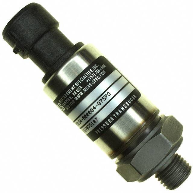

M5100 Heavy Industrial Pressure Transducer • CE Compliance • Wide Temperature Range • Compact • Variety of Pressure Ports and Electrical Configurations DESCRIPTION The M5100 series pressure transducers from the Microfused™ line of MEAS, set a new price performance standard for demanding commercial and heavy industrial applications. This series is suitable for measurement of liquid or gas pressure, even for difficult media such as contaminated water, steam, and mildly corrosive fluids. The transducer pressure cavity is machined from a solid piece of 17-4 PH stainless steel. The standard version includes a 1/4 NPT pipe thread allowing a leak-proof, all metal sealed system. There are no O-rings, welds or organics exposed to the pressure media. The durability is excellent. The M5100 exceeds the latest heavy industrial CE requirements including surge protection, and is over voltage protected to 16Vdc in both positive and reverse polarity. This product is geared to the OEM customer who uses medium to high volumes. The standard version is suitable for many applications, but the dedicated design team at our Transducer Engineering Center stands ready to provide a semi-custom design where the volume and application warrants. FEATURES • • • • • • • APPLICATIONS Heavy Industrial CE Approval 100 V/m EMI Protection Reverse Polarity Protection Extended Temperature Range 1% Total Error Band Compact Outline -40°C to +125°C Operating Temperature Range M5100 • • • • • • • • Advanced HVAC Systems Refrigeration Systems Automotive Test Stands Industrial Process Control Pumps and Compressors Hydraulic/Pneumatic Systems Agriculture Equipment Energy Generation and Management www.meas-spec.com 1/7 June 2012 M5100 Heavy Industrial Pressure Transducer STANDARD RANGES Range 0 to 50 0 to 100 0 to 200 0 to 300 0 to 500 0 to 1k 0 to 3k 0 to 5k 0 to 10k psig • • • • • • • • • Range 0 to 3.5 0 to 7 0 to 14 0 to 20 0 to 35 0 to 70 0 to 200 0 to 350 0 to 700 Barg • • • • • • • • • DIN Range Barg 0 to 4 • 0 to 6 • 0 to 10 • 0 to 16 • 0 to 25 • 0 to 40 • 0 to 60 • 0 to 100 • 0 to 160 • 0 to 250 • 0 to 400 • 0 to 600 • 0 to 1000 • *Intermediate ranges available upon request. CONNECTION/ PRESSURE RANGE/ PRESSURE REF PRESSURE RANGE PG/BG PRESS REF 500 PSI 040BAR CODE CONNECTION 1 CABLE 2 FEET ALPHA#3243,18AWG DIM A 1.71 [ 43.5 ] 1.92 [ 48.6 ] DIM B 2.17 [ 55.2 ] 2.38 [ 60.5 ] 4 PACKARD CONNECTOR SUPPLY ON PIN A DIM A 1.71 [ 43.4 ] 1.92 [ 48.6 ] DIM B 2.53 [ 64.3 ] 2.72 [ 69.1 ] BENDIX PTIH-10-6P CONNECTOR DIM A 1.74 [ 44.2 ] 1.93 [ 49.0 ] DIM B 2.17 [ 55.0 ] 2.36 [ 59.8 ] DIM A 1.67 [ 42.3 ] 1.86 [ 47.1 ] 6 HIRSCHMANN CONNECTOR DIN 43650 FORM C DIM B 2.12 [ 53.8 ] 2.31 [ 58.6 ] DIM A 2.12 [ 53.8 ] 2.12 [ 53.8 ] 7 HIRSCHMANN CONNECTOR DIN 43650 FORM A DIM B 2.64 [ 67.1 ] 2.64 [ 67.1 ] 9 PACKARD CONNECTOR SUPPLY ON PIN B DIM A 1.71 [ 43.5 ] 1.92 [ 48.8 ] DIM B 2.53 [ 64.3 ] 2.72 [ 69.1 ] DIM A 1.69 [ 42.9 ] 1.90 [ 48.3 ] DIM B 2.21 [ 56.1 ] 2.41 [ 61.2 ] 1.92 [ 48.6 ] 5 D M12 CONNECTOR M CABLE 1 METER MANHATTAN#M39114,22AWG DIM A 1.71 [ 43.5 ] DIM B 2.17 [ 55.2 ] 2.38 [ 60.5 ] P CABLE 5 METER MANHATTAN#M39114,22AWG DIM A 1.71 [ 43.5 ] 1.92 [ 48.6 ] DIM B 2.17 [ 55.2 ] 2.38 [ 60.5 ] CABLE 10 METER MANHATTAN#M39114,22AWG DIM A 1.71 [ 43.5 ] 1.92 [ 48.6 ] DIM B 2.17 [ 55.2 ] 2.38 [ 60.5 ] R M5100 www.meas-spec.com 2/7 June 2012 M5100 Heavy Industrial Pressure Transducer PERFORMANCE SPECIFICATIONS Ambient Temperature: 25°C (unless otherwise specified) PARAMETERS Accuracy (combined non linearity, hysteresis, and repeatability) Isolation, Body to any Lead Pressure Cycles (Zero to Full Scale) MIN TYP -0.25 MAX UNITS NOTES 0.25 %F.S. 1 1 MΩ @ 25Vdc 1.00E+7 FS Cycles Proof Pressure 2X Rated Burst Pressure 5X Rated Long Term Stability (1 year) -0.25 0.25 %Span Total Error Band -1.0 1.0 %F.S. Compensated Temperature -20 +85 °C 2 Operating Temperature -40 +125 °C 3 Storage Temperature -40 +125 °C 3 Load Resistance (RL) RL > 100k Bandwidth DC to 1KHz (Typical) Shock 50g, 11msec Half Sine Shock per MIL-STD-202G, Method 213B, Condition A Vibration ±20g, MIL-STD-810C, Procedure 514.2, Fig 514.2-2, Curve L 4 For custom configurations, consult factory. Notes 1. Best fit straight line at 25°C. 2. TEB includes all accuracy errors, thermal errors, span and zero tolerances. 3. Cable 105°C max. 4. Voltage output. CE Compliance IEC 55022 Emissions Class A & B IEC 61000-4-2 Electrostatic Discharge Immunity (6kV contact/8kV air) IEC 61000-4-3 Electromagnetic Field Immunity (30V/m) IEC 61000-4-4 Electrical Fast Transient Immunity (1kV) IEC 61000-4-5 Surge Immunity (1kV) IEC 61000-4-6 Conducted RF Immunity (10V) IEC 61000-4-9 Magnetic Field Immunity (100A/m) M5100 www.meas-spec.com 3/7 June 2012 M5100 Heavy Industrial Pressure Transducer DIMENSIONS M5100 www.meas-spec.com 4/7 June 2012 M5100 Heavy Industrial Pressure Transducer 1 3 4 2 M5100 www.meas-spec.com 5/7 June 2012 M5100 Heavy Industrial Pressure Transducer M5100 www.meas-spec.com 6/7 June 2012 M5100 Heavy Industrial Pressure Transducer OUTPUT OPTIONS Code 3 4 5 6 7 8 Output 0.5 – 4.5V (ratiometric) 1 – 5V 4 – 20mA 0 – 5V 0 – 10V 1 – 6V Supply (V) 5 ± 0.25 Ratiometric 8 – 30 9 – 30 8 – 30 15 – 30 8 – 30 ORDERING INFORMATION M5131-000005-300PG Type (G = Gage) Units (P = psi, B = Bar) Pressure Range (See Pressure Range Table) Pressure Port (See Pressure Port Options Table) Specials (nnnnn = Custom Drawing) Connection (See Electrical Connections Table) Output (See Output Options Table) Model NORTH AMERICA EUROPE Measurement Specialties 45738 Northport Loop West Fremont, CA 94538 Tel: 1-800-767-1888 Fax: 1-510-498-1578 Sales: pfg.cs.amer@meas-spec.com Measurement Specialties (Europe), Ltd. 26 Rue des Dames 78340 Les Clayes-sous-Bois, France Tel: +33 (0) 130 79 33 00 Fax: +33 (0) 134 81 03 59 Sales: pfg.cs.emea@meas-spec.com ASIA Measurement Specialties (China), Ltd. No. 26 Langshan Road Shenzhen High-Tech Park (North) Nanshan District, Shenzhen 518057 China Tel: +86 755 3330 5088 Fax: +86 755 3330 5099 Sales: pfg.cs.asia@meas-spec.com The information in this sheet has been carefully reviewed and is believed to be accurate; however, no responsibility is assumed for inaccuracies. Furthermore, this information does not convey to the purchaser of such devices any license under the patent rights to the manufacturer. Measurement Specialties, Inc. reserves the right to make changes without further notice to any product herein. Measurement Specialties, Inc. makes no warranty, representation or guarantee regarding the suitability of its product for any particular purpose, nor does Measurement Specialties, Inc. assume any liability arising out of the application or use of any product or circuit and specifically disclaims any and all liability, including without limitation consequential or incidental damages. Typical parameters can and do vary in different applications. All operating parameters must be validated for each customer application by customer’s technical experts. Measurement Specialties, Inc. does not convey any license under its patent rights nor the rights of others. M5100 www.meas-spec.com 7/7 June 2012

物料型号:M5100 Heavy Industrial Pressure Transducer
器件简介:M5100系列压力变送器来自MEAS的Microfused™系列,为要求苛刻的商业和重型工业应用设定了新的性价比标准。该系列适用于测量液体或气体压力,甚至适用于难以处理的介质,如污染水、蒸汽和轻度腐蚀性液体。

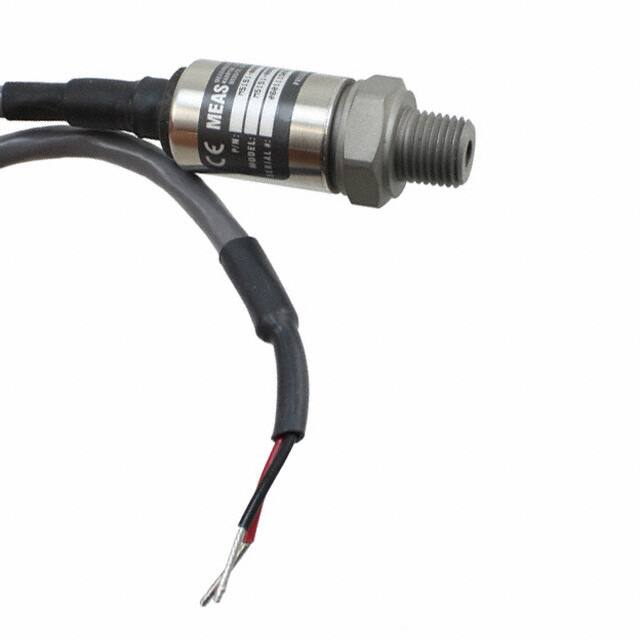

引脚分配:文档中提供了多种电气连接选项,包括不同长度的电缆、不同类型的连接器(如Packard、Bendix、Hirschmann等),以及相应的引脚分配信息。
参数特性: - 精度:总误差带为±1% F.S. - 工作温度范围:-40°C至+125°C - 隔离:身体到任何引脚1MQ@25Vdc - 压力循环:1.00E+7个零到全量程循环 - 校验压力:额定值的2倍 - 爆破压力:额定值的5倍 - 长期稳定性(1年):±0.25% Span - 补偿温度:-20°C至+85°C - 供电电压:多种输出选项,如0.5-4.5V、1-5V、4-20mA等
功能详解:M5100压力变送器具有重型工业CE认证、100V/m电磁干扰保护、反极性保护、扩展温度范围等特性。
应用信息: - 高级暖通空调系统 - 制冷系统 - 汽车测试台 - 工业过程控制 - 泵和压缩机 - 液压/气动系统 - 农业设备 - 能源产生和管理
封装信息:变送器压力腔由一整块17-4 PH不锈钢加工而成。标准版本包括1/4英寸NPT管螺纹,允许无泄漏、全金属密封系统。没有暴露在压力介质中的O形圈、焊缝或有机物。
