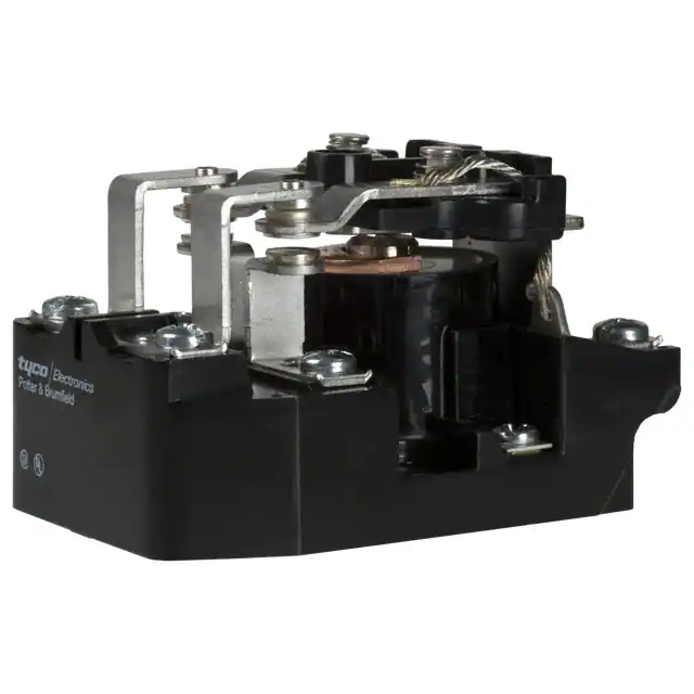

General Purpose Panel/Plug-in Relays Potter & Brumfield PRD Series Power Relay n Contact ratings to 50A blowouts available for switching DC loads n Contact arrangement up to 2 form C (2CO) n 1 form C auxiliary switch available n UL class B insulation n Magnetic Typical applications Industrial controls, lighting. Approvals UL E22575; CSA LR15734; VDE 40020133 (available only on PRD with DC coil and Termination code 1) Models with all screw terminals are UL Listed. Others are UL Recognized. Technical data of approved types on request. Contact Data Contact arrangement 1 and 2 form A (NO); 1 and 2 form C (CO); 1 form X (NO-DM) Rated voltage 600VAC,125VDC Rated current 50A Contact material Ag, AgCdO, W Min. recommended contact load 1A, 12VDC or 12VAC Initial contact resistance 75mΩ max. Initial voltage drop 75mV Frequency of operation 7200 ops/hr Operate/releases time max. 40/20ms Bounce time max. 10ms Contact ratings Type Load Cycles UL 5081) Models with screws or quick connects for main terminals Code Y, Ag, 1 pole 25A, 277VAC 100x103 1HP, 120VAC 100x103 2HP, 250VAC 100x103 10A, 600VAC 100x103 7A, 50VDC, resistive 100x103 Code Y, Ag, 2 pole 25A, 240VAC 100x103 20A, 277VAC 100x103 1HP, 120VAC 100x103 2HP, 250VAC 100x103 7A, 50VDC, resistive 100x103 10A, 600VAC 100x103 Code G, AgCdO, 1 pole 30A, 277VAC, resistive 100x103 1.5HP, 120VAC 100x103 2HP, 250VAC 100x103 10A, 600VAC 100x103 Code G, AgCdO, 2 pole 30A, 240VAC 100x103 20A, 277VAC 100x103 1.5HP, 120VAC 100x103 2HP, 250VAC 100x103 10A, 600VAC 100x103 1) Any PRD relay deviating electrically or physically from the standard models in the table is not UL or CSA listed. All horsepower ratings are for single phase motors.. 06-2016, Rev. 0616 www.te.com © 2015 Tyco Electronics Corporation, a TE Connectivity Ltd. company. Catalog and product specification according to IEC 61810-1 and to be used only together with the ‘Definitions’ section. Contact ratings (continued) Type Load Cycles UL 5081) Models with screws or quick connects for main terminals Code F, AgCdO, 1 pole 50A, 240VAC, general purpose2) 20x103 30A, 277VAC, resistive 100x103 1.5HP, 120VAC 100x103 2HP, 250VAC 100x103 10A, 600VAC 100x103 Code F, AgCdO, 2 pole 50A, 240VAC, general purpose2) 20x103 30A, 240VAC 100x103 20A, 277VAC 100x103 1.5HP, 120VAC 100x103 2HP, 250VAC 100x103 10A, 600VAC 100x103 2) In order to achieve 50A rating with contact code F, termination Code 0 or A is required. Code H, Ag with magnetic blowout, 1 or 2 pole 20A, 125VDC 1/3HP, 125VDC Code J, AgCdO with magnetic blowout, 1 or 2 pole 20A, 125VDC 1/3HP, 125VDC Code N, W stationary with AgCdO movable, 1 or 2 pole 25A, 250VAC 1HP, 125VAC 2HP, 250VAC UL 5081) Models with box lugs for main terminals Code P, Ag, 1 form X 50A, 277VAC, general purpose 30A, 277VAC, ballast 15A, 277VAC, tungsten 102LRA, 17FLA, 240VAC 120LRA, 20FLA, 120VAC 1.5HP, 120VAC 3HP, 240VAC Factory ratings Models with box lugs for main terminals Code R, Ag with magnetic blowout, 1 form X 60A, 28VDC, resistive 30A, 125VDC Mechanical endurance 100x103 100x103 100x103 100x103 100x103 100x103 100x103 100x103 6x103 6x103 30x103 30x103 30x103 30x103 100x103 100x103 DC Coil, 1x106 ops.; AC Coil 5x105 ops. Auxiliary Snap-Action Switch Contact Data Contact arrangement Rating Contact material Catalog and product data is subject to the terms of the disclaimer and all chapters of the ‘Definitions’ section, available at http://relays.te.com/definitions 1 form C (CO) 5A, 120VAC, 60Hz., 25°C Ag Catalog product data, ‘Definitions’ section, application notes and all specifications are subject to change. 1 General Purpose Panel/Plug-in Relays Potter & Brumfield PRD Series Power Relay (Continued) Coil Data Coil voltage range 6 to 110VDC 6 to 480VAC Coil insulation system according UL Class B Coil versions, DC coil Coil Rated Operate Release Coil Rated coil code voltage voltage voltage resistance power VDC VDC VDC Ω±10% W 6 6 4.5 0.6 18 2 12 12 9 1.2 71 2 24 24 18 2.4 288 2 48 48 36 4.8 1150 2 110 110 82.5 11 6050 2 All figures are given for coil without preenergization, at ambient temperature +23°C. Other coil voltages on request. Insulation Data Initial dielectric strength between open contacts between contact and coil between adjacent contacts Initial insulation resistance between insulated elements 2000Vrms 2000Vrms 2000Vrms 100MΩ Other Data Material compliance: EU RoHS/ELV, China RoHS, REACH, Halogen content refer to the Product Compliance Support Center at www.te.com/customersupport/rohssupportcenter Ambient temperature AC coil: -55ºC to 45ºC DC coil: -55°C to 80°C Category of environmental protection IEC 61810 RT0 - open relay Terminal type Screw, Quick connects, Box lugs Weight 284g Packaging/unit tray/20 pcs., box/40pcs. Coil versions, AC coil Coil Rated Operate Release Coil Rated coil code voltage voltage voltage resistance power VAC VAC VAC Ω±15% VA 6 6 5.1 0.6 0.86 9.8 12 12 10.2 1.2 3.2 9.8 Accessories 24 24 20.4 2.4 12 9.8 120 120 102 12 290 9.8 Product Code Description 240 240 204 24 1200 9.8 35D013 Metal dust cover 480 480 408 48 4500 9.8 All figures are given for coil without preenergization, at ambient temperature +23°C. Other coil voltages on request. Dimensions PRD/PRDA 1, 3, 5 and 7 PRD/PRDA 11 2.5 MAX. (63.3) .81 (20.6) .875 MAX. (22.23) 4 2 .31 (7.9) 1 3.375 MAX. (85.73) 4 6 2.51 MAX. (63.75) COIL 3 .875 MAX. (22.23) 2 6 2.51 MAX. 2.50 (63.5) (63.8) 1.875 1.875 (47.63) (47.63) 5 1 ( ) ( ) ) 6 COIL 1 2 MTG. HOLES DIA. .187 + .005 – .003 4.75 + .13 – .08 2 MTG. HOLES DIA. .187 + .005 – .003 4.75 + .13 – .08 2 MTG. HOLES DIA. .187 + .005 – .003 4.75 + .13 – .08 .31 (7.9) 2 8 7 3 ( .31 (7.9) 1.687 (42.85) COIL 1.875 (47.63) 5 PRD-3_P and R BOX LUG CONNECTOR 5 .81 (20.6) .59 MAX. (15.0) 2.5 MAX. (64) 2.28 MAX. (57.9) 2.50 MAX. (63.5) 2.50 MAX. ON PRD7 (63.5) .375 (9.53) 2.23 3.375 (56.6) (85.73) 2.5 MAX. (63.5) W/O AUX SWITCH 2 06-2016, Rev. 0616 www.te.com © 2015 Tyco Electronics Corporation, a TE Connectivity Ltd. company. 3.00 .375 4.250 MAX. (76.2) (9.53) (107.95) 3.375 MAX. W/O AUX SWITCH (85.73) Catalog and product specification according to IEC 61810-1 and to be used only together with the ‘Definitions’ section. Catalog and product data is subject to the terms of the disclaimer and all chapters of the ‘Definitions’ section, available at http://relays.te.com/definitions 2.28 MAX. (57.9) .375 (9.53) Catalog product data, ‘Definitions’ section, application notes and all specifications are subject to change. General Purpose Panel/Plug-in Relays Potter & Brumfield PRD Series Power Relay (Continued) Terminal assignment for models with magnetic blowout PRD3 with blowout PRD7 with blowout PRD 11 with blowout THIS SIDE OF MAGNET ATTRACTS NORTH SEEKING POLE OF COMPASS. THIS SIDE OF MAGNET ATTRACTS NORTH SEEKING POLE OF COMPASS. - - + POLARITY MARKING THIS SIDE OF MAGNET ATTRACTS NORTH SEEKING POLE OF COMPASS. - + POLARITY MARKING POLARITY MARKING Product code structure - Typical product code PRD -7 A Y 0 -120 Type PRD Open relay PRDA Open relay with aux. 1 form C (CO) snap-action switch Main contact arrangement 1 1 form A (1 NO) 3 1 form X (1 NO-DM) 5 1 form C (1 CO) 7 2 form A (2 NO) 7V 2 form A (2 NO) with 3mm contact gap 1) 11 2 form C (2 CO) 1) Code 7V is only available as a UL Recognized model, not UL Listed Coil input A AC, 50/60Hz D DC Main contact material and type Y .312” (7.92mm) dia. Ag [25A max. rating] G .312” (7.92mm) dia. AgCdO [30A max. rating] F .312” (7.92mm) dia. AgCdO [50A max. rating] 2) H Ag with magnetic blowout [20A DC max. rating] 3) J AgCdO with magnetic blowout [20A DC max. rating] N W stationary & AgCdO movable [25A max. rating] 4) P Ag [50A max. rating] 5) R Ag with magnetic blow out [50A max. rating] 5) 2) Available with Main contact arrangement code 1, 5, 7 or 11 only, and Termination code 0 or A only. 3) Available with Main contact arrangement code 3, 7 or 11 only 4) Available with Main contact arrangement code 1, 5, 7 or 11 only. 5) Available with Main contact arrangement code 3 only, and Termination code 4 only. Termination PRD types only 0 #8-32 screw term. for main contacts, #6-32 screw term. for coil. 1 .250” (6.35mm) QC for main contacts and coil (VDE approved Termination code) 3 #8-32 screw term. for main contacts, .250” (6.35mm) QC for coil. 4 Box lug term. which accept #6 - #14 wire for main contacts, #6-32 screw term. for coil. 6) 6) Available with Main contact arrangement code 3 only, and Main contact material code P or R only. PRDA (with aux. switch) types only A #8-32 screw term. for main contacts, #6-32 screw term. for coil, screw term. for aux. switch B .250” (6.35mm) QC for main contacts, coil and aux. switch L Twin .250” (6.35mm) QC for main contacts, .250” (6.35mm) QC for coil and aux. switch Coil voltage Coil code: please refer to coil versions table 06-2016, Rev. 0616 www.te.com © 2015 Tyco Electronics Corporation, a TE Connectivity Ltd. company. Catalog and product specification according to IEC 61810-1 and to be used only together with the ‘Definitions’ section. Catalog and product data is subject to the terms of the disclaimer and all chapters of the ‘Definitions’ section, available at http://relays.te.com/definitions Catalog product data, ‘Definitions’ section, application notes and all specifications are subject to change. 3 General Purpose Panel/Plug-in Relays Potter & Brumfield PRD Series Power Relay (Continued) Product Code Arrangement Material Coil Terminals Part Number PRD-3AY0-120 PRD-3AG0-120 PRD-3AJ0-120 PRD-3AJ3-24 PRD-3DH0-24 PRD-3DY0-12 PRD-3DY0-24 PRD-3DY0-110 PRD-5AY0-24 PRD-5AY0-120 PRD-5AY1-120 PRD-5AY0-240 PRD-5DF0-12 PRD-5DY0-12 PRD-5DY0-24 PRD-7AG0-120 PRD-7AY0-24 PRD-7AY0-120 PRD-7AY0-240 PRD-7AY3-120 PRD-7DG0-24 PRD-7DH0-48 PRD-7DY0-12 PRD-7DY0-24 PRD-11AF0-240 PRD-11AG0-24 PRD-11AG0-120 PRD-11AG0-240 PRD-11AH0-120 PRD-11AY0-24 PRD-11AY0-120 PRD-11AY0-240 PRD-11AY0-480 PRD-11DF0-12 PRD-11DF0-110 PRD-11DG0-12 PRD-11DG0-24 PRD-11DH0-12 PRD-11DH0-24 PRD-11DH0-48 PRD-11DH0-110 PRD-11DJ0-24 PRD-11DY0-12 PRD-11DY0-24 PRD-11DY0-48 PRD-11DY0-110 PRDA-11AGA-120 PRDA-11AYA-120 1 form X, 1 NO-DM Ag AgCdO, 30A AgCdO, mag blowout 120VAC Screw 24VAC 24VDC 12VDC 24VDC 110VDC 24VAC 120VAC Screw / QC Screw 7-1393127-9 6-1393127-9 7-1393127-4 7-1393127-5 8-1393127-6 9-1393127-5 9-1393127-6 9-1393127-4 1393128-6 1393128-5 1-1393128-1 1393128-7 2-1423100-4 1-1393128-6 1-1393128-7 9-1393129-5 1393130-9 1393130-7 1-1393130-0 1-1393130-2 1-1393130-6 2-1393130-1 2-1393130-8 2-1393130-9 3-1423100-0 1-1393127-1 1393127-9 1-1393127-2 1-1393127-6 2-1393127-9 2-1393127-6 3-1393127-0 3-1393127-1 2-1423100-2 2-1423100-9 3-1393127-5 3-1393127-8 4-1393127-7 4-1393127-9 5-1393127-0 4-1393127-6 5-1393127-5 6-1393127-1 6-1393127-2 6-1393127-3 6-1393127-0 7-1393131-4 7-1393131-9 Ag, mag blowout Ag 1 form C, 1 CO AgCdO, 50A Ag 2 form A, 2 NO 24VDC 120VAC 24VAC 120VAC 240VAC 120VAC 24VDC 48VAC 12VDC 24VDC 240VAC 24VAC 120VAC 240VAC 120VAC 24VAC 120VAC 240VAC 480VAC 12VDC 110VDC 12VDC 24VDC 12VDC 24VDC 48VDC 110 VDC 24 VDC 12 VDC 24 VDC 48 VAC 110 VDC 120 VAC AgCdO, 30A Ag AgCdO, 30A Ag, mag blowout Ag 2 form C, 2 CO QC Screw 240VAC 12VDC AgCdO, 50A AgCdO, 30A Ag, mag blowout Ag AgCdO, 50A AgCdO, 30A Ag, mag blowout AgCdO, mag blowout Ag AgCdO, 30A Screw / QC Screw PRD accessory Product Code Description 35D013 Part Number Metal dust cover enclosure 35D013 Dust Cover PRD dust cover has a steel base with knockouts for 0.5” (12.7mm) dia. conduit and a cover fitted with two screws. Fits PRD relays, except with auxiliary contacts. Finished in gray baked enamel. Mounting: Three No. 10 holes on 1.875” (47.63mm) x 4.125” (104.77mm) centers. 5-1393158-2 5.31 MAX. (134.9) 4.125 (104.77) .687 2.06 (17.45) (52.3) .50 (12.7) 1.875 (47.63) .093 (2.36) 1.625 (41.28) .937 (23.86) .218 DIA. (5.54) 3 MTG. HOLES 2.56 (65.0) 1.50 (38.1) .75 (19.1) 06-2016, Rev. 0616 www.te.com © 2015 Tyco Electronics Corporation, a TE Connectivity Ltd. company. Catalog and product specification according to IEC 61810-1 and to be used only together with the ‘Definitions’ section. 3.38 MAX. (85.9) .812 (20.62) 5.125 (130.18) .88 DIA. KNOCKOUT HOLES (22.4) 2 KNOCKOUT HOLES EACH END 4 4 HOLES TAPPED #8-32 Note: Additional unused holes may be present in dust cover base. 4 3.13 MAX. (79.5) .97 (24.64) Catalog and product data is subject to the terms of the disclaimer and all chapters of the ‘Definitions’ section, available at http://relays.te.com/definitions Catalog product data, ‘Definitions’ section, application notes and all specifications are subject to change.
