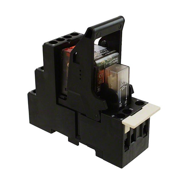

    RELAY GEN PURPOSE DPDT 12A 230V
PT2L7TD0 数据手册
General Purpose Relays Product Sets SCHRACK Relay Package PT n Relay package consisting of PT relay, DIN-rail socket, plastic retaining clip, module and marking tag n 2 pole 12 A, 3 pole 10 A or 4 pole 6 A n DC- or AC coil n Mechanical and electrical indicator n Manual test tab, optionally lockable Approvals Relay: VDE Cert. No. 40009108, cULus E214025, Lloyds 00/20059 F0274-D Socket: VDE Cert. No. 40009108, cULus E135149 Z Technical data of approved types on request Contact data PT2 PT3 PT5 Contact configuration 2 CO 3 CO 4 CO Contact set single contact Type of interruption micro disconnection Rated voltage/ max. switching voltage AC 240/400VAC 240/400VAC 240/240VAC Rated current 12 A 10 A 6A Limiting continous current see derating curve Maximum breaking capacity AC 3000 VA 2500 VA 1500 VA Limiting breaking capacity, max. 20 ms 24 A 20 A 12 A Contact material AgNi90/10, AgNi90/10 gold plated Minimum contact load 12V/10mA, 20mV/1mA gold plated Rated frequency of operation with/without load 6 / 600 min-1 Contact ratings For contact ratings see datasheet Miniature Relay PT Coil data Rated coil voltage range DC coil AC coil Operative range, IEC 61810 DC coil, AC coil 50 Hz AC coil 60 Hz at 70°C 6...220 VDC 6...230 VAC 2 90...110% of rated voltage Coil versions, DC coil Coil Rated Operate Release Coil Rated coil code voltage voltage voltage resistance power LED+PD*) VDC VDC VDC Ω±10% mW LB2 12 9.0 1.2 192 750 LC4 24 18.0 2.4 777 741 *) Protection diode PD Coil versions, AC coil 50/60 Hz Coil Rated Operate Release Coil Rated coil code voltage voltage voltage resistance power LED 50/60 Hz 50/60 Hz 50/60 Hz VAC VAC VAC Ω VA RC4 24 19.2/21.6 7.2 192±10% 1.0/0.79 SB5 115 92.0/103.5 34.5 4845±12% 1.0/0.86 TD0 230 184.0/207.0 69.0 19465±15% 1.0/0.90 Insulation PT2 PT3 PT5 Dielectric strength coil-contact circuit 2500 Vrms 2500 Vrms 2500 Vrms open contact circuit 1200 Vrms 1200 Vrms 1200 Vrms adjacent contact circuits 2500 Vrms 2500 Vrms 2000 Vrms Clearance / creepage coil-contact circuit ≥ 4/4 mm ≥ 4/4 mm ≥ 4/4 mm adjacent contact circuits ≥3.5/9.5 mm ≥2.6/3.5 mm ≥1.8/3.5 mm Material group of insulation parts IIIa Insulation to IEC 60664-1 Type of insulation coil-contact circuit basic open contact circuit micro disconnection adjacent cont. circuits basic Rated insulation voltage 250 V Pollution degree 2 2 2 Rated voltage system 230/400 V 240 V 240 V Overvoltage category III III III All figures are given for coil without preenergization, at ambient temperature +23°C. Other coil voltages on request. 04-2015, Rev. 0415 www.te.com © 2015 Tyco Electronics Corporation, a TE Connectivity Ltd. company Datasheets and product specification according to IEC 61810-1 and to be used only together with the ‘Definitions’ section. Datasheets and product data is subject to the terms of the disclaimer and all chapters of the ‘Definitions’ section, available at http://relays.te.com/definitions Datasheets, product data, ‘Definitions’ section, application notes and all specifications are subject to change. 1 General Purpose Relays Product Sets SCHRACK Relay Package PT (Continued) Other data PT2 PT3 PT5 Mechanical endurance DC coil 30 x 106 cycles AC coil 20 x 106 cycles Material compliance: EU RoHS/ELV, China RoHS, REACH, Halogen content refer to the Product Compliance Support Center at www.te.com/customersupport/rohssupportcenter Ambient temperature range for mounting/handling -25...+70°C in operation -40...+70°C Processing Terminals screw Terminal screw torque acc. IEC 61984 0.5 Nm max. 0.7 Nm Wire cross section single wire 2 x 2.5 mm2 fine wire 2 x 2.5 mm2 with bootlace crimp (DIN 46228/1) 2 x 1.5 mm2 Insertion cycles A (10) Max. Insertion Force total 100 N Mounting distance ≥ 0 mm, dense packing of sockets Weight with PT78720/PT78730/PT78740 71 g 78 g 85 g with PT78722/PT78742 74 g - 90 g Packaging unit 5 pcs Dimensions Package with PT78 720 / PT78 730 / PT78 740 S0427-D 2 04-2015, Rev. 0415 www.te.com © 2015 Tyco Electronics Corporation, a TE Connectivity Ltd. company Package with PT78 722 / PT78 742 S0489-CI Datasheets and product specification according to IEC 61810-1 and to be used only together with the ‘Definitions’ section. Datasheets and product data is subject to the terms of the disclaimer and all chapters of the ‘Definitions’ section, available at http://relays.te.com/definitions Datasheets, product data, ‘Definitions’ section, application notes and all specifications are subject to change. General Purpose Relays Product Sets SCHRACK Relay Package PT (Continued) Product code structure Typical product code PT 5L 8 LC4 Type PT Relay Package PT Version 2S Relay set: PT 2-pole CO contacts (2 form C), red LED 3S Relay set: PT 3-pole CO contacts (3 form C), red LED 5S Relay set: PT 4-pole CO contacts (4 form C), red LED 2L Relay set: PT 2-pole CO contacts (2 form C), red LED, with logical arrangement of control / load terminals 5L Relay set: PT 4-pole CO contacts (4 form C), red LED, with logical arrangement of control / load terminals Contact material 7 AgNi 90/10, with test button 8 AgNi 90/10 gold plated, with test button Coil LB2 12 VDC RC4 24 VAC TD0 230 VAC LC4 SB5 24 VDC 115 VAC Other types on request Product code PT2S7LB2 PT2S7LC4 PT2S7RC4 PT2S7SB5 PT2S7TD0 PT3S7LB2 PT3S7LC4 PT3S7RC4 PT3S7SB5 PT3S7TD0 PT5S7LB2 PT5S7LC4 PT5S7RC4 PT5S7SB5 PT5S7TD0 PT5S8LB2 PT5S8LC4 PT5S8RC4 PT5S8TD0 PT2L7LB2 PT2L7LC4 PT2L7RC4 PT2L7SB5 PT2L7TD0 PT5L7LB2 PT5L7LC4 PT5L7RC4 PT5L7SB5 PT5L7TD0 PT5L8LB2 PT5L8LC4 PT5L8RC4 PT5L8TD0 Socket PT78720 Retainer PT17016 Marking tag PT17040 Module PTML0024 PT78730 PTMV0524 PTMV0615 PTMV0730 PTML0024 PT78740 PTMV0524 PTMV0615 PTMV0730 PTML0024 PTMV0524 PTMV0615 PTMV0730 PTML0024 PT78722 PT17021 PTMV0524 PTMV0730 PTML0024 PTMV0524 PTMV0615 PTMV0730 PTML0024 PT78742 PTMV0524 PTMV0615 PTMV0730 PTML0024 PTMV0524 PTMV0730 Relay PT270012 PT270024 PT270R24 PT270S15 PT270T30 PT370012 PT370024 PT370R24 PT370S15 PT370T30 PT570012 PT570024 PT570R24 PT570S15 PT570T30 PT580012 PT580024 PT580R24 PT580T30 PT270012 PT270024 PT270R24 PT270S15 PT270T30 PT570012 PT570024 PT570R24 PT570S15 PT570T30 PT580012 PT580024 PT580R24 PT580T30 Coil 12VDC 24VDC 24VAC 115VAC 230VAC 12VDC 24VDC 24VAC 115VAC 230VAC 12VDC 24VDC 24VAC 115VAC 230VAC 12VDC 24VDC 24VAC 230VAC 12VDC 24VDC 24VAC 115VAC 230VAC 12VDC 24VDC 24VAC 115VAC 230VAC 12VDC 24VDC 24VAC 230VAC Part Number 7-1415074-1 8-1415074-1 5-1418074-1 2-1415366-1 6-1415074-1 1-1415075-1 2-1415075-1 9-1415074-1 1-1415366-1 1415075-1 9-1415075-1 1415076-1 7-1415075-1 1415366-1 8-1415075-1 5-1415075-1 6-1415075-1 3-1415075-1 4-1415075-1 8-1415534-7 8-1415534-9 9-1415534-0 9-1415534-2 9-1415534-4 1415535-7 1415535-9 1-1415535-1 1-1415535-3 1-1415535-5 1-1415535-7 1-1415535-8 1-1415535-9 2-1415535-0 04-2015, Rev. 0415 www.te.com © 2015 Tyco Electronics Corporation, a TE Connectivity Ltd. company Datasheets and product specification according to IEC 61810-1 and to be used only together with the ‘Definitions’ section. Datasheets and product data is subject to the terms of the disclaimer and all chapters of the ‘Definitions’ section, available at http://relays.te.com/definitions Datasheets, product data, ‘Definitions’ section, application notes and all specifications are subject to change. 3
