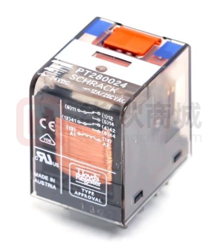

    功率继电器 3PDT 240VAC 24VDC 741mW 10A RELAY_28X22.5MM_TM
PT371024 数据手册
General Purpose Relays Industrial Relays SCHRACK Miniature Relay PT n 2 pole 12A, 3 pole 10A or 4 pole 6A, 2, 3 or 4 form C (CO) contacts or AC coil n Switching performance up to 3000VA n Relay height 29mm n Mechanical indicator, optional LED and protection diode n Manual test tab, optionally lockable n White marking tabs n DC Typical applications Universal use in control and automation F0191-B Z Approvals Contact Data (continued) Technical data of approved types on request Contact ratings Type Contact Load Cycles UL 508 PT 2 C (CO) 12A, 250VAC, general purpose, 70°C 6.000 PT 2 C (CO) 12A, 250VAC, resistive, 70°C 100x103 PT 2 A (NO) of C (CO) 12A, 250VAC, resistive, 70°C 100x103 PT 2 A (NO) of C (CO) 12A, 250VAC, resistive, 70°C 100x103 PT 3 C (CO) 10A, 250VAC, general purpose, 70°C 6.000 PT 3 C (CO) 10A, 250VAC, resistive, 70°C 100x103 PT 3 A (NO) of C (CO) 10A, 250VAC, resistive, 70°C 100x103 PT 3 B (NC) of C (CO) 10A, 250VAC, resistive, 70°C 100x103 PT 5 C (CO) 6A, 250VAC, general purpose, 70°C 6.000 PT 5 C (CO) 6A, 250VAC, resistive, 70°C 100x103 PT 5 A (NO) of C (CO) 6A, 250VAC, resistive, 70°C 100x103 PT 5 B (NC) of C (CO) 6A, 250VAC, resistive, 70°C 100x103 EN60947-4-1 PT 2 A (NO) of C (CO) 400VAC, 3.75A, AC3, opposite polarity, 70°C PT 2 A (NO) of C (CO) 230VAC, 1.7A, AC5b (400W lamp load), opposite polarity, 70°C PT 3 A (NO) of C (CO) 250VAC, 2A, AC3, opposite polarity 70°C PT 3 A (NO) of C (CO) 230VAC, 1.7A, AC5b (400W lamp load), opposite polarity, 70°C PT 5 A (NO) of C (CO) 250VAC, 3A, AC3, same polarity 70°C PT 5 A (NO) of C (CO) 230VAC, 1.7A, AC5b (400W lamp load), same polarity, 70°C PT 2 A (NO) of C (CO) DC coil, AC-15, 250VAC/4A, opposite polarity 6.050 PT 3 A (NO) of C (CO) DC coil, AC-15, 250VAC/4A, same polarity 6.050 PT 5 A (NO) of C (CO) DC coil, AC-15, 250VAC/4A, same polarity 6.050 PT 2 A (NO) of C (CO) AC coil, AC-15, 250VAC/2A, opposite polarity 6.050 PT 3 A (NO) of C (CO) AC coil, AC-15, 250VAC/2A, same polarity 6.050 PT 5 A (NO) of C (CO) AC coil, AC-15, 250VAC/2A, same polarity 6.050 PT2/3/5 A (NO) of C (CO) DC-13, 24VDC/4A 6.050 Mechanical endurance DC coil 30x106 operations AC coil 20x106 operations VDE Cert. No. 40009108, UL E214025, Lloyds 00/20059 Contact Data PT2 PT3 PT5 Contact arrangement 2 form C 3 form C 4 form C 2 CO 3 CO 4 CO Rated voltage 240VAC Max. switching voltage 400VAC 400VAC 240VAC Rated current 12A 10A 6A Limiting making current, max. 20ms 24A 20A 12A Limiting breaking current 12A 10A 6A Limiting short-time current 300A/30ms Switching power 3000VA 2500VA 1500VA Contact material AgNi90/10, AgNi90/10 gold plated Min. recommended contact load 12V at 10mA gold plated: 20mV at 1mA Initial voltage drop 30mV at 100mA/6VDC Frequency of operation with/without load 360/36000h-1 Operate time typ., DC coil 15ms Release time typ., DC coil, without/with PD 10/18ms Bounce time typ., DC coil, form A/form B 6/8ms Contact ratings Type IEC 61810 PT 2 DC/AC coil PT 2 DC/AC coil PT 2 DC/AC coil PT 3 DC/AC coil PT 5 DC/AC coil Contact Load C (CO) A (NO) of C (CO) A (NO) of C (CO) C (CO) C (CO) 12A, 250VAC, cosφ=1, 70°C 9A, 250VAC, cosφ=1, 80°C 4A, 250VAC, cosφ=1, 80°C 10A, 250VAC, cosφ=1, 70°C 6A, 250VAC, cosφ=1, 70°C Cycles 70x103 150x103 300x103 100x103 100x103 Coil Data Coil voltage range Operative range, IEC 61810 DC coil, AC-coil 50Hz AC coil 60 Hz at 70°C Coil insulation system according UL 01-2017, Rev. 0117 www.te.com © 2015 Tyco Electronics Corporation, a TE Connectivity Ltd. company Datasheets and product specification according to IEC 61810-1 and to be used only together with the ‘Definitions’ section. Datasheets and product data is subject to the terms of the disclaimer and all chapters of the ‘Definitions’ section, available at http://relays.te.com/definitions 6 to 220VDC 6 to 230VAC 2 90..110% of rated voltage class 155 (F) Datasheets, product data, ‘Definitions’ section, application notes and all specifications are subject to change. 1 General Purpose Relays Industrial Relays SCHRACK Miniature Relay PT (Continued) Coil Data (continued) Insulation Data Coil versions, DC coil, standard Coil Rated Operate Release Coil Rated coil code voltage voltage voltage resistance power VDC VDC VDC Ω±10%1)2) mW 006 6 4.5 0.6 48 750 012 12 9.0 1.2 192 750 024 24 18.0 2.4 777 741 048 48 36.0 4.8 3072 750 060 60 45.0 6 48451) 743 110 110 82.5 11 161332) 750 220 220 165.0 22 645332) 750 Coil versions, DC coil with bipolar LED or LED and protection diode Coil code Rated Operate Release Coil Rated coil bipol. LED+ voltage voltage voltage resistance +LED pwr. LED PD3) VDC VDC VDC Ω±10%1)2) mW L06 LA6 6 4.5 0.6 48 750+3.5 L12 LB2 12 9.0 1.2 192 750+10 L24 LC4 24 18.0 2.4 777 741+18 L48 LE8 48 36.0 4.8 3072 750+38 L60 LG0 60 45.0 6.0 48451) 743+56 M10 MB0 110 82.5 11.0 161332) 750+96.5 N20 NC0 220 165.0 22.0 645332) 750+202.5 1) Coil resistance ±12%, 2) Coil resistance ±15%, 3) Protection diode PD; standard polarity: +A1/-A2 All figures are given for coil without pre-energization, at ambient temperature +23°C Coil versions, AC coil, 50/60Hz Coil code Rated Operate Release Coil Rated coil STD LED voltage voltage voltage resistance power 50/60Hz 50/60Hz 50/60Hz VAC VAC VAC Ω±10%1)2) VA 506 R06 6 4.8/5.4 1.8 11 1.0/0.85 512 R12 12 9.6/10.8 3.6 48 1.0/0.85 524 R24 24 19.2/21.6 7.2 192 1.0/0.79 548 R48 48 38.4/43.2 14.4 777 1.0/0.87 560 R60 60 48.0/54.0 18.0 1306 1.0/0.87 615 S15 115 92.0/103.5 34.5 48451) 1.0/0.86 730 T30 230 184/207 69.0 194652) 1.0/0.90 PT2 PT3 PT5 Initial dielectric strength between open contacts 1200Vrms 1200Vrms 1200Vrms between contact and coil 2500Vrms 2500Vrms 2500Vrms between adjacent contacts 2500Vrms 2500Vrms 2000Vrms Initial surge withstand voltage between contact and coil 5000V (1.2/50µs) Clearance/creepage between contact and coil ≥3/4mm Material group of insulation parts IIIa Pollution degree 2 Other Data Material compliance: EU RoHS/ELV, China RoHS, REACH, Halogen content refer to the Product Compliance Support Center at www.te.com/customersupport/rohssupportcenter Ambient temperature -40 to +70°C Cold storage, IEC 60068-2-1 -40°C/16h Dry heat, IEC 60068-2-2 70°C/16h Category of environmental protection IEC 61810 RTII - flux proof Vibration resistance (functional), form A (NO)/form B (NC) 7/4g Shock resistance (functional), form A (NO)/form B (NC) 20/5g Terminal type PCB-THT, plug-in quick-connect Cover retention, pull/push force 100/100N Weight 30g Mounting distance, for mounting on PCB 5mm Resistance to soldering heat THT IEC 60068-2-20 270°C/10s Packaging unit 10/250pcs. Accessories For details see datasheet Accessories Miniature Relay PT Note: indicated contact ratings and electrical endurance data for direct wiring of relays (according IEC 61810-1); for relays mounted on sockets deratings may apply. 1) Coil resistance ±12%, 2) Coil resistance ±15% All figures are given for coil without pre-energization, at ambient temperature +23°C Product Sets Complete sets consisting of a relay mounted on a socket see 2 01-2017, Rev. 0117 www.te.com © 2015 Tyco Electronics Corporation, a TE Connectivity Ltd. company Datasheets and product specification according to IEC 61810-1 and to be used only together with the ‘Definitions’ section. Datasheets and product data is subject to the terms of the disclaimer and all chapters of the ‘Definitions’ section, available at http://relays.te.com/definitions Package PT Datasheets, product data, ‘Definitions’ section, application notes and all specifications are subject to change. General Purpose Relays Industrial Relays SCHRACK Miniature Relay PT (Continued) PCB layout ​/ ​terminal assignment Bottom view on pins 4 pole 3 pole S0354-AA S0354-AD Circuit LED (13) A1 S0354-AB 2 pole S0354-AE S0354-AC S0354-AF protection diode+LED (14) A2 (13) A1+ (14) A2- Dimensions Solder- and plug-in terminals (standard version) PCB version S0355-AA 01-2017, Rev. 0117 www.te.com © 2015 Tyco Electronics Corporation, a TE Connectivity Ltd. company Datasheets and product specification according to IEC 61810-1 and to be used only together with the ‘Definitions’ section. S0355-BB Datasheets and product data is subject to the terms of the disclaimer and all chapters of the ‘Definitions’ section, available at http://relays.te.com/definitions Datasheets, product data, ‘Definitions’ section, application notes and all specifications are subject to change. 3 General Purpose Relays Industrial Relays SCHRACK Miniature Relay PT (Continued) Product code structure Typical product code Type PT Miniature Relay PT Contact arrangement 2 2 form C contacts (2 CO contacts) 3 3 form C contacts (3 CO contacts) 5 4 form C contacts (4 CO contacts) Contact material 7 AgNi ​90/10, with test button 2 AgNi ​90/10, without test button Version 0 Standard, 2.8​mm quick connect term. Coil Coil code: please refer to coil versions table 8 3 AgNi ​90/10 gold plated, with test button AgNi ​90/10 gold plated, without test button 1 PCB terminals PT 5 7 0 730 Other types on request Product code Cont. Config. Cont. material Version Coil Coil Part number PT270024 2 form C AgNi ​90/10 AMP 2.8 DC coil 24VDC 4-1419111-2 PT270524 2 CO contacts test button connectors AC coil 24VAC 4-1419111-8 PT270615 115VAC 5-1419111-0 PT270730 230VAC 5-1419111-1 PT270L24 DC coil+LED 24VDC 9-1415001-1 PT270R24 AC coil+LED 24VAC 1415002-1 PT270S15 115VAC 2-1415039-1 PT270T30 230VAC 3-1415002-1 PT271024 PCB terminals DC coil 24VDC 5-1419111-3 PT271524 AC coil 24VAC 5-1419111-6 PT271615 115VAC 4-1419135-0 PT271730 230VAC 5-1419111-8 PT370024 3 form C AgNi ​90/10 AMP 2.8 DC coil 24VDC 6-1419111-1 PT370524 3 CO contacts test button connectors AC coil 24VAC 6-1419111-6 PT370615 115VAC 6-1419111-8 PT370730 230VAC 6-1419111-9 PT370L24 DC coil+LED 24VDC 5-1415002-1 PT370R24 AC coil+LED 24VAC 7-1415002-1 PT370S15 115VAC 9-1415039-1 PT370T30 230VAC 9-1415002-1 PT371024 PCB terminals DC coil 24VDC 7-1419111-1 PT371524 AC coil 24VAC 7-1419111-3 PT371615 115VAC 1393154-8 PT371730 230VAC 7-1419111-5 PT570024 4 form C AgNi ​90/10 AMP 2.8 DC coil 24VDC 1-1393154-2 PT570524 4 CO contacts test button connectors AC coil 24VAC 8-1419111-7 PT570615 115VAC 9-1419111-0 PT570730 230VAC 9-1419111-1 PT570L24 DC coil+LED 24VDC 6-1415001-1 PT570LC4 DC coil+LED+PD 7-1415541-0 PT570R24 AC coil+LED 24VAC 7-1415001-1 PT570S15 115VAC 7-1415003-1 PT570T30 230VAC 8-1415001-1 PT571024 PCB terminals DC coil 24VDC 9-1419111-3 PT571524 AC coil 24VAC 9-1419111-6 PT571615 115VAC 1-1393154-5 PT571730 230VAC 9-1419111-8 PT580024 AgNi ​90/10 AMP 2.8 DC coil 24VDC 1-1393154-7 PT580524 gold plated connectors AC coil 24VAC 2-1393154-1 PT580730 test button 230VAC 2-1393154-2 PT580L24 DC coil+LED 24VDC 5-1415026-1 PT580R24 AC coil+LED 24VAC 6-1415026-1 PT580T30 230VAC 7-1415026-1 PT581024 PCB terminals DC coil 24VDC 7-1419135-2 PT581730 AC coil 230VAC 2-1393154-3 4 01-2017, Rev. 0117 www.te.com © 2015 Tyco Electronics Corporation, a TE Connectivity Ltd. company Datasheets and product specification according to IEC 61810-1 and to be used only together with the ‘Definitions’ section. Datasheets and product data is subject to the terms of the disclaimer and all chapters of the ‘Definitions’ section, available at http://relays.te.com/definitions Datasheets, product data, ‘Definitions’ section, application notes and all specifications are subject to change.
