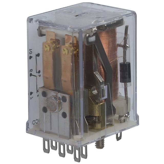

Signal Signal Relays Potter & Brumfield R10 Series Relay n 1 through 8 form C (CO) contact arrangement range of coil options provides sensitivity ranging from 25 to 750mW n Various contacts switch from dry circuit to 7.5 amps n Many mounting and termination options n Broad Typical applications Coin changers, audio equipment, elevators, traffic controls, ultrasonic test equipment, parking toll readers. Approvals UL E29244; CSA LR15734 Technical data of approved types on request. Contact Data Contact arrangement 1, 2, 3, 4, 6 and 8 form C (CO) Rated voltage 120VAC Rated current 7.5A Contact material Ag, AgCdO, Au overlay Ag, AuPtAg Contact style Single or bifurcated crossbar Min. recommended contact load W type, AgCdO, single contact 300mA, 12VDC X type, AgCdO, single contact 300mA, 12VDC M type, AgCdO, bifurcated contact 300mA, 12VDC Y type, Ag, single contact 100mA, 12VDC Z type, Ag, bifurcated crossbar 1mA, 12VDC P type, Au overlay Ag, bifurcated crossbar dry circuit L type, AuPtAg, bifurcated crossbar dry circuit Initial contact resistance All AgCdO contact types 100mΩ All other contact materials and types 50mΩ Frequency of operation 360 ops./hr Contact ratings Type Load UL 508 W type, AgCdO, single contact 7.5A, 120VAC, resistive 7.5A, 28VDC, resistive 1/8HP, 120VAC, same polarity 1/6HP, 240VAC, same polarity X type, AgCdO, single contact 2A, 30VDC, resistive 5A, 120VAC, resistive 5A, 30VDC, resistive 1/20HP, 120VAC, same polarity 1/10HP, 240VAC, same polarity M type, AgCdO, bifurcated contact 5A, 120VAC, resistive 5A, 28VDC, resistive Y type, Ag, single contact 2A, 120VAC 2A, 28VDC 250VA, 250VAC 125VA, 125VAC Z type, Ag, bifurcated crossbar contact 3A, 120VAC 3A, 28VDC 2A, 30VDC 02-2017, Rev. 0217 www.te.com © 2015 Tyco Electronics Corporation, a TE Connectivity Ltd. company Cycles 100x103 6x103 100x103 6x103 6x103 6x103 6x103 30x103 100x103 6x103 6x103 100x103 Datasheets and product specification according to IEC 61810-1 and to be used only together with the ‘Definitions’ section. R10 R10-R R10S R10-T Contact ratings (continued) Type Load Cycles UL 508 P type, Au overlay Ag, bifurcated crossbar contact 2A, 120VAC, resistive 100x103 3 A, 120 VAC, resistive 6x103 3 A, 30 VDC, resistive 100x103 L type, AuPtAg, bifurcated crossbar contact 500mA, 28VDC, resistive 6x103 Mechanical endurance 10x106 ops., except W type is 1x106 ops. Coil Data Coil voltage range 3 to 115VDC 4.5mA to 20mA 6 to 115VAC Coil versions, DC coil Coil Rated Operate Coil Rated coil code voltage voltage resistance power VDC VDC Ω±10% mW V - standard DC voltage adjustment 1, 2 and 4 pole V10 3 2.25 10 900 V28 5 3.75 28 900 V52 6 4.5 52 900 V185 12 9 185 900 V700 24 18 700 900 V2.5K 48 36 2500 900 V5.8K 72 54 5800 900 V15.0K 115 86 15000 900 6 pole V6 3 2.25 6 1,500 V16 5 3.75 16 1,600 V25 6 4.5 25 1,500 V90 12 9 90 1,600 V430 24 18 430 1,400 V1.5K 48 36 1500 1,600 V3.5K 72 54 3500 1,500 V9.0K 115 86 9000 1,500 8 pole V5 3 2.25 5 1,800 V14 5 3.75 14 1,800 V20 6 4.5 20 1,800 V72 12 9 72 2,000 V350 24 18 350 1,700 V1.25K 48 36 1250 1,900 V2.8K 72 54 2800 1,900 V8.0K 115 86 8000 1,700 All figures are given for coil without preenergization, at ambient temperature +23°C. Datasheets and product data is subject to the terms of the disclaimer and all chapters of the ‘Definitions’ section, available at http://relays.te.com/definitions Datasheets, product data, ‘Definitions’ section, application notes and all specifications are subject to change. 1 Signal Signal Relays Potter & Brumfield R10 Series Relay (Continued) Coil versions, DC coil (continued) Coil versions, DC coil (continued) Coil Rated Operate Coil Rated coil Coil Rated Operate Coil Rated coil code voltage voltage resistance power code voltage voltage resistance power VDC VDC Ω±10% mW VDC VDC Ω±10% mW Q - special DC voltage adjustment S - sensitive DC voltage adjustment (continued) 2 pole 1 and 2 pole SS110 3 2.25 110 85 Q52 5 3.1 52 500 SS350 5 3.75 350 75 Q110 6 4.5 110 350 SS500 6 4.5 500 75 Q450 12 9.2 450 350 Q1.8K 24 17.4 1,800 350 SS2.0K 12 9 2000 75 SS4.5K 18 13.5 4500 75 Q7.5K 48 36.2 7500 310 SS7.5K 24 18 7500 80 Q15.0K 72 49.5 15000 350 SS15.0K 36 27 15000 85 Q30.0K 115 67.5 30000 450 SS30.0K 48 36 30000 80 3 and 4 pole Q32 5 3.8 32 800 3 and 4 pole SS52 3 2.25 52 175 Q52 6 4.2 52 700 SS175 5 3.75 175 150 Q185 12 8.4 185 800 SS250 6 4.5 250 150 Q1.0K 24 17.2 1000 600 SS1.0K 12 9 1000 150 Q3.2K 48 31.1 3200 750 Q7.5K 72 49.3 7500 700 SS2.2K 18 13.5 2200 150 SS3.7K 24 18 3700 150 Q15.0K 115 67.5 15000 900 SS7.5K 36 27 7500 175 S - sensitive DC voltage adjustment SS15.0K 48 36 15000 150 1 and 2 pole S50 3 2.25 50 180 Coil Maximum Operate Coil Pick-up S140 5 3.75 140 180 code coil current current resistance coil power S200 6 4.5 200 180 mADC mADC Ω±10% mW S800 12 9 800 180 J - sensitive DC current adjustment S3.2K 24 18 3200 180 2 pole S13.0K 48 36 13000 180 J1.0K 45 8.5 1000 75 S28.0K 72 54 28000 190 J2.5K 28 5.8 2500 85 S50.0K 115 86 50000 270 J5.0K 20 4.1 5000 85 3 and 4 pole J10.0K 14 3.1 10000 100 S30 3 2.25 30 300 J15.0K 11.5 2.6 15000 100 S80 5 3.75 80 350 J30.0K 8.3 1.7 30000 85 S110 6 4.5 110 350 3 and 4 poles S450 12 9 450 350 J1.0K 45 13 1000 175 S1.8K 24 18 1800 350 J2.5K 28 8.4 2500 175 S7.5K 48 36 7500 300 J5.0K 20 6.2 5000 200 S16.0K 72 54 16000 350 J10.0K 14 4.5 10000 200 S40.0K 115 86 40000 350 J15.0K 11.5 3.5 15000 200 6 pole J30.0K 8.3 2.5 30000 200 S20 3 2.25 20 500 6 pole S56 5 3.75 56 500 J1.0K 45 16 1000 250 S80 6 4.5 80 500 J2.5K 28 10 2500 250 S320 12 9 320 500 J5.0K 20 7.2 5000 250 S1.2K 24 18 1200 500 J10.0K 14 5 10000 250 S5.2K 48 36 5200 500 J15.0K 11.5 4.2 15000 270 S13.0K 72 54 13000 400 J30.0K 8.3 2.9 30000 250 S30.0K 115 86 30000 500 8 pole 8 pole J1.0K 45 20 1000 250 S12 3 2.25 12 750 J2.5K 28 13 2500 250 S35 5 3.75 35 750 J5.0K 20 9 5000 250 S52 6 4.5 52 700 J10.0K 14 6.4 10000 250 S200 12 9 200 750 J15.0K 11.5 5.3 15000 270 S800 24 18 800 750 J30.0K 8.3 3.7 30000 250 S3.2K 48 36 3200 750 J - sensitive DC current adjustment - R10S types only S7.5K 72 54 7500 700 1 pole S16.0K 115 86 16000 850 J5001) – 4.5 500 10 SS - ultra sensitive DC voltage adjustment 1 pole J1.0K1) – 3.2 1000 10 J2.5K – 2 2500 10 SS220 3 2.25 220 45 J5.0K2) – 1.4 5000 10 SS700 5 3.75 700 40 J10.0K – 1 10000 10 SS1.0K 6 4.5 1000 40 J16.0K – 0.8 16000 10 SS4.0K 12 9 4000 40 SS9.0K 18 13.5 9000 40 J30.0K3) – 0.6 30000 11 SS15.0K 24 18 15000 40 SS30.0K 36 27 30000 45 2 02-2017, Rev. 0217 www.te.com © 2015 Tyco Electronics Corporation, a TE Connectivity Ltd. company Datasheets and product specification according to IEC 61810-1 and to be used only together with the ‘Definitions’ section. Datasheets and product data is subject to the terms of the disclaimer and all chapters of the ‘Definitions’ section, available at http://relays.te.com/definitions Datasheets, product data, ‘Definitions’ section, application notes and all specifications are subject to change. Signal Signal Relays Potter & Brumfield R10 Series Relay (Continued) 1) Suggested for 5VDC operation 2) Suggested for 12VDC operation 3) Suggested for 24VDC operation JJ - ultrasensitive DC current adjustment 1 pole JJ1.0K 45 4.5 1000 20 JJ2.5K 28 2.9 2500 25 JJ5.0K 20 2.1 5000 25 JJ10.0K 14 1.5 10000 25 JJ15.0K 11.5 1.2 15000 25 JJ30.0K 8.3 0.85 30000 25 2 pole JJ1.0K 45 6.5 1000 45 JJ2.5K 28 4.1 2500 45 JJ5.0K 20 2.9 5000 45 JJ10.0K 14 2 10000 40 JJ15.0K 11.5 1.7 15000 45 JJ30.0K 8.3 1.2 30000 45 4 pole JJ1.0K 45 9 1000 85 JJ2.5K 28 5.8 2500 85 JJ5.0K 20 4.1 5000 85 JJ10.0K 14 3 10000 90 JJ15.0K 11.5 2.4 15000 85 JJ30.0K 8.3 1.7 30000 90 30 Typical Operate and Release Time 25 10 (all contact configurations) 20 15 8 Release Time (no suppression) 10 5 12 6 4 2 Operate Time Release Time (Milliseconds) 45 45 45 45 40 35 45 (Curves for reference only. If specific values are required, testing is required.) 1.0 1.33 1.5 2.0 2.5 3.0 Multiple of Max. Pull-in Voltage or Current R10 Ultra-Sensitive “SS” and “JJ” Typical Ranges of Operation @ 25°C 50 (Curves for reference only. If specific values are required, testing is required.) 40 Typical Operate and Release Time (all contact configurations) 30 10 8 6 Release Time (no suppression) 20 10 Operate Time 4 2 Release Time (Milliseconds) 20 20 25 20 20 25 20 Operative Range R10 Relays (DC Only) Typical Ranges of Operations @ 25°C Operate Time (Milliseconds) Pick-up coil power mW Operate Time (Milliseconds) Coil versions, DC coil (continued) Coil Maximum Operate Coil code coil current current resistance mADC mADC Ω±10% J - sensitive DC current adjustment – R10S types only 2 pole J5001) – 6.3 500 J1.0K – 4.5 1000 J2.5K2) – 2.9 2500 J5.0K – 2 5000 J10.0K3) – 1.4 10000 J16.0K – 1.2 16000 J30.0K – 0.8 30000 4 pole J500 – 9 500 J1.0K – 6.5 1000 J2.5K2) – 4.1 2500 J5.0K3) – 2.9 5000 J10.0K – 2 10000 J16.0K – 1.4 16000 J30.0K – 1.2 30000 3.0 4.0 1.0 1.5 2.0 Multiple of Max. Pull-in Voltage or Current Typical Coil Inductance 500 Coil versions, AC coil (dual coil diode rectified construction) Coil Rated Operate Coil code voltage voltage resistance VAC VAC Ω±20% Standard AC 2 and 4 pole 6V 6 5 25 12V 12 9 120 24V 24 18 500 48V 48 36 2000 115V 115 86 9000 6 and 8 pole 6V 6 5 15 12V 12 9 90 24V 24 18 350 48V 48 36 1400 115V 115 86 7500 Coil Inductance (Henrys) All figures are given for coil without preenergization, at ambient temperature +23°C. 100 50 10 Armature (open) Armature (closed) 1.0 0.5 0.1 10 50 100 500 1K 5K 10K 100K Coil Resistance (Ohms) All figures are given for coil without preenergization, at ambient temperature +23°C. 02-2017, Rev. 0217 www.te.com © 2015 Tyco Electronics Corporation, a TE Connectivity Ltd. company Datasheets and product specification according to IEC 61810-1 and to be used only together with the ‘Definitions’ section. Datasheets and product data is subject to the terms of the disclaimer and all chapters of the ‘Definitions’ section, available at http://relays.te.com/definitions Datasheets, product data, ‘Definitions’ section, application notes and all specifications are subject to change. 3 Signal Signal Relays Potter & Brumfield R10 Series Relay (Continued) Insulation Data Other Data (continued) Initial dielectric strength between open contacts between contact and coil between adjacent contacts Initial insulation resistance between insulated elements Terminal type Solder/plug-in terminals, PCB-THT, 8- or 11-PIN octal type plug Weight 23 to 40g Packaging/unit tray/50 pcs., box/350pcs. 500Vrms 1000Vrms 1000Vrms 10GΩ, 500VDC Accessories For details see datasheet Other Data Material compliance: EU RoHS/ELV, China RoHS, REACH, Halogen content refer to the Product Compliance Support Center at www.te.com/customersupport/rohssupportcenter Ambient temperature -55ºC to 75ºC Category of environmental protection IEC 61810 RTI - dust protected and RTIII - wash tight Sockets and Accessories, R10 Relays Product Code Description Many versions of sockets and clips available. NOTE: Relays with contact current

物料型号:R10系列继电器,由Potter & Brumfield制造。
器件简介: - R10系列是信号继电器,具有1至8个形式C(CO)的接触安排。 - 提供多种线圈选项,灵敏度范围从25到750mW。 - 可切换从干电路到7.5安培的各种接触。
引脚分配: - 有多种端子类型,包括焊接/插入端子、PCB-THT、8或11针八端子类型插头。
参数特性: - 接触材料包括Ag.AgCdO和Au overlay Ag.AuPtAg。 - 接触风格为单刀或分叉横杆。 - 额定电压为120VAC,额定电流为7.5A。 - 初始接触电阻为50mΩ(对于所有AgCdO接触类型为100mΩ)。 - 操作频率为每小时360次。
功能详解: - 适用于投币机、音频设备、电梯、交通控制、超声波测试设备和停车收费读取器等典型应用。
应用信息: - 有多种接触类型和额定值,例如W型、X型、M型、Y型、Z型、P型和L型,适用于不同的电流和电压条件。
封装信息: - 提供多种封装选项,包括非密封聚碳酸酯防尘罩(RTI)、洗紧(RTII)的塑料外壳等。 - 重量在23到40克之间,包装单元为托盘/50件,盒/350件。
其他数据: - 初始介电强度、初始绝缘电阻、材料合规性(符合EU RoHS/ELV、中国RoHS、REACH)等。
产品代码结构: - 包括类型、外壳样式、端子和安装类型、接触风格和额定值、线圈电压等。
