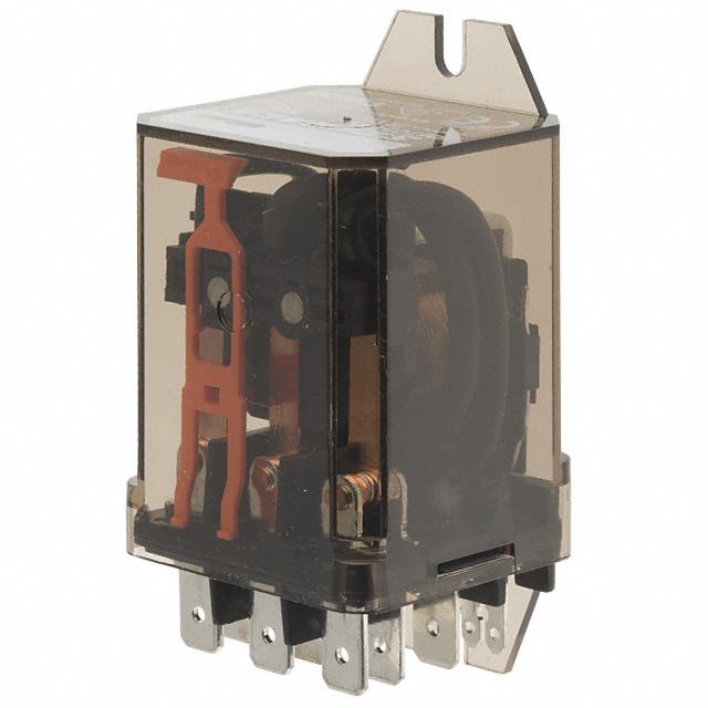

General Purpose Panel/Plug-in Relays SCHRACK Power Relay RM 8 n 2 pole 25 A, 2 form C (2 CO) contacts or AC coil n Mechanical indicator n Push-to-test button n Chassis or DIN rail mount n DC Typical applications Cleaning equipment, heating and cooling equipment. Z Approvals Coil Data VDE Cert. No. 40003144, UL E214025, Coil voltage range Operative range, IEC 61810 Coil insulation system according UL Technical data of approved types on request. Contact Data Contact arrangement 2 form C (CO) Rated voltage 400VAC Max. switching voltage 400VAC Rated current 25A Limiting making current, 20ms max. 60A Switching power 6000VA Contact material AgCdO, AgNi90/10 Min. recommended contact load 24VDC/100mA Frequency of operation, with/without load, DC coil 960/6000h-1 Operate/release time max., DC coil 15/10ms Bounce time max., form A/form B, DC coil 4/6ms Contact ratings Type Contact IEC 61810 RM8 C (CO) RM82 C (CO) RM82 C (CO) UL 508 RM80 A/B (NO/NC) RM8 A/B (NO/NC) RM82 A/B (NO/NC) RM82 A/B (NO/NC) Load Cycles 25 A, 250 VAC, cosφ=1 35°C 25 A, 250 VAC, cosφ=1 DC-coil, 65°C 25 A, 250 VAC, cosφ=1 AC-coil, 40°C 10x10 10x103 10x103 25 A, 240 VAC, 1 phase per pole, general purpose 40°C 25 A, 415 VAC, resistive, 45°C 16 A, 415 VAC, resistive, 70°C 240 VAC, 1phase, 2HP, 50°C 6x103 10x103 30x103 6x103 Mechanical endurance 03-2017, Rev. 0317 www.te.com © 2015 Tyco Electronics Corporation, a TE Connectivity Ltd. company. 3 6 to 220VDC 6 to 400VAC 2 class 130 (B) Coil versions, DC coil Coil code Rated Coil Rated coil STD LED PD3) LED+ voltage resistance power bipolar PD3) VDC Ω±10%1)2) W 006 L06 0A6 LA6 6 32 1.1 012 L12 0B2 LB2 12 110 1.3 024 L24 0C4 LC4 24 475 1.2 048 L48 0E8 LE8 48 2000 1.2 060 L60 0G0 LG0 60 2850 1.3 110 M10 1B0 MB0 110 100001) 1.2 2) 221 N21 2C1 NC1 220 40000 1.2 Operate voltage, DC coil 75% of rated coil voltage Release voltage, DC coil 10% of rated coil voltage 1) Coil resistance ±12%, 2) Coil resistance ±15%. 3) Protection diode PD; standard polarity: +A1 / -A2. All figures are given for coil without pre-energization, at ambient temperature +23°C. 10x106 operations Catalog and product specification according to IEC 61810-1 and to be used only together with the ‘Definitions’ section. Catalog and product data is subject to the terms of the disclaimer and all chapters of the ‘Definitions’ section, available at http://relays.te.com/definitions Catalog product data, ‘Definitions’ section, application notes and all specifications are subject to change. 1 General Purpose Panel/Plug-in Relays SCHRACK Power Relay RM 8 (Continued) Coil Data (continued) Insulation Data Coil versions, AC coil Coil code Rated Operate Release Coil Rated coil STD LED voltage voltage voltage resistance power 50/60Hz 50/60Hz 50/60Hz VAC VAC VAC Ω±10%1)2) VA 506 R06 6 4.8/5.1 1.8 4.7 2.86/2.36 512 R12 12 9.6/10.2 3.6 19.5 2.71/2.27 524 R24 24 19.2/20.4 7.2 80 2.62/2.00 548 R48 48 38.4/40.8 14.4 320 2.60/2.17 560 R60 60 48.0/51.0 18.0 500 2.62/2.20 615 S15 115 92.0/97.8 34.5 1850 2.65/2.22 730 T30 230 184.0/195.5 69.0 7500 2.69/ 2.26 2) 900 V00 400 320.0/340.0 120.0 23500 2.61/2.20 2) Coil resistance ±15%. All figures are given for coil without pre-energization, at ambient temperature +23°C. Terminal assignment Bottom view on pins Initial dielectric strength between open contacts between contact and coil between adjacent contacts Initial surge withstand voltage between contact and coil between adjacent contacts Clearance/creepage between contact and coil between adjacent contacts Material group of insulation parts 1500Vrms 2500Vrms 4000Vrms 5000V(1.2/50µs) 6000V(1.2/50µs) ≥4.0/14.9mm ≥15.3/15.3mm IIIa Other Data Material compliance: EU RoHS/ELV, China RoHS, REACH, Halogen content refer to the Product Compliance Support Center at www.te.com/customersupport/rohssupportcenter Ambient temperature for mounting/handling -20 to +40°C in operation DC coil -40 to +65°C AC coil -40 to +40°C 16 A contact load -40 to +70°C Category of environmental protection IEC 61810 RTI - dust protected Vibration resistance (functional) form A (NO)/form B (NC) 10/5g, 30 to 150Hz Terminal type quick-connect Cover retention, pull/push force 100/100N Weight 81g Packaging unit 10/25 pcs. Dimensions Cover with mounting brackets, 6.3​mm quick connect terminals Cover with DIN-snap-on attachement horizontal 2 03-2017, Rev. 0317 www.te.com © 2015 Tyco Electronics Corporation, a TE Connectivity Ltd. company. Catalog and product specification according to IEC 61810-1 and to be used only together with the ‘Definitions’ section. Catalog and product data is subject to the terms of the disclaimer and all chapters of the ‘Definitions’ section, available at http://relays.te.com/definitions vertical Catalog product data, ‘Definitions’ section, application notes and all specifications are subject to change. General Purpose Panel/Plug-in Relays SCHRACK Power Relay RM 8 (Continued) Product code structure Typical product code RM 8 0 9 024 Type RM Power relay RM8 Contact configuration 8 2 form C contacts (2 CO), 25A Version 0 AgCdO, without test button 3 AgCdO, with test button 2 AgNi90/10, without test button 7 AgNi90/10, with test button Enclosure 5 cover with mounting brackets, 6.3mm quick connect terminals 8 cover with DIN-snap-on attachment, horizontal, 6.3mm quick connect terminals 9 cover with DIN-snap-on attachment, vertical, 6.3mm quick connect terminals Coil Coil code: please refer to coil versions table Product code RM805024 RM825024 RM805524 RM805615 RM805730 RM825730 RM808024 RM808524 RM808730 RM809024 RM809615 RM809730 RM835024 RM835524 RM835615 RM835730 RM838024 RM838524 RM838730 RM839024 RM839524 RM839730 Contacts 2 form C, 2 CO contacts 25 A 03-2017, Rev. 0317 www.te.com © 2015 Tyco Electronics Corporation, a TE Connectivity Ltd. company. Cont. material AgCdO AgNi AgCdO AgCdO AgCdO AgNi AgCdO AgCdO AgCdO AgCdO AgCdO AgCdO AgCdO AgCdO AgCdO AgCdO AgCdO AgCdO AgCdO AgCdO AgCdO AgCdO Version Without test button With test button Catalog and product specification according to IEC 61810-1 and to be used only together with the ‘Definitions’ section. Enclosure Mounting brackets quick c. 6.3 ​mm Coil Coil DC-coil 24VDC AC-coil 24VAC 115VAC 230VAC DIN-snap-on horizontal DC-coil AC-coil DIN-snap-on vertical DC-coil AC-coil mounting brackets quick c. 6.3 ​mm DC-coil AC-coil DIN-snap-on horizontal DC-coil AC-coil DIN-snap-on vertical DC-coil AC-coil 24VDC 24VAC 230VAC 24VDC 115VAC 230VAC 24VDC 24VAC 115VAC 230VAC 24VDC 24VAC 230VAC 24VDC 24VAC 230VAC Catalog and product data is subject to the terms of the disclaimer and all chapters of the ‘Definitions’ section, available at http://relays.te.com/definitions Part number 2-1393844-7 7-1415544-3 2-1393147-9 3-1393147-1 3-1393147-3 5-1415544-8 2-1393844-9 3-1393147-7 5-1393149-7 5-1393149-8 3-1393147-8 3-1393147-9 4-1393147-1 4-1393147-3 4-1393147-4 4-1393147-6 4-1393147-8 5-1393147-0 5-1393147-1 5-1393147-4 5-1393147-5 5-1393147-6 Catalog product data, ‘Definitions’ section, application notes and all specifications are subject to change. 3
