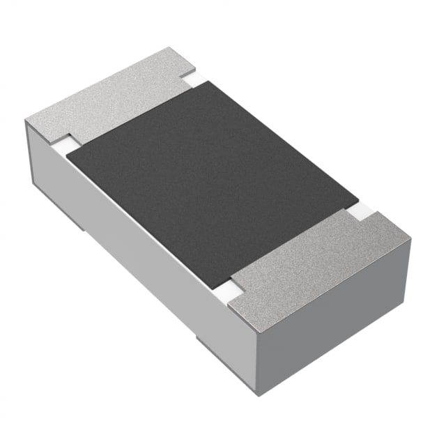

SMD Thin Film Precision Resistors - AEC-Q200 Compliant Type RQ73 Series Key Features SMD TaN Thin film resistor Special passivation layer on resistive element AEC-Q200 qualified Sulfur resistant (per ASTM B809-95 humid vapor test) RoHS Compliant TE Connectivity is proud to introduce this automotive grade thin film precision chip resistor, a sister to our highly successful RN73 range. The resistors are constructed in a high grade raw materials and laser trimmed to give precise tolerance figures. This, coupled with the tight TCR and anti-corrosive protection layer gives us a range of resistors which are ideal not just for automotive applications, but also for medical equipment, measuring instruments and industrial applications. Characteristics – Electrical Type RQ73 1E RQ73 1J RQ73 2A RQ73 2B Size 0402 0603 0805 1206 Resistance tolerance ±0.1% Resistance Range 40R ~ 35K 40R ~ 130K 10R ~ 350K 10R ~1M0 TCR (ppm/°C) ±10PPM/°C Max. dissipation at 0.0625W 0.15W 0.2W 0.4W Tamb=85°C Max. Working Voltage 50V 75V 100V 200V (DC or RMS)¹ ² Max. Overload Voltage 100V 150V 200V 400V (DC or RMS) Operating Temperature -55 ~ 155°C Notes: This is the maximum voltage that may be continuously supplied to the resistor 1. element, see “IEC publication 60115-8” 2. Max. Operation Voltage : So called RCWV (Rated Continuous Working Voltage) is determined by RCWV = √ Rated Power x Resistance Value or Max. RCWV listed above, whichever is lower. 1773270-2 Rev A 06 / 2018 Dimensions in millimetres unless otherwise specified Dimensions Shown for reference purposes only. Specifications subject to change For Email, phone or live chat, go to: www.te.com/help SMD Thin Film Precision Resistors - AEC-Q200 Compliant Construction Dimensions: (mm) Type L W A B t RQ73 1E 1.00 ± 0.10 0.50 ± 0.05 0.25 ± 0.15 0.30 ± 0.10 0.30 ± 0.10 RQ73 1J 1.55 ± 0.10 0.80 ± 0.10 0.3 ± 0.20 0.30 ± 0.15 0.45 ± 0.15 RQ73 2A 2.00 ± 0.10 1.25 ± 0.10 0.35 ± 0.20 0.40 ± 0.20 0.50 ± 0.15 RQ73 2B 3.10 ± 0.10 1.60 ± 0.10 0.40 ± 0.20 0.40 ± 0.20 0.60 ± 0.15 Derating Curve 1773270-2 Rev A 06 / 2018 Dimensions in millimetres unless otherwise specified Dimensions Shown for reference purposes only. Specifications subject to change For Email, phone or live chat, go to: www.te.com/help SMD Thin Film Precision Resistors - AEC-Q200 Compliant Environmental Characteristics Test Electrical Characteristics IEC 60115-1 4.8 Requirement Within Specified Tolerance Short time overload (S.T.O.L) IEC60115-1 4.13 Permanent resistance change after a 5 second application of a voltage 2.5 times RCWV or the maximum overload voltage specified in the above list, whichever is less. ΔR/R max. ±(0.1%+0.02Ω) Resistance to soldering heat (R.S.H) AEC Q200-15 Un-mounted chips completely immersed for 10±1second in a SAC solder bath at 260℃±5ºC no visible damage ΔR/R max. ±(0.1%+0.02Ω) Solderability IEC 60068-2-58 Un-mounted chips completely immersed for 2±0.5 second in a SAC solder bath at 235℃±5℃ Temperature Cycling JESD22 method JA104 1000 cycles -55 ~ 125°C, dwell time 5 – 10 min. Bias Humidity AEC Q200-7 1000 +48/-0 hours, loaded with 10% rated power in humidity chamber controlled at +85℃/ 85%RH 1000 +48/-0 hours, loaded with RCWV or Vmax in chamber controlled at 85 ±2ºC, 1.5 hours on and 0.5 hours off Load Life IEC60115-1 4.25 Operational Life AEC Q200-8 MIL-STD-202 -108 High Temperature Exposure AEC Q200-3 Moisture Resistance AEC-Q200 -6 MIL-STD-202 Method 106 Mechanical Shock MIL-STD-202 Method 213 Vibration MIL-STD-202 Method 204 Terminal strength AEC-Q200-6 Board flex AEC-Q200-21 Flower of sulfur test ASTM B809 - 95 1773270-2 Rev A 06 / 2018 Procedure - DC resistance values measurement - Temperature Coefficient of Resistance (T.C.R) Natural resistance change per change in degree centigrade. 1000 cycles -55 ~ 155°C, dwell time 5 – 10 min. 1,000 hours at 125±2°C, loaded with rated power continuously 1000 hrs @ 125℃, un-powered 1000 hrs @ 155℃, un-powered good tinning (>95% covered) no visible damage no visible damage ΔR/R max. ±(0.1%+0.02Ω) no visible damage ΔR/R max. ±(0.2%+0.02Ω) ΔR/R max. ±(0.1%+0.02Ω) ΔR/R max. ±(0.1%+0.02Ω) ΔR/R max. ±(0.1%+0.02Ω) ΔR/R max. ±(0.1%+0.02Ω) ΔR/R max. ±(0.15%+0.02Ω) 65±2°C, 80~100% RH, 10 cycles, 24 hours/ cycle ΔR/R max. ±(0.1%+0.02Ω) 1/2 Sine Pulse / 1500g Peak / Velocity 15.4ft/sec ΔR/R max. ±(0.1%+0.02Ω) 5 g's for 20 min , 12 cycles each of 3 orientations ΔR/R max. ±(0.1%+0.02Ω) 1 kg for 60 s No Physical Damage Bending 2mm for 60 sec 105±2°C, Duration 1,000 hours Dimensions in millimetres unless otherwise specified Dimensions Shown for reference purposes only. Specifications subject to change ΔR/R max. ±(0.1%+0.02Ω) 0402 ΔR/R max. ±(0.2%+0.02Ω) Others ΔR/R max. ±(0.1%+0.02Ω) For Email, phone or live chat, go to: www.te.com/help SMD Thin Film Precision Resistors - AEC-Q200 Compliant Marking: 0603 E24 series 3 Digits – first two digits denote significant figures of resistance and third digit denotes number of zeros thereafter. EG = 222 2K2 0603 E96 series 3 Digits - The 1st two digit codes are referring to the CODE in the table, the 3rd code is the index of resistance value : Y=10⁻²,X=10⁻¹,A=10⁰,B=10¹,C=10²,D=10³,E=10⁴,F=10⁵ EX : 17.8Ω=25X,178Ω=25A,1K78 =25B 17K8=25C, 178K=25D, 1M78=25E 0805 & 1206 E24 and E96 4 digits – Where value is below 100R use R as decimal, otherwise three significant figures plus number of following zeros. E.G. Resistance 4 digit marking 10Ω 12Ω 100Ω 6K8 47K 10R0 12R0 1000 6801 4702 Notes: 1. No marking for non-E24/E96 resistance values. 2. No marking for 0402 size resistors 1773270-2 Rev A 06 / 2018 Dimensions in millimetres unless otherwise specified Dimensions Shown for reference purposes only. Specifications subject to change For Email, phone or live chat, go to: www.te.com/help SMD Thin Film Precision Resistors - AEC-Q200 Compliant Packaging Paper Tape Specification (mm) Size 0402 0603 0805 1206 A 1.20±0.10 1.90±0.20 2.40±0.20 3.60±0.20 Size B 0.7±0.10 1.10±0.20 1.65±0.20 2.00±0.20 P1 W 8.00±0.30 8.00±0.30 8.00±0.30 8.00±0.30 P0 F 3.50±0.05 3.50±0.20 3.50±0.20 3.50±0.20 ØD 0402 2.00±0.10 4.00±0.10 Ø1.50 0603 4.00±0.10 4.00±0.10 Ø1.50 0805 4.00±0.10 4.00±0.10 Ø1.50 1206 4.00±0.10 4.00±0.10 Ø1.50 +0.1 -0.0 +0.1 -0.0 +0.1 -0.0 +0.1 -0.0 E 1.75±0.10 1.75±0.10 1.75±0.10 1.75±0.10 T 0.40±0.05 0.65±0.05 Max. 1.0 Max. 1.0 Reel Dimensions (mm) Symbol Dim. (mm) A Ø178.0±2.0 B Ø60.0±1.0 C 13.0±0.2 D 9.0±0.5 All sizes 5,000 pieces per reel 1773270-2 Rev A 06 / 2018 Dimensions in millimetres unless otherwise specified Dimensions Shown for reference purposes only. Specifications subject to change For Email, phone or live chat, go to: www.te.com/help SMD Thin Film Precision Resistors - AEC-Q200 Compliant Storage and Handling Condition: 1. 2. 3. Products are recommended to be used up within two years. Check solderability in case shelf life extension is needed. To store products with following condition: Temperature : 5 to 40℃ Humidity : 20 to 70% relative humidity Caution: a. Don’t store products in a corrosive environment such as sulfide, chloride gas, or acid. It may cause oxidation of electrode, which easily be resulted in poor soldering. b. To store products on the shelf and avoid exposure to moisture. c. Don’t expose products to excessive shock, vibration, direct sunlight etc. MOUNTING Due to their rectangular shapes and small tolerances, Surface Mountable Resistors are suitable for handling by automatic placement systems. Chip placement can be on ceramic substrates and printed-circuit boards (PCBs). Electrical connection to the circuit is by individual soldering condition. The end terminations guarantee a reliable contact. SOLDERING CONDITION The robust construction of chip resistors allows them to be completely immersed in a solder bath of 260°C for 10 seconds. Therefore, it is possible to mount Surface Mount Resistors on one side of a PCB and other discrete components on the reverse (mixed PCBs). Surface Mount Resistors are tested for solderability at 235°C during 2 seconds within lead-free solder bath. The test condition for no leaching is 260°C for 30 seconds. Typical examples of soldering profile and condition that provide reliable joints without any damage are given below. Infrared soldering condition for Chip Resistors Temperature Condition Average ramp-up rate (217°C to 260°C) Between 150 and 200°C > 217°C Peak Temperature Time within 245°C Ramp-down rate (Peak to 217°C) Time from 25°C to Peak 1773270-2 Rev A 06 / 2018 Dimensions in millimetres unless otherwise specified Exposure time Less than 3°C/second Between 60-120 seconds Between 60-150 seconds 260ºC +0/-5°C Min. 30 seconds Less than 6°C/second No greater than 480 seconds Dimensions Shown for reference purposes only. Specifications subject to change For Email, phone or live chat, go to: www.te.com/help SMD Thin Film Precision Resistors - AEC-Q200 Compliant How To Order RQ73 C 1E Common Part TCR Size Code RQ73 C= 10PPM/°C 1E = 0402 1J = 0603 2A = 0805 2B = 1206 40R2 Resistance Value 100R (100Ω) 1K0 (1000Ω) B TDF Tolerance Packaging Spec. TD = Reel 5000 B = .1% TDF = Reel 1000 100K (100,000Ω) 1773270-2 Rev A 06 / 2018 Dimensions in millimetres unless otherwise specified Dimensions Shown for reference purposes only. Specifications subject to change For Email, phone or live chat, go to: www.te.com/help

物料型号: RQ73系列
器件简介: - 汽车级薄膜精密芯片电阻器,符合AEC-Q200标准。 - 采用SMD TaN薄膜电阻技术,具有特殊的钝化层,以提高耐腐蚀性。 - 适用于汽车、医疗设备、测量仪器和工业应用。
引脚分配: - 尺寸包括0402、0603、0805和1206。
参数特性: - 电阻公差:±0.1% - 电阻范围:40R~35K(RQ731E)、40R~130K(RQ73 1J)、10R~350K(RQ73 2A)、10R~1M0(RQ73 2B)。 - 温度系数(TCR):±10PPM/°C - 最大功耗:0.0625W(RQ731E)、0.15W(RQ73 1J)、0.2W(RQ73 2A)、0.4W(RQ73 2B)。 - 最大工作电压和过载电压根据尺寸不同而有所变化。
功能详解: - 电阻器采用高精度激光修调技术,确保精确的电阻值。 - 具有抗硫化特性,符合ASTM B809-95的湿热蒸汽测试。 - 符合RoHS标准。
应用信息: - 适用于需要高精度和高可靠性的应用场景。
封装信息: - 提供详细的尺寸信息和标记方法。 - 包括环境特性测试,如电气特性、短时间过载、耐焊热、可焊性、温度循环、偏置湿度、负载寿命、操作寿命、高温暴露、耐湿性、机械冲击、振动、端子强度和板弯曲测试。
订购信息: - 提供了如何根据TCR、尺寸代码、电阻值、公差和包装规格来订购产品的指南。
存储和处理条件: - 推荐在两年内使用完产品,并在需要延长货架寿命时检查可焊性。 - 存储条件包括温度5到40℃,湿度20到70%。
焊接条件: - 芯片电阻器可以完全浸入260°C的焊料浴中10秒。
订购示例: - RQ73 C 1E 40R2 B TDF,表示0402尺寸,TCR为10PPM/°C,电阻值为40R,公差为±0.1%,包装规格为5000件/卷。
