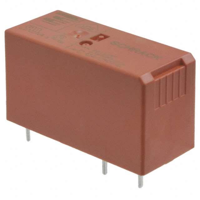

    RELAY GEN PURPOSE SPDT 16A 115V
RT314615 数据手册
General Purpose Relays PCB Relays SCHRACK Power PCB Relay RT1 n 1 pole 12A/16A, 1 form C (CO) or 1 form A (NO) contact or AC coil n 5kV/10mm coil-contact, reinforced insulation n Ambient temperature 85°C (DC coil) n WG version: product in accordance to IEC 60335-1 n Reflow version: for THR (Through-Hole Reflow) soldering process n DC Typical applications Boiler control, timers, garage door control, POS automation, interface modules Approvals VDE Cert. No. 40007571, cULus E214025, cCSAus 1142018; CQC in preparation Technical data of approved types on request Contact Data 12A 16A Contact arrangement 1 form C (CO) or 1 form A (NO) Rated voltage 250VAC Max. switching voltage 400VAC Rated current 12A 16A Limiting continuous current 12A 16A, UL: 20A Limiting making current max. 4s, duty factor 10% 25A 30A Breaking capacity max. 3000VA 4000VA Contact material AgNi 90/10, AgNi 90/10 gold plated Frequency of operation, with/without load DC coil 360/72000h-1 AC coil 360/36000h-1 Operate/release time max., DC coil 8/6ms Bounce time max., DC coil, form A/form B 4/6ms Electrical endurance see electrical endurance graph1) Contact ratings Type Contact Load Cycles IEC 61810 RT314 DC-coil A (NO) 16A, 250VAC, cosφ=1, 85°C 30x103 RT314 DC-coil C (CO) 16A, 250VAC, cosφ=1, 85°C 10x103 RT314 DC-coil A (NO) 10A, 400VAC, cosφ=1, 85°C 150x103 RT114 DC-coil A (NO) 12A, 250VAC, cosφ=1, 85°C 50x103 RT114 AC-coil A (NO) 12A, 250VAC, cosφ=1, 70°C 100x103 UL 508 RT314 A/B (NO/NC) 20A, 250VAC, general purpose, 85°C 6x103 RT334 A (NO) 16A, 250VAC, gen. purpose, 85°C 50x103 RT314 A (NO) 1hp, 240VAC, 40°C 1x103 RT314 A (NO) FLA/LRA, 4.5/13.1A, 480VAC, 70°C 100x103 EN60947-5-1 RT314 DC-coil A/B (NO/NC) 2A, 24VDC, DC13 6.050 EN60730-1 RT314 DC-coil A (NO) 12(2)A, 250VAC, 85°C 100x103 1) For reflow solderable versions: actual contact performance may be influenced by the reflow soldering process. 10-2014, Rev. 1014 www.te.com © 2014 Tyco Electronics Corporation, a TE Connectivity Ltd. company Datasheets and product specification according to IEC 61810-1 and to be used only together with the ‘Definitions’ section. F0144-C Zb Contact Data (continued) Mechanical endurance DC coil AC coil AC coil, reflow version >30x106 operations >10x106 operations >5x106 operations Coil Data Coil voltage range, DC coil/ AC coil 5 to 110VDC / 24 to 230VAC Operative range, IEC 61810 2 Coil insulation system according UL class F Coil versions, DC coil Coil Rated Operate Release Coil Rated coil code voltage voltage voltage resistance power VDC VDC VDC Ω±10%2) mW 005 5 3.5 0.5 62 403 006 6 4.2 0.6 90 400 009 9 6.3 0.9 200 400 012 12 8.4 1.2 360 400 020 20 14.0 2.0 952 420 024 24 16.8 2.4 1440 400 048 48 33.6 4.8 5520 417 060 60 42.0 6.0 85702) 420 110 110 77.0 11.0 288002) 420 2) Coil resistance ±12%. All figures are given for coil without pre-energization, at ambient temperature +23°C. Other coil voltages on request. Coil versions, AC coil 50/60 Hz Coil Rated Operate Release Coil Rated coil code voltage voltage voltage resistance power VAC VAC VAC Ω±15%3) VA 524 24 18.0 3.6 3503) 0.76 615 115 86.3 17.3 8100 0.76 620 120 90.0 18.0 8800 0.75 700 200 150.0 30.0 24350 0.76 730 230 172.5 34.5 32500 0.74 3) Coil resistance ±10%. All figures are given for coil without pre-energization, at ambient temperature +23°C, 50 Hz. Other coil voltages on request. Datasheets and product data is subject to the terms of the disclaimer and all chapters of the ‘Definitions’ section, available at http://relays.te.com/definitions Datasheets, product data, ‘Definitions’ section, application notes and all specifications are subject to change. 1 General Purpose Relays PCB Relays SCHRACK Power PCB Relay RT1 (Continued) Insulation Data Initial dielectric strength between open contacts between contact and coil Clearance/creepage between contact and coil Material group of insulation parts Tracking index of relay base reflow version 1000Vrms 5000Vrms ≥10/10mm IIIa PTI 250V PTI 175V Other Data Material compliance: EU RoHS/ELV, China RoHS, REACH, Halogen content refer to the Product Compliance Support Center at www.te.com/customersupport/rohssupportcenter Resistance to heat and fire WG version or Reflow version according EN60335, par30 Ambient temperature DC coil -40 to 85°C AC coil -40 to 70°C Category of environmental protection, IEC 61810 standard version RTII - flux proof, RTIII - wash tight reflow version RTII - flux proof Vibration resistance (functional) form A/form B contact, 30 to 500Hz 20g/5g Shock resistance (destructive) 100g Other Data (continued) Terminal type standard version PCB-THT, plug-in reflow version PCB-THR Mounting distance AC coil: ≥2.5mm Weight 14g Resistance to soldering heat THT, IEC 60068-2-20 RTII 270°C/10s RTIII 260°C/5s Resistance to soldering heat THR reflow soldering (for reflow version) forced gas convection 4) or vapour phase 5) temperature profile according EN61730 Packaging/unit tube/20 pcs., box/500 pcs. 4) infrared heating not allowed 5) recommended fluid LS/230 Accessories For details see datasheet A ccessories Industrial Power Relay RT NOTE: indicated contact ratings and electrical endurance data for direct wiring of relays (according IEC 61810-1); for relays mounted on sockets deratings may apply. PCB layout / terminal assignment *) With the recommended PCB hole sizes a grid pattern from 2.5​mm to 2.54​mm can be used. Bottom view on solder pins 12​A, pinning 3.5​mm 12​A, pinning 5​mm S0418-CB 1 form C (CO) contact S0418-CN 1 form C (CO) contact S0163-BG 1 form A (NO) contact 10-2014, Rev. 1014 www.te.com © 2014 Tyco Electronics Corporation, a TE Connectivity Ltd. company S0418-CA 1 form C (CO) contact S0163-BC 1 form A (NO) contact S0163-BH 2 16​A, pinning 5​mm Datasheets and product specification according to IEC 61810-1 and to be used only together with the ‘Definitions’ section. S0163-BE 1 form A (NO) contact S0163-BD Datasheets and product data is subject to the terms of the disclaimer and all chapters of the ‘Definitions’ section, available at http://relays.te.com/definitions S0163-BF Datasheets, product data, ‘Definitions’ section, application notes and all specifications are subject to change. General Purpose Relays PCB Relays SCHRACK Power PCB Relay RT1 (Continued) Dimensions THT version THR version (reflow solderable) S0272-BB S0272-BRB Process conditions for Reflow soldering according to EN61760-1 Product code structure Typical product code Type RT Power PCB Relay RT1 Version 1 12A, pinning 3.5mm, flux proof 2 12A, pinning 5mm, flux proof *) 3 16A, pinning 5mm, flux proof B 12A, pinning 3.5mm, wash tight D 16A, pinning 5mm, wash tight Contact arrangement 1 1 form C (CO) contact 3 1 form A (NO) contact Contact material 4 AgNi 90/10 5 AgNi 90/10 gold plated (for type RT31.) Coil Coil code: please refer to coil versions table Version Blank Standard version WG Product in accordance with IEC 60335-1 (domestic appliances) R Reflow solderable RT 3 1 4 024 *) Wash tight version on request 10-2014, Rev. 1014 www.te.com © 2014 Tyco Electronics Corporation, a TE Connectivity Ltd. company Datasheets and product specification according to IEC 61810-1 and to be used only together with the ‘Definitions’ section. Datasheets and product data is subject to the terms of the disclaimer and all chapters of the ‘Definitions’ section, available at http://relays.te.com/definitions Datasheets, product data, ‘Definitions’ section, application notes and all specifications are subject to change. 3 General Purpose Relays PCB Relays SCHRACK Power PCB Relay RT1 (Continued) Product code Version Contacts Contact material Coil Version Part number RT114009 12A, pinning 3.5mm, 1 form C (CO) AgNi 90/10 9VDC Standard 1393239-9 RT114012 flux proof contact 12VDC 1419108-1 RT114012WG IEC60335-1 compliant 7-1415538-6 RT114024 24VDC Standard 1-1393239-3 RT114024WG IEC60335-1 compliant 1415539-4 RT114730 230VAC Standard 1-1393239-9 RT115024 AgNi 90/10 gold pl. 24VDC 2-1393239-1 RT134012 1 form A (NO) AgNi 90/10 12VDC 2-1393239-6 RT134024 contact 24VDC 3-1393239-0 RT214012 12A, pinning 5mm, 1 form C (CO) 12VDC 5-1393239-4 RT214024 flux proof contact 24VDC 5-1393239-5 RT214524 24VAC 5-1393239-9 RT214730 230VAC 1419108-6 RT314005 16A, pinning 5mm, 5VDC 9-1393239-1 RT314006 flux proof 6VDC 9-1393239-3 RT314012 12VDC 9-1393239-5 RT314012WG IEC60335-1 compliant 8-1415535-6 RT314024 24VDC Standard 9-1393239-8 RT314024WG IEC60335-1 compliant 1415538-7 RT314048 48VDC Standard 1393240-1 RT314730 230VAC 1393240-7 RT315024 AgNi 90/10 gold pl. 24VDC 1-1393240-4 RT334009WG 1 form A (NO) AgNi 90/10 9VDC IEC60335-1 compliant 3-1415538-1 RT334012 contact 12VDC Standard 4-1393240-5 RT334012WG IEC60335-1 compliant 1-1415527-1 RT334024 24VDC Standard 4-1393240-8 RT334048 48VDC 5-1393240-0 RTB14005 12A, pinning 3.5mm, 1 form C (CO) 5VDC 1-1393238-2 RTB14012 wash tight contact 12VDC 1-1393238-5 RTB14024 24VDC 1-1393238-9 RTB14524 24VAC 2-1393238-4 RTD14005 16A, pinning 5mm, 5VDC 5-1393238-9 RTD14012 wash tight 12VDC 6-1393238-2 RTD14024 24VDC 6-1393238-8 RTD14048 48VAC 6-1393238-9 RTD34012 1 form A (NO) 12VDC 3-1419108-5 RTD34024 contact 24VDC 3-1419108-8 This list represents the most common types and does not show all variants covered by this datasheet. Other types on request 4 10-2014, Rev. 1014 www.te.com © 2014 Tyco Electronics Corporation, a TE Connectivity Ltd. company Datasheets and product specification according to IEC 61810-1 and to be used only together with the ‘Definitions’ section. Datasheets and product data is subject to the terms of the disclaimer and all chapters of the ‘Definitions’ section, available at http://relays.te.com/definitions Datasheets, product data, ‘Definitions’ section, application notes and all specifications are subject to change.
