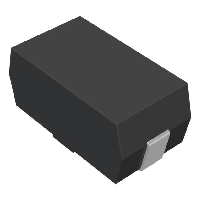

METAL GLAZE HIGH VOLTAGE SMD RESISTORS Type SMV Series Key Features Flameproof UL94V0 molded package, resistant to sulfuration, heat and humidity. Metal-glaze elements provide high stable performance against environmental conditions and overload. High surge withstanding & pulse withstanding performance. TE Connectivity is pleased to introduce our Metal Glaze high voltage power resistor, the sister to our SM series power resistor, giving UL94V0 flame resistance and resistance to sulfur along with high surge and pulse withstand capabilities Characteristics – Electrical Excellent mechanical strength & electrical stability. Characteristics Resistance Tolerance Resistance Temp. Coeff. Power Rating Load Short Time Overload △R±1% No evidence of mechanical damage or insulation breakdown Insulation Resistance , MΩ Pulse Loading Capability △R/R≦±2% Dielectric Withstanding Voltage Solderability Resistance to Soldering Heat 1773242-1 CIS WR 02/2018 Standards ±5% (J) ±1% (F) ±200ppm / ℃ Surface Temp. 275℃ Max. △R/R≦±1% Dimensions in millimetres unless otherwise specified Minimum 95% coverage No evidence of mechanical damage. △R/R≦±1% Dimensions Shown for reference purposes only. Specifications subject to change Test Methods -65℃ ~ 200℃ Rated voltage for 30 minutes 2.5 times of rated voltage for 5 sec. AC 1000V for 1min. DC 500V megger IEC 60065 14.1 235℃±5℃ for 2 seconds 270 ±5℃ for 10±1 seconds For Email, phone or live chat, go to: www.te.com/help METAL GLAZE HIGH VOLTAGE SMD RESISTORS Environmental Characteristics Characteristics Standards Temp. cycle △R/R≦±2% Load life △R/R≦±5% Moisture-proof Load Life △R/R≦±5% Test Methods - °C i s → Roo Te p. i s → + °C i s → Roo Temp.(3mins) / (5 cycles) Rated power load 90 minutes ON 30 minutes OFF 70℃ 1000 hours Rated power load 90 minutes ON 30 minutes OFF 40℃ 95% RH 1000 hours Reference Standards: JIS C 5201 Dimensions and Resistance Range: Rated Power @20°C 1W 2W 3W A ±0.3 (mm) 4.0 5.5 7.3 B ±0.3 (mm) 6.7 10.5 13.5 C ±0.3 (mm) 1.4 1.7 1.7 D ±0.3 (mm) 3.55 5.0 6.8 E max. (mm) 7.9 12 17 F ±0.3 (mm) 1.5 2.3 2.5 Resistance Ra ge Ω 100K~10M 100K~10M 100K~10M Max. Working Voltage DC RMS 1600V 1150V 3500V 2500V 5000V 3500V Rated Continuous Working Voltage (RCWV) shall be determined from RCWV = √Rated Power x Resista ce Value or Max. Permissible Voltage listed above Whichever is lowest 1773242-1 CIS WR 02/2018 Dimensions in millimetres unless otherwise specified Dimensions Shown for reference purposes only. Specifications subject to change For Email, phone or live chat, go to: www.te.com/help METAL GLAZE HIGH VOLTAGE SMD RESISTORS Derating Curve For resistors operated in ambient temperatures above 20℃, power rating must be derated in accordance with the curve below Surface Temperature rise 1773242-1 CIS WR 02/2018 Dimensions in millimetres unless otherwise specified Dimensions Shown for reference purposes only. Specifications subject to change For Email, phone or live chat, go to: www.te.com/help METAL GLAZE HIGH VOLTAGE SMD RESISTORS Lightning Surge The resistors are designed to withstand 1.2/50 ㎲ pulse & 10/700 ㎲ according to IEC61000-4-5,30 pulse per voltage, 30 seconds between each pulse. The resistance value change rate between pre- and post-test shall be within ±5% 1773242-1 CIS WR 02/2018 Dimensions in millimetres unless otherwise specified Dimensions Shown for reference purposes only. Specifications subject to change For Email, phone or live chat, go to: www.te.com/help METAL GLAZE HIGH VOLTAGE SMD RESISTORS Pulse Characteristics Packaging Reel Dimensions (mm) 1773242-1 CIS WR 02/2018 Dimensions in millimetres unless otherwise specified Dimensions Shown for reference purposes only. Specifications subject to change For Email, phone or live chat, go to: www.te.com/help METAL GLAZE HIGH VOLTAGE SMD RESISTORS Tape dimensions (mm) PWR 1W 2W 3W B0 ±0.2 8 11.8 17.5 A0 ±0.2 4.3 5.8 7.8 P1 ±0.1 8 12 16 P2 ±0.1 2 2 2 P0 ±0.1 4 4 4 D0 ±0.1 1.5 1.5 1.5 E ±0.1 1.75 1.75 1.75 F ±0.1 7.5 11.5 14.2 W ±0.3 16 24 32 D1 ±0.1 1.5 1.5 1.5 T ±0.1 4.15 5.8 7.5 RL QTY 2000 1000 500 How To Order SMV Common Part 2W Power rating 100K Resistance Value J T Tolerance Pack Style 100 K ohms 100,000 ohm s100K SMV 1W 2W 3W 1 M ohm 1,000,000 ohms 1M0 F – 1% J – 5% T – Tape & Reel 10 M ohms 10,000,000 ohms 10M 1773242-1 CIS WR 02/2018 Dimensions in millimetres unless otherwise specified Dimensions Shown for reference purposes only. Specifications subject to change For Email, phone or live chat, go to: www.te.com/help

物料型号:SMV系列
器件简介:TE Connectivity推出的金属釉高压功率电阻器,具有UL94V0阻燃性能,抗硫化,耐高温和湿度。
引脚分配:文档中未明确提供引脚分配信息。
参数特性: - 电阻公差:±5%(J)±1%(F) - 电阻温度系数:+200ppm/°C (-65°C~200°C) - 功率额定负载:表面温度最高275°C,R/R≤±1% - 短时间过载:额定电压的2.5倍,持续5秒 - 耐电压:AC 1000V,1分钟,无机械损伤或绝缘击穿 - 绝缘电阻:10,000 MΩ - 脉冲负载能力:IEC 60065-14.1标准,AR/R≤±2% - 焊锡性:最小95%覆盖率,235°C±5°C,持续2秒 - 耐焊锡热:270±5°C,持续10±1秒,无机械损伤,AR/R≤±1%
功能详解:金属釉元素提供高稳定性能,抵抗环境条件和过载。
应用信息:文档中未明确提供应用信息
封装信息:提供了详细的尺寸和电阻范围,以及额定功率和最大工作电压。例如,1W型号的尺寸为A±0.3 mm x B±0.3 mm x C±0.3 mm等,电阻范围从100K到10M,最大工作电压为1600V。
