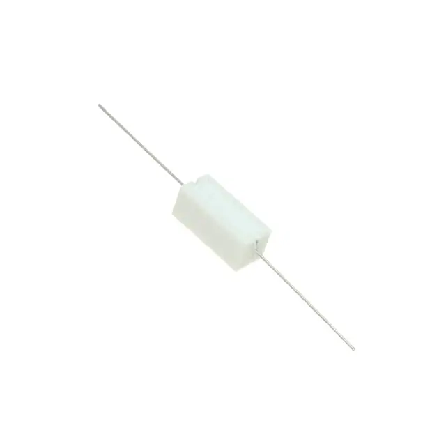

High Power Resistors Type SQ Series Key Features I Choice of Styles I Bracketed Types Available I Temp. Op. -55°C to +250°C I Wide Value Range I Stable TCR 300ppm/°C I Custom Designs Welcome I Inorganic Flame Proof Construction This flexible range of Power Wirewound Resistors either have wire or power oxide film elements. The SQ series resistors are wound or deposited on a fine non - alkali ceramic core then embodied in a ceramic case and sealed with an inorganic silica filler. This design provides a resistor with high insulation resistance, low surface temperature, excellent T.C.R., and entirely fire proof construction. These resistors are ideally suited to a range of areas where low cost, and efficient thermal performance are important design criteria. Metal film cores adjusted by laser spiral are used where the resistor value is above that suited to wire. Similar performance is obtained although short time overload is slightly derated. Characteristics - Electrical Test Condition Performance Resistance Temp. Coefficient: -55°C ~ 155°C ± 300ppm/°C *Short Time Overload: 10 times rated power for 5 seconds ± 2% Rated Load: Rated power for 30 minutes ± 1% Voltage Withstand: 1000V AC 1 minute no change Insulation Resistance: 500V megger 1000 Meg Temperature Cycle: -30°C ~ 85°C for 5 cycles ± 1% Load Life: 70°C on-off cycle for 1000 hours ± 5% Moisture-proof Load Life: 40°C 95% RH on-off cycle 1000 hours ± 5% Incombustability: 16 times rated wattage for 5 minutes No flame Max. Overload Voltage: 2 times max. working voltage *Metal Film Elements: Short time overload 5 times rated power, 5 seconds Type SQP - Horizontal 35 ±3 2W: 23 ±3 d H L W Dimensions H ± 1 L ± 1.5 d ± 0.05 l ± 0.3 Resistance Range Wire Metal Film ø2.7 Power Rating W±1 Max. Working Voltage 2W 7 7 18 0.65 23 R10 - 82R 83R - 10K 3W 8 8 22 0.8 35 R10 - 180R 181R - 33K 350V 5W 10 9 22 0.8 35 R10 - 180R 181R - 100K 350V 150V 7W 10 9 35 0.8 35 R10 - 430R 431R - 100K 500V 10W 10 9 48 0.8 35 R10 - 470R 471R - 100K 750V 15W 12.5 11.5 48 0.8 35 R50 - 600R 601R - 150K 1000V 20W - 25W 14 13.5 60 0.8 35 R50 - 1K0 1.1K - 150K 1000V Rated Continuous Working Voltage (RCWV) RCWV: Rated Power x Resistance Value or Maximum Working Voltage listed above whichever is lower 1773285 CIS BI 06/2011 Dimensions are in millimeters and inches unless otherwise specified. Values in brackets are standard equivalents. Dimensions are shown for reference purposes only. Specifications subject to change. For email, phone or live chat, go to: te.com/help High Power Resistors Type SQ Series Type SQH - Horizontal with Faston Connectors Power Rating W±1 H±1 L ± 1.5 P Dimensions H1± 1 D±0.5 P1±0.2 P2±0.2 Resistance Range Wire Metal Film 10W 10 10 48 32 ±1 21 5 2.5 1.7 R50 - 600R 601R - 50K 15W 12.5 11.5 48 32 ±1 21 5 2.5 1.7 1R0 - 600R 601R - 50K 20W 14.5 13.5 60 42 ±1 24 6 3.0 2.5 1R0 - 1K0 1K1 - 50K 30W 19 19 75 55 ±2 31 7.5 – – 1R0 - 2K0 – 40W 19 19 90 67 ±2 31 7.5 – – 1R0 - 2K0 – Type SQB - Horizontal with Faston Connectors and Bracket Power Rating Dimensions B ± 0.5 C ± 0.5 5.0 12.0 10W A ± 0.5 8.0 G ± 0.5 3.0 15W 8.0 5.5 12.0 20W 8.0 5.5 12.0 3.0 30W 10.5 8.0 18.0 3.5 40W 10.5 8.0 18.0 3.5 3.0 Power Derating Curve 100 -55 Load Against Temperature -70 300 15W-40W Surface Temperature (°C) Rated Load (%) 80 60 40 20 0 -50 0 50 100 150 200 155°C 250 7W, 10W 200 5W 150 100 50 250 300 275°C 0 Ambient Temperature (°C) 0 20 40 06 80 100 Rated Load (%) Type SQM - Vertical Power Rating Dimensions H±1 S ± 1.5 20 7 P ± 2.0 5 Resistance Range Wire Metal Film R10 - 82R 83R - 10K 2W W±1 11 3W 12 25 8 5 R10 - 180R 181R - 33K 5W 13 25 9 5 R10 - 180R 181R - 100K 7W 13 39 9 5 R10 - 430R 431R - 100K 10W 13 51 9 5 R10 - 470R 471R - 100K 10WS 16 35 12 7.5 R10 - 360R 361R - 100K N.B. Custom design versions in wire at low tolerances, better T.C.R., and higher ohmic values are available to special order. Please enquire. 1773285 CIS BI 06/2011 Dimensions are in millimeters and inches unless otherwise specified. Values in brackets are standard equivalents. Dimensions are shown for reference purposes only. Specifications subject to change. For email, phone or live chat, go to: te.com/help High Power Resistors Type SQ Series Type SPS - Vertical Mounting with Stabilising Bracket 5.0 5.0 5.0 5.0 2.0 Ø1.0 R0.2 0.8 Suggested PCB Layout Plan Power Rating 7W Dimension L ± 1.5 K ± 0.5 48 8.5 10W 60 Resistance Range Wire Metal Film R10 - 430R 431R - 100K 20 R10 - 470R 471R - 100K Type SQZ - Horizontal Pluggable Power Rating W±1 H±1 Dimensions L±1.5 P±1.5 P1 P2 P3 P4 H1±1 H2±1 Resistance Range Wire Metal Film 5W 10 10 28 15 4.2 2 5 1.5 25 10.5 R10 - 130R 7W 10 10 36 20 4.2 2 5 1.5 25 10.5 R10 - 430R 431R - 100K 10W 10 10 48 32 4.2 2 5 1.5 25 10.5 R20 - 470R 471R - 100K 15W 12.5 20W-25W* 15 131R - 100K 12 48 32 4.2 2 5 1.5 26 10.5 1R0 - 600R 601R - 150K 13 60 42 7 6 10 2.7 36 15.0 1R0 - 1K0 1K1 - 150K *NB: 20W & 25W Devices Terminations are not crimped Type SQZ - Recommended PCB Hole Dimensions Power Rating a b p 5W 2.0 0.8 15 7W 2.0 0.8 20 10W 2.0 0.8 32 15W 2.0 0.8 32 20W_25W 3.5 1.0 42 How to Order SQP W 20 1R0 F Common Part Element Rated Power Resistance Value Resistance Tolerance SQP - Axial Type SQZ - Pluggable Type SQM - Vertical Type SPS - Vertical Type SQH - Horizontal Type SQB - Horizontal Type (with bracket) 2 - 2 Watts W - Wire R - Metal Film 3 - 3 Watts 5 - 5 Watts etc 0.1 ohm (1 milliohm) R10 1 ohm (1000 milliohms) 1R0 1K ohm (1000 ohms) 1K0 1M ohm (1000000 ohms) 1M0 F - ±1% G - ±2% J - ±5% K - ±10% TE Connectivity, TE connectivity (logo) and TE (logo) are trademarks. Other logos, product and Company names mentioned herein may be trademarks of their respective owners. While TE has made every reasonable effort to ensure the accuracy of the information in this datasheet, TE does not guarantee that it is error-free, nor does TE make any other representation, warranty or guarantee that the information is accurate, correct, reliable or current. TE reserves the right to make any adjustments to the information contained herein at any time without notice. TE expressly disclaims all implied warranties regarding the information contained herein, including, but not limited to, any implied warranties of merchantability or fitness for a particular purpose. The dimensions in this datasheet are for reference purposes only and are subject to change without notice. Specifications are subject to change without notice. Consult TE for the latest dimensions and design specifications.

物料型号:SQ系列高功率电阻器,包括SQP、SQH、SQB、SQM、SPS和SQZ等型号。
器件简介:SQ系列电阻器采用线绕或功率氧化膜元件,绕制在非碱性陶瓷芯上,封装在陶瓷外壳中,并用无机硅填充密封。设计提供了高绝缘电阻、低表面温度、优异的温度系数(TCR)、完全防火构造。
引脚分配:不同型号的电阻器有不同的尺寸和引脚分配,例如SQP型号具有轴向引脚,SQZ型号为水平可插拔型。
参数特性: - 电阻温度系数(RTC):在-55°C至155°C范围内为±300ppm/°C。 - 短时间过载:额定功率的10倍,持续5秒,变化±2%。 - 额定负载:额定功率下30分钟,变化±1%。 - 耐压:1000V AC,1分钟,无变化。 - 绝缘电阻:500V兆欧表测试,达到1000兆欧。 - 温度循环:-30°C至85°C,5个循环,变化±1%。 - 负载寿命:70°C开关循环1000小时,变化±5%。 - 防潮负载寿命:40°C,95%相对湿度下开关循环1000小时,变化±5%。 - 防火性:额定瓦特数的16倍,持续5分钟,无火焰。 - 最大过载电压:最大工作电压的2倍。
功能详解:SQ系列电阻器适用于多种应用,特别是在需要高可靠性和稳定性的场合。
应用信息:这些电阻器适用于需要低成本和高效热性能的多种应用领域。
封装信息:提供了详细的尺寸信息和推荐PCB布局计划,以确保电阻器的正确安装和性能。
订购指南:提供了如何根据电阻值、公差、额定功率和元件类型进行订购的示例。
