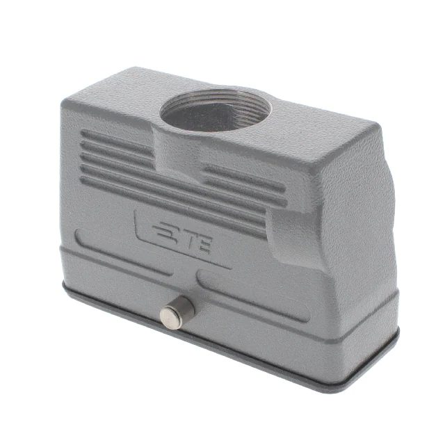

    HUMIREL(泰科)
    胶壳及附件 重载连接器 H24B-TSBH-PG29
T1930240129-000 数据手册
4 THIS DRAWING IS UNPUBLISHED. C COPYRIGHT 1 20 RELEASED FOR PUBLICATION REVISIONS ALL RIGHTS RESERVED. BY - 20 2 3 P DESCRIPTION LTR A A1 D B DATE DWN APVD INITIAL RELEASE 25JUN2015 DL CW ECR-15-011116 28JUL2015 DL CW ECR-20-014876 28JUL2021 WQR CW D PG/M 45 C 14.3 78.5 C NOTES: 1. TECHNICAL CHARACTERISTICS: BODY MATERIAL: DIE CAST ALUMINIUM ALLOY SURFACE TREATMENT: POWDER-COATED, GRAY DEGREE OF PROTECTION: IP65 (MATED) 61 121.8 104 1. 4X M3 THREAD 4X M3 THIS DRAWING IS A CONTROLLED DOCUMENT. TOLERANCES UNLESS OTHERWISE SPECIFIED: DIMENSIONS: mm A MATERIAL 1470-19 (3/13) : : : , : IP65( B ) 27 B 44.8 : 0 1 2 3 4 PLC PLC PLC PLC PLC ANGLES TBD - FINISH - - DWN 25JUN2015 CHK 25JUN2015 APVD 25JUN2015 DAVID LI CHRIS WANG XU XIANG PRODUCT SPEC T1930240129-000 H24B-TSBH-PG29 PG29 T1930240140-000 H24B-TSBH-M40 M40 ASSEMBLY PART NUMBER ASSEMBLY PART DESCRIPTION PG/M TE Connectivity NAME H24B-TSBH-PG/M A 108-137013 APPLICATION SPEC - 114-137013 WEIGHT Customer Drawing SIZE A3 CAGE CODE - DRAWING NO RESTRICTED TO - T19302401XX000 SCALE 3:4 SHEET 1 OF 1 REV B
