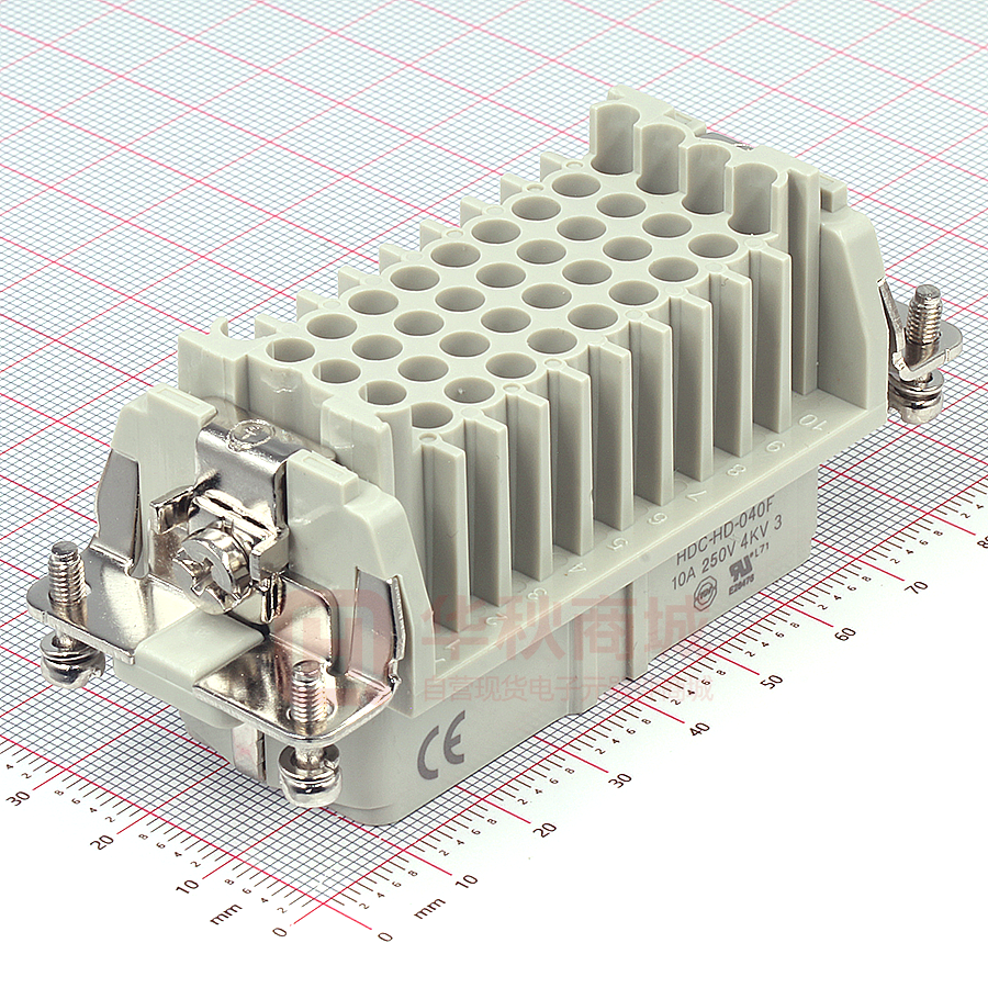

    电源连接器 40Pin(4x10)
T2020402201-000 数据手册
4 THIS DRAWING IS UNPUBLISHED. C COPYRIGHT 20 2 3 1 20 RELEASED FOR PUBLICATION REVISIONS ALL RIGHTS RESERVED. BY - P DESCRIPTION LTR B 77.5 B1 D B2 ( 1.2 ) C : 1. ( 84.5 ) APVD ECR-15-013292 24SEP2015 DL CW ECR-15-017530 02DEC2015 GY CW ECR-16-015492 08NOV2016 QY CW ECR-21-105750 30JUN2021 BS CW : : : : : 4X M3 SCREW RECOMMENDED TIGHTENING TORQUE 0.5Nm 4X M3 , 0.5Nm M4 SCREW RECOMMENDED TIGHTENING TORQUE 1.2Nm M4 , 1.2Nm 34 DWN D NOTES: 1. TECHNICAL CHARACTERISTICS: INSULATION MATERIAL: PC RATED VOLTAGE: 250 V RATED CURRENT: 10 A INSULATION RESISTANCE: >=400M ^ RATED IMPULSE VOLTAGE: 4 KV POLLUTION DEGREE: 3 FLAMMABILITY: UL94V-0 MATING CYCLES: 500 CYCLES WIRE RANGE: 0.14-2.5 mm² (26-14 AWG) CONTACT TYPE: CRIMP CONTACT 2. CONTACT NEED TO BE ORDERED SEPARATELY. (ORDER No. REFER TO DRAWING:T20200X20XX000) 38.9 20.6 27 C DATE : : : : : 2. ( C PC 250V 10A >=400M ^ : 4 KV 3 UL94V-0 500 0.14-2.5 mm² (26-14 AWG) . : T20200X20XX000) B B 7.75 TYPE-1,T2020402201-000,TE LOGO -1,T2020402201-000,TE LOGO 68.5 36 27 18 TYPE-2,T2020402201-001,STAINLESS STEEL SCREW,TE LOGO -2,T2020402201-001, ,TE LOGO THIS DRAWING IS A CONTROLLED DOCUMENT. TOLERANCES UNLESS OTHERWISE SPECIFIED: DIMENSIONS: A 4X 3.3 77.5 PANEL CUT OUT FOR INSERTS FOR USE WITHOUT HOODS/HOUSINGS 1470-19 (3/13) mm MATERIAL 0 1 2 3 4 PLC PLC PLC PLC PLC ANGLES - FINISH - - 16DEC2014 RAGHAVENDRA H M CHK 16DEC2014 CHRIS WANG APVD 16DEC2014 XU XIANG DWN PRODUCT SPEC TE Connectivity NAME HD-040-F A 108-137042 APPLICATION SPEC - - WEIGHT SIZE - Customer Drawing A3 CAGE CODE - DRAWING NO RESTRICTED TO - T2020402201000 SCALE 1:1 SHEET 1 OF 2 REV C 4 THIS DRAWING IS UNPUBLISHED. C COPYRIGHT 20 RELEASED FOR PUBLICATION BY - 2 3 1 20 REVISIONS ALL RIGHTS RESERVED. P DESCRIPTION LTR - DATE SEE SHEET 1 DWN APVD - - - D D NOTE: SEE SHEET 1 : 1 C C TYPE-3,T2020402201-002,STAINLESS STEEL SCREW,NO LOGO -3,T2020402201-002, , LOGO B ALL DIMENSIONS ARE SAME AS TYPE 1, EXCEPT THOSE DEFINED IN THIS TYPE. , 1 T2020402201-002 HD-040-F T2020402201-001 HD-040-F T2020402201-000 HD-040-F TOLERANCES UNLESS OTHERWISE SPECIFIED: A MATERIAL 1470-19 (3/13) 0 1 2 3 4 PLC PLC PLC PLC PLC ANGLES - HD-040 FEMALE INSERT HD-040 TYPE-1 -1 FINISH - - 16DEC2014 RAGHAVENDRA H M CHK 16DEC2014 CHRIS WANG APVD 16DEC2014 XU XIANG TYPE DWN PRODUCT SPEC TE Connectivity NAME HD-040-F A 108-137042 APPLICATION SPEC - B TYPE-2 -2 PART DESCRIPTION THIS DRAWING IS A CONTROLLED DOCUMENT. mm TYPE-3 -3 HD-040 FEMALE INSERT,STAINLESS STEEL SCREW HD-040 , PART NUMBER DIMENSIONS: HD-040 FEMALE INSERT, STAINLESS STEEL SCREW,NO LOGO HD-040 , , LOGO - WEIGHT SIZE - Customer Drawing A3 CAGE CODE - DRAWING NO RESTRICTED TO - T2020402201000 SCALE 1:1 SHEET 2 OF 2 REV C
