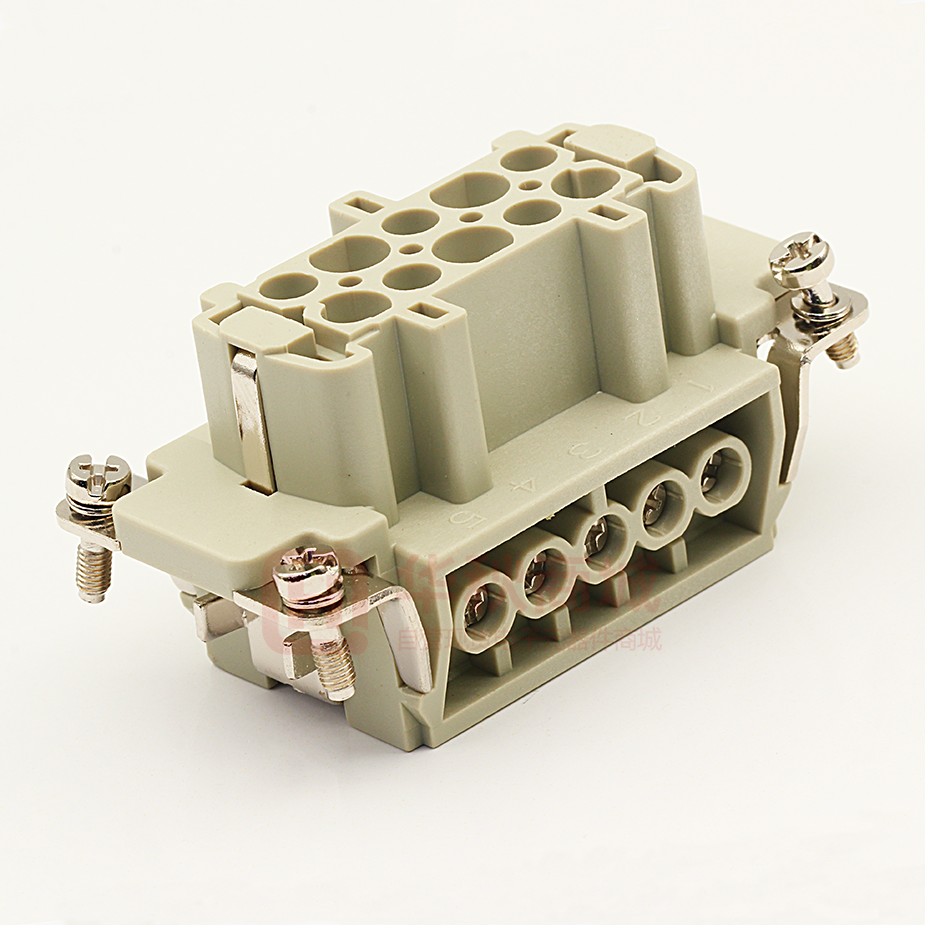

    HUMIREL(泰科)
    线对线连接器 14-20AWG 10Pin(2x5)
T2040102201-000 数据手册
4 THIS DRAWING IS UNPUBLISHED. C COPYRIGHT 1 20 RELEASED FOR PUBLICATION REVISIONS ALL RIGHTS RESERVED. BY - 20 2 3 P 5 48 A 64 D DESCRIPTION LTR B B1 n3 .3 PANEL CUT FOR INSERTS FOR USE WITHOUT HOODS/ HOUSINGS M4 SCREW,RECOMMENDED TIGHTENING TORQUE 1.2Nm M4 , 1.2Nm : ( 23.3 ) 17.3 1. 1.2 34.5 C 10X M3 SCREW,RECOMMENDED TIGHTENING TORQUE 0.5Nm 10X M3 , 0.5Nm APVD INITIAL RELEASE 14APR2015 GY CW ECR-15-013759 27SEP2015 DW CW ECR-16-011988 25AUG2016 YC CW ECR-18-017123 15DEC2018 KW CW D NOTES: 1. TECHNICAL CHARACTERISTICS: INSULATION MATERIAL: PC RATED VOLTAGE: 500V RATED CURRENT: 16A INSULATION RESISTANCE: >=400M ^ RATED IMPULSE VOLTAGE: 6KV POLLUTION DEGREE: 3 FLAMMABILITY: UL94V-0 MATING CYCLES: 500 CYCLES WIRE RANGE: 0.5mm²~2.5mm² (AWG20-AWG14) CONTACT TYPE: SCREW CLAMP (M3) 4X 57 DWN 36 33.8 27 14 B2 DATE 4X M3 SCREW,RECOMMENDED TIGHTENING TORQUE 0.5Nm 4X M3 , 0.5Nm : : : : : : : : : : : C PC 500V 16A >=400M ^ 6KV 3 UL94V-0 500 0.5mm²~2.5mm² (AWG20-AWG14) (M3) B 27 B TYPE 1,T2040102201-000,WITH LOGO 1,T2040102201-000, LOGO 57 THIS DRAWING IS A CONTROLLED DOCUMENT. TOLERANCES UNLESS OTHERWISE SPECIFIED: DIMENSIONS: mm A MATERIAL 1470-19 (3/13) 0 1 2 3 4 PLC PLC PLC PLC PLC ANGLES - FINISH - - DWN 14APR2015 CHK 14APR2015 APVD 14APR2015 GINO YAO CHRIS WANG XIANG XU PRODUCT SPEC TE Connectivity NAME HE-010-F A 108-137044 APPLICATION SPEC - 114-137044 WEIGHT CUSTOMER DRAWING SIZE CAGE CODE A3 00779 DRAWING NO RESTRICTED TO - T2040102201000 SCALE 1:1 SHEET 1 OF 2 REV B2 4 THIS DRAWING IS UNPUBLISHED. C COPYRIGHT 20 2 3 RELEASED FOR PUBLICATION BY - 1 20 REVISIONS ALL RIGHTS RESERVED. P DESCRIPTION LTR - DATE SEE SHEET 1 DWN APVD - - - D D TYPE 2,T2040102201-001,WITHOUT LASER SIDE MARK 2,T2040102201-001, NOTE: ALL SPEC REFER TO TYPE 1 : TYPE 1 C B C TYPE 3,T2049102201-000,WITHOUT LASER LOGO 3,T2049102201-000, LOGO T2040102201-000 HE-010-F T2040102201-001 HE-010-F T2049102201-000 HE-010-F PART NUMBER THIS DRAWING IS A CONTROLLED DOCUMENT. TOLERANCES UNLESS OTHERWISE SPECIFIED: DIMENSIONS: mm A MATERIAL 1470-19 (3/13) 0 1 2 3 4 PLC PLC PLC PLC PLC ANGLES - FINISH - - B HE-010 FEMALE INSERT HE-010 TYPE 1 HE-010 FEMALE INSERT,WITHOUT LASER SIDE MARK HE-010 , TYPE 2 HE-010 FEMALE INSERT,WITHOUT LOGO HE-010 , LOGO TYPE 3 PART DESCRIPTION DWN 14APR2015 CHK 14APR2015 APVD 14APR2015 GINO YAO CHRIS WANG XIANG XU PRODUCT SPEC TYPE TE Connectivity NAME HE-010-F A 108-137044 APPLICATION SPEC - 114-137044 WEIGHT CUSTOMER DRAWING SIZE CAGE CODE A3 00779 DRAWING NO RESTRICTED TO - T2040102201000 SCALE 1:1 SHEET 2 OF 2 REV B2
