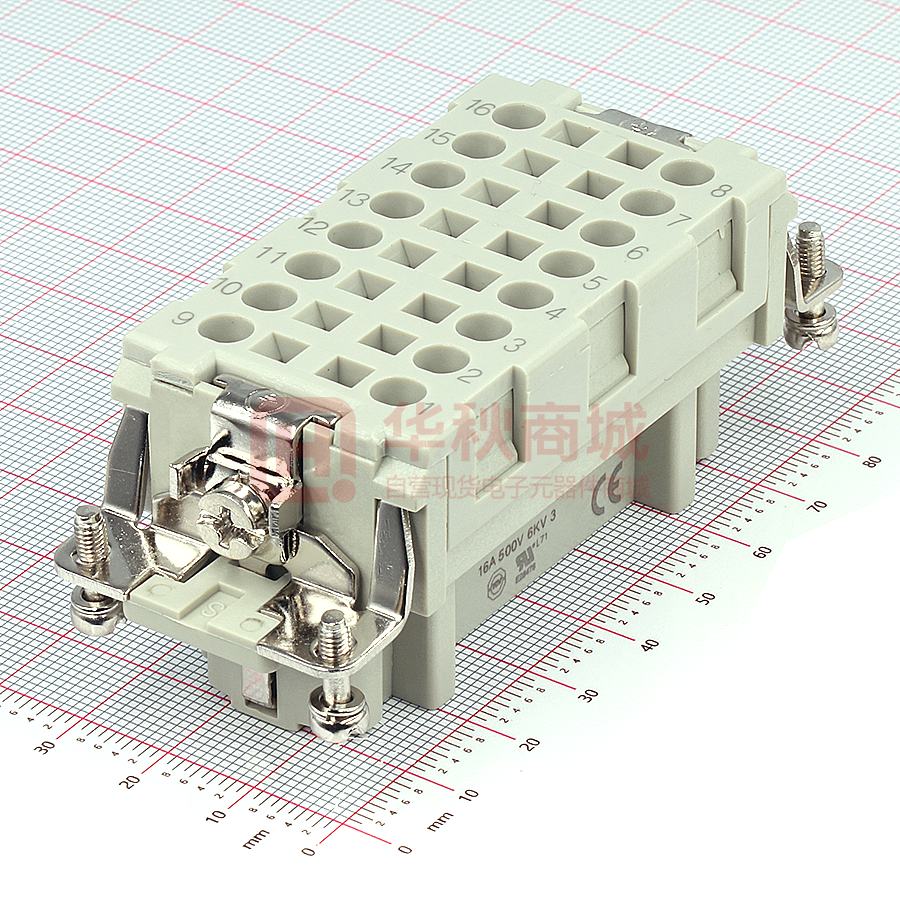

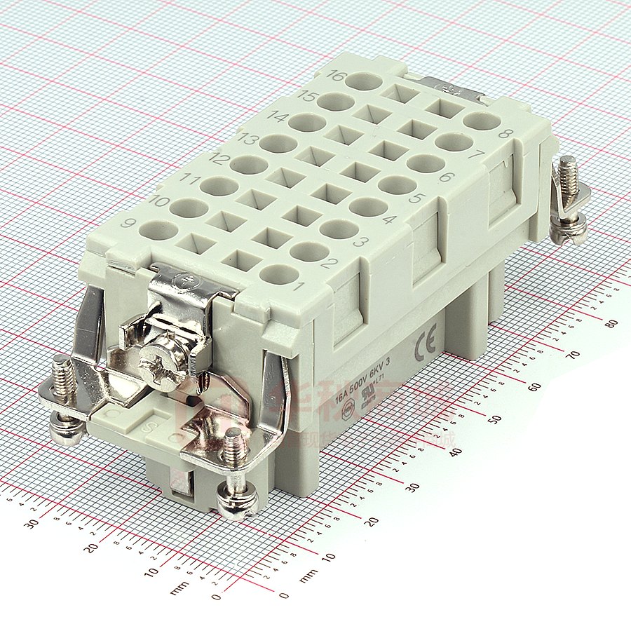

    HUMIREL(泰科)
    胶壳及附件 16Pin(2x8) 14–20AWG
T2040163201-000 数据手册
4 THIS DRAWING IS UNPUBLISHED. C COPYRIGHT 1 20 RELEASED FOR PUBLICATION REVISIONS ALL RIGHTS RESERVED. BY - 20 2 3 P DESCRIPTION LTR 84.5 A B D B1 DWN APVD INITIAL RELEASE 15APR2015 CY CW ECR-15-013759 09OCT2015 DW CW ECR-16-009892 13JUL2016 RL CW ECR-21-106515 12AUG2021 SQ CW D 33.8 C DATE C 34.5 1.2 ( 23.3 ) 17.3 4X M3 SCREW RECOMMENDED TIGHTENING TORQUE 0.5Nm 4 X M3 , 0.5Nm NOTES: 1. TECHNICAL CHARACTERISTICS: INSULATION MATERIAL: PC RATED VOLTAGE: 500V RATED CURRENT: 16A INSULATION RESISTANCE: >=400M ^ RATED IMPULSE VOLTAGE: 6KV POLLUTION DEGREE: 3 FLAMMABILITY: UL94V-0 MATING CYCLES: 500 CYCLES WIRE RANGE: 0.5mm²~2.5mm² (AWG20-AWG14) CONTACT FINISH: SILVER PLATED CONTACT TYPE: SPRING CLAMP : 1. : : : : : : : : : : 27 M4 SCREW, RECOMMENDED TIGHTENING TORQUE 1.2Nm M4 , 1.2Nm 5 68.5 : 77.5 HE-016-FS T2040163201-000 HE-016-FS n3 .3 THIS DRAWING IS A CONTROLLED DOCUMENT. PANEL CUT OUT FOR INSERTS FOR USE WITHOUT HOODS/HOUSING TOLERANCES UNLESS OTHERWISE SPECIFIED: DIMENSIONS: mm A MATERIAL 1470-19 (3/13) T2040163201-001 0 1 2 3 4 PLC PLC PLC PLC PLC ANGLES - FINISH - - PC 500V 16A >=400M ^ 6KV 3 UL94V-0 500 0.5mm²~2.5mm² (AWG20-AWG14) : B HE-016 FEMALE INSERT, STAINLESS STEEL SCREW, SPRING CLAMP HE-016 , , HE-016 FEMALE INSERT, SPRING CLAMP HE-016 , PART NUMBER 4X 77.5 36 14 27 B PART DESCRIPTION DWN 15APR2015 CHK 15APR2015 APVD 15APR2015 Gino.Yao Chris.Wang Xiang.Xu PRODUCT SPEC C STAINLESS STEEL STAINLESS STEEL STEEL STEEL FIXING SCREW MAT'L GROUND CONTACT SCREW MAT'L TE Connectivity NAME HE-016-FS A 108-137044 APPLICATION SPEC - 114-137044 WEIGHT Customer Drawing SIZE CAGE CODE A3 00779 DRAWING NO RESTRICTED TO - T2040163201000 SCALE 4:5 SHEET 1 OF 1 REV C
