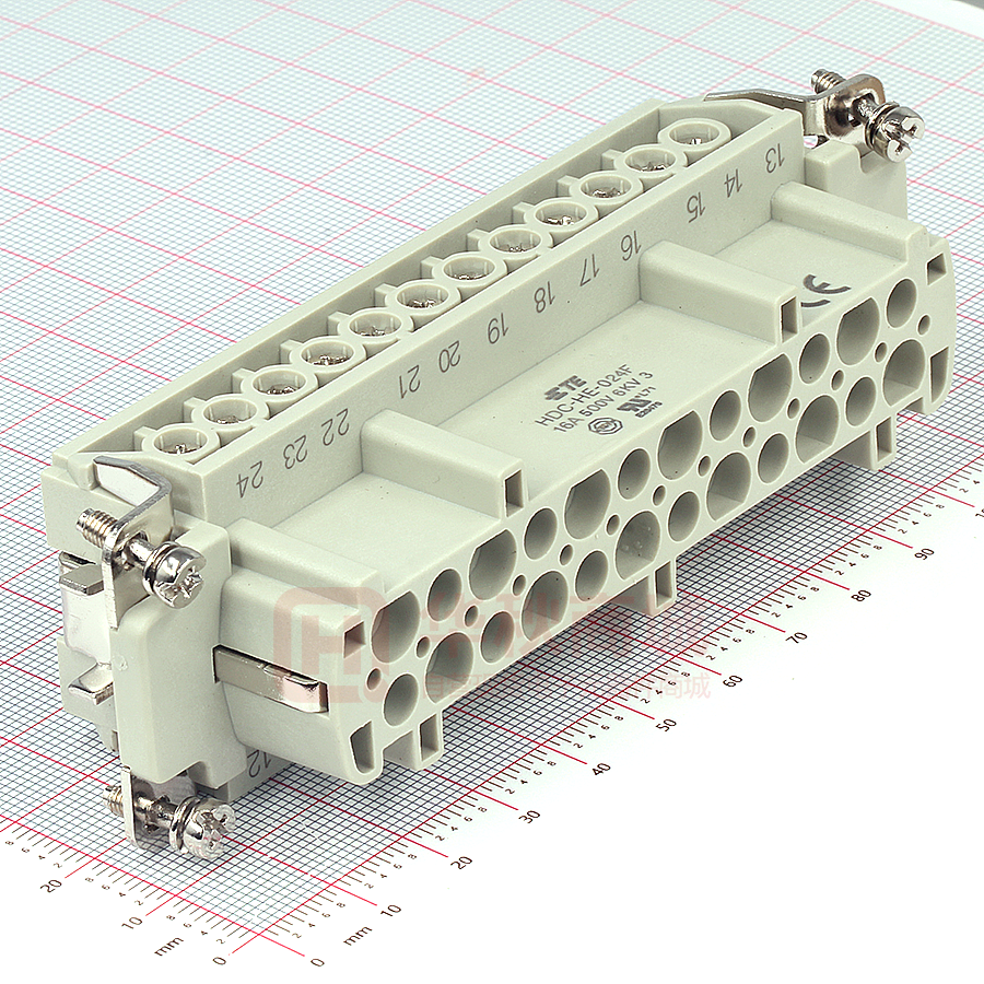

    线对线连接器 14~20AWG 24Pin(2x12)
T2040242201-000 数据手册
4 THIS DRAWING IS UNPUBLISHED. C COPYRIGHT RELEASED FOR PUBLICATION 1 20 REVISIONS ALL RIGHTS RESERVED. BY - 20 2 3 P A 111 A1 D B 33.8 B1 ( 23.3 ) 17.3 1.2 34.5 C : 1. 27 4X M3 SCREW,RECOMMENDED TIGHTENING TORQUE 0.5Nm 4X M3 , 0.5Nm B DATE DWN APVD INITIAL 05JAN2015 GY CW ECR-15-004309 24MAR2015 GY CW ECR-15-013759 26SEP2015 DW CW ECR-16-011988 27AUG2016 YC CW : : : : : : : : : : : C PC 500V 16A >=400M ^ 6KV 3 UL94V-0 500 0.5mm²~2.5mm² (AWG20-AWG14) (M3) B 104 36 4X n 3.3 14 95 27 5 TYPE 1,T2040242201-000,WITH LOGO 1,T2040242201-000, LOGO THIS DRAWING IS A CONTROLLED DOCUMENT. TOLERANCES UNLESS OTHERWISE SPECIFIED: DIMENSIONS: mm A 104 PANEL CUT FOR INSERTS FOR USE WITHOUT HOODS/ HOUSINGS 1470-19 (3/13) D NOTES: 1. TECHNICAL CHARACTERISTICS: INSULATION MATERIAL: PC RATED VOLTAGE: 500V RATED CURRENT: 16A INSULATION RESISTANCE: >=400M ^ RATED IMPULSE VOLTAGE: 6KV POLLUTION DEGREE: 3 FLAMMABILITY: UL94V-0 MATING CYCLES: 500 CYCLES WIRE RANGE: 0.5mm²~2.5mm² (AWG20-AWG14) CONTACT TYPE: SCREW CLAMP (M3) M4 SCREW,RECOMMENDED TIGHTENING TORQUE 1.2Nm M4 , 1.2Nm 24X M3 SCREW,RECOMMENDED TIGHTENING TORQUE 0.5Nm 24X M3 , 0.5Nm DESCRIPTION LTR MATERIAL 0 1 2 3 4 PLC PLC PLC PLC PLC ANGLES - FINISH - - DWN 15AUG2014 CHK 15AUG2014 APVD 15AUG2014 GINO YAO CHRIS WANG XIANG XU TE Connectivity NAME PRODUCT SPEC HE-024-F A 108-137044 APPLICATION SPEC - 114-137044 WEIGHT CUSTOMER DRAWING SIZE CAGE CODE A3 00779 DRAWING NO RESTRICTED TO T2040242201000 SCALE 1:1 SHEET - 1 OF 2 REV B1 4 THIS DRAWING IS UNPUBLISHED. C COPYRIGHT 20 RELEASED FOR PUBLICATION BY - 2 3 1 20 REVISIONS ALL RIGHTS RESERVED. P DESCRIPTION LTR DATE DWN APVD SEE SHEET 1 D D NOTE: ALL SPEC REFER TO TYPE 1 : TYPE 1 TYPE 2,T2040242201-001,WITHOUT LOGO 2,T2040242201-001, LOGO C C B B T2040242201-000 HE-024-F T2040242201-001 HE-024-F PART NUMBER THIS DRAWING IS A CONTROLLED DOCUMENT. TOLERANCES UNLESS OTHERWISE SPECIFIED: DIMENSIONS: mm A MATERIAL 1470-19 (3/13) 0 1 2 3 4 PLC PLC PLC PLC PLC ANGLES - FINISH - - 15AUG2014 CHK 15AUG2014 APVD 15AUG2014 CHRIS WANG XIANG XU TYPE 1 HE-024 FEMALE INSERT,WITHOUT LOGO HE-024 , LOGO TYPE 2 PART DESCRIPTION DWN GINO YAO HE-024 FEMALE INSERT HE-024 PRODUCT SPEC TYPE TE Connectivity NAME HE-024-F A 108-137044 APPLICATION SPEC - 114-137044 WEIGHT CUSTOMER DRAWING SIZE CAGE CODE A3 00779 DRAWING NO RESTRICTED TO T2040242201000 SCALE 1:1 SHEET - 2 OF 2 REV B1
