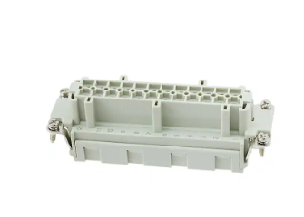

    HUMIREL(泰科)
    电源连接器 24Pin(2x12) 14–20AWG
T2040243201-000 数据手册
4 THIS DRAWING IS UNPUBLISHED. C COPYRIGHT 1 20 RELEASED FOR PUBLICATION REVISIONS ALL RIGHTS RESERVED. BY - 20 2 3 P DESCRIPTION LTR A 111 A1 D B DWN APVD INITIAL 05Jan2015 GY CW ECR-15-004309 24Mar2015 GY CW ECR-15-013759 26Sep2015 DW CW ECR-21-106515 21JUL2021 SQ CW D 33.8 C DATE NOTES: 1. TECHNICAL CHARACTERISTICS: INSULATION MATERIAL: PC RATED VOLTAGE: 500V RATED CURRENT: 16A INSULATION RESISTANCE: >=400M ^ RATED IMPULSE VOLTAGE: 6KV POLLUTION DEGREE: 3 FLAMMABILITY: UL94V-0 MATING CYCLES: 500 CYCLES OPERATION TEMPERATURE: -40 $ C~+125 $ C WIRE RANGE: 0.5mm²~2.5mm² (AWG20-AWG14) CONTACT TYPE: SPRING CLAMP ( 23.3 ) 17.3 1.2 34.5 M4 screw, recommended tightening torque 1.2Nm C 4 X M3 screw, recommended tightening torque 0.5Nm : 27 1. 104 B 5 : : : : : : : : : : : : PC 500V 16A >=400M ^ 6KV 3 UL94V-0 500 -40 $ C~+125 $ C 0.5mm²~2.5mm² (AWG20-AWG14) B 4X n 3.3 95 36 14 27 HE-024-FS THIS DRAWING IS A CONTROLLED DOCUMENT. TOLERANCES UNLESS OTHERWISE SPECIFIED: DIMENSIONS: mm 104 A Panel cut out for inserts for using without hoods/housings 1470-19 (3/13) C MATERIAL 0 1 2 3 4 PLC PLC PLC PLC PLC ANGLES - FINISH - - DWN 18Aug2014 CHK 18Aug2014 APVD 18Aug2014 Gino.Yao Chris.Wang Xiang.Xu T2040243201-000 DESCRIPTION PART NUMBER TE Connectivity NAME PRODUCT SPEC HE-024-FS A 108-137044 APPLICATION SPEC - 114-137044 WEIGHT CUSTOMER DRAWING SIZE CAGE CODE A3 00779 DRAWING NO RESTRICTED TO - T2040243201000 SCALE 1:1 SHEET 1 OF 1 REV C
