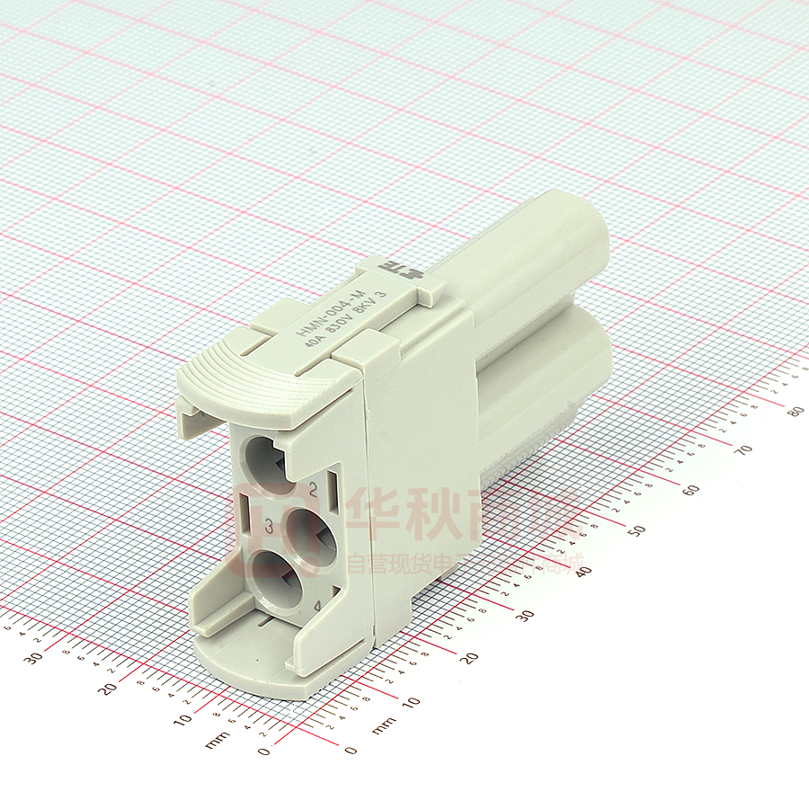

    HUMIREL(泰科)
    线对线连接器 10-15AWG 4Pin
T2111042101-000 数据手册
4 THIS DRAWING IS UNPUBLISHED. C COPYRIGHT 20 1 20 RELEASED FOR PUBLICATION BY - 2 3 REVISIONS ALL RIGHTS RESERVED. P DESCRIPTION LTR A B D C DATE DWN APVD INITIAL 20MAR2015 DW CW ECR-15-018270 07DEC2015 DW CW ECR-21-111798 23SEP2021 WQR CW D 14.5 NOTES: 1. TECHNICAL CHARACTERISTICS: INSULATION MATERIAL: PC RATED VOLTAGE: 830V RATED CURREN3T: 40A INSULATION RESISTANCE: >=400M ^ RATED IMPULSE VOLTAGE: 8KV POLLUTION DEGREE: 3 FLAMMABILITY: UL94V-0 MATING CYCLES: 500 CYCLES OPERATION TEMPERATURE: -40 $ C~+125 $ C WIRE RANGE: 1.5mm²~6.0mm² CONTACT TYPE: CRIMP CONTACT 2. CONTACT NEED TO BE ORDERED SEPARATELY. (ORDER No. REFER TO DRAWING:T20400X10XX000) 34.4 C 54.8 : 1. B 2. : : : : : : : : : : : : PC 830V 40A >=400M ^ 8KV 3 UL94V-0 500 -40 $ C~+125 $ C 1.5mm²~6.0mm² ( B . : T20400X10XX000) HMN-004-M THIS DRAWING IS A CONTROLLED DOCUMENT. TOLERANCES UNLESS OTHERWISE SPECIFIED: DIMENSIONS: mm A MATERIAL 1470-19 (3/13) 0 1 2 3 4 PLC PLC PLC PLC PLC ANGLES - FINISH - - DWN 20MAR2015 CHK 20MAR2015 APVD 20MAR2015 David Wang Chris.Wang Xiang.Xu C T2111042101-000 DESCRIPTION PART NUMBER TE Connectivity NAME PRODUCT SPEC HMN-004-M A 108-137060 APPLICATION SPEC - 114-137060 WEIGHT Customer Drawing SIZE CAGE CODE A3 00779 DRAWING NO RESTRICTED TO - T2111042101000 SCALE 3:2 SHEET 1 OF 1 REV C
