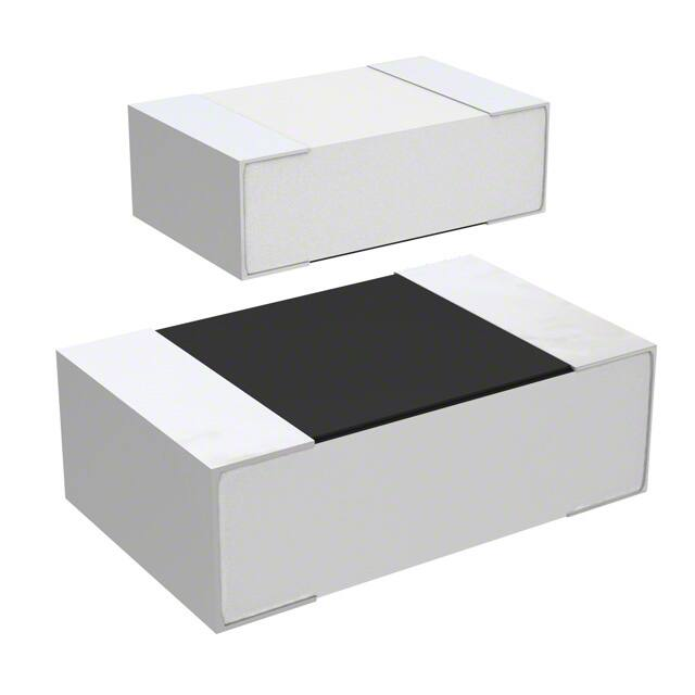

Trimmable Thick Film Chip Resistor Type TCR Series Key Features Suitable for laser fine tune Small size and light weight Highly reliable multilayer electrode construction Compatible with all soldering process Applications Tuner Mobile Phone Camcorder Portable Audio This Ruthenium based trimmable thick film chip resistor, suitable for laser fine tuning is ideal for use in circuits where a variable resistor might otherwise be used. Characteristics – Electrical Size 0402 0603 0805 1206 1210 2010 2512 Power Rating @70°C 0.0625W 0.1W 0.125W 0.25W 0.3W 0.75W 1W Max. Operating Voltage 50V 50V 150V 200V 200V 200V 250V Max. Overload Voltage 100V 100V 300V 400V 400V 400V 500V Tolerance Resistance Range Ω~ +0 ~ -10 +0 ~ -20 +0 ~ -30 MΩ Ω ~ 9. Ω ~ MΩ 1M02 ~ MΩ TCR (ppm/°C) ±200 ±200 ±100 ±200 Photo Sensor Operating Temperature range -55 ~ +155°C Portable Measuring Equipment Operating Voltage=√ P*R or Max. operating oltage listed a o e, whichever is lower. O erload Voltage= . *√ P*R or Max. o erload oltage listed a o e, hi he er is lower. Derating 1773287 Rev. B 10/2018 Dimensions in millimetres unless otherwise specified Dimensions Shown for reference purposes only. Specifications subject to change For Email, phone or live chat, go to: www.te.com/help Trimmable Thick Film Chip Resistor Environmental Characteristics Item Requirement Temperature Coefficient of Resistance (T.C.R.) As Spec. Short Time Overload Insulation Resistance Ω ≥10G Endurance ± . %+ . Ω Damp Heat with Load ± . %+ . Ω Dry Heat ± . %+ . Ω . %+ . Ω Bending Strength Solderability Resistance to Soldering Heat Voltage Proof 1773287 Rev. B 10/2018 ± . %+ . Dimensions in millimetres unless otherwise specified 95% min. coverage ± . %+ . Ω No breakdown or flashover Dimensions Shown for reference purposes only. Specifications subject to change Test Methods JIS-C-5201-1 4.8 IEC-60115-1 4.8 -55°C~+125°C, 25°C is the reference temperature JIS-C-5201-1 4.13 IEC-60115-1 4.13 RCWV*2.5 or Max. Overload Voltage whichever is lower for 5 seconds JIS-C-5201-1 4.6 IEC-60115-1 4.6 Max. Overload Voltage for 1 minute JIS-C-5201-1 4.25 IEC-60115-1 4.25.1 70±2°C, RCWV for 1000 hrs ith . hrs ON and . hr OFF JIS-C-5201-1 4.24 IEC-60115-1 4.24 40±2°C, 90~95% R.H. RCWV for 1000 hrs with . hrs ON and . hr OFF JIS-C-5201-1 4.23 IEC-60115-1 4.23.2 at +125/+155°C for 1000 hrs JIS-C-5201-1 4.33 IEC-60115-1 4.33 Bending once for 5 seconds 2010, 2512 sizes: 2mm Other sizes: 3mm JIS-C-5201-1 4.17 IEC-60115-1 4.17 245±5°C for 3 seconds JIS-C-5201-1 4.18 IEC-60115-1 4.18 260±5°C for 10 seconds JIS-C-5201-1 4.7 IEC-60115-1 4.7 1.42 times Max. Operating Voltage for 1 minute For Email, phone or live chat, go to: www.te.com/help Trimmable Thick Film Chip Resistor Environmental Characteristics (cont.) Item Requirement Individual leaching area ≦5% Total leaching area ≦10% Leaching Rapid Change of Temperature ± . %+ . Test Methods JIS-C-5201-1 4.18 IEC-60068-2-58 8.2.1 260±5°C for 30 seconds JIS-C-5201-1 4.19 IEC-60115-1 4.19 -55°C to +125/+155°C, 5 cycles Ω RCWV Rated Continuous Working Voltage =√ P*R or Max. Operating Voltage whichever is lower. Storage Temperature: 15~28°C; Humidity < 80%RH Construction and Dimensions 1 2 3 4 1773287 Rev. B 10/2018 Alumina Substrate Bottom Electrode Top Electrode Edge Electrode 5 6 7 8 Barrier Layer External Electrode Resistor Layer Primary Overcoat Size L (mm) W (mm) T (mm) D1 (mm) D2 (mm) 0402 0603 0805 1206 1210 2010 2512 1.00±0.05 1.60±0.10 2.00±0.10 3.10±0.10 3.10±0.10 5.00±0.10 6.35±0.10 0.50±0.05 0.80±0.10 1.25±0.10 1.55±0.10 2.60±0.15 2.50±0.15 3.10±0.15 0.35±0.05 0.45±0.10 0.50±0.10 0.55±0.10 0.55±0.10 0.55±0.10 0.55±0.10 0.20±0.10 0.30±0.20 0.35±0.20 0.50±0.25 0.50±0.25 0.60±0.25 0.60±0.25 0.20±0.10 0.30±0.20 0.40±0.20 0.50±0.20 0.50±0.20 0.50±0.20 0.50±0.20 Dimensions in millimetres unless otherwise specified Dimensions Shown for reference purposes only. Specifications subject to change Weight (g) (1000pcs) 0.620 2.042 4.368 8.947 15.959 24.241 39.448 For Email, phone or live chat, go to: www.te.com/help Trimmable Thick Film Chip Resistor Recommended Land Pattern Size 0402 0603 0805 1206 1210 2010 2512 A (mm) 0.50 0.90 1.20 2.00 2.00 3.80 3.80 B (mm) 0.45 0.60 0.70 0.90 0.90 0.90 1.60 C (mm) 0.60 0.90 1.30 1.60 2.80 2.80 3.50 Soldering Condition (1) Time of IR reflow soldering at maximum temperature point 260°C:10s (2) Time of wave soldering at maximum temperature point 260°C:10s (3) Time of soldering iron at maximum temperature point 410°C:5s 1773287 Rev. B 10/2018 Dimensions in millimetres unless otherwise specified Dimensions Shown for reference purposes only. Specifications subject to change For Email, phone or live chat, go to: www.te.com/help Trimmable Thick Film Chip Resistor Packaging Reel Specification Size Tape Type Qty Reel Tape Width Reel Nom. ØA (mm) ØB (mm) 0402 0603 0805 1206 1210 2010 2512 Paper Paper Paper Paper Paper Emboss Plastic 10K 5K 5K 5K 5K 4K 4K 8mm 8mm 8mm 8mm 8mm 12mm 12mm 7 inch 7 inch 7 inch 7 inch 7 inch 7 inch 7 inch 178.5±1.5 178.5±1.5 178.5±1.5 178.5±1.5 178.5±1.5 178.5±1.5 178.5±1.5 E ±0.10 1.75 1.75 1.75 1.75 1.75 F ±0.05 3.50 3.50 3.50 3.50 3.50 ⁺¹/₋ ⁺¹/₋ ⁺¹/₋ ⁺¹/₋ ⁺¹/₋ ⁺¹/₋ ⁺¹/₋ ØC (mm) W (mm) T (mm) 13.0±0.2 13.0±0.2 13.0±0.2 13.0±0.2 13.0±0.2 13.0±0.2 13.0±0.2 9.0±0.5 9.0±0.5 9.0±0.5 9.0±0.5 9.0±0.5 13.0±0.5 13.0±0.5 12.5±0.5 12.5±0.5 12.5±0.5 12.5±0.5 12.5±0.5 15.5±0.5 15.5±0.5 Paper Tape Specification. Dimensions (mm) Size 0402 0603 0805 1206 1210 1773287 Rev. B 10/2018 A ±0.10 0.65 1.10 1.60 1.90 2.90 B 1.15±0.10 1.90±0.10 2.40±0.20 3.50±0.20 3.50±0.20 Dimensions in millimetres unless otherwise specified W ±0.20 8.0 8.0 8.0 8.0 8.0 P ±0.10 4.00 4.00 4.00 4.00 4.00 Dimensions Shown for reference purposes only. Specifications subject to change P ±0.05 2.00 4.00 4.00 4.00 4.00 P ±0.05 2.00 2.00 2.00 2.00 2.00 ØD +0.1/-0 1.50 1.50 1.50 1.50 1.50 T ±0.10 0.45 0.70 0.85 0.85 0.85 For Email, phone or live chat, go to: www.te.com/help Trimmable Thick Film Chip Resistor Embossed Plastic Tape Specification Dimensions (mm) Size 2010 2512 A ±0.10 2.8 3.5 B ±0.10 5.5 6.7 W ±0.30 12.0 12.0 E ±0.10 1.75 1.75 F ±0.05 5.5 5.5 P ±0.10 4.00 4.00 P ±0.10 4.00 4.00 P ±0.05 2.00 2.00 ØD +0.1/-0 1.50 1.50 T ±0 1.2 1.2 How To Order TCR Common Part TCR 1773287 Rev. B 10/2018 Dimensions in millimetres unless otherwise specified 0805 Size 0402 0603 0805 1206 1210 2010 2512 N Resistance Tolerance 1K5 Resistance N: 0 ~ -10% P: 0 ~ -20% Q: 0 ~ -30% 1R2: 1.2Ω 100R: 100Ω 3K3: 3.3KΩ 100K: 100KΩ 1M5: 1.5MΩ M: MΩ Dimensions Shown for reference purposes only. Specifications subject to change For Email, phone or live chat, go to: www.te.com/help

物料型号:TCR系列可调厚膜芯片电阻器(Trimmable Thick Film Chip Resistor)
器件简介:这是一种基于钌的可调厚膜芯片电阻器,适合激光微调,适用于电路中原本可能使用可变电阻的地方。
引脚分配:文档中没有提供具体的引脚分配信息。
参数特性: - 尺寸:0402、0603、0805、1206、1210、2010、2512 - 功率等级:0.0625W至1W - 最大工作电压:50V至250V - 最大过载电压:100V至500V - 公差:+0~-10%、+0~-20%、+0~-30% - 电阻范围:10Ω至10MΩ - 温度系数(TCR):+200ppm/°C
功能详解: - 适用于激光微调,具有小型化和轻量化的特点。 - 高可靠性的多层电极结构。 - 与所有焊接工艺兼容。 - 工作温度范围:-55°C至+155°C。
应用信息: - 调谐器、移动电话、摄像机、便携式设备、音频、光电传感器、测量设备。
封装信息: - 提供了不同尺寸的封装信息,包括长度(L)、宽度(W)、厚度(T)、D1、D2以及每1000件的重量。 - 推荐焊盘图案和尺寸。 - 焊接条件,包括最大温度点的时间和冷却速率。 - 包装信息,包括卷轴规格和纸带规格。
环境特性:包括电阻温度系数、短时间过载、绝缘电阻、耐久性、湿热带负载、干热、弯曲强度、焊接性和耐焊接热等测试方法和要求。
订购指南:提供了如何根据尺寸、电阻公差和阻值进行订购的示例。
