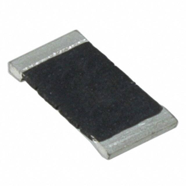

    27mΩ , - , 1W , ±1% , -65℃~+170℃ , ±75ppm/℃ ,
TL3AR027FTDG 数据手册
SMD Low Ohmic - Current Sense Resistors Type TL Series Type TL Series Characteristics Electrical 1206 R003-R20 2010 2512 R003-R50 R001-R50 ± 1% Up to 1 watt at 70°C derating to zero at 170°C -65°C to +170°C < 5 Nanohenries ±75ppm/°C (R007-R20/R50) Resistance Value Range: Resistance Tolerance: Power Rating: Operating Temperature: Inductance: T.C.R. Tyco are pleased to offer this Characteristics Mechanical unique High Power, metal chip resistor for current sensing positions. It has a special metal resistive element and suitable barrier layers beneath Body Construction: Terminations: Coating: Fully Welded Element 100% Tin Epoxy the solder to prolong terminal life. Following the developments by Power Derating Curve semiconductor manufacturers in 100 the production of a range of IC's for battery charge management and Type Power Rating Series satisfies the demand for a TL2B 0.25 Watts low ohmic shunt resistor to act as a TL2H* 0.5 Watts current sensor. It has particular TL3A 1.0 Watts Rated Power (%) 80 low voltage power supplies, the TL applications in the automotive 60 40 20 industry for sensing in EMU's. 0 0 50 70 Key Features ■ Up to 1 Watt at 70°C ■ Supplied on Tape ■ Ideal for Current Detection ■ Wide Value Range R001 to 1R0 Possible 90 110 130 150 170 190 Ambient Temperature (°C) For resistors operated in ambient temperatures above 70°C, power rating must be derated in accordance with this curve. Dimensions L D W ■ Fully Automated Manufacture ■ 12:06, 20:10 and 25:12 Packages Available ■ Available in Distribution H D Type L W H D TL2B 3.2 1.6 0.6 0.5 TL2H* 5.1 2.5 0.6 0.5 TL3A 6.4 3.2 0.6 0.8 How to Order TL Common Part 3A Power Ratings Resistance Value 2B - 12:06 TL - Standard Part R015 *2H - 20:10 3A - 25:12 F TE Tolerance Packaging 0.005 ohm (5 milli ohm) R005 0.015 ohm (15 milli ohms) R015 TE - 4000 per Reel F - ±1% TDG - 2000 per Reel (2512 only) 0.047 ohm (47 milli ohms) R047 * - 20:10 available by special request. Minimum Orders of 10000 pcs to apply Literature No. 1773289 Issued: 07-08 Dimensions are shown for reference purposes only. Dimensions are in millimetres unless otherwise specified. Specifications subject to change. tycoelectronics.com passives.tycoelectronics.com
TL3AR027FTDG
1. 物料型号:Type TL系列,包括TL2B、TL2H和TL3A型号。 2. 器件简介:该系列是高功率金属片电阻器,适用于电流检测位置,具有特殊的金属电阻元件和适当的屏障层,以延长端子寿命。 3. 引脚分配:文档中未明确提供引脚分配信息,但提到了100%锡端子。 4. 参数特性: - 电阻值范围:1206型号为R003-R20,2010型号为R003-R50,2512型号为R001-R50。 - 电阻公差:±1%。 - 功率等级:最高1瓦特在70°C,随着温度升高至170°C逐渐降低至零。 - 工作温度范围:-65°C至+170°C。 - 电感:<5纳亨。 - 温度系数:±75ppm/°C(R007-R20/R50)。 5. 功能详解:文档强调了该电阻器在电池充电管理和低电压电源供应IC的电流检测应用中的重要性,特别是在汽车工业中用于EMU的电流检测。 6. 应用信息:适用于电池充电管理和低电压电源供应的电流检测,特别是在汽车工业中。 7. 封装信息:提供了三种封装尺寸的详细尺寸信息,包括TL2B、TL2H和TL3A,以及它们的长、宽、高和直径。
