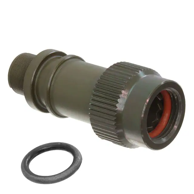

TINEL LOCK RING 3 CODE 76 - TINEL-LOCK BACKSHELL TXR76AB00-1608AI SERIES TXR: RING INCLUDED (SEE RING OPTION) TX: RING NOT INCLUDED CONNECTOR INTERFACE MATERIAL REFER TO CH00-0250-008 FINISH REFER TO CH00-0250-008 ANGLE ORDER NUMBER (TABLE 1) ENTRY SIZE (TABLE 2) RING OPTION AI - TO SUIT SINGLE BRAID BI - TO SUIT DOUBLE BRAID FOR TX, LEAVE BLANK MODIFICATION CODE REFER TO CH00-0250-008 2 NOTES: 1. THIS PRODUCT IS DESIGNED TO TERMINATE A BRAIDED CABLE SHIELD AND A HEAT SHRINKABLE LIPPED BOOT TO A CONNECTOR. 2. FOR ADDITIONAL DIMENSIONS, ORDERING INFORMATION AND MODIFICATIONS, SEE CH00-0250-008. 3. SEE DRAWING TR FOR DETAIL ON TINEL-LOCK RING, RINGS ARE DESIGNED TO BE HEATED ELECTRICALLY, ALL RINGS ARE MARKED WITH THERMOCHROMIC PAINT WHICH CHANGES COLOUR WHEN INSTALLATION TEMPERATURE IS REACHED. 4. BACKSHELL TO BE PERMANENTLY MARKED/BAGGED AND LABELLED WITH CODE IDENTIFICATION NUMBER AND PART NUMBER LESS RING DESIGNATOR. (e.g. 06090-TXR76AB00-1206). RING SHALL BEAR NO MARKING. 5. FOR LARGER ENTRY SIZES, A 2 PIECE BACKSHELL ASSEMBLY (TYPE 2) IS SUPPLIED. 6. BACKSHELL MATES WITH BS 9522. N0001 PATT 603, BSS 9522, F0017 PATT 105 DRAWN K.WINCZURA DATE CHECKED 05/12/2014 APPROVED K.SHEPPARD 15/12/2014 APPROVED H.SMITH 3RD ANGLE PROJECTION NOT TO SCALE 05/12/2014 01/10/2015 REVISIONS LTR DESCRIPTION E REVISED PER ECO-15-002399 F REVISED PER ECO-15-013980 UNLESS OTHERWISE SPECIFIED ALL DIMENSIONS IN MILLIMETRES GENERAL TOL LINEAR +/-0,25MM ANGULAR +/- 1° DA TE 18/02/2015 01/10/2015 TE CAGE CODE: 06090 POLAMCO/TE CAGE CODE: U5792 APPROVED H.SMITH TITLE: TINEL LOCK BACKSHELL ASSY USED ON: BS9522 PATT 105 / PATT 603 TE CONNECTIVITY - POLAMCO LTD RESERVES THE RIGHT TO AMEND THIS DRAWING AND THE INFORMATION SET FORTH HEREON AT ANY TIME. USERS SHOULD INDEPENDENTLY EVALUATE THE SUITABILITY OF THE PRODUCT FOR THEIR APPLICATION. DRAWING NO: DRAWING REV: SHT TXR76 F 1 IF MAX ENTRY IS EXCEEDED BACKSHELL WILL BE SUPPLIED AS TYPE 2 21,50 `0,50 PART MARK HERE STRAIGHT BACKSHELL - TYPE 1 26,50 SILICONE O-RING XXXX A THREAD ØB ØK ØY XXXX ØS ØZ A THREAD ØB SILICONE O-RING 36,40 SILICONE O-RING PART MARK HERE 5 STRAIGHT BACKSHELL - TYPE 2 21,50 `0,50 F C G D 45° BACKSHELL - TYPE 2 45° BACKSHELL - TYPE 1 W H T 21,50 `0,50 J E M 90° BACKSHELL - TYPE 1 W 21,50 `0,50 T 90° BACKSHELL - TYPE 2 H J E M 90° BACKSHELL - TYPE 1 STAINLESS STEEL AND NICKEL ALUMINIUM BRONZE DRAWN K.WINCZURA DATE CHECKED 05/12/2014 APPROVED K.SHEPPARD 15/12/2014 APPROVED H.SMITH 3RD ANGLE PROJECTION NOT TO SCALE 05/12/2014 01/10/2015 REVISIONS LTR DESCRIPTION E REVISED PER ECO-15-002399 F REVISED PER ECO-15-013980 UNLESS OTHERWISE SPECIFIED ALL DIMENSIONS IN MILLIMETRES GENERAL TOL LINEAR +/-0,25MM ANGULAR +/- 1° DA TE 18/02/2015 01/10/2015 TE CAGE CODE: 06090 POLAMCO/TE CAGE CODE: U5792 APPROVED H.SMITH 90° BACKSHELL - TYPE 2 STAINLESS STEEL AND NICKEL ALUMINIUM BRONZE TITLE: TINEL LOCK BACKSHELL ASSY USED ON: BS9522 PATT 105 / PATT 603 TE CONNECTIVITY - POLAMCO LTD RESERVES THE RIGHT TO AMEND THIS DRAWING AND THE INFORMATION SET FORTH HEREON AT ANY TIME. USERS SHOULD INDEPENDENTLY EVALUATE THE SUITABILITY OF THE PRODUCT FOR THEIR APPLICATION. DRAWING NO: DRAWING REV: SHT TXR76 F 2 TABLE 1 ORDER NUMBER 08 10 12 14 16 18 20 22 24 SHELL SIZE 6 8 10 12 14 16 18 20 22 24 TABLE 2 ENTRY SIZE 04 05 06 07 08 10 12 14 16 18 20 22 24 ØZ MIN 6,35 7,92 9,53 11,10 12,70 15,88 19,05 22,23 25,40 28,58 31,75 34,93 38,10 DRAWN K.WINCZURA A THREAD 7/16-28UNEF 9/16-24UNEF 11/16-24UNEF 13/16-20UNEF 15/16-20UNEF 1 1/16-18UNEF 1 3/16-18UNEF 1 5/16-18UNEF 1 7/16-18UNEF ØS 9,49 +/-0,04 11,06 +/-0,04 12,66 +/-0,04 14,21 +/-0,07 15,81 +/-0,07 18,96 +/-0,08 22,14 +/-0,08 25,30 +/-0,08 28,48 +/-0,08 31,65 +/-0,08 34,83 +/-0,08 37,98 +/-0,08 41,15 +/-0,08 DATE 05/12/2014 CHECKED 05/12/2014 APPROVED K.SHEPPARD 15/12/2014 APPROVED H.SMITH 01/10/2015 REVISIONS LTR DESCRIPTION E REVISED PER ECO-15-002399 F REVISED PER ECO-15-013980 ØB MAX 17,3 20,3 23,8 26,8 29,8 33,3 36,3 39,8 42,8 ØY ± 0,3 14,00 15,50 17,10 18,70 20,30 23,50 26,70 29,80 33,00 36,20 39,40 42,50 45,70 ØK MAX NA 21,0 21,0 21,0 24,5 29,0 32,5 35,5 37,0 40,0 43,5 48,5 52,1 3RD ANGLE PROJECTION NOT TO SCALE TITLE: UNLESS OTHERWISE SPECIFIED ALL DIMENSIONS IN MILLIMETRES GENERAL TOL LINEAR +/-0,25MM ANGULAR +/- 1° DA TE 18/02/2015 01/10/2015 TE CAGE CODE: 06090 POLAMCO/TE CAGE CODE: U5792 MAX ENTRY 04 06 08 10 12 14 16 18 18 APPROVED H.SMITH C ±0,5 13,90 14,40 15,20 16,04 16,29 17,34 17,68 18,02 19,17 F ±0,5 NA 12,5 12,5 12,5 13,1 13,5 14,5 15,5 16,1 16,5 17,0 18,5 21,9 D ±0,5 26,8 27,5 28,0 29,0 29,7 30,5 30,9 31,1 32,1 G ±0,5 NA 27,5 27,5 27,5 28,0 29,0 29,7 30,5 30,9 31,1 32,1 35,3 38,1 W ±0,5 25,0 28,0 31,5 35,0 38,0 41,5 45,0 48,0 51,0 H ±0,5 NA 24,0 24,0 24,0 27,0 31,0 34,0 35,0 38,0 42,0 45,0 54,5 58,0 T ±0,5 17,5 18,6 20,5 22,5 24,0 26,0 28,0 29,5 31,0 M ±0,5 NA 15,5 15,5 15,5 17,0 19,5 21,0 20,0 21,5 24,0 25,5 31,0 33,0 THESE DIMENSIONS APPLY IF BACKSHELL IS STAINLESS STEEL OR NICKEL ALUMINIUM BRONZE W T E ±0,5 ±0,5 ±0,5 22,4 17,5 26,4 24,8 18,6 28,2 29,5 20,5 29,7 32,6 22,5 31,2 35,4 24,0 32,9 39,2 26,0 34,5 42,6 28,0 36,1 45,8 29,5 37,6 48,3 31,0 39,1 E ±0,5 26,20 27,95 29,45 31,00 32,70 34,25 35,80 37,40 38,90 J ±0,5 NA 27,95 27,95 27,95 29,45 31,00 32,70 34,25 35,80 37,40 38,90 42,00 46,00 THESE DIMENSIONS APPLY IF BACKSHELL IS STAINLESS STEEL OR NICKEL ALUMINIUM BRONZE H M J ±0,5 ±0,5 ±0,5 NA NA NA 24,3 17,2 28,2 24,3 17,2 28,2 24,3 17,2 28,2 28,3 19,4 29,7 31,1 21,0 31,2 34,2 22,8 32,9 38,5 25,3 34,5 40,7 26,1 36,1 43,7 27,6 37,6 46,4 29,1 39,1 50,0 31,0 42,0 53,5 33,0 46,0 TINEL LOCK BACKSHELL ASSY USED ON: BS9522 PATT 105 / PATT 603 TE CONNECTIVITY - POLAMCO LTD RESERVES THE RIGHT TO AMEND THIS DRAWING AND THE INFORMATION SET FORTH HEREON AT ANY TIME. USERS SHOULD INDEPENDENTLY EVALUATE THE SUITABILITY OF THE PRODUCT FOR THEIR APPLICATION. DRAWING NO: DRAWING REV: SHT TXR76 F 3
