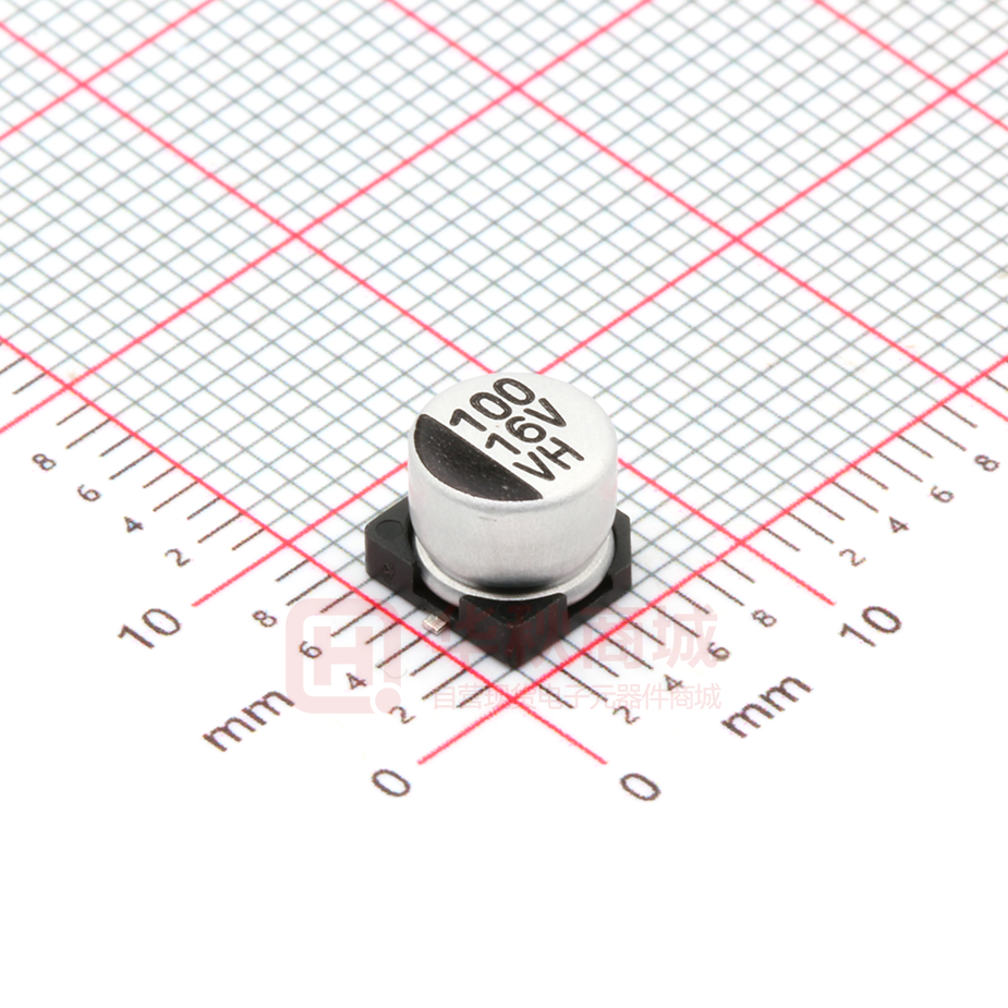

    SMD,D6.3xL5.4mm
    贴片铝电解电容 SMD,D6.3xL5.4mm 100µF ±20% 16V 2000Hrs@105℃
VH1C101ME054000CE0 数据手册
Chang ® 铝电解电容器 Aluminum Electrolytic Capacitors VH 型片式铝电解电容 VH Series Chip Type Aluminum Electrolytic Capacitors 特点     Features 产品直径 Case diameter: :Ф 4mm – Ф 10mm 适用于再流焊。 Reflow soldering is available. 适用于高密度表面组装。Available for high density surface mounting. ROHS 指令已对应完毕。Adapted to the ROHS directive. 主要技术性能 Specifications 项目 Items 特性 Characteristics 工作温度范围 Operating Temperature -55℃ ~+105℃(6.3-100V),-40℃ ~+105℃(160-400V) Range 额定电压范围 6.3V ~ 400V Rated Voltage Range 标称电容量范围 1 ~ 1000μF Nominal Capacitance Range 标称电容量允许偏差 ±20%(20℃,120Hz) NominalCapacitanceToleranc e 漏电流 Leakage Current 损耗角正切(tgδ) 6.3to100V 160-400V I≤0.01CRVR or 3(μA),取较大者(2 分钟) CR:标称电容量 I≤0.04 CRVR +100(μA )(20℃,1 分钟)CR:标称电容量(μF) (μF) UR 额定电压(V) UR 额定电压(V) I≤0.01CRVR or 3(μA) Whichever is greater(at 20℃, after 2 I≤0.04CRVR +100(μA) Whichever is greater(at 20℃, after 1 minutes) minutes) UR (V) 6.3 10 16 25 35 50 63 80 100 120-250 350-400 tgδ 0.32 0.24 0.20 0.16 0.13 0.12 0.12 0.11 0.10 0.15 0.20 Dissipation Factor (Max) 20℃, 120Hz +105℃施加额定电压 2000 小时后,电容器应满足以下要求: After 2000 hours . application of rated voltage at 105℃, the capacitor shall meet the following requirement: 电容量变化率 ±30%初始值以内(160-400V 为±20% ) 耐久性 Capacitance Change Within ±30% of the initial value(±20% of 160-400V) Load Life 损耗角正切 ≤ 300%初始规定值(160-400V 为≤200% ) Dissipation Factor Not more than 300% of the initial specified value(≤200% of 160-400V) 漏电流 ≤ 初始规定值 Leakage Current Not more than the initial specified value 高温贮存 Shelf Life +105℃ 贮存 1000 小时后,加额定工作电压 30 分钟,电容器应满足以上耐久性要求 After storage for 1000 hours at +105℃, UR to be applied for 30 minutes ,the capacitors shall meet the requirement of load life above 低温特性 Low Temperature Stability 阻抗比 Impedance Ratio (120Hz) UR (V) 6.3 10 16 25 35 50 63 80 100 160-250 350-400 Z(-55℃)/Z(+20℃) 4 4 3 3 3 2 3 4 4 - - Z(-40℃)/Z(+20℃) - - - - - - - - - 6 10 在 250℃的条件下,电容器在热板上保持 30 秒,然后从热板上取出电容器,让其在室温下恢复,电容器应满足以下要求:The capacitors shall be kept on the hot plate maintained at 250℃ for 30 seconds. After removing from the hot plate and restored at room temperature, they meet the following requirement. 耐焊接热 Resistance to Soldering Heat 电容量变化率 ±10%初始值以内 Capacitance Change Within ±10% of the initial value 损耗角正切(tgδ) ≤初始规定值 Dissipation Factor Not more than the initial specified value 漏电流 ≤ 初始规定值 Leakage Current Not more than the initial specified value CHANGZHOU HUAWEI ELECTRONICS CO.,LTD. Chang 铝电解电容器 ® Aluminum Electrolytic Capacitors 尺寸图 Dimensions (Ф8 ~ Ф10) Capacitance 电容量 0.3MAX A±0.2 H Ф6.3×7.7 (mm) 4 × 5.4 A 1.8 B 4.3 C 4.3 E 1.0 L 5.4 H 注:160-400 产品 L 值公差为±1  E Negative 负极 L±0.5 H * Apply to 适用于 A±0.2 A±0.2 Negative 负极 L+0.2 -0.1 Positive 正极 C±0.2 A±0.2 E B±0.2 D±0.5 100 16V V H C±0.2 Plastic Platform 塑料底盘 D±0.5 0.3MAX Type 型号 Voltage 电压 B±0.2 Positive 正极 470 16V V H Capacitance 电容量 Plastic Platform 塑料底盘 0.5MAX Type 型号 5 × 5.4 2.1 5.3 5.3 1.3 5.4 6.3 × 5.4 2.4 6.6 6.6 2.2 5.4 0.5 ~ 0.8 6.3 × 7.7 2.4 6.6 6.6 2.2 7.7 8× 6.5 2.9 8.3 8.3 2.3 6.5 8× 10.5 2.9 8.3 8.3 3.1 10.5 10 × 10.5 8× 12.5 3.2 2.9 10.3 8.3 10.3 8.3 4.5 3.1 10.5 12.5 0.8~1.1 标称电容量、额定电压、额定纹波电流与外形尺寸对应表 Nominal capacitance, rated voltage, rated ripple current and case size table 电压 WV(Vdc) 6.3 10 35 0.5MAX (Ф4 ~ Ф6.3) Voltage 电压 容量 Ca(μA) 产品尺寸 纹波电流 22 4*5.4 33 电压 WV(Vdc) 容量 Ca(μA) 产品尺寸 纹波电流 22 10 4*5.4 18 4*5.4 26 22 5*5.4 30 47 5*5.4 36 33 5*5.4 32 100 5*5.4 38 47 6.3*5.4 50 220 6.3*5.4 86 100 6.3*5.4 60 330 6.3*7.7 105 220 6.3*7.7 100 470 8*10.5 340 330 8*10.5 290 680 8*10.5 350 470 8*10.5 320 1000 10*10.5 495 680 10*10.5 470 1500 10*12.5 560 1000 10*12.5 510 2200 10*12.5 580 1200 10*12.5 520 10 4*5.4 20 10 5*5.4 21 22 5*5.4 27 22 5*5.4 23 33 5*5.4 35 47 6.3*5.4 38 47 5*5.4 34 100 6.3*7.7 66 100 6.3*5.4 60 220 8*10.5 240 220 6.3*7.7 105 330 10*10.5 410 330 8*10.5 290 470 10*10.5 450 470 8*10.5 320 560 10*12.5 500 680 10*10.5 395 680 10*12.5 510 1000 10*10.5 450 1500 10*12.5 520 4.7 4*5.4 16 1 4*5.4 6.3 10 5*5.4 27 2.2 4*5.4 11 22 6.3*5.4 44 3.3 4*5.4 14 33 6.3*5.4 48 4.7 5*5.4 19 16 25 50 10 × 12.5 3.2 10.3 10.3 4.5 12.5 63 100 250 47 6.3*7.7 80 10 6.3*5.4 36 100 8*10.5 230 22 6.3*5.4 32 220 10*10.5 260 33 6.3*7.7 60 330 10*10.5 450 47 8*10.5 210 470 10*12.5 500 100 8*10.5 230 560 10*12.5 510 220 10*10.5 375 10 6.3*5.4 26 22 8*10.5 100 22 6.3*7.7 48 33 10*10.5 100 33 8*10.5 140 47 10*10.5 150 47 8*10.5 170 100 10*12.5 180 100 10*10.5 310 150 10*12.5 330 10 6.3*7.7 24 10 8*10.5 57 22 8*10.5 100 15 8*12.5 65 33 10*10.5 150 22 10*12.5 80 47 10*12.5 180 10 10*10.5 75 56 10*12.5 180 15 10*12.5 81 22 10*12.5 83 80 160 200 3.3 8*10.5 36 2.2 8*10.5 29 4.7 8*10.5 42 3.3 8*10.5 30 6.8 8*10.5 64 4.7 8*12.5 40 8.2 10*10.5 70 5.6 10*12.5 51 10 10*10.5 72 6.8 10*12.5 52 8.2 10*12.5 55 10 10*12.5 60 400 I~=Rated ripple current (mA) (105℃, 120Hz) I~=额定纹波电流(mA)(105℃,120Hz)  Frequency coefficient of ripple current 额定纹波电流的频率系数 Frequency 频率 Coefficient 系数 50Hz 120Hz 300Hz 1KHz 0.70 1.00 1.17 1.36 CHANGZHOU HUAWEI ELECTRONICS CO.,LTD 10K~100Hz 1.50
