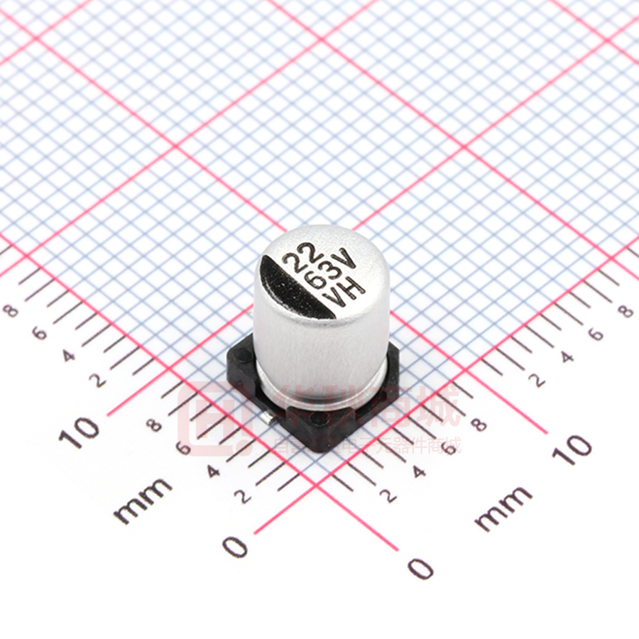

    SMD,D6.3xL7.7mm
    贴片铝电解电容 SMD,D6.3xL7.7mm 22µF ±20% 63V 2000Hrs@105℃
VH1J220ME077000CE0 数据手册
主要技术性能 Specifications 项目 Items 特性 Performance Characteristics 6.3~450V 标称电容量范围 Nominal Capacitance Range 1~2200μF 标称电容量允许偏差 Capacitance Tolerance A ±0.2 5×5.4 6.3×5.4 6.3×7.7 8×6.5 8×10.5 10×10.5 8×12.5 10×12.5 12.5×13.5 1.8 2.1 2.4 2.4 2.9 2.9 3.2 2.9 3.2 4.7 B 4.3 5.3 6.6 6.6 8.3 8.3 10.3 8.3 10.3 13 C 4.3 5.3 6.6 6.6 8.3 8.3 10.3 8.3 10.3 13 E 1.0 1.3 2.2 2.2 2.3 3.1 4.5 3.1 4.5 4.5 L 5.4 5.4 5.4 7.7 6.5 10.5 10.5 12.5 12.5 13.5 电压WV (Vdc) I≤0.01CRVR or 3(μA),取较大者(2分钟) CR:标称电容量(μ F) UR额定电压(V) I≤0.01CRVR or 3(μA) Whichever is greater(at 20℃, after 2 minutes) I≤0.04 CRVR +100(μA )(20℃,1分钟)CR:标称电容量(μF ) UR额定电压(V) I≤0.04CRVR +100(μA) Whichever is greater(at 20℃, after 1 minutes) UR (V) 6.3 10 16 25 35 50 63 80 100 160~250 350~450 tgδ 0.32 0.24 0.20 0.16 0.14 0.12 0.12 0.11 0.10 0.15 0.20 6.3 ±30%初始值以内(160~450V为±20% ) Within ±30% of the initial value(±20% of 160~450V) 电容量变化率 Capacitance Change 10 ≤ 300%初始规定值(160~450V为≤200% ) Not more than 300% of the initial specified value(≤200% of 160~450V) ≤ 初始规定值 Not more than the initial specified value +105℃ 贮存1000小时后,加额定工作电压30分钟,电容器应满足以上耐久性要求 After storage for 1000 hours at +105℃, UR to be applied for 30 minutes ,the capacitors shall meet the requirement of load life above UR (V) 6.3 10 16 25 35 50 63 80 100 160~250 350~450 Z(-25℃)/Z(+20℃) 4 4 3 2 2 2 2 3 3 3 6 Z(-40℃)/Z(+20℃) - - - - - - - - - 6 10 Z(-55℃)/Z(+20℃) 12 8 6 4 3 3 3 3 3 - - 在250℃的条件下,电容器在热板上保持30秒,然后从热板上取出电容器,让其在室温下恢复,电容器应满足以下要求: The capacitors shall be kept on the hot plate maintained at 250℃ for 30 seconds. After removing from the hot plate and restored at room temperature, they meet the following requirement. 074 0.5M A X 4×5.4 160~450V 漏电流 Leakage Current 耐焊接热 Resistance to Soldering Heat 单位 Unit: mm 0.5~0.8 0.8~1.1 标称电容量、额定电压、额定纹波电流与尺寸对应表 Nominal Capacitance, Rated Voltage, Rated Ripple Current and Case Size Table ±20%(20℃,120Hz) 损耗角正切 Dissipation Factor 低温特性 Low Temperature Stability 阻抗比 Impedance Ratio (120Hz) H A +105℃施加额定电压2000小时后,电容器应满足以下要求: After 2000 hours . application of rated voltage at 105℃, the capacitor shall meet the following requirement: 高温贮存 Shelf Life H H 6.3~100V 耐久性 Load Life negative 负极 L±0.5 -55~+105℃(6.3~100V), -40~+105℃(160~450V) 额定电压范围 Rated Voltage Range 损耗角正切(tgδ) Dissipation Factor (Max) 20℃, 120Hz C ±0.2 注:160~400产品L值公差为±1 工作温度范围 Operating Temperature Range 漏电流 Leakage Current A ±0.2 Φ* 6.3×7.7 L±0.3 RoHS指令已对应完毕。Adapted to the RoHS directive. 0.3M A X negative 负极 0.2 L+-0. 1 适用于高密度表面组装。Available for high density surface mounting. positive 正极 A ±0.2 适用于再流焊。 Reflow soldering is available. plastic platform 座板 series 型号 capacitance 容量 A ±0.2 产品直径 Case diameter: :Ф 4mm – Ф 12.5mm C ±0.2 B±0.2 100 16V VH 特点 Features D ±0.5 0.3M A X voltage 电压 B±0.2 capacitance 容量 positive 正极 470 16V VH series 型号 0.5M A X voltage 电压 Φ8~Φ12.5 plastic platform 座板 E Φ4~Φ6.3 D ±0.5 铝电解电容器-贴片型 Aluminum electrolytic capacitor- SMD type E VH 外形图及尺寸表 Case Size Table 16 容量Cap 产品尺寸 纹波电流 (μF) 电压WV (Vdc) 容量Cap (μF) 产品尺寸 纹波电流 电压WV (Vdc) 容量Cap (μF) 产品尺寸 纹波电流 电压WV (Vdc) 容量Cap (μF) 产品尺寸 纹波电流 100 100 12.5×13.5 390 10 8×10.5 57 15 8×12.5 65 22 10×12.5 80 33 12.5×13.5 180 10 10×10.5 75 15 10×12.5 81 22 4×5.4 22 330 8×10.5 290 1 4×5.4 6.3 33 4×5.4 26 470 8×10.5 320 2.2 4×5.4 11 47 5×5.4 36 680 10×10.5 470 3.3 4×5.4 14 100 5×5.4 38 1000 12.5×13.5 560 4.7 5×5.4 19 220 6.3×5.4 86 1200 10×12.5 520 10 6.3×5.4 36 330 6.3×7.7 105 10 5×5.4 21 22 6.3×5.4 32 470 8×10.5 340 22 5×5.4 23 33 6.3×7.7 60 680 8×10.5 350 47 6.3×5.4 48 47 8×10.5 230 22 12.5×13.5 220 1000 10×10.5 495 100 6.3×7.7 86 100 8×10.5 230 2.2 8×10.5 30 1500 10×12.5 560 220 8×10.5 240 220 10×10.5 375 3.3 8×10.5 36 2200 12.5×13.5 690 330 10×10.5 410 330 12.5×13.5 500 4.7 8×10.5 42 10 4×5.4 20 470 10×10.5 450 10 6.3×5.4 26 6.8 8×10.5 64 22 5×5.4 27 560 10×12.5 500 22 6.3×7.7 48 8.2 10×10.5 70 33 5×5.4 35 680 10×12.5 550 47 8×10.5 150 10 10×10.5 72 47 5×5.4 34 1000 12.5×13.5 560 100 10×10.5 310 22 12.5×13.5 150 100 6.3×5.4 60 4.7 4×5.4 16 220 12.5×13.5 480 2.2 8×10.5 29 220 6.3×7.7 105 10 5×5.4 27 10 6.3×7.7 35 3.3 8×10.5 30 470 8×10.5 320 22 6.3×5.4 44 22 8×10.5 90 4.7 8×12.5 40 680 10×10.5 395 33 6.3×5.4 48 33 10×10.5 100 5.6 10×12.5 51 1000 10×10.5 450 47 6.3×7.7 80 47 10×10.5 150 6.8 10×12.5 52 2200 12.5×13.5 690 100 8×10.5 240 100 10×12.5 180 8.2 10×12.5 55 10 4×5.4 18 220 10×10.5 430 4.7 6.3×5.8 18 10 12.5×13.5 75 22 5×5.4 30 330 10×10.5 450 10 6.3×7.7 24 4.7 10×12.5 40 33 5×5.4 32 470 10×12.5 510 22 8×10.5 100 10 12.5×13.5 70 47 6.3×5.4 50 560 12.5×13.5 530 33 10×10.5 150 100 6.3×5.4 60 680 12.5×13.5 550 47 10×12.5 180 220 6.3×7.7 100 82 12.5×13.5 310 16 25 35 50 63 80 100 200 250 400 450 I~=Rated ripple current (mA) (105℃, 120Hz) I~=额定纹波电流(mA)(105℃,120Hz) 额定纹波电流频率修正系数 Frequency correction factor for ripple current 电容量变化率 Capacitance Change ±10%初始值以内 Within ±10% of the initial value 损耗角正切(tgδ) Dissipation Factor ≤ 初始规定值 Not more than the initial specified value Frequency 频率 50Hz 120Hz 300Hz 1KHz 10K~100Hz 漏电流 Leakage Current ≤ 初始规定值 Not more than the initial specified value Coefficient 系数 0.70 1.00 1.17 1.36 1.50 目录中记载的内容可能未经提示而变更。贵司在购买时请要求提供承认书,并以此为基准使用。 The contents recorded in the catalogue might be changed without any reminder.Please ask for providing the datasheet and take it as standard when purchasing. 160 目录中记载的内容可能未经提示而变更。贵司在购买时请要求提供承认书,并以此为基准使用。 The contents recorded in the catalogue might be changed without any reminder.Please ask for providing the datasheet and take it as standard when purchasing. 075 主要技术性能 Specifications 项目 Items 特性 Performance Characteristics 6.3~450V 标称电容量范围 Nominal Capacitance Range 1~2200μF 标称电容量允许偏差 Capacitance Tolerance A ±0.2 5×5.4 6.3×5.4 6.3×7.7 8×6.5 8×10.5 10×10.5 8×12.5 10×12.5 12.5×13.5 1.8 2.1 2.4 2.4 2.9 2.9 3.2 2.9 3.2 4.7 B 4.3 5.3 6.6 6.6 8.3 8.3 10.3 8.3 10.3 13 C 4.3 5.3 6.6 6.6 8.3 8.3 10.3 8.3 10.3 13 E 1.0 1.3 2.2 2.2 2.3 3.1 4.5 3.1 4.5 4.5 L 5.4 5.4 5.4 7.7 6.5 10.5 10.5 12.5 12.5 13.5 电压WV (Vdc) I≤0.01CRVR or 3(μA),取较大者(2分钟) CR:标称电容量(μ F) UR额定电压(V) I≤0.01CRVR or 3(μA) Whichever is greater(at 20℃, after 2 minutes) I≤0.04 CRVR +100(μA )(20℃,1分钟)CR:标称电容量(μF ) UR额定电压(V) I≤0.04CRVR +100(μA) Whichever is greater(at 20℃, after 1 minutes) UR (V) 6.3 10 16 25 35 50 63 80 100 160~250 350~450 tgδ 0.32 0.24 0.20 0.16 0.14 0.12 0.12 0.11 0.10 0.15 0.20 6.3 ±30%初始值以内(160~450V为±20% ) Within ±30% of the initial value(±20% of 160~450V) 电容量变化率 Capacitance Change 10 ≤ 300%初始规定值(160~450V为≤200% ) Not more than 300% of the initial specified value(≤200% of 160~450V) ≤ 初始规定值 Not more than the initial specified value +105℃ 贮存1000小时后,加额定工作电压30分钟,电容器应满足以上耐久性要求 After storage for 1000 hours at +105℃, UR to be applied for 30 minutes ,the capacitors shall meet the requirement of load life above UR (V) 6.3 10 16 25 35 50 63 80 100 160~250 350~450 Z(-25℃)/Z(+20℃) 4 4 3 2 2 2 2 3 3 3 6 Z(-40℃)/Z(+20℃) - - - - - - - - - 6 10 Z(-55℃)/Z(+20℃) 12 8 6 4 3 3 3 3 3 - - 在250℃的条件下,电容器在热板上保持30秒,然后从热板上取出电容器,让其在室温下恢复,电容器应满足以下要求: The capacitors shall be kept on the hot plate maintained at 250℃ for 30 seconds. After removing from the hot plate and restored at room temperature, they meet the following requirement. 074 0.5M A X 4×5.4 160~450V 漏电流 Leakage Current 耐焊接热 Resistance to Soldering Heat 单位 Unit: mm 0.5~0.8 0.8~1.1 标称电容量、额定电压、额定纹波电流与尺寸对应表 Nominal Capacitance, Rated Voltage, Rated Ripple Current and Case Size Table ±20%(20℃,120Hz) 损耗角正切 Dissipation Factor 低温特性 Low Temperature Stability 阻抗比 Impedance Ratio (120Hz) H A +105℃施加额定电压2000小时后,电容器应满足以下要求: After 2000 hours . application of rated voltage at 105℃, the capacitor shall meet the following requirement: 高温贮存 Shelf Life H H 6.3~100V 耐久性 Load Life negative 负极 L±0.5 -55~+105℃(6.3~100V), -40~+105℃(160~450V) 额定电压范围 Rated Voltage Range 损耗角正切(tgδ) Dissipation Factor (Max) 20℃, 120Hz C ±0.2 注:160~400产品L值公差为±1 工作温度范围 Operating Temperature Range 漏电流 Leakage Current A ±0.2 Φ* 6.3×7.7 L±0.3 RoHS指令已对应完毕。Adapted to the RoHS directive. 0.3M A X negative 负极 0.2 L+-0. 1 适用于高密度表面组装。Available for high density surface mounting. positive 正极 A ±0.2 适用于再流焊。 Reflow soldering is available. plastic platform 座板 series 型号 capacitance 容量 A ±0.2 产品直径 Case diameter: :Ф 4mm – Ф 12.5mm C ±0.2 B±0.2 100 16V VH 特点 Features D ±0.5 0.3M A X voltage 电压 B±0.2 capacitance 容量 positive 正极 470 16V VH series 型号 0.5M A X voltage 电压 Φ8~Φ12.5 plastic platform 座板 E Φ4~Φ6.3 D ±0.5 铝电解电容器-贴片型 Aluminum electrolytic capacitor- SMD type E VH 外形图及尺寸表 Case Size Table 16 容量Cap 产品尺寸 纹波电流 (μF) 电压WV (Vdc) 容量Cap (μF) 产品尺寸 纹波电流 电压WV (Vdc) 容量Cap (μF) 产品尺寸 纹波电流 电压WV (Vdc) 容量Cap (μF) 产品尺寸 纹波电流 100 100 12.5×13.5 390 10 8×10.5 57 15 8×12.5 65 22 10×12.5 80 33 12.5×13.5 180 10 10×10.5 75 15 10×12.5 81 22 4×5.4 22 330 8×10.5 290 1 4×5.4 6.3 33 4×5.4 26 470 8×10.5 320 2.2 4×5.4 11 47 5×5.4 36 680 10×10.5 470 3.3 4×5.4 14 100 5×5.4 38 1000 12.5×13.5 560 4.7 5×5.4 19 220 6.3×5.4 86 1200 10×12.5 520 10 6.3×5.4 36 330 6.3×7.7 105 10 5×5.4 21 22 6.3×5.4 32 470 8×10.5 340 22 5×5.4 23 33 6.3×7.7 60 680 8×10.5 350 47 6.3×5.4 48 47 8×10.5 230 22 12.5×13.5 220 1000 10×10.5 495 100 6.3×7.7 86 100 8×10.5 230 2.2 8×10.5 30 1500 10×12.5 560 220 8×10.5 240 220 10×10.5 375 3.3 8×10.5 36 2200 12.5×13.5 690 330 10×10.5 410 330 12.5×13.5 500 4.7 8×10.5 42 10 4×5.4 20 470 10×10.5 450 10 6.3×5.4 26 6.8 8×10.5 64 22 5×5.4 27 560 10×12.5 500 22 6.3×7.7 48 8.2 10×10.5 70 33 5×5.4 35 680 10×12.5 550 47 8×10.5 150 10 10×10.5 72 47 5×5.4 34 1000 12.5×13.5 560 100 10×10.5 310 22 12.5×13.5 150 100 6.3×5.4 60 4.7 4×5.4 16 220 12.5×13.5 480 2.2 8×10.5 29 220 6.3×7.7 105 10 5×5.4 27 10 6.3×7.7 35 3.3 8×10.5 30 470 8×10.5 320 22 6.3×5.4 44 22 8×10.5 90 4.7 8×12.5 40 680 10×10.5 395 33 6.3×5.4 48 33 10×10.5 100 5.6 10×12.5 51 1000 10×10.5 450 47 6.3×7.7 80 47 10×10.5 150 6.8 10×12.5 52 2200 12.5×13.5 690 100 8×10.5 240 100 10×12.5 180 8.2 10×12.5 55 10 4×5.4 18 220 10×10.5 430 4.7 6.3×5.8 18 10 12.5×13.5 75 22 5×5.4 30 330 10×10.5 450 10 6.3×7.7 24 4.7 10×12.5 40 33 5×5.4 32 470 10×12.5 510 22 8×10.5 100 10 12.5×13.5 70 47 6.3×5.4 50 560 12.5×13.5 530 33 10×10.5 150 100 6.3×5.4 60 680 12.5×13.5 550 47 10×12.5 180 220 6.3×7.7 100 82 12.5×13.5 310 16 25 35 50 63 80 100 200 250 400 450 I~=Rated ripple current (mA) (105℃, 120Hz) I~=额定纹波电流(mA)(105℃,120Hz) 额定纹波电流频率修正系数 Frequency correction factor for ripple current 电容量变化率 Capacitance Change ±10%初始值以内 Within ±10% of the initial value 损耗角正切(tgδ) Dissipation Factor ≤ 初始规定值 Not more than the initial specified value Frequency 频率 50Hz 120Hz 300Hz 1KHz 10K~100Hz 漏电流 Leakage Current ≤ 初始规定值 Not more than the initial specified value Coefficient 系数 0.70 1.00 1.17 1.36 1.50 目录中记载的内容可能未经提示而变更。贵司在购买时请要求提供承认书,并以此为基准使用。 The contents recorded in the catalogue might be changed without any reminder.Please ask for providing the datasheet and take it as standard when purchasing. 160 目录中记载的内容可能未经提示而变更。贵司在购买时请要求提供承认书,并以此为基准使用。 The contents recorded in the catalogue might be changed without any reminder.Please ask for providing the datasheet and take it as standard when purchasing. 075
