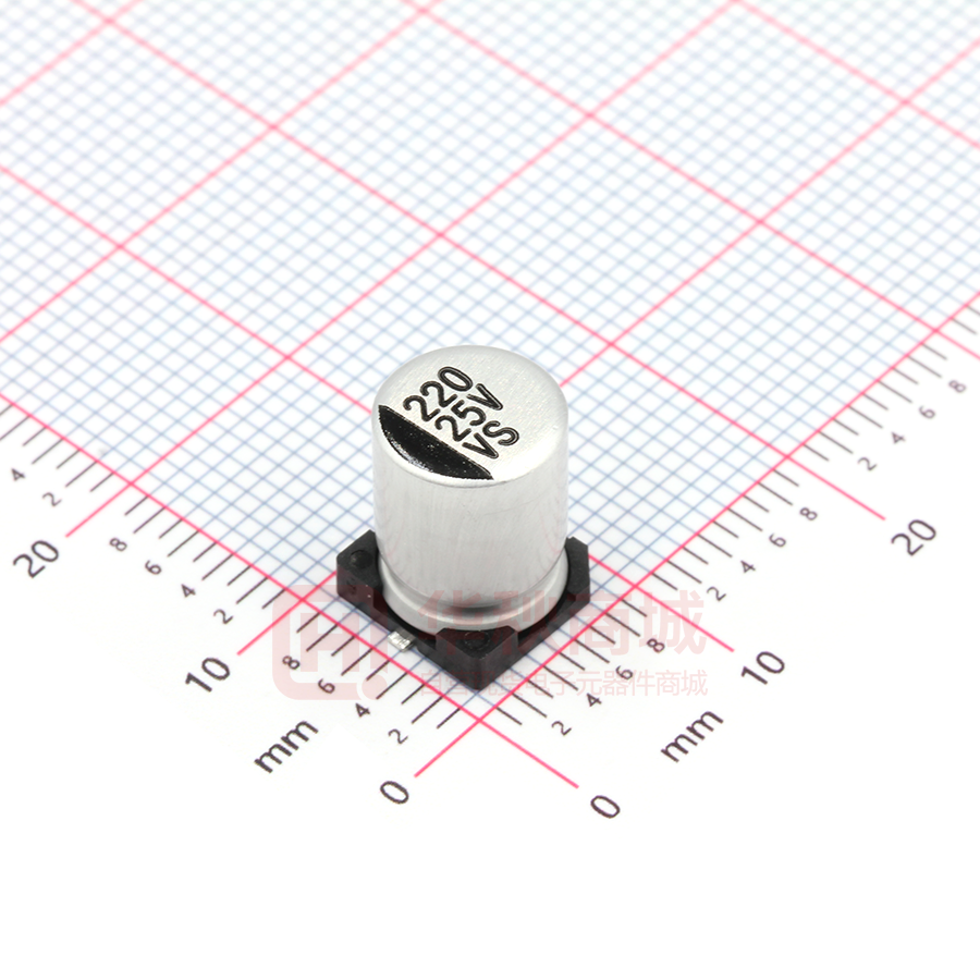

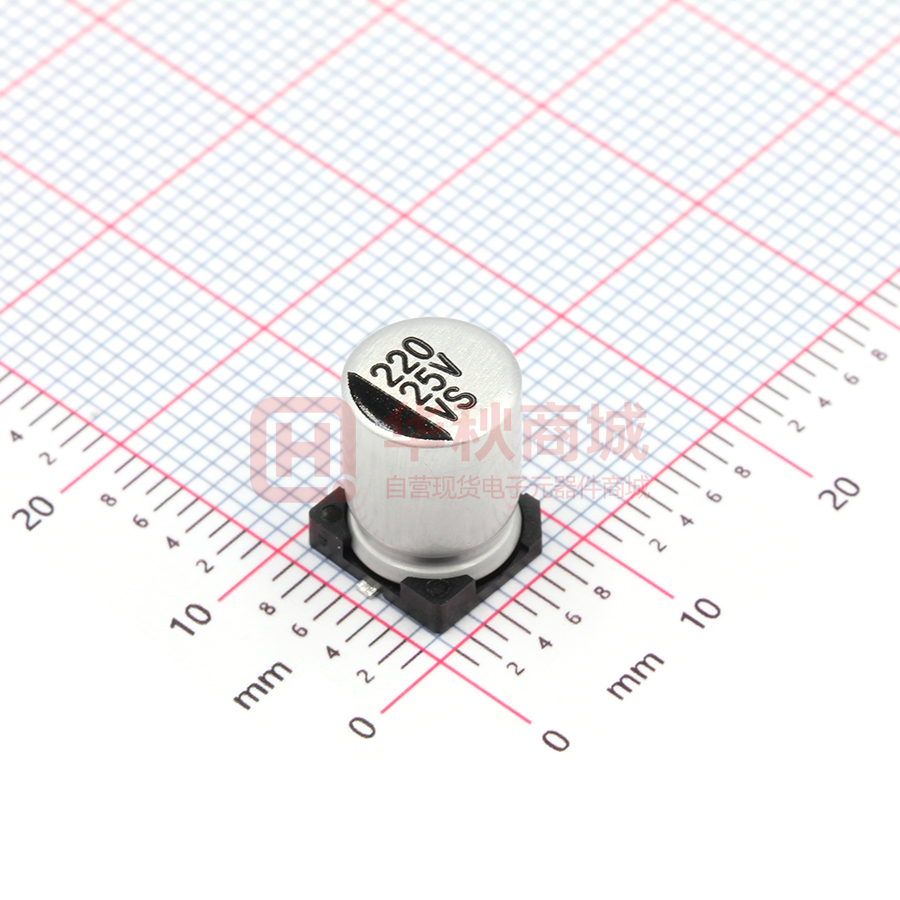

    贴片铝电解电容 SMD,D8xL10.5mm 220µF ±20% 25V 2000Hrs@85℃
VS1E221MF105000CE0 数据手册
Φ8~Φ12.5 适用于高密度表面组装。Available for high density surface mounting. negative 负极 0.2 L+-0. 1 RoHS指令已对应完毕。Adapted to the RoHS directive. 0.3M A X A ±0.2 E A ±0.2 适用于再流焊。 Reflow soldering is available. B±0.2 100 16V VS 产品直径 Case diameter: Ф4~12.5mm. D ±0.5 特点 Features capacitance 容量 Φ* 6.3×7.7 L±0.3 positive 正极 C ±0.2 A ±0.2 C ±0.2 plastic platform 座板 series 型号 A ±0.2 0.3M A X voltage 电压 0.5M A X capacitance 容量 positive 正极 B±0.2 series 型号 D ±0.5 voltage 电压 plastic platform 座板 E Φ4~Φ6.3 470 16V VS 铝电解电容器-贴片型 Aluminum electrolytic capacitor- SMD type 0.5M A X VS 外形图及尺寸表 Case Size Table negative 负极 L±0.5 H H 单位 Unit: mm 主要技术性能 Specifications 特性 Performance Characteristics 项目 Items 工作温度范围 Operating Temperature Range -40~85℃ 额定电压范围 Rated Voltage Range 6.3~100V 标称电容量范围 Nominal Capacitance Range V I≤0.01CRVR or 3(μA),取较大者(2分钟) CR:标称电容量(μF) UR:额定电压(V) I≤0.01CRVR or 3(μA) Whichever is greater(at 20℃, After 2 minutes) CR: Nominal Capacitance (μF) UR: Rated voltages (V) 损耗角正切(tgδ) Dissipation Factor (Max) 20℃, 120Hz UR (V) 6.3 tgδ 0.28 10 0.24 16 25 0.20 35 0.16 50 0.14 μF 63 0.12 100 0.12 0.10 +85℃施加额定电压2000小时后,电容器应满足以下要求: After 2000 hours’ application of rated voltage at 85℃, the capacitor shall meet the following requirement: 耐久性 Load Life 高温贮存 Shelf Life 电容量变化率 Capacitance Change ±20%初始值以内 Within ±20% of the initial value 损耗角正切 Dissipation Factor ≤ 200%初始规定值 Not more than 200% of the initial specified value 漏电流 Leakage Current ≤ 初始规定值 Not more than the initial specified value 低温特性 Low Temperature Stability 阻抗比 Impedance Ratio (120Hz) Z(-25℃)/Z(+20℃) Z(-40℃)/Z(+20℃) 损耗角正切 Dissipation Factor 漏电流 Leakage Current 8×10.5 10×10.5 12.5×13.5 A 1.8 2.1 2.4 2.4 2.9 2.9 3.2 4.7 13 B 4.3 5.3 6.6 6.6 8.3 8.3 10.3 C 4.3 5.3 6.6 6.6 8.3 8.3 10.3 13 E 1.0 1.3 2.2 2.2 2.3 3.1 4.5 4.5 L 5.4 5.4 5.4 7.7 6.5 10.5 10.5 13.5 0.5~0.8 0.8~1.1 10 6.3 D×L mm I~mA D×L mm 16 I~mA D×L mm I~mA 16 25 35 50 63 100 < Ф8 4 3 2 2 2 2 2 2 ≥ Ф8 5 4 3 2 2 2 2 2 < Ф8 8 8 4 4 3 3 3 3 ≥ Ф8 10 8 6 4 3 3 3 3 ±10%初始值以内 Within ±10% of the initial value ≤初始规定值 Not more than the initial specified value ≤ 初始规定值 Not more than the initial specified value D×L mm I~mA D×L mm 50 I~mA D×L mm I~mA 4×5.4 3.2 4×5.4 4.7 0.33 4×5.4 5.7 0.47 4×5.4 6.8 1.0 4×5.4 10 2.2 4×5.4 15 3.3 4×5.4 18 4×5.4 24 5×5.4 25 41 4×5.4 47 71 6.3×7.7 60 8×10.5 90 6.3×7.7 94 8×10.5 117 10×10.5 120 6.3×7.7 105 8×10.5 140 8×10.5 120 10×10.5 123 10×10.5 180 12.5×13.5 450 12.5×13.5 510 39 59 31 4×5.4 28 44 5×5.4 48 5×5.4 45 5×5.4 46 6.3×5.4 65 5×5.4 47 5×5.4 52 6.3×5.4 75 6.3×5.4 70 6.3×7.7 94 54 6.3×7.7 132 8×10.5 200 8×10.5 175 10×10.5 250 10×10.5 320 12.5×13.5 620 220 6.3×5.4 91 6.3×7.7 8×6.5 330 6.3×7.7 188 470 8×10.5 680 103 173 6.3×7.7 162 165 8×10.5 280 8×10.5 390 8×10.5 320 380 8×10.5 390 8×10.5 370 10×10.5 8×10.5 370 10×10.5 700 10×10.5 10×12.5 820 90 6.3×5.4 5×5.4 6.3×5.4 8×10.5 56 6.3×5.4 98 32 6.3×5.4 60 6.3×5.4 6.3×5.4 34 38 89 50 24 5×5.4 47 6.3×7.7 5×5.4 6.3×5.4 52 20 4×5.4 44 40 5×5.4 32 30 5×5.4 I~mA 24 5×5.4 4×5.4 D×L mm 5×5.4 4×5.4 5×5.4 I~mA 4×5.4 39 4×5.4 D×L mm 5×5.4 30 5×5.4 2200 20 5×5.4 31 6.3×5.4 1000 26 4×5.4 4×5.4 4×5.4 5×5.4 100 4×5.4 20 100 63 0.1 33 10 35 25 0.22 22 在250℃的条件下,电容器在热板上保持30秒,然后从热板上取出电容器,让其在室温下恢复,电容器应满足以下要求: The capacitors shall be kept on the hot plate maintained at 250℃ for 30 seconds. After removing from the hot plate and restored at room temperature, they meet the following requirement. 耐焊接热 Resistance to Soldering Heat 8×6.5 10 6.3 电容量变化率 Capacitance Change 6.3×7.7 4.7 +85℃贮存1000小时后,电容器应满足以上耐久性要求 After storage for 1000 hours at +85℃, the capacitors shall meet the requirement of load life above UR (V) 6.3×5.4 标称电容量、额定电压、额定纹波电流与尺寸对应表 标称电容量、额定电压、额定纹波电流与外形尺寸对应表 Nominal Capacitance, Rated Voltage, Rated Ripple Current and Case Size Table Nominal capacitance, rated voltage, rated ripple current and case size table ±20%(20℃,120Hz) 漏电流 Leakage Current 5×5.4 H 0.1~2200μF 标称电容量允许偏差 Nominal Capacitance Tolerance 4×5.4 6.3×77 143 8×10.5 230 8×10.5 200 10×10.5 310 10×10.5 360 8×10.5 270 10×10.5 340 10×10.5 380 12.5×13.5 600 12.5×13.5 690 8×10.5 350 10×10.5 420 480 10×10.5 440 12.5×13.5 700 580 12.5×13.5 780 12.5×13.5 760 I~=Rated ripple current (mA) (85℃, 120Hz) I~=额定纹波电流(mA)(85℃,120Hz) 070 目录中记载的内容可能未经提示而变更。贵司在购买时请要求提供承认书,并以此为基准使用。 The contents recorded in the catalogue might be changed without any reminder.Please ask for providing the datasheet and take it as standard when purchasing. 目录中记载的内容可能未经提示而变更。贵司在购买时请要求提供承认书,并以此为基准使用。 The contents recorded in the catalogue might be changed without any reminder.Please ask for providing the datasheet and take it as standard when purchasing. 071 Φ8~Φ12.5 适用于高密度表面组装。Available for high density surface mounting. negative 负极 0.2 L+-0. 1 RoHS指令已对应完毕。Adapted to the RoHS directive. 0.3M A X A ±0.2 E A ±0.2 适用于再流焊。 Reflow soldering is available. B±0.2 100 16V VS 产品直径 Case diameter: Ф4~12.5mm. D ±0.5 特点 Features capacitance 容量 Φ* 6.3×7.7 L±0.3 positive 正极 C ±0.2 A ±0.2 C ±0.2 plastic platform 座板 series 型号 A ±0.2 0.3M A X voltage 电压 0.5M A X capacitance 容量 positive 正极 B±0.2 series 型号 D ±0.5 voltage 电压 plastic platform 座板 E Φ4~Φ6.3 470 16V VS 铝电解电容器-贴片型 Aluminum electrolytic capacitor- SMD type 0.5M A X VS 外形图及尺寸表 Case Size Table negative 负极 L±0.5 H H 单位 Unit: mm 主要技术性能 Specifications 特性 Performance Characteristics 项目 Items 工作温度范围 Operating Temperature Range -40~85℃ 额定电压范围 Rated Voltage Range 6.3~100V 标称电容量范围 Nominal Capacitance Range V I≤0.01CRVR or 3(μA),取较大者(2分钟) CR:标称电容量(μF) UR:额定电压(V) I≤0.01CRVR or 3(μA) Whichever is greater(at 20℃, After 2 minutes) CR: Nominal Capacitance (μF) UR: Rated voltages (V) 损耗角正切(tgδ) Dissipation Factor (Max) 20℃, 120Hz UR (V) 6.3 tgδ 0.28 10 0.24 16 25 0.20 35 0.16 50 0.14 μF 63 0.12 100 0.12 0.10 +85℃施加额定电压2000小时后,电容器应满足以下要求: After 2000 hours’ application of rated voltage at 85℃, the capacitor shall meet the following requirement: 耐久性 Load Life 高温贮存 Shelf Life 电容量变化率 Capacitance Change ±20%初始值以内 Within ±20% of the initial value 损耗角正切 Dissipation Factor ≤ 200%初始规定值 Not more than 200% of the initial specified value 漏电流 Leakage Current ≤ 初始规定值 Not more than the initial specified value 低温特性 Low Temperature Stability 阻抗比 Impedance Ratio (120Hz) Z(-25℃)/Z(+20℃) Z(-40℃)/Z(+20℃) 损耗角正切 Dissipation Factor 漏电流 Leakage Current 8×10.5 10×10.5 12.5×13.5 A 1.8 2.1 2.4 2.4 2.9 2.9 3.2 4.7 13 B 4.3 5.3 6.6 6.6 8.3 8.3 10.3 C 4.3 5.3 6.6 6.6 8.3 8.3 10.3 13 E 1.0 1.3 2.2 2.2 2.3 3.1 4.5 4.5 L 5.4 5.4 5.4 7.7 6.5 10.5 10.5 13.5 0.5~0.8 0.8~1.1 10 6.3 D×L mm I~mA D×L mm 16 I~mA D×L mm I~mA 16 25 35 50 63 100 < Ф8 4 3 2 2 2 2 2 2 ≥ Ф8 5 4 3 2 2 2 2 2 < Ф8 8 8 4 4 3 3 3 3 ≥ Ф8 10 8 6 4 3 3 3 3 ±10%初始值以内 Within ±10% of the initial value ≤初始规定值 Not more than the initial specified value ≤ 初始规定值 Not more than the initial specified value D×L mm I~mA D×L mm 50 I~mA D×L mm I~mA 4×5.4 3.2 4×5.4 4.7 0.33 4×5.4 5.7 0.47 4×5.4 6.8 1.0 4×5.4 10 2.2 4×5.4 15 3.3 4×5.4 18 4×5.4 24 5×5.4 25 41 4×5.4 47 71 6.3×7.7 60 8×10.5 90 6.3×7.7 94 8×10.5 117 10×10.5 120 6.3×7.7 105 8×10.5 140 8×10.5 120 10×10.5 123 10×10.5 180 12.5×13.5 450 12.5×13.5 510 39 59 31 4×5.4 28 44 5×5.4 48 5×5.4 45 5×5.4 46 6.3×5.4 65 5×5.4 47 5×5.4 52 6.3×5.4 75 6.3×5.4 70 6.3×7.7 94 54 6.3×7.7 132 8×10.5 200 8×10.5 175 10×10.5 250 10×10.5 320 12.5×13.5 620 220 6.3×5.4 91 6.3×7.7 8×6.5 330 6.3×7.7 188 470 8×10.5 680 103 173 6.3×7.7 162 165 8×10.5 280 8×10.5 390 8×10.5 320 380 8×10.5 390 8×10.5 370 10×10.5 8×10.5 370 10×10.5 700 10×10.5 10×12.5 820 90 6.3×5.4 5×5.4 6.3×5.4 8×10.5 56 6.3×5.4 98 32 6.3×5.4 60 6.3×5.4 6.3×5.4 34 38 89 50 24 5×5.4 47 6.3×7.7 5×5.4 6.3×5.4 52 20 4×5.4 44 40 5×5.4 32 30 5×5.4 I~mA 24 5×5.4 4×5.4 D×L mm 5×5.4 4×5.4 5×5.4 I~mA 4×5.4 39 4×5.4 D×L mm 5×5.4 30 5×5.4 2200 20 5×5.4 31 6.3×5.4 1000 26 4×5.4 4×5.4 4×5.4 5×5.4 100 4×5.4 20 100 63 0.1 33 10 35 25 0.22 22 在250℃的条件下,电容器在热板上保持30秒,然后从热板上取出电容器,让其在室温下恢复,电容器应满足以下要求: The capacitors shall be kept on the hot plate maintained at 250℃ for 30 seconds. After removing from the hot plate and restored at room temperature, they meet the following requirement. 耐焊接热 Resistance to Soldering Heat 8×6.5 10 6.3 电容量变化率 Capacitance Change 6.3×7.7 4.7 +85℃贮存1000小时后,电容器应满足以上耐久性要求 After storage for 1000 hours at +85℃, the capacitors shall meet the requirement of load life above UR (V) 6.3×5.4 标称电容量、额定电压、额定纹波电流与尺寸对应表 标称电容量、额定电压、额定纹波电流与外形尺寸对应表 Nominal Capacitance, Rated Voltage, Rated Ripple Current and Case Size Table Nominal capacitance, rated voltage, rated ripple current and case size table ±20%(20℃,120Hz) 漏电流 Leakage Current 5×5.4 H 0.1~2200μF 标称电容量允许偏差 Nominal Capacitance Tolerance 4×5.4 6.3×77 143 8×10.5 230 8×10.5 200 10×10.5 310 10×10.5 360 8×10.5 270 10×10.5 340 10×10.5 380 12.5×13.5 600 12.5×13.5 690 8×10.5 350 10×10.5 420 480 10×10.5 440 12.5×13.5 700 580 12.5×13.5 780 12.5×13.5 760 I~=Rated ripple current (mA) (85℃, 120Hz) I~=额定纹波电流(mA)(85℃,120Hz) 070 目录中记载的内容可能未经提示而变更。贵司在购买时请要求提供承认书,并以此为基准使用。 The contents recorded in the catalogue might be changed without any reminder.Please ask for providing the datasheet and take it as standard when purchasing. 目录中记载的内容可能未经提示而变更。贵司在购买时请要求提供承认书,并以此为基准使用。 The contents recorded in the catalogue might be changed without any reminder.Please ask for providing the datasheet and take it as standard when purchasing. 071
