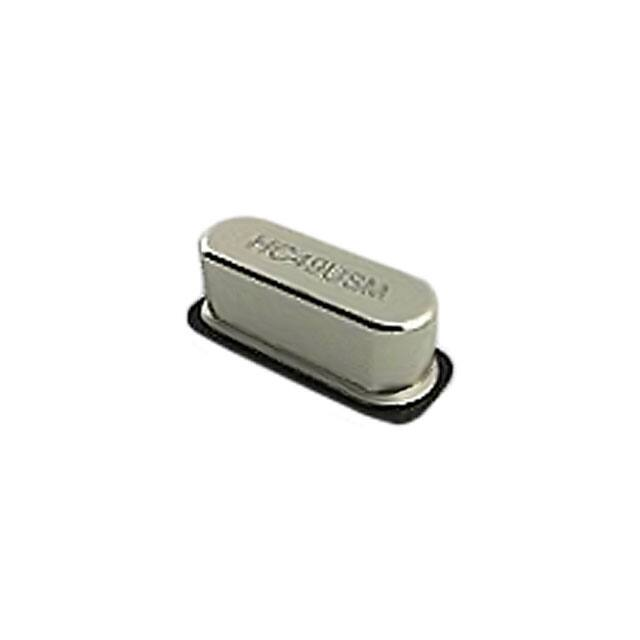

HC49USM Series Product Feature: Applications: Low Cost SMD Package Low ESR Compatible with Leadfree Processing Frequency Fibre Channel Server & Storage Sonet /SDH 802.11 / Wifi T1/E1.T3/E3 System Clock 3.2 MHz to 100 MHz ESR (Equivalent Series Resistance) 3.2 MHz - 3.49 MHz 3.5 MHz - 3.99 MHz 4.0 MHz - 4.99 MHz 5.0 MHz - 5.99 MHz 6.0 MHz - 6.99 MHz 7.0 MHz - 8.9 MHz 9.0 MHz - 12.9 MHz 13 MHz- 19.9 MHz 20 MHz - 36 MHz 36 MHz – 100.0 MHz (3rd O.T.) 300 Ω Max. 200 Ω Max. 150 Ω Max. 120 Ω Max. 100 Ω Max. 80 Ω Max. 60 Ω Max. 40 Ω Max. 30 Ω Max. 100 Ω Max. Shunt Capacitance (C0) 7 pF Max. Frequency Tolerance @ 25° C ±30 ppm Standard (see Part Number Guide for more options) Frequency Stability over Temperature ±50 ppm Standard (see Part Number Guide for more options) Crystal Cut AT Cut Load Capacitance 18 pF Standard (see Part Number Guide for more options) Drive Level 1 mW Max. Aging ±5 ppm Max. / Year Standard Temperature Operating 0° C to +70° C Standard (see Part Number Guide for more options) Storage -40° C to +85° C Standard Part Number Guide Package HC49USM­ (4.5 mm H) HC49USM2(3.5 mm H) HC49USM3(3.1 mm H)- Tolerance (ppm) at Room Temperature B = ±50ppm F = ±30ppm G = ±25ppm H = ±20ppm I = ±15ppm J = ±10ppm* Dimension Units: mm Sample Part Number: HC49USM - FB1F18 - 20.000 Stability Operating Mode Load (ppm) over Operating Temperature Range (overtone) Capacitance Temperature (pF) A = ±100ppm B = ±50ppm 0 = 0°C to +50°C F = Fundamental F = ±30ppm 1 = 0°C to +70°C 3 = Third Overtone 18pF Standard G = ±25ppm 2 = -10°C to +60°C Or Specify H = ±20ppm 3 = -20°C to +70°C I = ±15ppm 5 = -40°C to +85°C J = ±10ppm 9 = -10°C to +50°C Frequency -20.000 MHz * Not available at all frequencies. Revised B: 09/20 Page 2 of 6 www.ilsiamerica.com HC49USM Series Pb Free Solder Reflow Profile: Typical Circuit: *Units are backward compatible with 240C reflow processes Package Information: MSL = N/A Termination = e4 (Sn / Cu/ Ag over Ni over Kovar base metal). Tape and Reel Information: A B C D E F QTY per Reel Revised B: 09/20 Page 3 of 6 24 +/- 0.3 12 +/- 0.2 11.5 +/- 0.2 25 +/- 1.5 80/100 330 1000 www.ilsiamerica.com

物料型号:HC49USM系列
器件简介:该系列提供低成本的表面贴装封装,具有低等效串联电阻(ESR),并且兼容无铅加工。
引脚分配:文档中未明确提供引脚分配信息。
参数特性: - 频率范围:3.2MHz至100MHz - 等效串联电阻(ESR):不同频率下有不同的最大值 - 电容:最大7pF - 25°C频率容差:标准+30ppm,有更多选项 - 频率随温度变化的稳定性:标准±50ppm,有更多选项 - 晶体切割:AT切割 - 负载电容:标准18pF,有更多选项 - 驱动水平:最大1mW - 老化:标准每年±5ppm - 工作温度:标准0°C至+70°C,有更多选项 - 存储温度:标准-40°C至+85°C
功能详解:文档提供了详细的频率与ESR的关系表,以及温度对频率稳定性的影响。
应用信息:适用于光纤通道、服务器和存储、Sonet/SDH、802.11/Wi-Fi、T1/E1、T3/E3和系统时钟等。
封装信息:提供了详细的尺寸信息和包装信息,例如胶带和卷轴信息。
