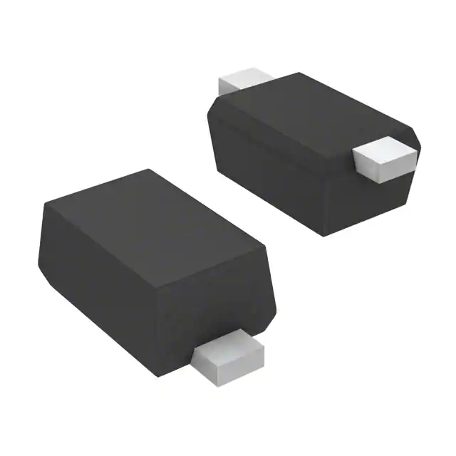

BAR50... Silicon PIN Diodes • Current-controlled RF resistor for switching and attenuating applications • Frequency range above 10 MHz up to 6 GHz • Especially useful as antenna switch in mobile communication • Very low capacitance at zero volt reverse bias at freuencies above 1 GHz (typ. 0.15 pF) • Low forward resistance • Very low harmonics distortion • Pb-free (RoHS compliant) package 1) • Qualified according AEC Q101 BAR50-02L BAR50-02V BAR50-03W  Type BAR50-02L BAR50-02V BAR50-03W Package TSLP-2-1 SC79 SOD323 Configuration single,leadless single single LS(nH) 0.4 0.6 1.8 Marking AB a A 1 2009-05-13 BAR50... Maximum Ratings at TA = 25°C, unless otherwise specified Parameter Diode reverse voltage Forward current Total power dissipation BAR50-02L, TS ≤ 130°C BAR50-02V, TS ≤ 120°C BAR50-03W, TS ≤ 115°C Junction temperature Operating temperature range Storage temperature 1Pb-containing Symbol VR IF Ptot Value 50 100 250 250 250 Unit V mA mW Tj Top Tstg 150 -55 ... 125 -55 ... 150 °C package may be available upon special request Thermal Resistance Parameter Junction - soldering point 1) BAR50-02L BAR50-02V BAR50-03W Symbol RthJS Value ≤ 80 ≤ 120 ≤ 140 Unit K/W Electrical Characteristics at TA = 25°C, unless otherwise specified Parameter DC Characteristics Reverse current VR = 50 V Forward voltage IF = 50 mA 1For Symbol min. IR VF - Values typ. 0.95 max. 50 1.1 Unit nA V calculation of RthJA please refer to Application Note Thermal Resistance 2 2009-05-13 BAR50... Electrical Characteristics at TA = 25°C, unless otherwise specified Parameter AC Characteristics Diode capacitance VR = 1 V, f = 1 MHz VR = 5 V, f = 1 MHz VR = 0 V, f = 100 MHz VR = 0 V, f = 1...1.8 GHz, BAR50-02L VR = 0 V, f = 1...1.8 GHz, all other Reverse parallel resistance VR = 0 V, f = 100 MHz VR = 0 V, f = 1 GHz VR = 0 V, f = 1.8 GHz Forward resistance I F = 0.5 mA, f = 100 MHz I F = 1 mA, f = 100 MHz I F = 10 mA, f = 100 MHz Charge carrier life time I F = 10 mA, IR = 6 mA, measured at IR = 3 mA, RL = 100 Ω I-region width Insertion loss1) I F = 3 mA, f = 1.8 GHz I F = 5 mA, f = 1.8 GHz I F = 10 mA, f = 1.8 GHz Isolation1) VR = 0 V, f = 0.9 GHz VR = 0 V, f = 1.8 GHz VR = 0 V, f = 2.45 GHz VR = 0 V, f = 5.6 GHz 1BAR50-02L Symbol min. CT RP rf τ rr Values typ. max. Unit pF 0.24 0.2 0.2 0.1 0.15 25 6 5 25 16.5 3 1100 0.5 0.4 kΩ Ω 40 25 4.5 ns - WI IL - 56 0.56 0.4 0.27 24.5 20 18 12 - µm dB ISO - in series configuration, Z = 50 Ω 3 2009-05-13 BAR50... Diode capacitance CT = ƒ (VR) f = Parameter 0.5 pF Reverse parallel resistance RP = ƒ(V R) f = Parameter 10 3 KOhm 0.4 10 2 100 MHz CT Rp 0.35 0.3 10 1 1 GHz 1.8 GHz 0.25 1 MHz 100 MHz 1 GHz 1.8 GHz 10 0 0.2 0.15 10 -1 0 0.1 0 2 4 6 8 10 12 14 16 V 20 2 4 6 8 10 12 14 16 V 20 VR VR Forward resistance rf = ƒ (I F) f = 100 MHz 10 4 Ohm Forward current IF = ƒ (VF) TA = Parameter 10 0 A 10 -1 10 3 10 -2 10 2 IF 10 -3 rf 10 1 10 -4 -40 °C 25 °C 85 °C 125 °C 10 0 10 -5 10 -1 -2 10 10 -1 10 0 10 1 mA 10 2 10 -6 0 0.2 0.4 0.6 0.8 V 1.2 IF VF 4 2009-05-13 BAR50... Forward current IF = ƒ (T S) BAR50-02L 120 mA Forward current IF = ƒ (T S) BAR50-02V 120 mA 100 90 80 100 90 80 IF 70 60 50 40 30 20 10 0 0 15 30 45 60 75 90 105 120 °C 150 IF 70 60 50 40 30 20 10 0 0 15 30 45 60 75 90 105 120 C° 150 TS TS Forward current IF = ƒ (T S) BAR50-03W 120 mA Permissible Pulse Load RthJS = ƒ (t p) BAR50-02L 10 2 100 90 80 IF mA RthJS 70 60 50 40 30 20 10 0 0 15 30 45 60 75 90 105 120 C° TS 10 1 D = 0.5 0.2 0.1 0.05 0.02 0.01 0.005 0 150 10 0 -6 10 10 -5 10 -4 10 -3 10 -2 °C 10 0 tp 5 2009-05-13 BAR50... Permissible Pulse Load IFmax / I FDC = ƒ (tp ) BAR50-02L 10 1 10 3 Permissible Pulse Load RthJS = ƒ (t p) BAR50-02V mA D=0 0.005 0.01 0.02 0.05 0.1 0.2 0.5 I Fmax/ IFDC 10 2 R thJS 10 1 10 0 0.5 0.2 0.1 0.05 0.02 0.01 0.005 0 10 0 -6 10 10 -5 10 -4 10 -3 10 -2 °C 10 0 10 -1 -6 10 10 -5 10 -4 10 -3 10 -2 s 10 0 tp tp Permissible Pulse Load IFmax / I FDC = ƒ (tp ) BAR50-02V 10 1 Permissible Pulse Load RthJS = ƒ (t p) BAR50-03W 10 3 IFmax /IFDC 10 2 0 0.005 0.01 0.02 0.05 0.1 0.2 0.5 RthjS 10 1 10 0 0.5 0.2 0.1 0.05 0.02 0.01 0.005 0 10 0 -6 10 10 -5 10 -4 10 -3 10 -2 10 -1 s 10 1 10 -1 -6 10 10 -5 10 -4 10 -3 10 -2 s 10 0 tp tp 6 2009-05-13 BAR50... Permissible Pulse Load IFmax / I FDC = ƒ (tp ) BAR50-03W 10 1 Insertion loss IL = -|S21| 2 = ƒ(f) IF = Parameter BAR50-02L in series configuration, Z = 50Ω 0 dB 100 mA IFmax/I FDC -0.2 |S 21| 2 10 mA 0 0.005 0.1 0.2 0.5 1 2 5 -0.3 5 mA -0.4 -0.5 3 mA -0.6 -0.7 10 0 -6 10 10 -5 10 -4 10 -3 10 -2 s 10 0 -0.8 0 1 2 3 4 GHz 6 tp f Isolation ISO = -|S21|2 = ƒ(f) VR = Parameter BAR50-02L in series configuration, Z = 50Ω 0 dB |S21|2 -10 -15 -20 -25 0V 1V 10 V 1 2 3 4 GHz -30 0 6 f 7 2009-05-13 Package SC79 BAR50... Package Outline 0.2 0.8 ±0.1 10˚MAX. M A 0.13 -0.03 +0.05 2 1.6 ±0.1 0.55 ±0.04 Foot Print 1.35 0.35 Marking Layout (Example) 2005, June Date code 0.35 BAR63-02V Type code Cathode marking Laser marking Standard Packing Reel ø180 mm = 3.000 Pieces/Reel Reel ø180 mm = 8.000 Pieces/Reel (2 mm Pitch) Reel ø330 mm = 10.000 Pieces/Reel Standard 4 Reel with 2 mm Pitch 2 0.2 1.33 1.96 Cathode marking 0.4 0.93 8 0.2 ±0.05 0.66 Cathode marking 1 0.3 ±0.05 Cathode marking 10˚MAX. 1.2 ±0.1 A 8 2009-05-13 BAR50... Date Code marking for discrete packages with one digit (SCD80, SC79, SC75 1) ) CES-Code M onth 2 0 03 01 02 03 04 05 06 07 08 09 10 11 12 a b c d e f g h j k l n 2 0 04 p q r s t u v x y z 2 3 2005 A B C D E F G H J K L N 2006 P Q R S T U V X Y Z 4 5 2 0 07 a b c d e f g h j k l n 2008 p q r s t u v x y z 2 3 2009 A B C D E F G H J K L N 2010 P Q R S T U V X Y Z 4 5 2011 a b c d e f g h j k l n 2012 p q r s t u v x y z 2 3 2 0 13 A B C D E F G H J K L N 2014 P Q R S T U V X Y Z 4 5 1 ) New Marking Layout for SC75, implemented at October 2005. . 9 2009-05-13 Package SOD323 BAR50... Package Outline 0.9 +0.2 -0.1 +0.2 1.25 -0.1 0 ±0.05 A 1.7 +0.2 -0.1 +0.05 0.3 -0.2 2 Cathode marking 1 0.3 +0.1 -0.05 0.25 M A 0.45 ±0.15 2.5 ±0.2 0.15 +0.1 -0.06 Foot Print 0.6 Marking Layout (Example) 0.8 1.7 0.8 BAR63-03W Type code Cathode marking Laser marking Standard Packing Reel ø180 mm = 3.000 Pieces/Reel Reel ø330 mm = 10.000 Pieces/Reel 4 0.2 2 2.9 8 Cathode marking 0.65 1.35 1 10 2009-05-13 Package TSLP-2-1 BAR50... Package Outline Top view 0.05 MAX. 2 0.4 +0.1 Bottom view 0.6 ±0.05 0.65±0.05 2 1 1 1) 1) Cathode marking 1) Dimension applies to plated terminal Foot Print For board assembly information please refer to Infineon website "Packages" 0.45 0.275 0.6 0.35 0.35 0.925 0.3 1 Copper Solder mask Stencil apertures Marking Layout (Example) BAS16-02L Type code Cathode marking Laser marking Standard Packing Reel ø180 mm = 15.000 Pieces/Reel Reel ø330 mm = 50.000 Pieces/Reel (optional) 4 0.5 1.16 Cathode marking 0.76 8 0.275 0.375 0.25 ±0.035 0.5 ±0.035 1 ±0.05 11 2009-05-13 BAR50... Edition 2006-02-01 Published by Infineon Technologies AG 81726 München, Germany © Infineon Technologies AG 2007. All Rights Reserved. Attention please! The information given in this dokument shall in no event be regarded as a guarantee of conditions or characteristics (“Beschaffenheitsgarantie”). With respect to any examples or hints given herein, any typical values stated herein and/or any information regarding the application of the device, Infineon Technologies hereby disclaims any and all warranties and liabilities of any kind, including without limitation warranties of non-infringement of intellectual property rights of any third party. Information For further information on technology, delivery terms and conditions and prices please contact your nearest Infineon Technologies Office ( www.infineon.com ). Warnings Due to technical requirements components may contain dangerous substances. For information on the types in question please contact your nearest Infineon Technologies Office. Infineon Technologies Components may only be used in life-support devices or systems with the express written approval of Infineon Technologies, if a failure of such components can reasonably be expected to cause the failure of that life-support device or system, or to affect the safety or effectiveness of that device or system. Life support devices or systems are intended to be implanted in the human body, or to support and/or maintain and sustain and/or protect human life. If they fail, it is reasonable to assume that the health of the user or other persons may be endangered. 12 2009-05-13
